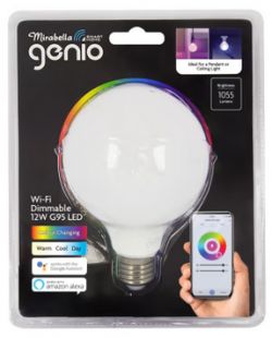

    Hi, If someone came to this topic. I got a tuya compatible RGBCW lamp "LED Planet" - Smart LED 10W 3000-7000+RGB BIvolt. with the same BK7231T and WB2L without any led driver (like: SM2135 above). To work , follow the same instructions (thanks @p.kaczmarek2 !!! ) and here the pins settings:
    This is required cuz it uses 2 PWM channels, one for brightness other for LED Temperature, need to combine both to work CW
    PS.: Still under tests ... maybe change it if I notice any problem.

    I have a Mirabella Genio 9W E27 800Lumen RGB + CCT Bulb - Part I003293,
    Initially flashed with tuya_cloudcutter profile: 'Grid Connect GLD132HA Bulb' profile
    I attempted to OTA flash the first one with OpenBK, firmware UG_1.15.258, and suspected it was bricked post flash - as once powered up, it never illuminated again - figuring it'd bricked it, it was ripped apart.
    Found it has a WBLC5 - BK7231TQN32 chip inside.
    Managed to OTA flash the second bulb first with OpenBK UG_1.15.346 - based on identified firmware: 2.9.15
    though as mentioned it never illuminates once powered on - however I can connect to the OpenBK web interface on this second bulb, and can successfully navigate through Config.

    Hi p.kaczmarek2,
    turns out the bulb is SM2135 controlled - P24: SM2135DAT & P26: SM2135CLK did the trick after a reboot.
    While some of the RGB colours are ever so slightly off - the bulb is controllable both via RBG, dimming and colour temp control.
    The bulb packaging looks like this - their available from Bunnings as well:
    https://templates.blakadder.com/mirabella_genio_I003293.html

    If it's useful to anyone here I used the pins from the I002944 above as a starting point to work out the ones for the G95 bulb:
    https://www.kmart.com.au/product/mirabella-genio-wi-fi-dimmable-12w-g95-led-bulb-42905806/
    Packaging of Mirabella Genio 12W G95 LED bulb with a phone app.
    P7 - LED Warm
    P8 - LED Cool
    P26 - LED Red
    P24 - LED Green
    P6 - LED Blue
    For ESPHome:
    light:
      - platform: rgbww
        red: output_red
        green: output_green
        blue: output_blue
        cold_white: output_cold_white
        warm_white: output_warm_white
        cold_white_color_temperature: 6536 K # guess
        warm_white_color_temperature: 2000 K # guess
        color_interlock: true
    output:
      - platform: ledc
        pin: GPIO26
        max_power: 80%
      - platform: ledc
        pin: GPIO24
        max_power: 80%
      - platform: ledc
        pin: GPIO6
        max_power: 80%
      - platform: ledc
        pin: GPIO8
        max_power: 80%
      - platform: ledc
        pin: GPIO7
        max_power: 80%
    (edit: I was able to flash with tuya-cloudcutter without opening them, using this profile: mirabella-genio-i003332-fancy-round-5w-rgbct-bulb)
