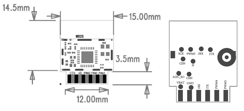

    Solderless adapters for boards like ESP12/TYWE3S seem to be widely available, but we haven't seen any for devices in TYWE2S/ESP-02S form. That's why we've designed our own WB2S/CB2S to CB3S/WB3S form converter that can be used alongside the commercial modules. Our converter has been tested with new Tuya BK7231N "standing" modules and can be used to flash them effectively before soldering.
    So, let us consider the WB2S module:
    Diagram and dimensions of WB2S module and converter board
    Pin No.SymbolI/O typeFunction
    1VBATPPower supply pin (3.3 V), which is connected to the VBAT pin on the internal IC
    2PWM2I/OCommon GPIO, which is connected to the P8 pin on the internal IC
    3GNDPPower supply reference ground pin
    4PWM1I/OCommon GPIO, which is connected to the P7 pin on the internal IC
    51RXI/OUART1_RXD, which is used as a user-side serial interface pin and is connected to the P10 pin on the internal IC
    6PWM0I/OCommon GPIO, which is connected to the P6 pin on the internal IC
    71TXI/OUART1_TXD, which is used as a user-side serial interface pin and is connected to the P11 pin on the internal IC
    8ADAIADC pin, which is connected to the P23 pin on the internal IC
    9PWM4I/OCommon GPIO, which is connected to the P24 pin on the internal IC
    10CENILow-level reset, high-level active (internally pulled high) Docking IC-CEN
    11PWM5I/OCommon GPIO, which is connected to the P26 pin on the internal IC

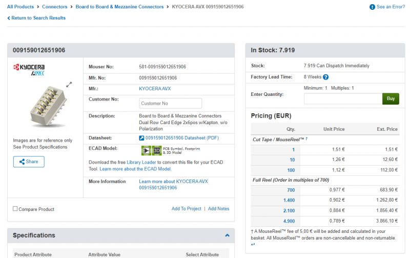

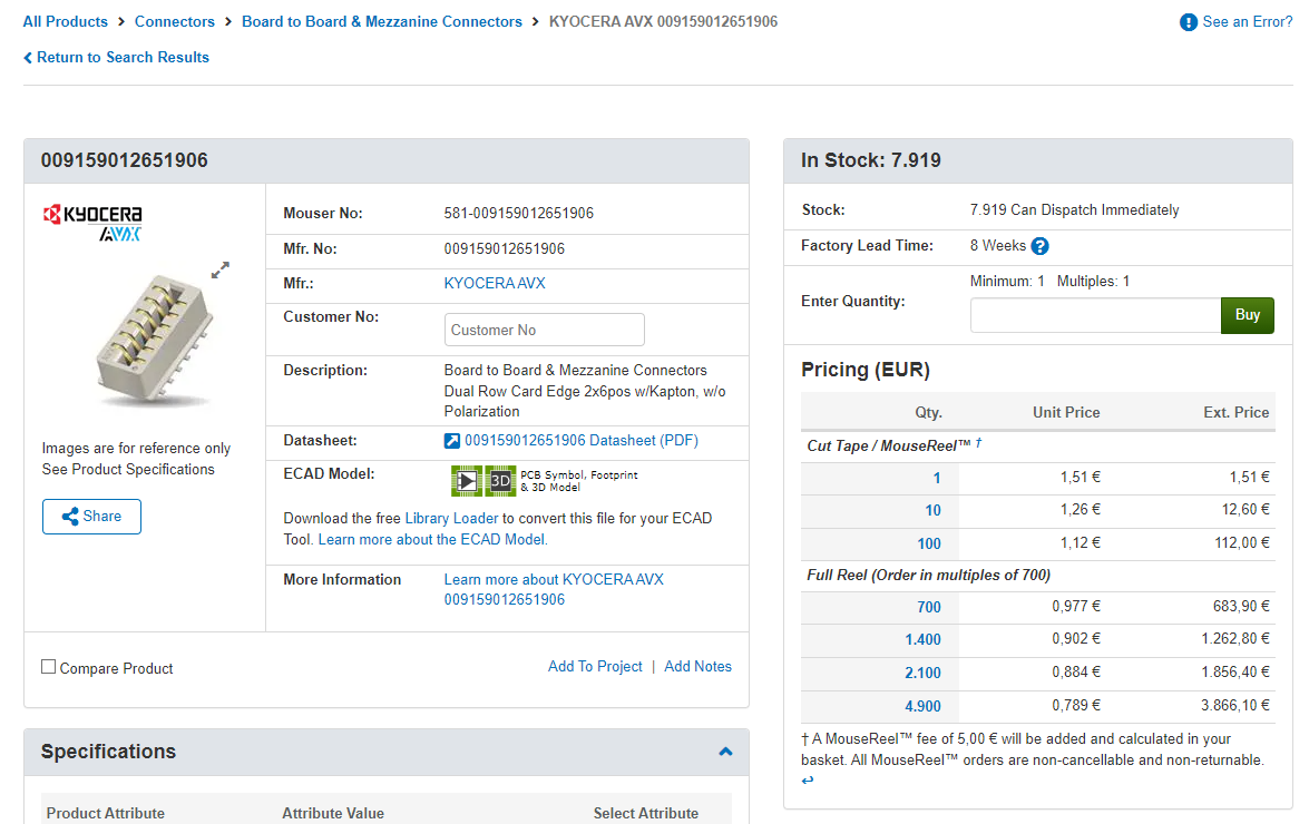

    That's why we've searched for suitable connector to make a conversion/daughter board ourselves. Here's what we found:

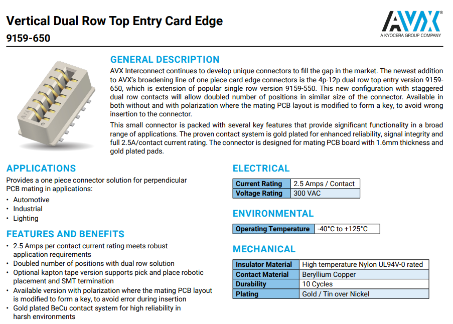

    Screenshot of an online store page displaying the KYOCERA AVX connector with part number 009159012651906.
    009159012651906 by KYOCERA AVX seems to have a matching pitch and contacts number. The current ratings are also of course well enough for our application:

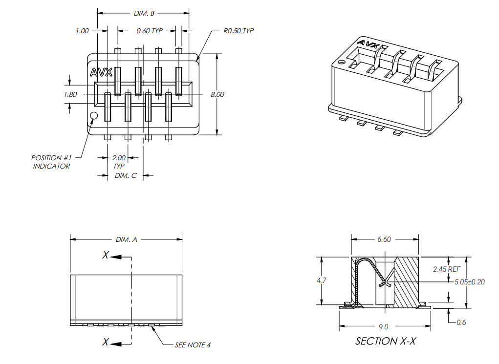

    AVX 9159-650 dual row top entry card edge connector.
    Here are dimensions of 4p version (6p is similiar):
    Technical drawing of a KYOCERA AVX 4p connector

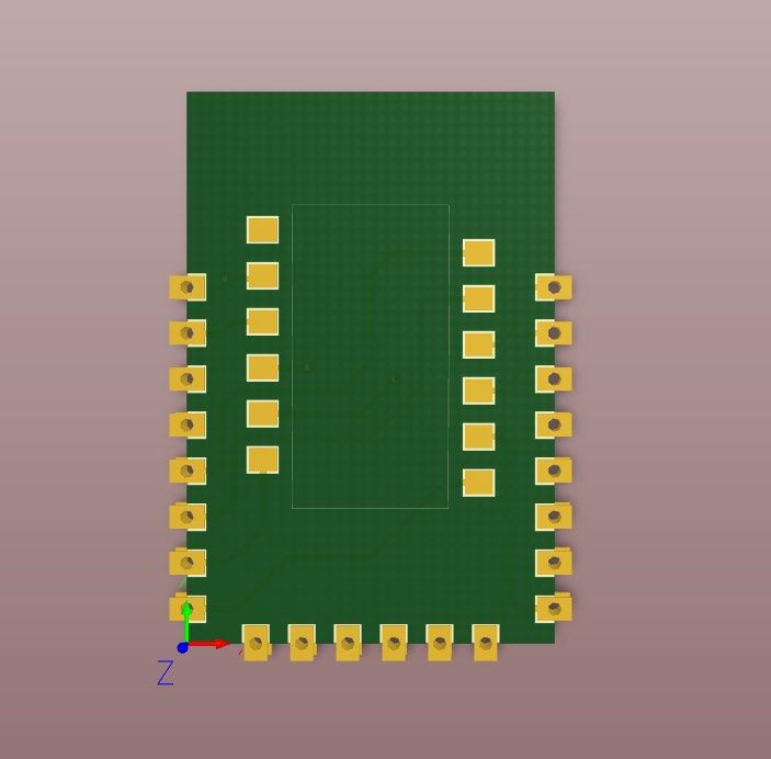

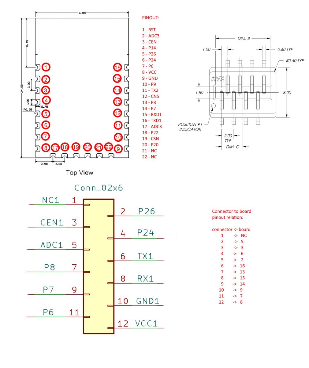

    So, after a moment in Kicad:
    Diagram and layout of the adapter board for CB2S/WB2S module.
    Note that first pin is NC (not connected) and that the board orientation matters.

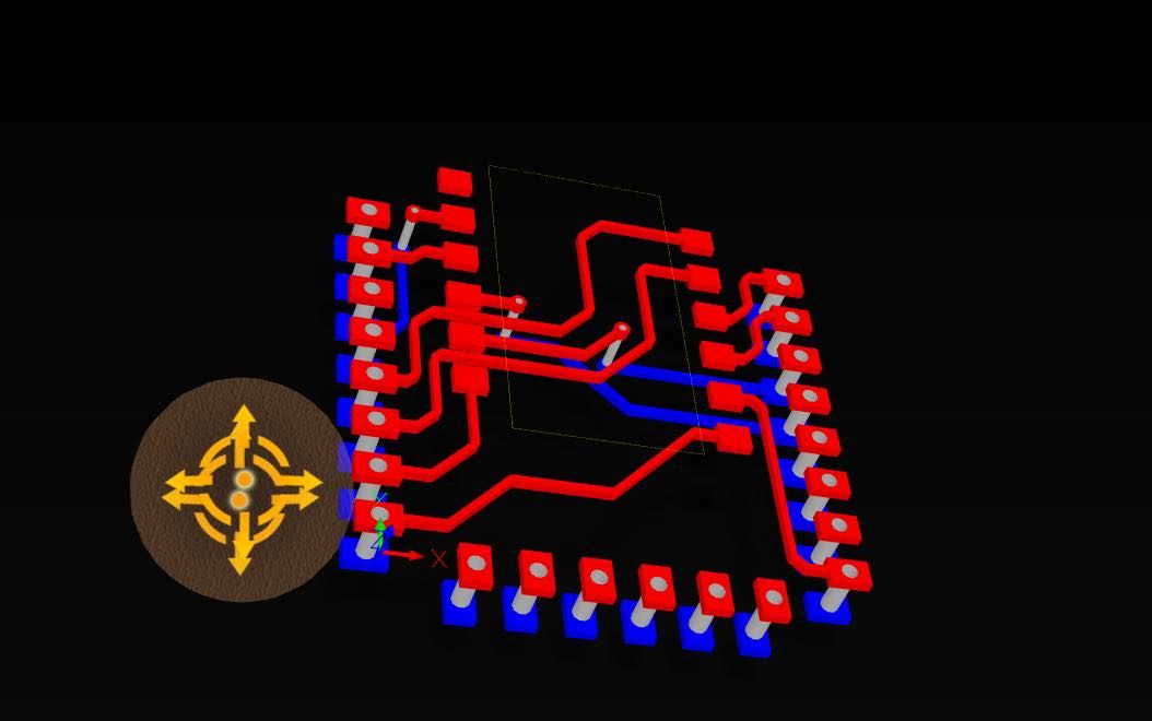

    And the board:
    PCB with red and blue traces in a 3D visualization.
    PCB design with pins on the edges

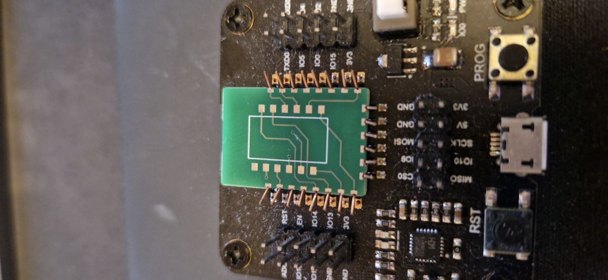

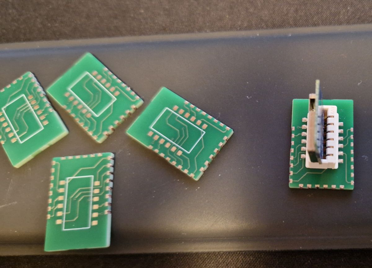

    We've ordered the boards and now's the time for testing:
    Green printed circuit boards with a module mounted on one of them.

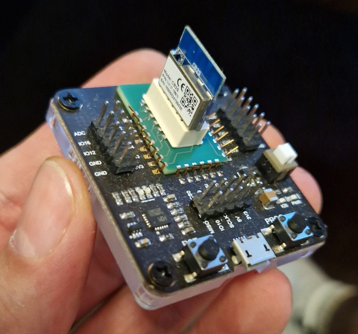

    CB2S fits well, and the daughter board fits TYWE3S/etc flasher good as well:
    Converter board on a main board without soldering
    The CB2S/WB2S is now easily flashable without soldering:
    CB2S module mounted on a PCB held in a hand
    Our flasher detects and flashes it well:

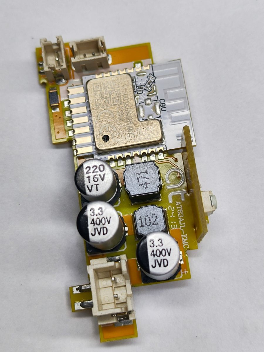

  • CBU pin access limits vertical adapter use
    #4 21217829
    insmod
    Posts: 1432
    Help: 168
    Rate: 455

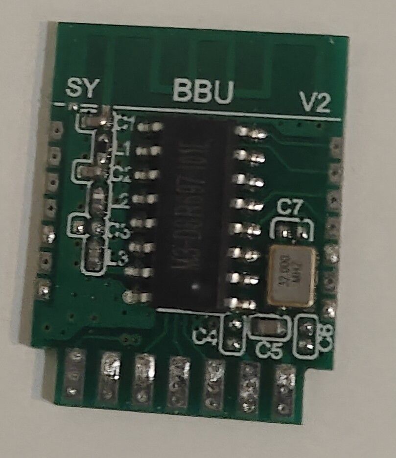

    CBU will only have 5 pins available, if connected vertically through a similar 7p adapter. But, it won't be possible to flash the board, since the uart pins are on the side. And it won't be possible to make an adapter, where cbu is placed horizontally, as its width it the same as that of an ESP-12 type module.
    Also, never seen before bluetooth BBU module (AK801?). Found in a random E27 bulb.
    Spoiler:
    BBU module with SY and V2 markings and electronic components, including an integrated circuit and capacitors. Electronic module with pin labels RXD, TXD, VPP, VCC, GND, and several NC.

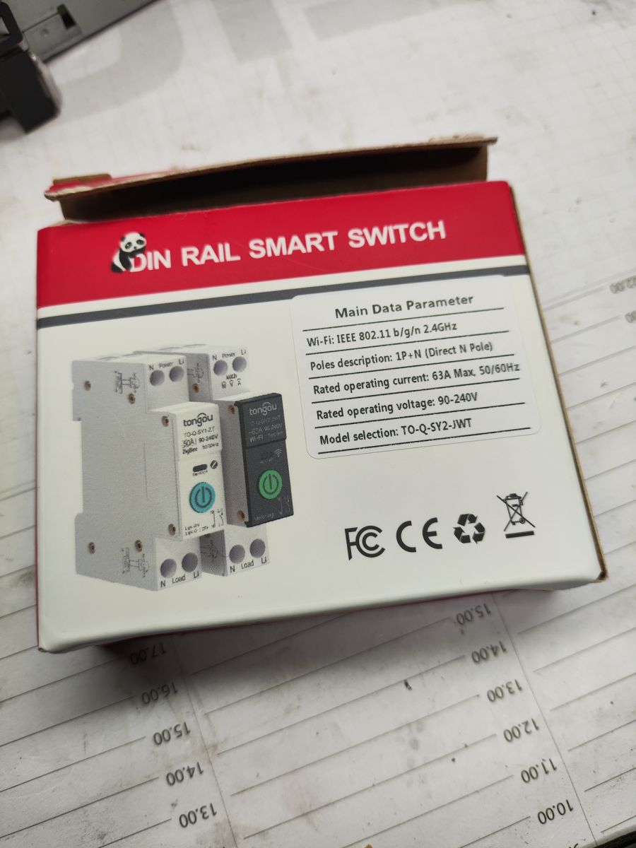

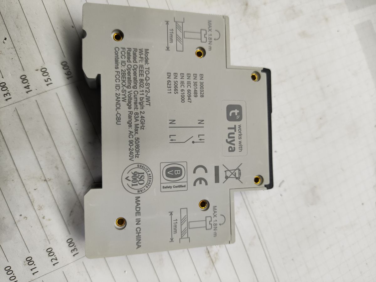

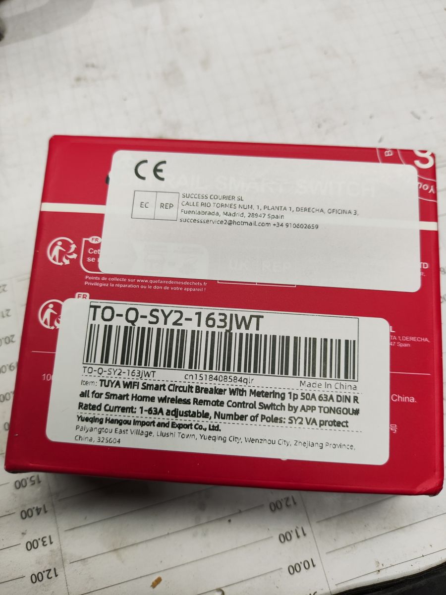

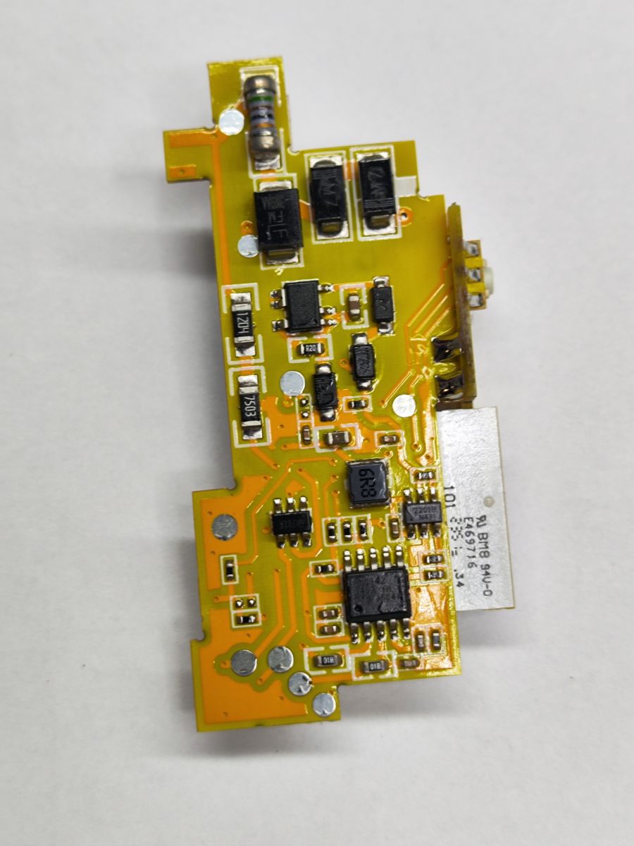

    I recently bought such a relay with measurement on the CBU:
    Close-up view of a circuit board with various electronic components. Electronic module with a relay and capacitors on a PCB. Image of the inside of a relay marked at 60A 250VAC COIL: 5VDC with visible wires and electronic components. Measurement relay on graph paper background. Packaging of a TUYA smart circuit breaker with metering, model TO-Q-SY2-163JWT. Photo of a DIN Rail Smart Switch box with technical data. Photo of a DIN Rail Smart Switch box with technical data. .
    By the way what pin-pin from esp8266 or esp32-c3 , esp32-s2, esp32-s3 or esp8285 will fit in this place ? He wants to Supla on this. I don't know how it will be with the measurement handling because there is something different (circuit) than in the GG but I will see what comes out.

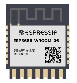

  • ESP8685-WROOM-06 fits multiple Tuya module footprints
    #8 21218005
    Posts: 14754
    Rate: 12875
    I see a TO-Q-SY2-163JWT relay. What kind of circuit is there? BL0942? Probably in SPI mode? OpenBeken supports it.

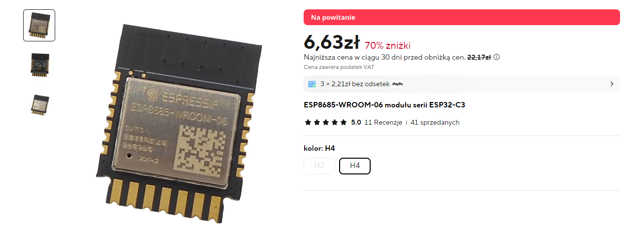

    As for the swap:
    ESP8685-WROOM-06 module by Espressif with visible logo and model number. .
    ESP8685-WROOM-06 fits in place of AXYU, BPU, CBU, ZSU, ZTU, WBRU.
    ESP8685-WROOM-06-H4 with 4MB flash (recommended) and ESP8685-WROOM-06-H2 with 2MB flash (not recommended, not enough flash)
    ESP8685-WROOM-06 module displayed on a product page with price and discount. .

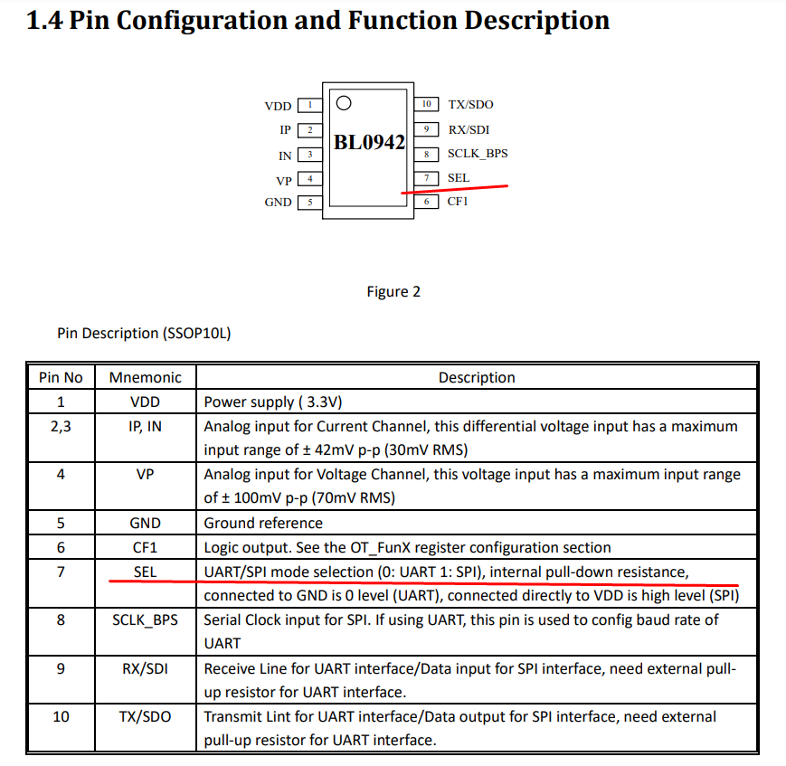

    In that case, is that BL0942 there in SPI or UART mode?
    Check the SEL pin:
    Pin configuration and function table for the BL0942 chip with SEL pin highlighted. .
  • #13 21218147
    madamsz1
    Level 42  
    Posts: 5883
    Help: 1057
    Rate: 1711
    Hym... it looks like pin 7 is not connected to anything . So it kind of works in the UART
  • #14 21218160
    Posts: 14754
    Rate: 12875
    The question now is whether the Supla supports the BL0942 in UART mode?

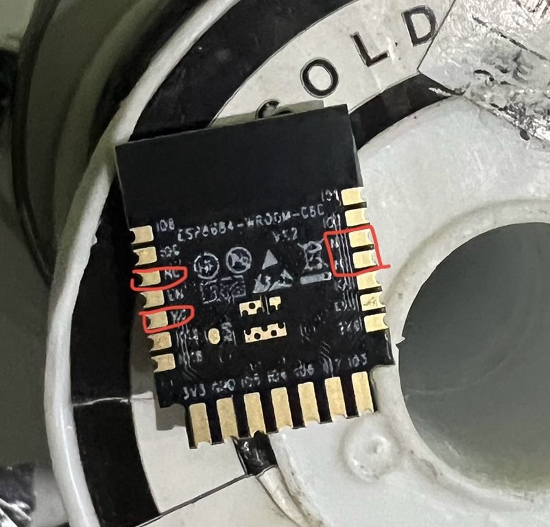

    >>21218128
    Do take note some of the pins are NC so you might have to bridge to other unused pins if the required pins are on those pads
    ESP8266 board with highlighted pins against a white rotor background.
  • #19 21223339
    DeDaMrAz
    Posts: 620
    Help: 34
    Rate: 130
    Thanks @ferbulous for the picture, this actually gives me hope that we can find CBU like adapter board as well so the hunt begins ;)

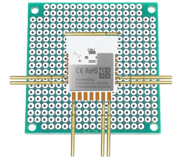

    You can still make your own diy CBU adapter with some prototype pcb and pogo pins soldered on the surface. Then just use clips to the uart
    Don't have it with me now but it looks like this
    Prototype circuit board with soldered CBU module and pogo pins.

Which connector part number fits the CB2S/WB2S board-to-board socket, and why was KYOCERA AVX 009159012651906 chosen for this adapter?
The chosen connector was KYOCERA AVX part 009159012651906. It was selected because its pitch and number of contacts matched the CB2S/WB2S mechanical interface, and its current rating was more than adequate for a low-power 3.3 V flashing setup. The thread also notes the designer compared dimensions, including a similar 4-pin version, before committing the KiCad layout. [#21216558]
What is BK7231GUIFlashTool, and how is it used to detect and flash BK7231N-based Tuya modules like CB2S and WB2S?
“BK7231GUIFlashTool is a flashing utility that detects and programs BK7231-family Tuya Wi‑Fi modules, using a GUI workflow for serial flashing.” In the thread, it is the tool used with the adapter to detect and flash BK7231N-based CB2S/WB2S modules after they are seated in the solderless daughter board. The practical use is simple: connect the adapted module to the flasher, run the tool, let it detect the module, then write firmware before soldering the module into the target device. [#21216558]

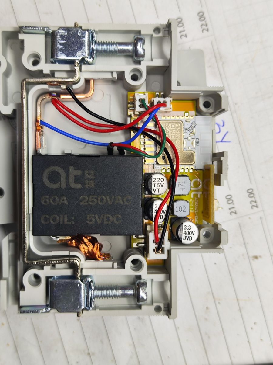

What is the BL0942 energy metering chip, and how do SPI mode and UART mode differ for firmware support?
“BL0942 is an energy-metering IC that measures electrical parameters for smart relays and sockets, and it can expose data through either SPI-mode wiring or UART-mode wiring.” In this thread, firmware support differs by interface: the relay discussed appeared to have BL0942 in UART mode, while OpenBeken support was already stated for BL0942 and the user asked whether another firmware stack supported the UART variant. The interface choice matters because drivers must match the chip’s wired mode. [#21218005]
ESP8685-WROOM-06-H4 vs ESP8685-WROOM-06-H2 — which one is better as a replacement for CBU, AXYU, BPU, ZSU, ZTU, or WBRU modules and why?
ESP8685-WROOM-06-H4 is the better replacement because it has 4 MB flash and was explicitly recommended. The H2 version has 2 MB flash and was explicitly not recommended because that capacity was described as not enough. The thread also states that ESP8685-WROOM-06 fits in place of AXYU, BPU, CBU, ZSU, ZTU, and WBRU, so the deciding factor here is flash size, not basic footprint compatibility. [#21218005]
Why would an ESP8684-WROOM-06C-H2 bulb reboot at 100% brightness, and how does lowering cw max_power to 0.95 help?
It rebooted because the bulb became unstable at full output. A user reported that the bulb looked normal until brightness reached 100%, then it reset; reducing cw max_power to 0.95 prevented the issue. That cap lowers peak drive demand, which reduces the stress that triggered the reboot. The thread does not quantify current or temperature, but it gives a concrete operational fix: limit the cool-white channel below full scale. [#21218251]
How can I tell whether a BL0942 in a Tuya relay is wired for SPI or UART mode by checking the SEL pin?
Check whether SEL pin 7 is connected. In the thread, the relay’s SEL pin appeared unconnected, and that was taken to mean the BL0942 was working in UART mode rather than SPI mode. So the practical test is visual continuity or trace inspection around pin 7: if SEL is not tied as required for SPI, treat the board as a UART-wired BL0942 design when choosing firmware support. [#21218147]
What pin-compatible ESP8266, ESP8285, or ESP32-family modules can replace a CBU module in a relay with energy measurement?
The thread directly recommends an ESP32-family module: ESP8685-WROOM-06. It was stated to fit in place of AXYU, BPU, CBU, ZSU, ZTU, and WBRU, with the H4 4 MB version preferred over the H2 2 MB version. No pin-compatible ESP8266, ESP8285, ESP32-C3, ESP32-S2, or ESP32-S3 module was confirmed in the discussion for that specific relay footprint, so the only explicit swap choice given was ESP8685-WROOM-06. [#21218005]

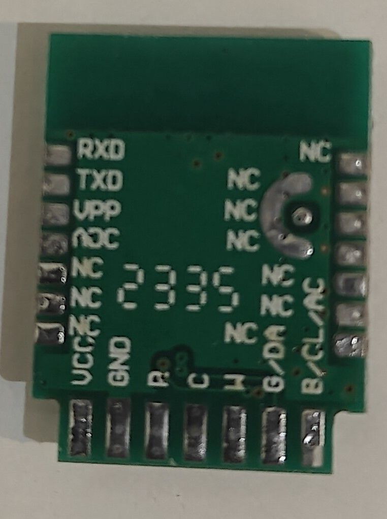

Why is making a solderless CBU adapter harder than CB2S/WB2S, especially when the UART pins are on the side and the module width matches ESP-12 boards?
It is harder because a similar vertical CBU adapter would expose only 5 usable pins, and that still would not solve flashing. The thread explains that CBU UART pins sit on the side, so a vertical board cannot reach them, while a horizontal adapter is impractical because the CBU width matches an ESP-12-style module. That combination blocks a clean daughter-board approach that worked for the 11-pin CB2S/WB2S design. [#21217829]
What devices most commonly use CBU compared with CB2S, CB3S, and WB2S modules, based on user reports from switches, bulbs, sensors, and LED SPI devices?
User reports in the thread split by device type. CBU was reported as common in door sensors, window sensors, flood sensors, and LED SPI devices, while CB2S, CB3S, and WB2S were reported as common in smart switches and “DIY smart switch” products. Another user also showed a relay with energy measurement built around CBU. So the pattern is sensors and some LED products for CBU, and switch hardware for CB2S/CB3S/WB2S. [#21218078]
How would I build a DIY CBU flashing adapter with prototype PCB, pogo pins, and UART clips if no ready-made adapter board is available?
You can make one from a prototype PCB, surface-soldered pogo pins, and separate UART clips. 1. Place pogo pins on the proto board so they press onto the CBU pads. 2. Hold the module mechanically in place during flashing. 3. Clip external UART leads onto the required serial points, since the side-mounted UART pins are the hard part. The thread presents this as a DIY workaround when no ready-made solderless CBU adapter exists. [#21238828]
Where can I get a couple of these CB2S/WB2S adapter boards pre-soldered or as connector-plus-PCB kits instead of ordering all parts separately?
The thread does not provide a seller, kit source, or order page. One user explicitly asked whether a couple could be ordered pre-soldered or as connector-plus-PCB sets, but no reply in the provided posts offered a buying option or distribution plan. So the only confirmed availability in this thread is DIY: the board files were attached by the project authors, and the hardware was built as a self-made solution. [#21276911]
What suitable connector options are available for the bottom 7-pin CBU module when designing a solderless adapter?
No suitable bottom 7-pin CBU connector was identified in the provided discussion. The last post asks that exact question, which shows the search was still open at that point. Earlier replies suggested a DIY alternative using pogo pins on a prototype PCB plus UART clips instead of a dedicated board-to-board connector. So, within this thread, the confirmed answer is “none found yet,” with pogo-pin tooling as the practical fallback. [#21279515]
