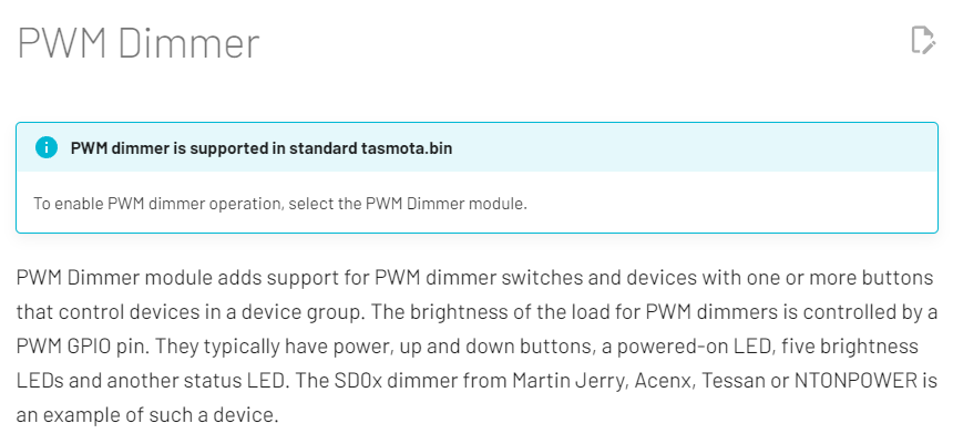

    The Martin Jerry Dimmer uses PWM dimmer, which is different from what MCU does. It's like a TuyaMCU dimmer but with different communication, in this case controlled via PWM:
    Screenshot of a webpage section with information about the PWM dimmer module.
    Getting other dimmers to work directly with OBK would require porting MCU functionality to OpenBeken, so OpenBeken would need to be able to detect phase via optocoupler and then quickly turn the light on at the specific point of sine wave. It is certainly doable, but there were no requests ever to that.
    Why would you like such a feature? Would you help with testing?

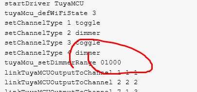

    tuyaMcu_setDimmerRange takes two arguments, min and max. And in the post you linked I can see:
    Screenshot of code where the tuyaMcu_setDimmerRange function has a missing space between arguments.
    did someone lost a space?
