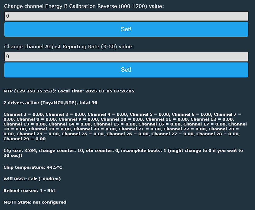

    Are you sure this code isn't for BL0492 and that your chip is different? On my device, all my attempts only result in zeros.
    Screenshot of OpenBK7231N device configuration menu.
    Application interface with energy calibration and reporting rate settings.
    Screenshot of a text editor with the file autoexec.bat open, containing configuration commands for a device.

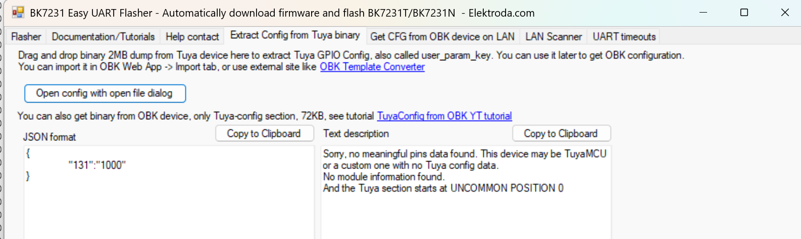

    First. config extraction, maybe it will tell us if your baud is correct:
    https://www.youtube.com/watch?v=WunlqIMAdgw

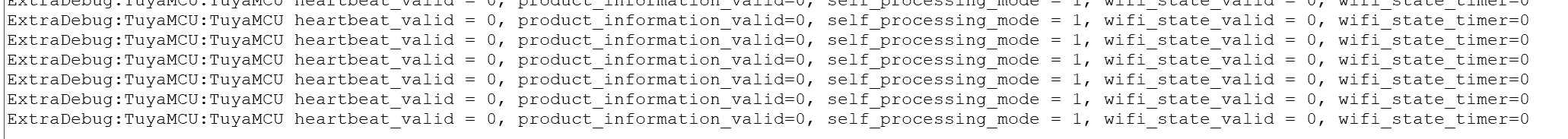

    Second, open web App Log, and check what are TuyaMCU messages saying, are there at least heartbeats received? Is there any communication at all?
    You should also show us inside of your device, so at least we can tell whether your device is using TuyaMCU or not...
    You may have incorrect baud setting.

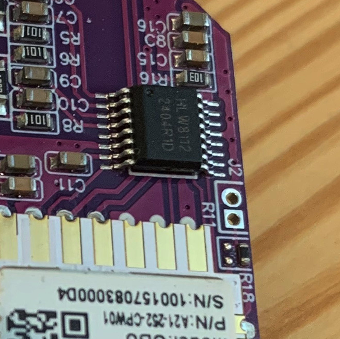

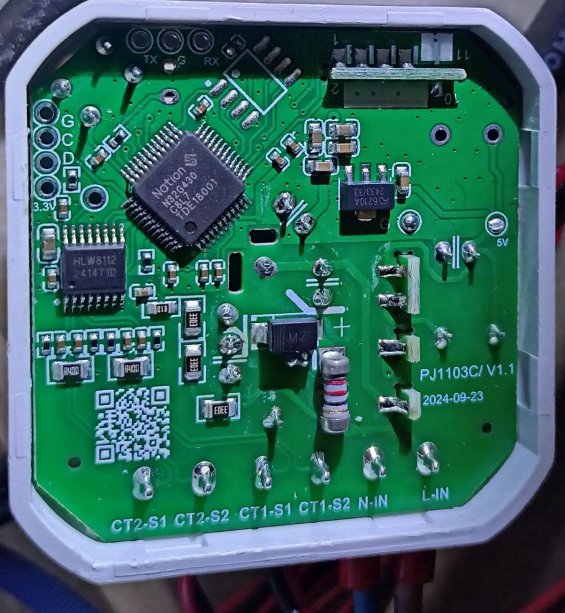

  • Different PJ1103C board and HLW8112 variant
    #34 21377847
    alexan_e

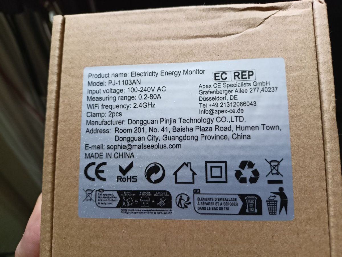

    >>21377652 yes my device uses HLW8112 but internally I see printed PJ1103C/v1.1 2024-09-23
    Close-up of a device's printed circuit board with visible electronic components and markings PJ1103C/v1.1 and date 2024-09-23.
    Looking again at the images of the device posted in the first post of the thread I see that the carton box says PJ1103A and then the internal images have PJ1203 v8 printed.
    In comparison mine has PJ1103AN on the box and PJ1103C/v1.1 on the PCB.
    here is my box (I got it from aliexpress about a month ago)
    Label on a box with information about the electricity energy monitor model PJ-1103AN.
    The PCBs look almost identical with some minor differences in a couple of wire pads. Not sure why this isn't working for you, what does your PCB have as a model?
    Added after 21 [minutes]:
    exotsk, I looked back and found your post here, you have a different device from the one I have. It used HLW8112 but everything else is different so it probably uses different ids and maybe even different baud rate.
  • #35 21377891

    @exotsk if you have a firmware backup from this device we can probably get the TuyaMCU dpIDs
  • TuyaMCU driver settings and baud rate options
    #36 21378054
    exotsk
    Posts: 13
    >>21377741
    hi. My device is https://www.elektroda.com/rtvforum/topic4016609.html#21224768
    is. like a https://www.elektroda.com/rtvforum/topic4016609.html#21212779
    the backup was lost with crashed windows
    startDriver TuyaMCU tuyaMcu_setBaudRate 9600 tuyaMcu_defWiFiState 4
    or 115200 heartbeat valid 0
    Screenshot of TuyaMCU debug code showing settings for WiFi and data processing.
    Screenshot of BK7231 Easy UART Flasher software with a message indicating lack of data.
    • t1.bin (72 KB) You must be logged in to download this attachment.

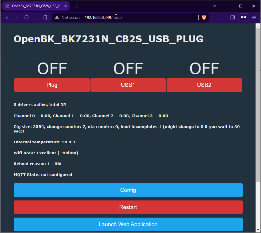

  • #37 21378125
    Posts: 5232
    Help: 449
    Rate: 918
    >>21378054
    please extract the 72kb tuya config file and post here
    Web page of OpenBK7231N device showing USB plug status information.

  • Extracted Tuya calibration and device metadata
    #39 21378170
    Posts: 5232
    Help: 449
    Rate: 918
    OK. those 2 72kb files have no material difference between them, which is fine.
    Not immediately sure how this helps, but this was extracted from them
    which does make it the same as the extract from the previous full firmware posted here https://www.elektroda.com/rtvforum/topic4016609.html#21213563 but there I posted less information- I probably didn't pair it with Tuya before extraction.
    Not sure if this helps though. It's a pain this thread is a mix of TuyaMCU and non-TuyaMCU devices.

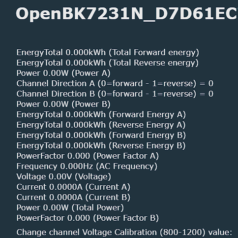

  • Tuya channels 1 and 2 appear unused
    #49 21400668
    alexan_e
    >>21373100
    After further investigation, it appears that Tuya channels 1 and 2 are not in use.
    I was able to extract this information from LocalTuya, indicating that forward_energy_total is 130 and reverse_energy_total is 131.
    101        (code: power.a, value: 0)
    102        (code: direction.a , value: FORWARD, cloud pull)
    103        (code: tbd , value: False, cloud pull)
    104        (code: directions, value: FORWARD, cloud pull)
    105        (code: power_b, value: 0)
    106        (code: energy_forword_a , value: 0)
    107        (code: energy_reverse_a , value: 1665)
    108        (code: energy_forword_b, value: 0)
    109        (code: energy_reserse_b, value: 0)
    110        (code: power_factor, value: 100)
    111        (code: freq, value: 4997)
    112        (code: voltage.a, value: 2319)
    113        (code: current_a , value: 0)
    114        (code: current_b, value: 0)
    115        (code: totaLpower, value: 0)
    116        (code: voltage.coef, value: 996)
    117        (code: current_a_calibration, value: 1000)
    118        (code: power_a_calibration, value: 1000 )
    119        (code: energy_a_calibration_fwd, value: 1000)
    120        (code: coef_a_reset, value: False, cloud pull)
    121        (code: power_factor_b, value: 100)
    122        (code: freq.calibration, value: 1020 )
    123        (code: current_b_calibration, value: 1000)
    124        (code: power_b_calibration, value: 1000)
    125        (code: energy_b_calibration_fwd , value: 1000)
    126        (code: coef_b_reset, value: False, cloud pull)
    127        (code: energy_a_calibration_rev, value: 1000)
    128        (code: energy_b_calibration_rev, value: 1000)
    129        (code: report_rate_control, value: 10)
    130        (code: forward_energy_total, value: 0)
    131        (code: reverse_energy_total, value: 1665)

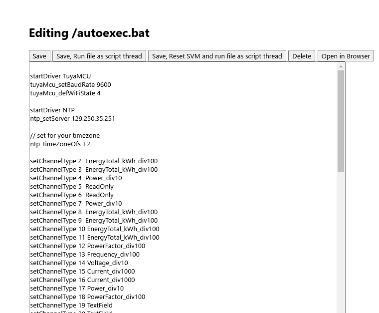

    I have updated the configuration file (autoexec.bat) for PJ-1103A (CB2S+HLW8112)
    startDriver TuyaMCU
    startDriver NTP
    ntp_setServer 129.250.35.251
    // set for your timezone
    ntp_timeZoneOfs +2
    setChannelType 2  EnergyTotal_kWh_div100
    setChannelType 3  EnergyTotal_kWh_div100
    setChannelType 4  Power_div10
    setChannelType 5  ReadOnly
    setChannelType 6  ReadOnly
    setChannelType 7  Power_div10
    setChannelType 8  EnergyTotal_kWh_div100
    setChannelType 9  EnergyTotal_kWh_div100
    setChannelType 10 EnergyTotal_kWh_div100
    setChannelType 11 EnergyTotal_kWh_div100
    setChannelType 12 PowerFactor_div100
    setChannelType 13 Frequency_div100
    setChannelType 14 Voltage_div10
    setChannelType 15 Current_div1000
    setChannelType 16 Current_div1000
    setChannelType 17 Power_div10
    setChannelType 18 PowerFactor_div100
    setChannelType 19 TextField
    setChannelType 20 TextField
    setChannelType 21 TextField
    setChannelType 22 TextField
    setChannelType 23 TextField
    setChannelType 24 TextField
    setChannelType 25 TextField
    setChannelType 26 TextField
    setChannelType 27 TextField
    setChannelType 28 TextField
    setChannelType 29 TextField
    SetChannelLabel  2   "Total Forward energy"
    SetChannelLabel  3   "Total Reverse energy"
    SetChannelLabel  4   "Power A"
    SetChannelLabel  5   "Direction A (0=forward - 1=reverse)"
    SetChannelLabel  6   "Direction B (0=forward - 1=reverse)"
    SetChannelLabel  7   "Power B"
    SetChannelLabel  8   "Forward Energy A"
    SetChannelLabel  9   "Reverse Energy A"
    SetChannelLabel  10  "Forward Energy B"
    SetChannelLabel  11  "Reverse Energy B"
    SetChannelLabel  12  "Power Factor A"
    SetChannelLabel  13  "AC Frequency"
    SetChannelLabel  14  "Voltage"
    SetChannelLabel  15  "Current A"
    SetChannelLabel  16  "Current B"
    SetChannelLabel  17  "Total Power"
    SetChannelLabel  18  "Power Factor B"
    SetChannelLabel  19  "Voltage Calibration (800-1200)"
    SetChannelLabel  20  "Current A Calibration (800-1200)"
    SetChannelLabel  21  "Power A Calibration (800-1200)"
    SetChannelLabel  22  "Energy A Calibration Forward (800-1200)"
    SetChannelLabel  23  "Frequency Calibration (800-1200)"
    SetChannelLabel  24  "Current B Calibration (800-1200)"
    SetChannelLabel  25  "Power B Calibration (800-1200)"
    SetChannelLabel  26  "Energy B Calibration Forward (800-1200)"
    SetChannelLabel  27  "Energy A Calibration Reverse (800-1200)"
    SetChannelLabel  28  "Energy B Calibration Reverse (800-1200)"
    SetChannelLabel  29  "Adjust Reporting Rate (3-60)"
    linkTuyaMCUOutputToChannel 130 2 2
    linkTuyaMCUOutputToChannel 131 2 3
    linkTuyaMCUOutputToChannel 101 2 4
    linkTuyaMCUOutputToChannel 102 2 5
    linkTuyaMCUOutputToChannel 104 2 6
    linkTuyaMCUOutputToChannel 105 2 7
    linkTuyaMCUOutputToChannel 106 2 8
    linkTuyaMCUOutputToChannel 107 2 9
    linkTuyaMCUOutputToChannel 108 2 10
    linkTuyaMCUOutputToChannel 109 2 11
    linkTuyaMCUOutputToChannel 110 2 12
    linkTuyaMCUOutputToChannel 111 2 13
    linkTuyaMCUOutputToChannel 112 2 14
    linkTuyaMCUOutputToChannel 113 2 15
    linkTuyaMCUOutputToChannel 114 2 16
    linkTuyaMCUOutputToChannel 115 2 17
    linkTuyaMCUOutputToChannel 121 2 18
    linkTuyaMCUOutputToChannel 116 2 19
    linkTuyaMCUOutputToChannel 117 2 20
    linkTuyaMCUOutputToChannel 118 2 21
    linkTuyaMCUOutputToChannel 119 2 22
    linkTuyaMCUOutputToChannel 122 2 23
    linkTuyaMCUOutputToChannel 123 2 24
    linkTuyaMCUOutputToChannel 124 2 25
    linkTuyaMCUOutputToChannel 125 2 26
    linkTuyaMCUOutputToChannel 127 2 27
    linkTuyaMCUOutputToChannel 128 2 28
    linkTuyaMCUOutputToChannel 129 2 29
    // do not send to MQTT the following channels
    SetChannelPrivate 19 true
    SetChannelPrivate 20 true
    SetChannelPrivate 21 true
    SetChannelPrivate 22 true
    SetChannelPrivate 23 true
    SetChannelPrivate 24 true
    SetChannelPrivate 25 true
    SetChannelPrivate 26 true
    SetChannelPrivate 27 true
    SetChannelPrivate 28 true
    SetChannelPrivate 29 true
    // you can use these to force initial configuration values
    //SetChannel 19 1000
    //SetChannel 20 1000
    //SetChannel 21 1000
    //SetChannel 22 1000
    //SetChannel 23 1000
    //SetChannel 24 1000
    //SetChannel 25 1000
    //SetChannel 26 1000
    //SetChannel 27 1000
    //SetChannel 28 1000
    //SetChannel 29 10
    PowerSave 1
    I'm still not sure about the following channels and how we can use them
    I’m encountering another issue: the only input type I found that works for setting the calibration values is the TextField type, but it only functions on the web interface page. The TextField type is not published to MQTT, even after removing the SetChannelPrivate setting.
    I’m trying to publish the calibration values so they can be adjusted in Home Assistant. Any ideas on how to resolve this issue? We need an input type that can handle values up to 1200, so a dimmer type won’t work.

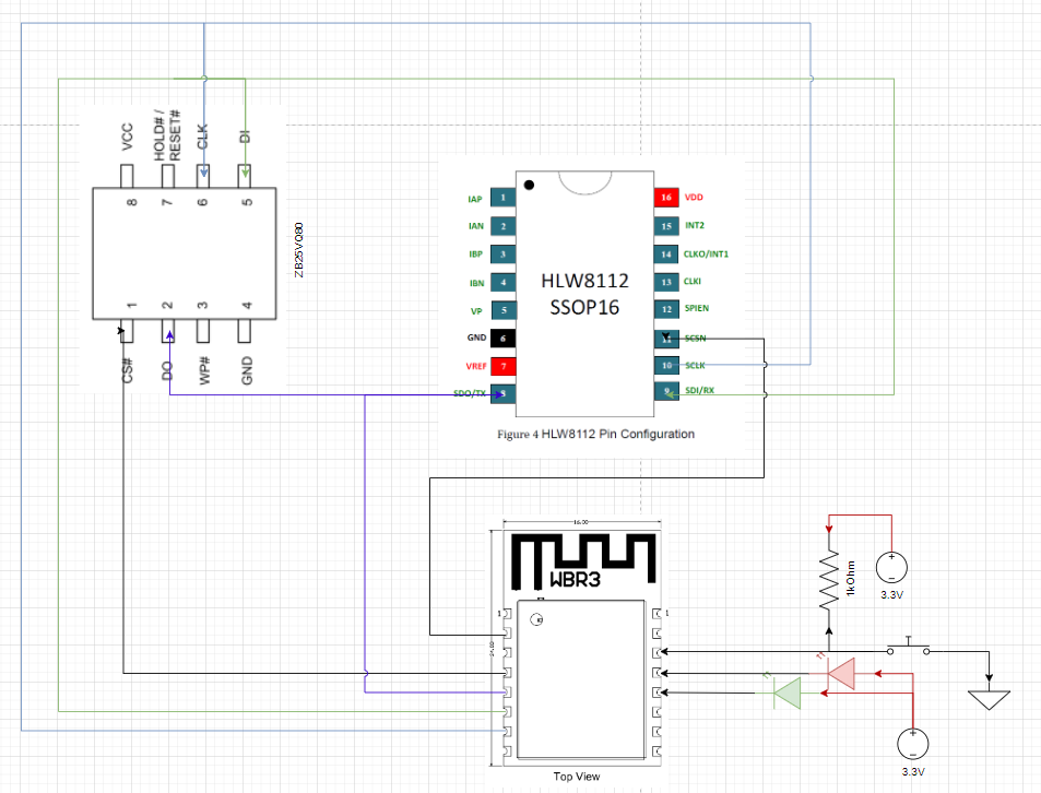

    fcol95
    >>21221637 hello dicamarques! any progress on the hlw8112 driver? i've got a PC311-W-TY energy meter that also has it, but connected to a WBR3 chip on my side.
    Circuit diagram with HLW8112 and WBR3 components.

  • 120A version needs matching firmware dump
    #52 21608416
    booskiboomkin
    [postid:32ba670f72][/postid:32ba670f72] I have exactly the same model, the 2ch version however mine stopped working - I couldn't reset the device and get it to pair with WiFi.
    I've downloaded and flashed the firmware you included here and it now works again however the power and current calibration is way, way off. Even setting the calibration in the settings doesn't even get me close.
    Is there something I can modify in the firmware before flashing to fix that?
    Added after 4 [minutes]:
    Please provide dump - trying to fix faulty unit with corrupt firmware.
    https://www.aliexpress.com/item/1005007288504....order_list.order_list_main.42.21ef1802ZdW589
    This is the version I have - 120A - might explain why firmware above failed.
    My firmware attached - doesn't allow for reset to connect to WiFi - LED stays off.

    #60 21712696
    marschr
    taktlos wrote:
    Jailbreaking procedure:
    1. Easy as can be done with OTA method so follow instructions from tuya-cloudcutter project and flash OpenBeken-v1.17.262_bk7231n.ug.bin firmware with profile tuya-generic-pj-1103a-energy-meter.
    Is this section tested for real? The device PCB image shows a N32G430 MCU but the file mentioned here is for a BK7231n, I'm skeptical that this would brick the device, can someone confirm?
Discussion about the Tuya WiFi energy meter PJ-1103A/PJ1103C based on BK7231N/CB2S, later also BK7238/T1-M variants, focusing on firmware flashing, TuyaMCU integration, and reverse engineering of the metering path. Early attempts used TuyaMCU commands and dpID mapping for voltage, current, power, frequency, power factor, and energy totals, but some units did not respond as expected. The hardware was identified across different revisions as either BL0942-based or HLW8112-based, with several users confirming that some boards use an external TuyaMCU/N32G430 MCU while others appear to connect the HLW8112 directly to the WiFi module. The thread evolved into driver development for HLW8112 SPI mode, extraction of Tuya configuration and calibration data from flash dumps, and troubleshooting of incorrect readings, missing AP/reset behavior, and protocol mismatches. Later posts confirmed working OpenBeken setups for some PJ1103C boards using TuyaMCU with UART commands and periodic state queries, while other board revisions still required new driver support or parsing of non-Tuya plaintext debug output from the MCU.
