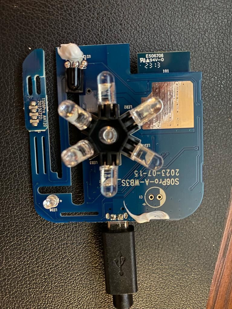

  • Need help identifying IR transmitter and receiver pins
    #1 20828706
    brianroy86
    Posts: 31
    Close-up of a circuit board with electronic components. A circuit board of an electronic device with several LED lights and a connected USB cable.
    Hi all,
    I have a S08Pro that I got on aliexpress for like $3. I have cracked it open and was able to use cloud cutter to install the esphome kickstarter on it. I got the temp and humidity sensors working, but I need some assistance with the IR transmitter and receiver. I'm not sure which pins to use, could someone take a look and let me know? Hopefully we can get this added as a cc profile for future users as well.
    My current ESPHome yaml below.

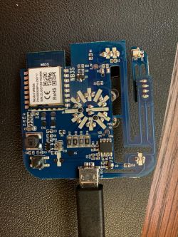

    Is there anything else I can provide to help get this to be a supported model with ESPHome? If not, is there documentation on how I can move from ESPHome to OpenBeken? I wasn't able to just grab the bin file from the releases and upload it to the ESPHome web UI.

  • Working ESPHome yaml for Tuya IR blaster S08Pro
    #4 21131413
    cmuki
    Hello all!
    After dedicating a lot of time of trying to get IR Remote for OpenBK to work, I couldn't do it and gave up.
    Yesterday I stumbled upon this post and managed to get everything working - temperature, humidity and IR (I'm using it for a Daikin AC).
    Here's the content of my yaml after the wifi configuration - it's an amalgamation of several posts and yamls I found on the internet as well as the AC component. Don't forget to add the tuya component.

    remote_transmitter:
      pin: 26 # from IRSend line
      carrier_duty_percent: 50%
    remote_receiver:
      pin:
        number: 8
        inverted: True # from IRRecv line
      dump: all
    status_led:
      pin: 9 # from LED 0 line
