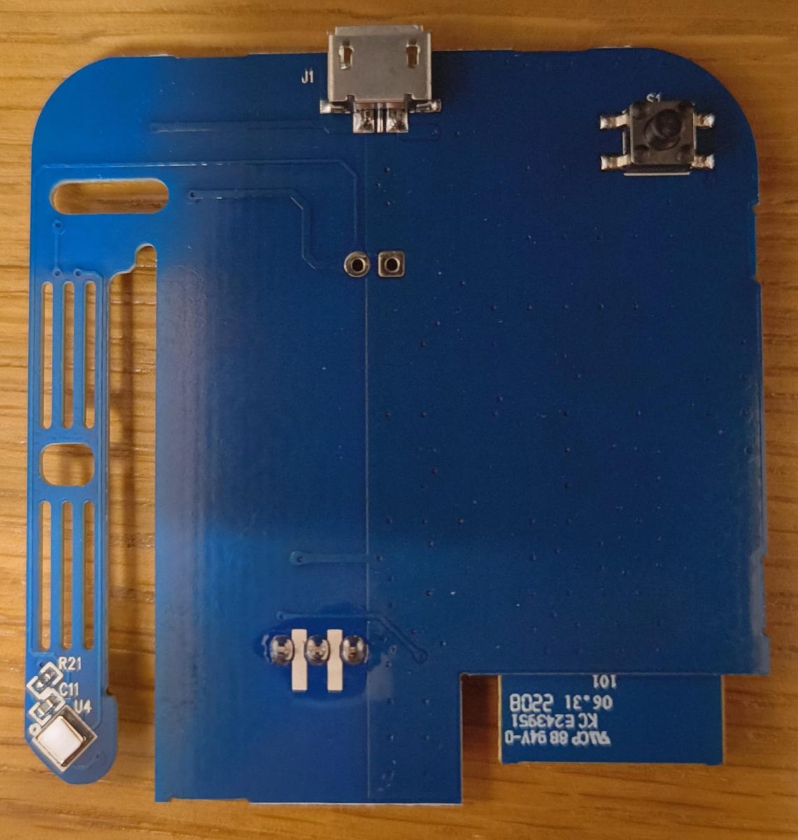

  • Teardown of the S06Pro WB3S IR blaster sold on eBay, often mislabeled as Zigbee despite a real Zigbee version existing.
  • The board exposes solder points clearly enough to use, and software replacement required several tries by shorting the top-left contact to GND.
  • Alternative software now runs, but it still lacks the IR resources needed for full functionality.

    Sold on Ebay quite often falsely marked as Zigbee (there is also a real Zigbee version)
    Teardown IR Blaster S06Pro WB3S Teardown IR Blaster S06Pro WB3S
    Solder points easily visible an usable. Replacing software took a few attempts with shorting the top left contact to GND.
    Now the alternative software is running but I seem to be missing the IR resources...

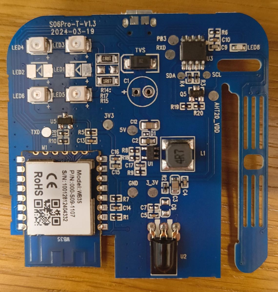

    Hi, just got an S06Pro from AliExpress.
    Its full name is S06Pro-T-V1.3 dated on board to 2024-03-19 and looks like this:
    PCB of the S06Pro model, version S06Pro-T-V1.3 PCB board with blue laminate featuring micro USB port and soldering pads.
    It is different from the images posted on this post's head.
    Looking at this tutorial video: https://www.youtube.com/watch?v=KU0tDwtjfjw (from https://openbekeniot.github.io/webapp/devicesList.html ), they solder directly to the WB3S module, while on this post (and also on my board) there are dedicated (?) solder pads. Which should I use?
    Also, on the images above, the micro usb is also connected - does it need to be connected in parallel?
    Thanks!

    If it were mine I would solder all directly to the WB3S contacts and use the 5V USB for power - common ground with USB-TTL and S06.
    The TuyaMCU might get in the way, hampering your efforts, so you may have to sever either RX or TX between the WB3S and TuyaMCU. This could be a trace cut or an MCU leg lift.
  • #13 21344438
    Posts: 14743
    Rate: 12839
    This WB3S has only side rows of pads soldered, so it could even be easily removed from the board by using our tricky method shown here:
    but that's as a last resort, first just try flashing in-circuit...
    I will do just that. So from the USB-TTL I will take only the GND, RX and TX.
    Not sure I fully understand what you wrote here, but let's see first if the first approach fails.

    So at the end I soldered to the pads as my soldering skills are so-so. Anyway, Using latest version of the BK7231 flasher (BK7231GUIFlashTool-v5), I done first a backup and then flashed. It ended up with a crc error. Looking at the site for the crc what to do section, I stupidly changed the chip type to BK7231N. Since that moment I cannot put the device in boot mode. It has a reset button on the bottom of the PCB that a long click on it worked on the intents described above. There was also a blue led blinking that now is not. Have I bricked the device? Any advice what to do to try to fix it?
    Thanks in advance!
    EDIT
    I shortcut the CEN leg with GND and it worked like a charm :) (using BK7231T of course...) not sure why the CRC error happened earlier.
