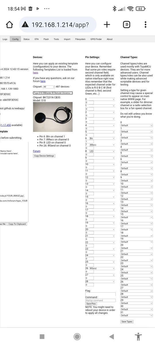

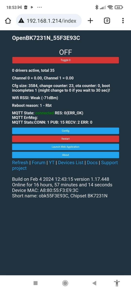

    I uploaded OpenBK, set up the I/O according to the ready-made configuration from OpenBK, configured MQTT and connected to HA.

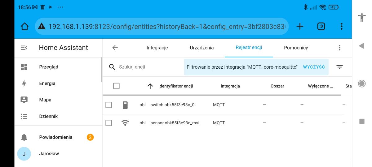

    Well here I have a problem. The HA shows 2 entities from this device (a button and I think WiFi), but nothing related to IR. Did I miss something during the configuration? How can I control the IR transmitter at all?
    I want to control a Samsung tv and a Yamaha receiver. On the original sofet I could control these devices without a problem. I'm guessing that you need to have the remote control button codes - ok, but how do you receive them? Any commands? Currently the console does not show anything related to IR.

    OpenBK7231N interface screen showing connection status and device information.
    Configuration interface of Smart Home device Tuya S18 with pin settings and channel types.
    Screenshot of the Home Assistant interface showing a list of MQTT entities.

    that you need to have the remote control button codes - ok, but how to receive them?
    Such remote controls have learning functions, but with your changes I would look in open databases such as https://www.remotecentral.com/cgi-bin/codes/ or in open code libraries from e.g. Linux' Rasberry or Arduino for IR communication.

    Okay, so the codes are there. Now how to send them via HA to the device via IR with OpenBeken?
    IR should be visible in entities or not necessarily ?
