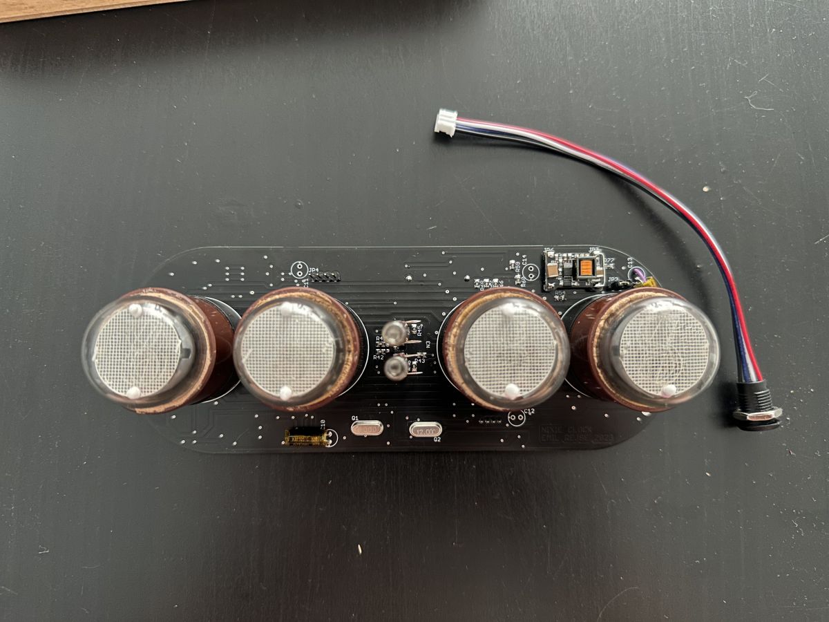

  • Hello forum users,

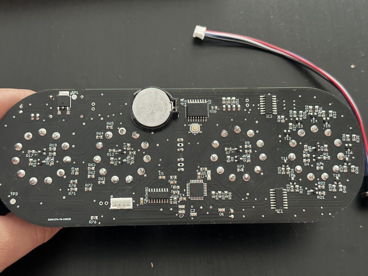

    I present the finished design of a watch based on IN-1 + INS-1 tubes
    Four IN-1 Nixie tubes on a black circuit board display numbers with a illuminated colon, device sits on a table.
    The project assumed the greatest possible compactness of the control electronics while using the most common elements.
    So I decided on a surface mount project, using the DS3231 as a real time clock, the watch code is contained in the ATmega328 present on the PCB as an integrated Arduino UNO, hence the presence of the CH340G on board and the possibility of programming at any time via the USB C port, which also serves as power.
    The tubes are controlled by two multiplexing 74HC595 registers connected to MMBTA42 and MMBTA92 transistors.
    The 170 V boost converter is a ready-made system purchased from our friends from the east.
    On the board, in the possible need for development, there are 3 free Arduino ports that can be used as inputs/outputs (buttons, alarm clock buzzer, etc.)
    The colon, of course, serves as the second hand.
    Four IN-1 tubes mounted on a black PCB, with a connected cable ending in a plug. Clock controller printed circuit board with SMD components and a battery, held in hand.
    The shape of the printed circuit board was created with the intention of making a watch case, but the woodwork is still ahead of me. :)
    What do you think? I'm interested in your opinions. :)

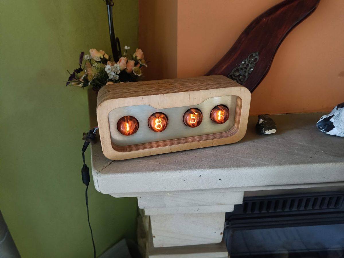

    The project was successful, but since it will be in a wooden housing, compactness was probably not that important.
    Personally, I would choose a clock on vertical lamps, similar to this one, but with an enclosed bottom. link

    Such a pretty tile that it's a shame to hide it. :)
    How is the time set? Because it's the only inconvenience when we still have the summer/winter time change. DS3231 has a very small deviation. I have two of these and they have been shining for 14 years.
    That's right, you can make a transparent casing or (if the heat exchange allows) pour a transparent resin.

    It was important because the housing is neither deep nor wide, more or less I see it as if you wrapped the presented circuit around, leaving the tube lenses outside the housing. The colleague above showed something similar and I'm going in that direction, but I still want to reduce it.
    Vertical lamps are not my taste at all, but everyone has their own taste ;)
    PCB as PCB, the Chinese from JBC did a good job ;)
    I update the RTC if necessary by simply uploading the code.
    The watch is still able to work with the Arduino IDE via USB.
    Reports as UNO.
    And I bought a nice USB C socket with a nut for the housing on a short cable.
    I will make a round hole and install. I use the same socket to power the entire system and program it.
    I have 3 free I/O released on goldpins, so you could add some "+" "-" and "ok" to the code to set it manually.
    It's still a long way to October. Connecting the watch to the computer for 10 seconds is nothing terrible. That was my assumption.
    Transparent would be nice, but it won't match anything on my desk.
    Flooding is not an option, because just like the whole thing does not heat up at all, the step-up already emits something there. I wouldn't want to risk it.
