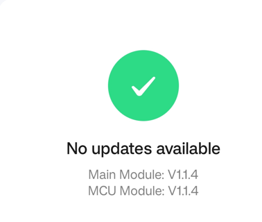

    Firmware detection
    Well, I needed to install the Tuya App to find the firmware. As always, it is quite easy, just run the app as guest mode, connect the device, and recover the firmware information.
    Software update window with a green check mark symbol.
    In this case, the main module and MCE are running version 1.1.4

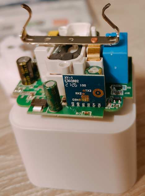

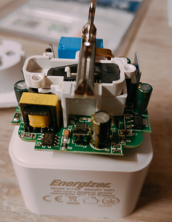

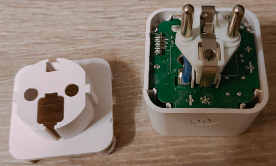

    As we all know by now, no physical dismantling is needed anymore, thanks to the beautiful work from the creators of "tuya-cloudcutter", but being me and curious as always, I opened the smart socket. This is quite easy, just pry around the casing going to each corner, and pop out the cover. It should go without damaging the socket.
    Once opened, this is what you get:
    Disassembled smart Wi-Fi plug with exposed interior and circuit board.
    Here are a few more close-ups:
    Close-up of the interior of an Energizer Smart WiFi socket after opening the casing.
    Interior of a Wi-Fi smart socket with visible circuit board and electronic components.

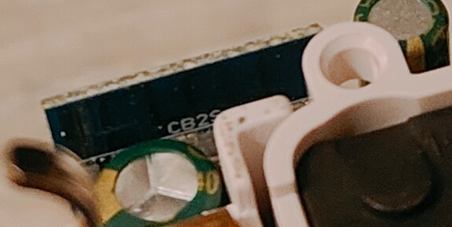

    The final close-up showing the board marking
    Close-up of the CB2S module marking on a circuit board
    In this case, a CB2S, meaning a BK7231N-based device.

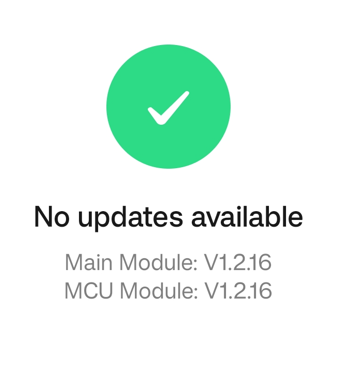

    Firmware:
    I added this blub and retrieved the firmware version, in this case, V1.2.16. Spoiler alert: so did all the other lights.
    Message indicating no updates available for modules version 1.2.16.
    And again, happy flashing here, fired up the rig, started HA automation, and waited for the result.

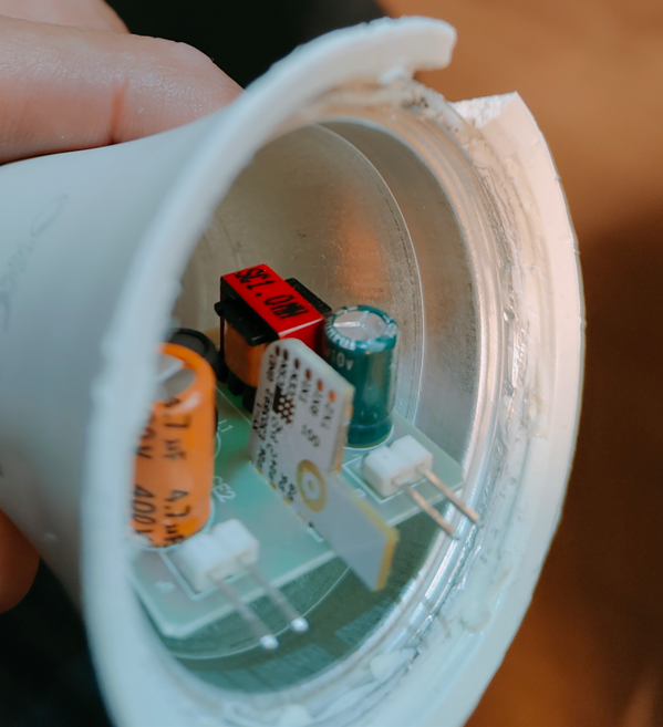

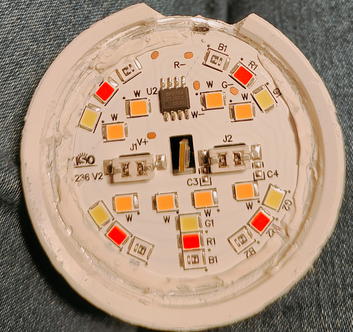

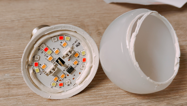

    Again, the flashing went like a breeze. No problems at all. But here comes the fun part. I didn't know which electronics were used on the inside. So now, it was time to dismantle the device. I could have fiddled around with the pins, but for a 3,99 euro device, I concluded I could sacrifice one. Ultimately, the casing opened easily, and the damage was not too bad. So, put a hobby knife between the socket and the plastic dome space and go round and round. It should pop off, and there is some caulking you can take off.
    Hood popped off:
    Close-up of an open smart LED bulb with visible diodes and control chip.

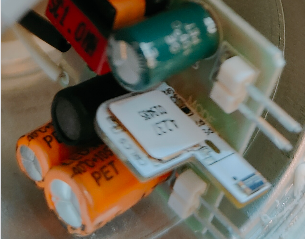

    You must pry a screwdriver on the side (for me, there was a tiny indent where I could pry the screwdriver in) and carefully try to pop the circuit board out. The more caulking you remove, the easier it will pop out.

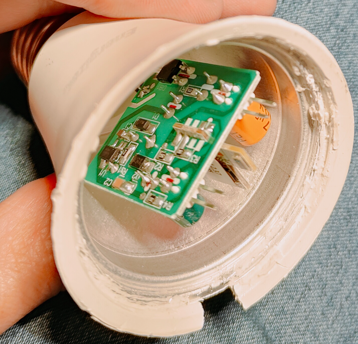

    Inside electronics:
    Close-up of the internal electronics of a smart LED bulb.
    Another angle (you can see the damage on the top):
    Close-up of the inside of a smart LED bulb.
    Another closeup reveals that only four pins are soldered (3,3V, GND, and two PWM's)
    Close-up of the interior of an LED bulb, showing a green circuit board with electronic components.
    The final one, revealing the BP5758, is the controlling chip and the last info I needed:
    Close-up of a circuit board with electronics and LED diodes, visible BP5758 chip.
    So, I put everything back together and put some superglue between the casing and the hood.
    No damage is visible besides the little piece of plastic that broke off.

    The pins are connected in the following way:
    P6 -> BP5758D_DAT, Channel 0
    P9 -> BP5758D_CLK, Channel 1
    LED ordering
    R=2
    G=0
    B=1
    C=3
    W=4
    Spoiler alert: The same goes for the GU10 and E14 lights.

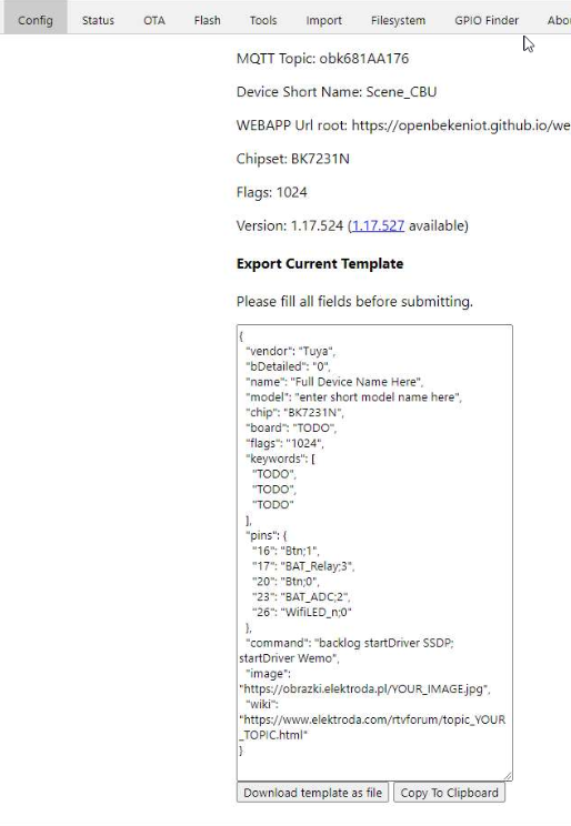

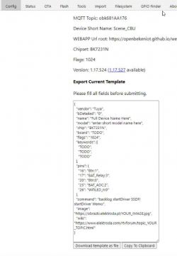

    #9 21026911
    Posts: 5216
    Help: 448
    Rate: 917
    please copy out config text from each device into a text editor then add product names/board/keywords/model and the url to this thread. choose an image address relevant for each product. keywords need not be repeated words from elsewhere in text block. paste each here as JSON from the syntax drop-down menu :)
    config is in the web app gui under config tab
    Screenshot showing the configuration tab in a web application, displaying a sample configuration JSON.
    example complete:
