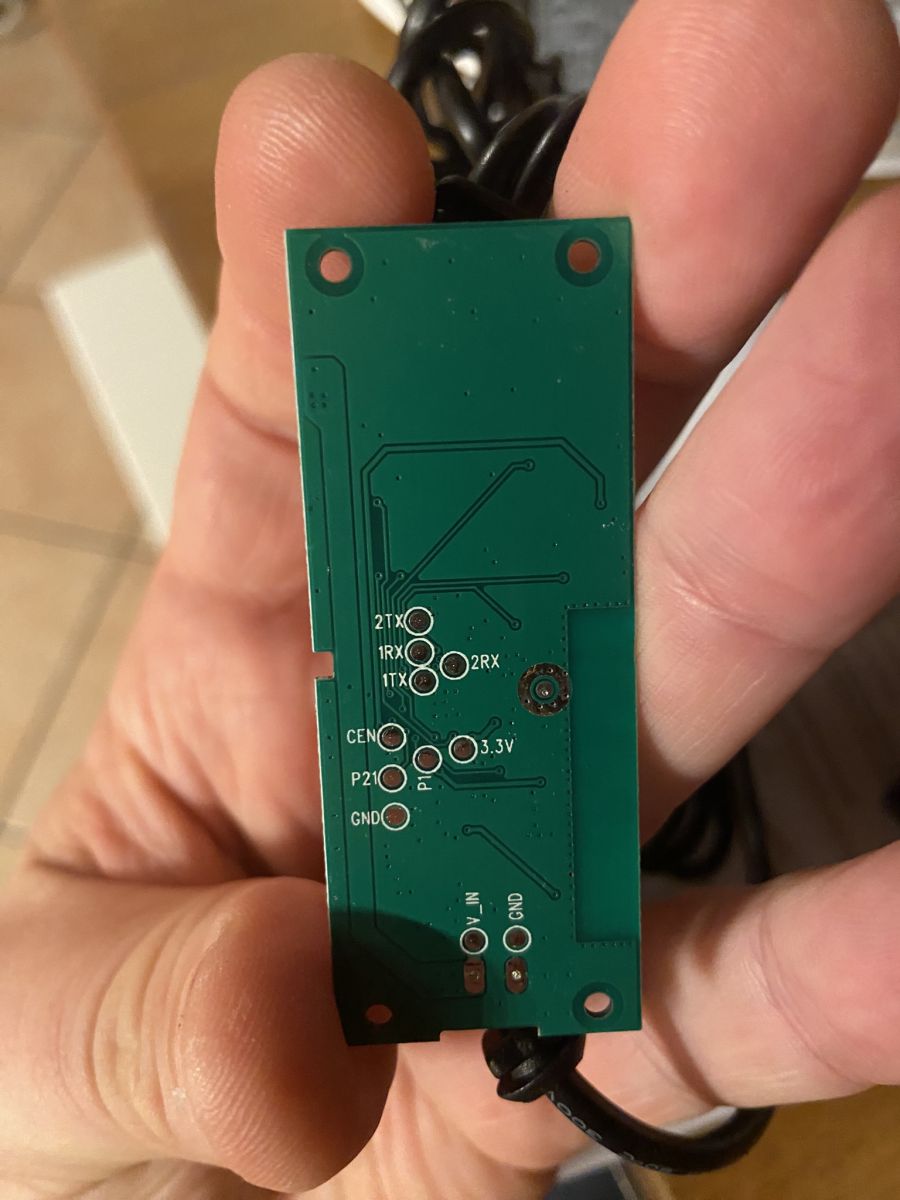

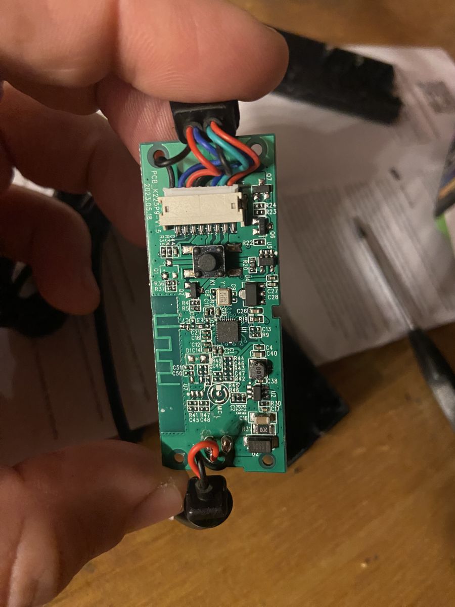

    I recently bought the same Neon LED Strip from Action as the one discussed there: https://www.elektroda.com/rtvforum/topic4083817.html
    However, my version of this strip is based on BK7231N, not LN882H.
    Here are a few pictures of the tear-down:
    [BK7231N] Configuring LSC Neon LED Strip with BK7231N Chip from Action Store
    I started fiddling around with OBK and its different tools. I ended up with the following configuration:
