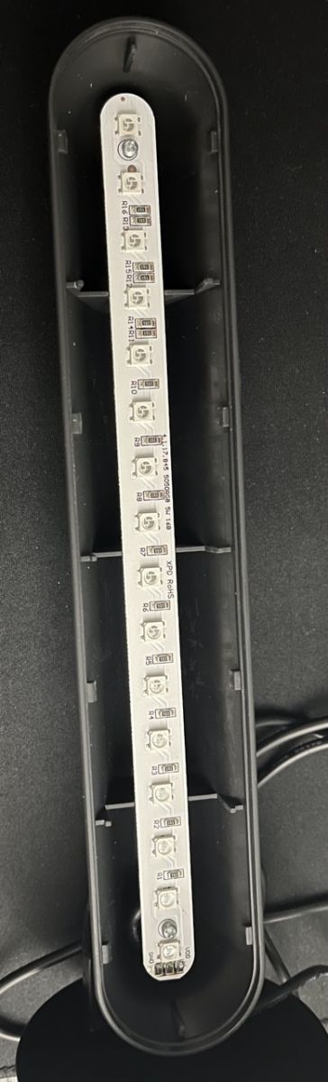

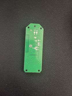

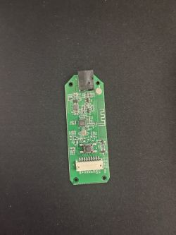

    I bought this LSC Battletron LED bar at Action for 13€, it has a BK7231N (https://www.action.com/fr-fr/p/3202651/barre-led-de-gaming-battletron-razer-chroma/)
    I successfully flashed OpenBK on it but I can't figure out how to configure the GPIO, I tried some pins but it didn't work.
    I attach some images of the inside and a backup of the original firmware.
    Thank you.
    Electronic printed circuit board with components on a black background. Image of the interior PCB of the Battletron LED strip. LED strip inside a casing with visible diodes and electronic components.

    I have extracted data from flash and it may shed some light:
    Text interpretation:
    - Microphone (TODO) on P23
    - IR Receiver is on P26
    - SPI MISOmiso
    - SPI MOSImosi
    - Control Pin (TODO) on P6
    Device seems to be using CBU module, which is using BK7231N.
    This means this it has some addressable LEDs, we have a WIP driver for that, but it's not finished. Would you like to try it out? It may not work correctly for your kind of LEDs. Are those ws2812b?

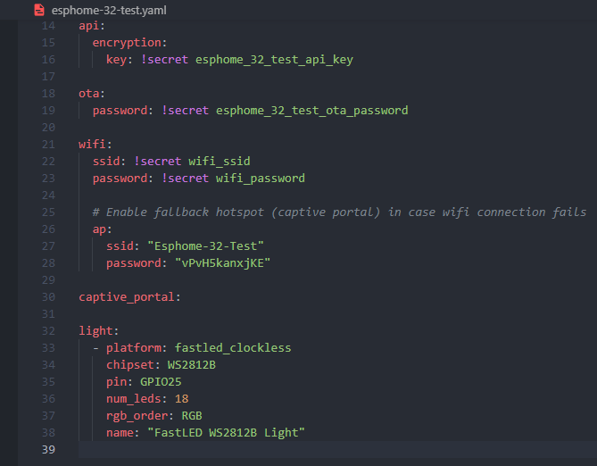

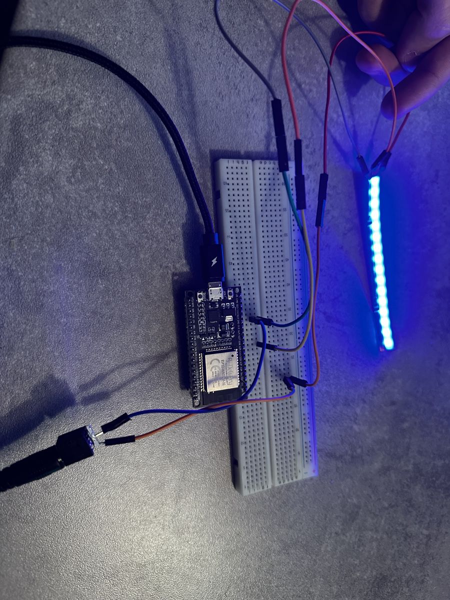

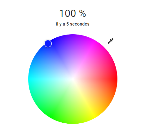

  • #7 20869106
    eliovital9
    I confirm that it works well with the WS2812B chipset. I cut a section of my LED strip that I managed to control via ESPHome. ESPHome configuration file with settings for WS2812B LED strip. Breadboard with connected ESPHome and a blue-lit WS2812B LED strip. Color wheel with a gradient and dropper icon.

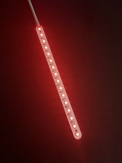

    figurant17
    I tried too with an ESP and WLED and it's working well.
    LED strip emitting red light on a dark background.
  • #9 20869249
    Posts: 14768
    Rate: 12911
    Ok, good news, so I just need to get WS2812B running on OBK
