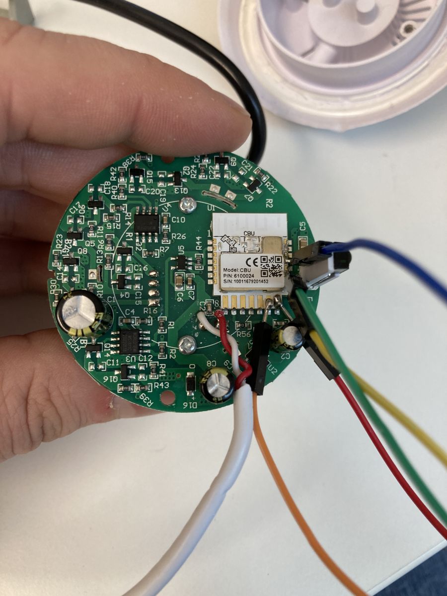

    Hi there,
    I have recently bought a cheap Battletron Multicolor Lightball from Action, and what a surprise, it is based on a Tuya CBU:
    https://www.action.com/de-at/p/3202652/battletron-gaming-lichtkugel-razer-chroma/
    So I gave it a go, flashing it with OpenBK which went fine. The soldering before was the bigger challenge. Unfortunately, the flasher was not able to decrypt the backup because it found no key. I don't know if I did something wrong there, but I'll post the Firmware Backup here as reference.
    Battletron lighting PCB with soldered wires.
    The problem I now have is that I don't know how to address the LEDs.
    The two ICs on the board seem to be WS2811c controllers: https://cdn-shop.adafruit.com/datasheets/WS2811.pdf
    The data in of the upper controller is connected to Pin 2 (Symbol P16) of the CBU. The data out of the first WS2811c is connected to the data in of the second one, kind of daisy-chained together.
    The IR Receiver is connected to Pin 9 (Symbol P7).
    Any hints on how I can get that to work?

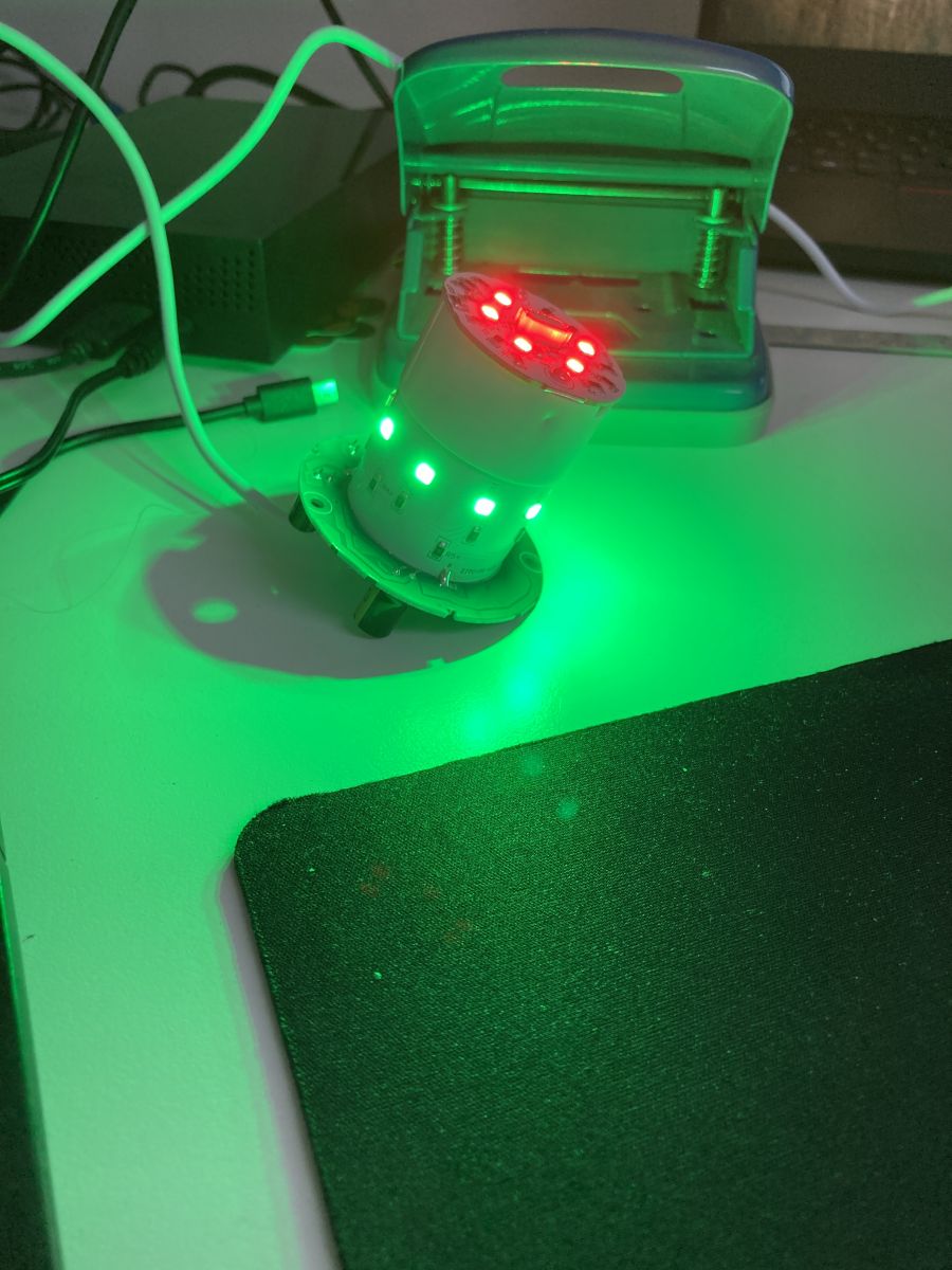

    Okay, I played around a bit with the code I have found here:
    https://www.elektroda.com/rtvforum/topic3968310.html#20709852
    I can get the LEDs to work with:
    startDriver SM16703P
    SM16703P_Init 2
    SM16703P_SetPixel 0 255 0 0
    SM16703P_SetPixel 1 0 255 0
    SM16703P_Start
    Device with LEDs glowing red and green.

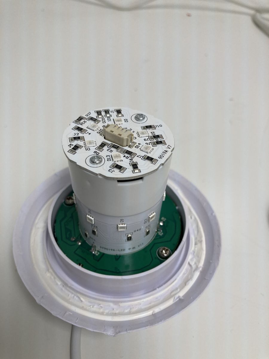

    It seems that the first driver feeds the nine outer LEDs, while the second one feeds the six LEDs on top.
    It seems that they cannot be addressed individually, which makes sense regarding the fact that there is a cable with five lines going to the top.
    Nevertheless, they light up but setting the color is rather unreliable, not giving the color entered or not updating the color.

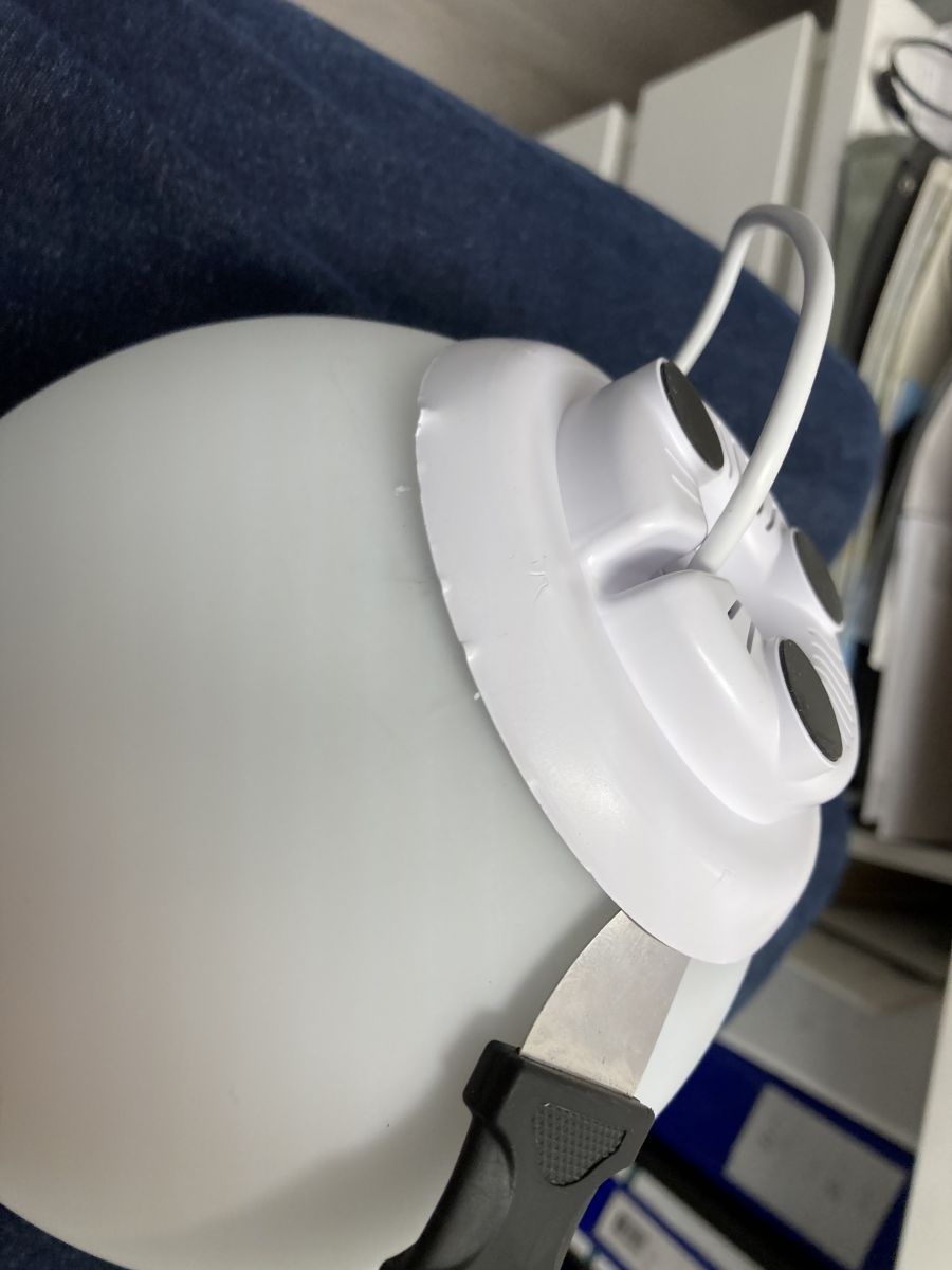

    bjoerns
    Posts: 7
    Opening this thing is really a pain.
    The base and the glass bulb are glued together with some silicone-based glue which is so heat resistant that warming it up with a hotgun may melt the plastic but does not weaken the glue.
    I've gone around the gap between the base and the glass bulb with a cutter and then used a spudger and a wide screwdriver to pry between the two parts. So I could weaken the glue to a point where both parts are separated.
    But you must be careful not to damage the glass.

  • #6 20948993
    dingsundbums
    Posts: 10
    Oh my.
    That's indeed a pain.
    And breaking the glass was exactly my concern :)

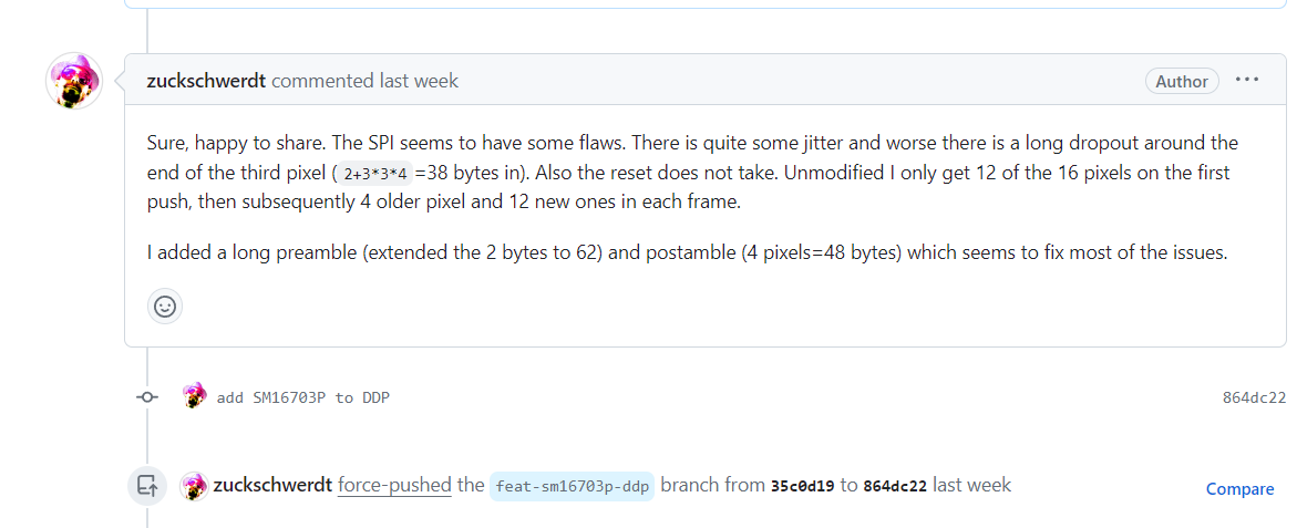

    Posts: 14770
    Rate: 12911
    Someone on Github had idea how to improve stability:
    Screenshot from a discussion thread on a code repository platform, featuring a comment by user zurkschwerdt about SPI issues.
    I've asked him to make PR with his changes but there was no reply since then, so maybe I will try to make this change myself and let you guys try. Any testing and help is welcome.

    #10 20967153
    Posts: 14770
    Rate: 12911
    @bjoerns The SPI DMA driver bug has been fixed. The SM16703P/WS2812B/etc LEDs should work good now. Please update your devices. For scripting configuration, please see:
