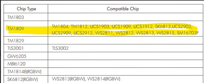

    I do believe the SM16703P driver is expected to work on SM16703P, WS2812B and then some other WS strips. Do you know what type yours is?
    ref: https://www.elektroda.com/rtvforum/topic4036716.html
    my question here to elektrodabot came from the fact that this controller here groups all these strips into one compatibility bracket:
    Compatibility table of chip types with LED strips.
    Assuming that's an accurate list of strip types that can be expected to behave correctly, perhaps yours is not one of those in that list
    also, OpenBeken has no support for microphones

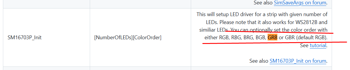

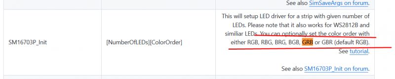

    @User0815 One thing about autoexec, you can edit color order with the following command in autoexec
    startDriver SM16703P
    //SM16703P_Init <number of LED's> <color order>
    SM16703P_Init 196 GRB
  • #5 21353005
    Posts: 14770
    Rate: 12911
    Or maybe he just need to do that?
    Screenshot of LED driver setup instructions.
    My German is a bit rusty...

    >>21353005 ah. forgot the simple thing of strip colour order!

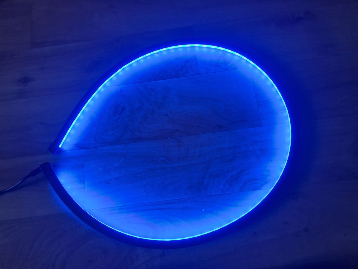

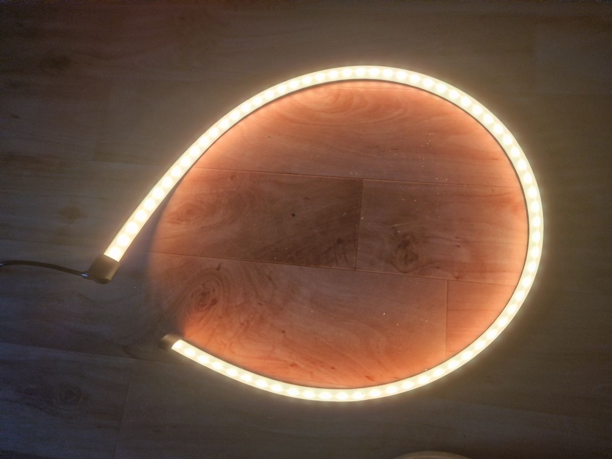

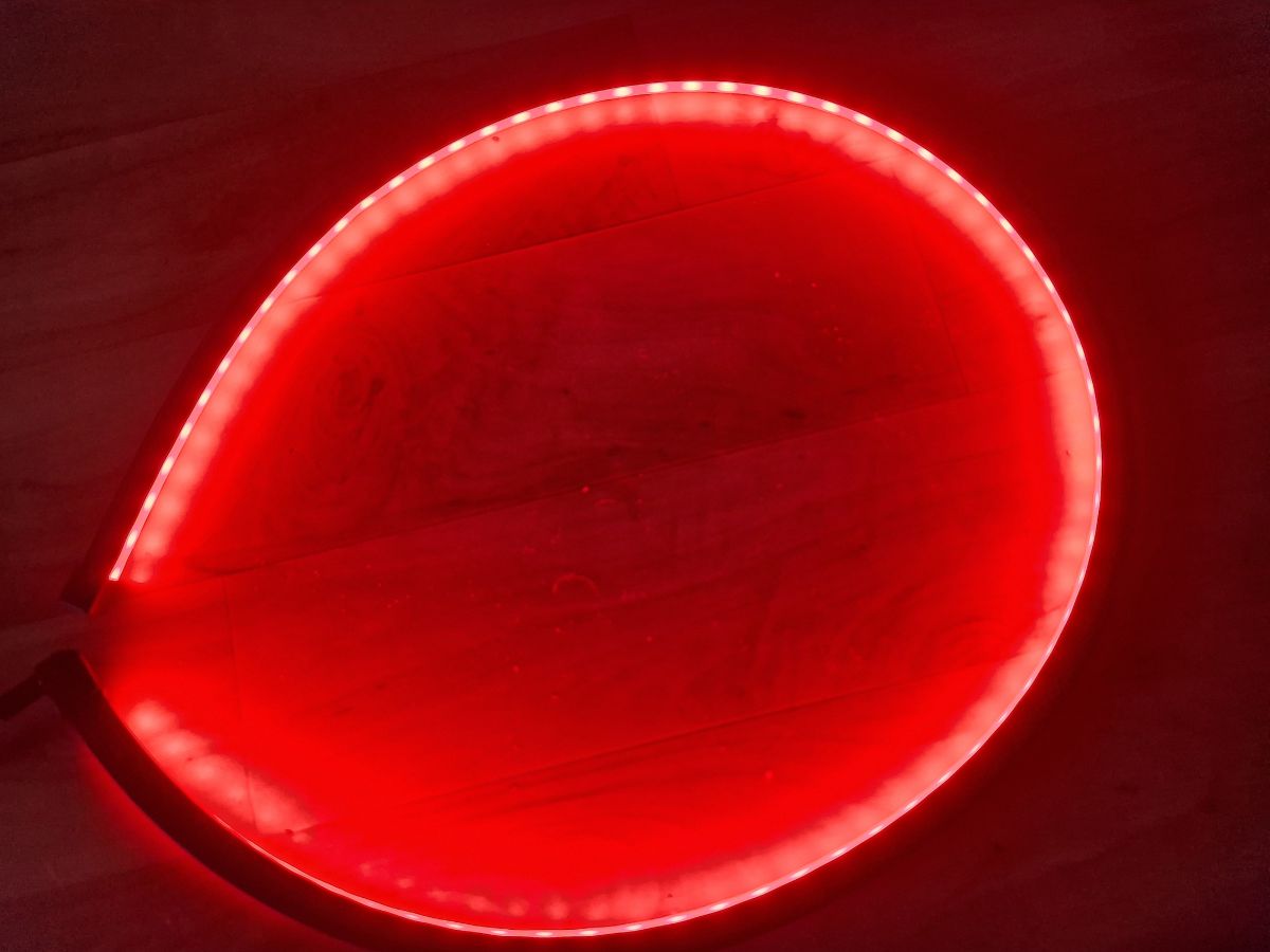

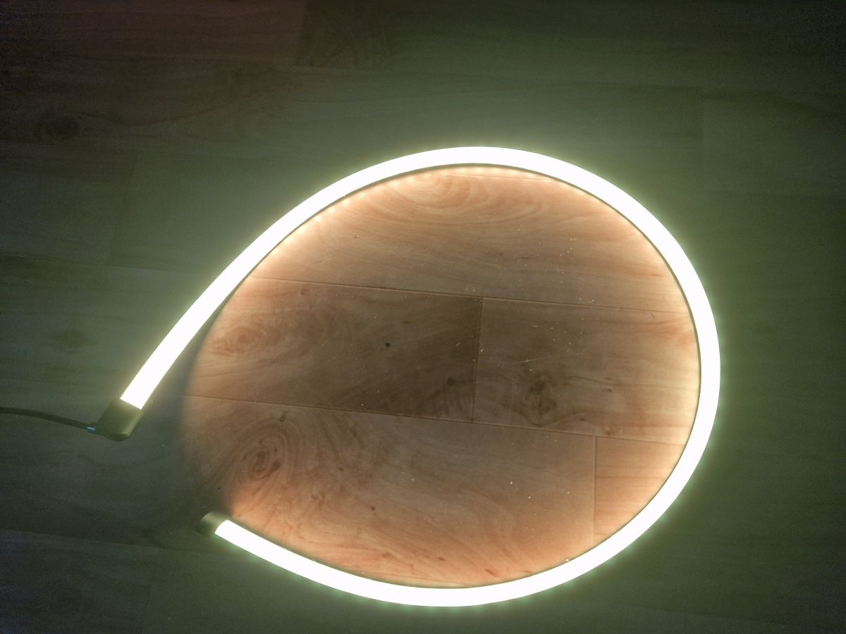

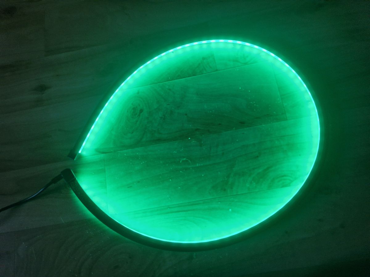

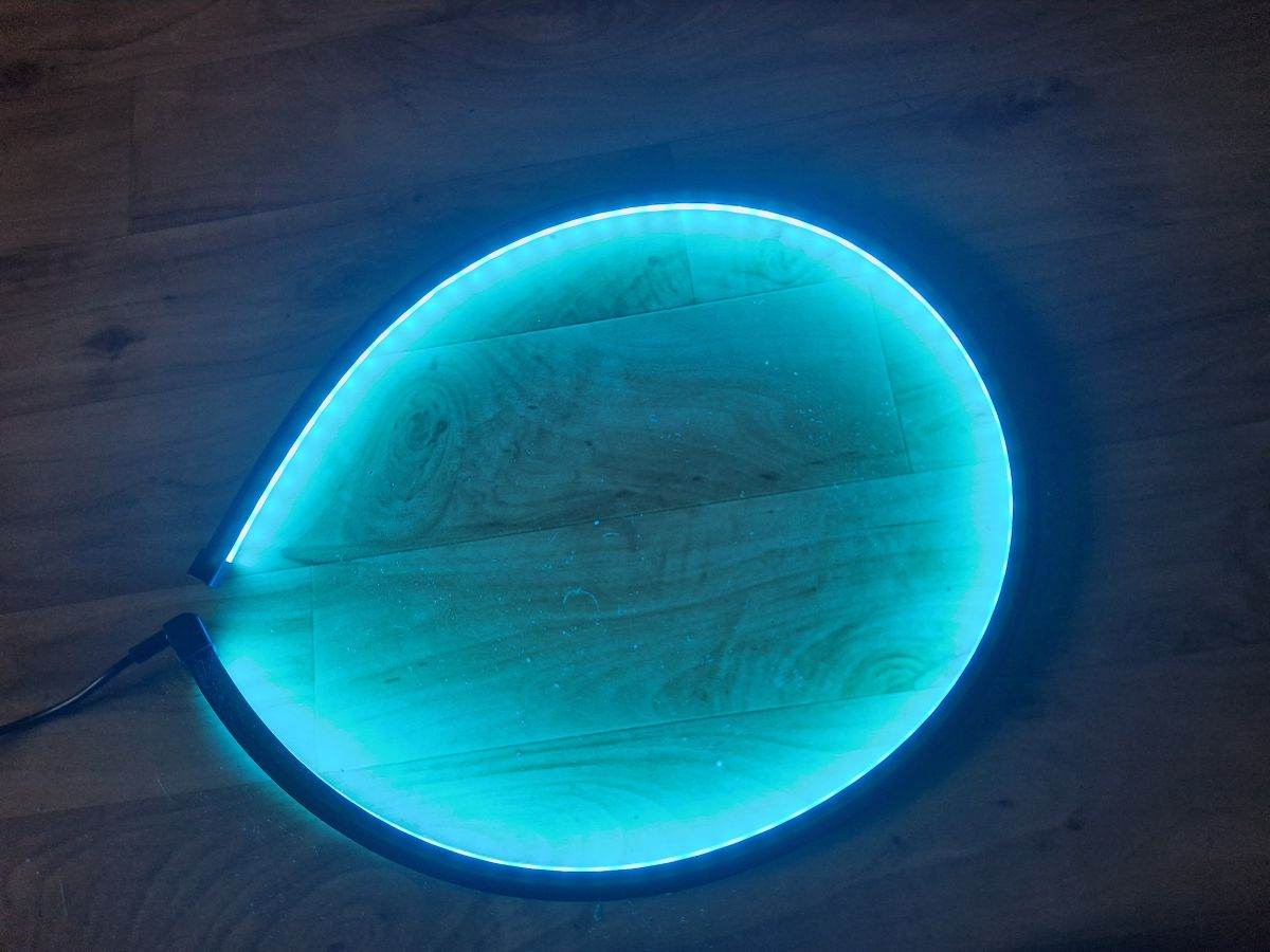

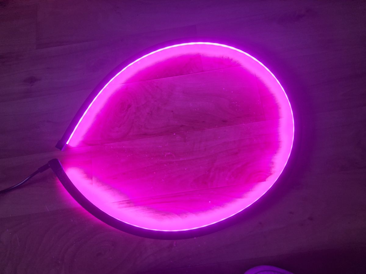

    Hallo,
    ich habe die Farbenreihenfolge jetzt hinbekommen, bis auf warm und kalt weiß, per Schieberegler.
    Pins sind folgende:
    Pin 6:  PWM           3
    Pin 7:  PWM           1
    Pin 8:  AlwaysHigh    0
    Pin 16: SM16703P_DIN  0
    Pin 28: Btn_NextColor 0
    Hier ist die Konfiguration der autoexec.bat, die ich verwende.
    backlog startDriver WEMO; startDriver SSDP
    Hier noch die Fotos, bei den Fotos von Gelb und Orange, nicht wunder es sieht aus wie weiß, ist aber die passende Farbe.
    Red LED strip arranged in a teardrop shape.
    A pink LED strip light on the floor. Semi-circular blue LED strip on a wooden floor. Illuminated LED strip emitting light blue light on a floor. Green LED strip in an arc shape on a wooden floor. Circular glowing LED strip on a wooden floor. An LED strip in an arc shape emitting warm white light.
