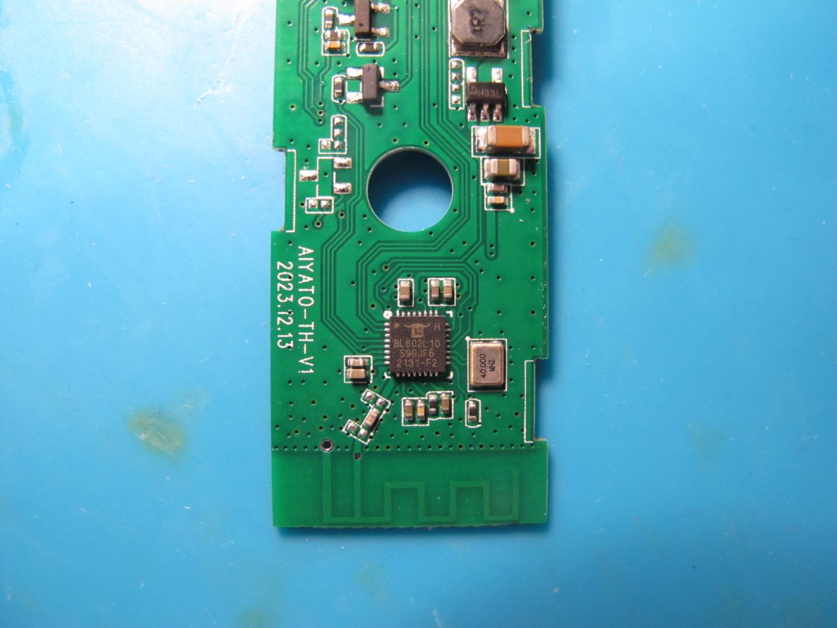

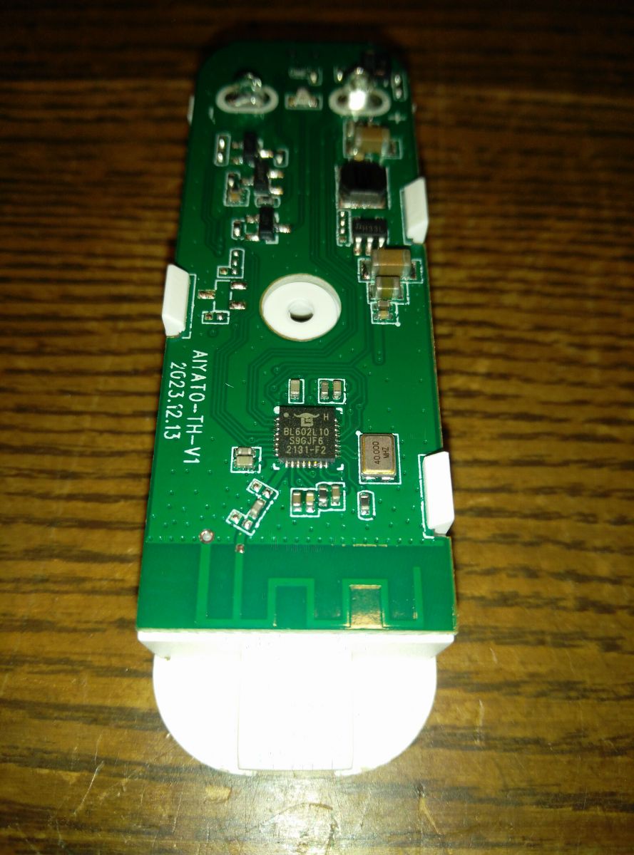

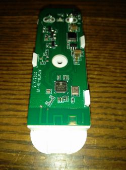

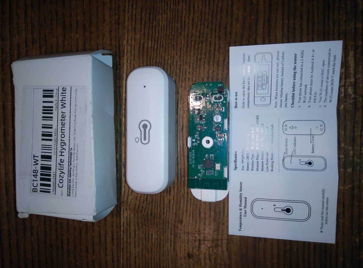

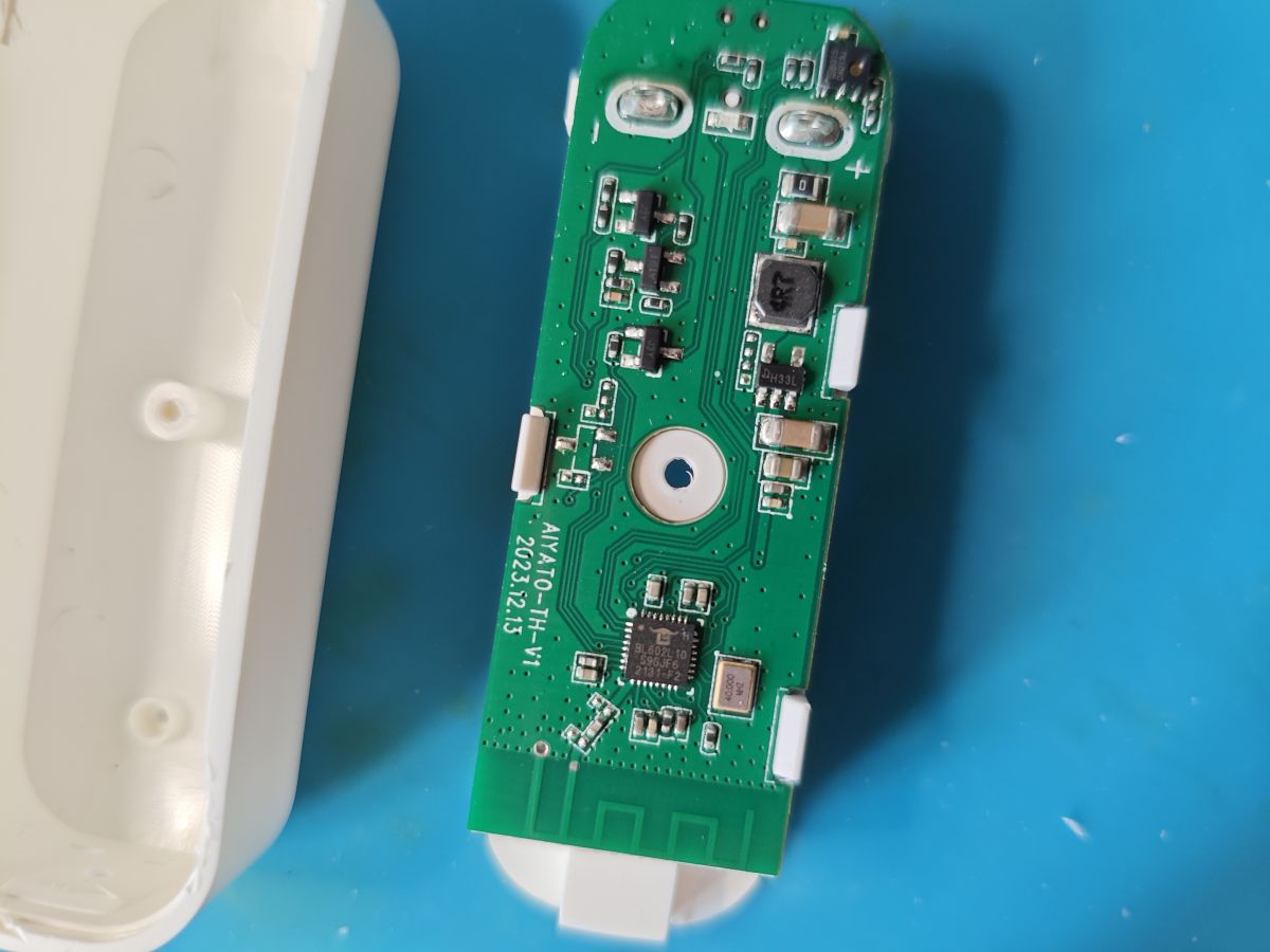

    Electronic board with a BL602L10 chip on a wooden surface.
    The image shows a set including a white Cozylife hygrometer, its circuit board, and a user manual placed on a wooden table. Printed circuit board with visible electronic components.
    This has BL602L10 chip and unfortunately I did not find any OpenBK instructions for this device. As chip naming suggests it has only 1MB Flash. BL602L10 is L=Light, 1 = 1MB.
    So I am not sure if I am able to flash it at all, however some people have managed to do this like here
    https://www.elektroda.com/rtvforum/topic4039068.html
    Also does OpenBK flashing software not support this chip. For this u need BLDevCube.exe from
    https://github.com/bouffalolab/bl_iot_sdk (use: tools/flash_tool)

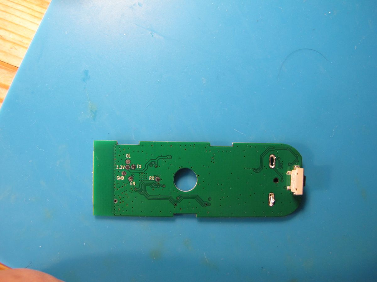

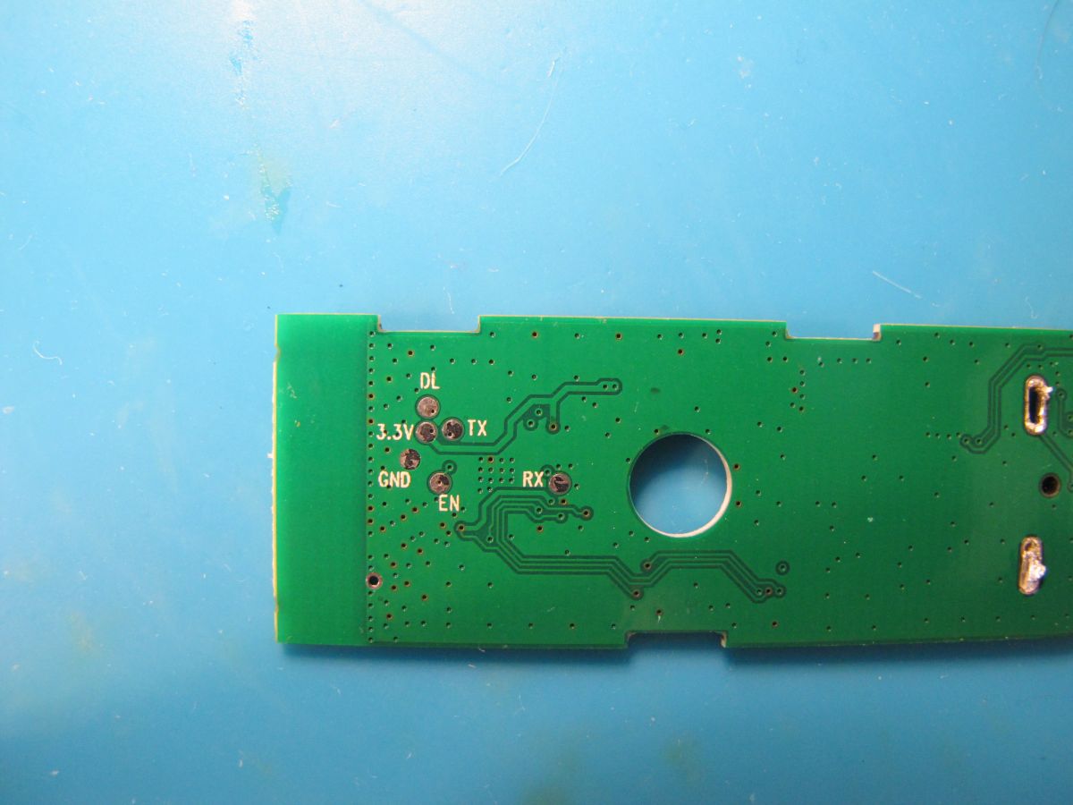

    For soldering u need to get access backside of board. Soldering battery terminals will probably melt your device case so best option will be with just a little help of solder iron try prying it open just a enough to get access for wires.
    [url=https://obrazki.elektroda.pl/1670641000_1729195987.jpg]Interior of a plastic case with a visible section of a circuit board featuring pin labels.

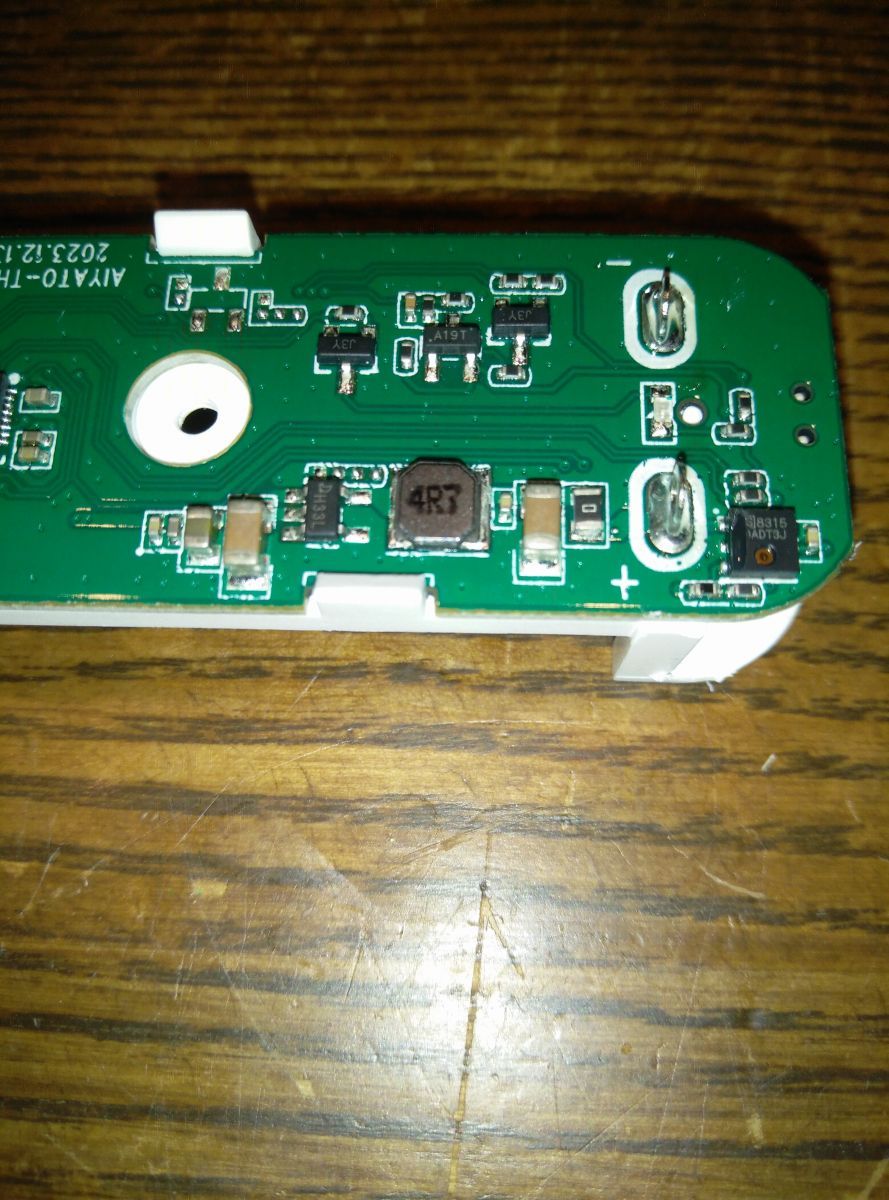

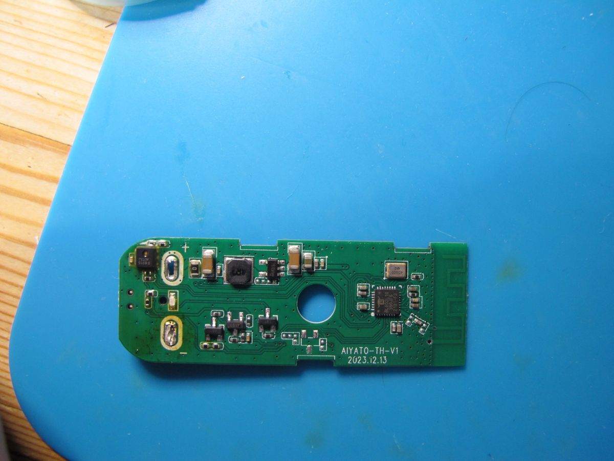

    I notice this image posted is just the thumb link with no link to full size. Confirms Senyslink CHT8315 presence.
    Circuit board with electronic components on a wooden background.

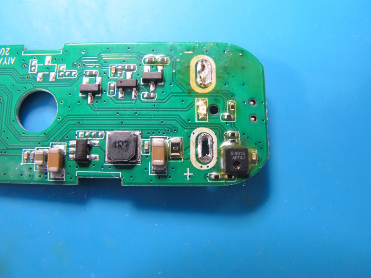

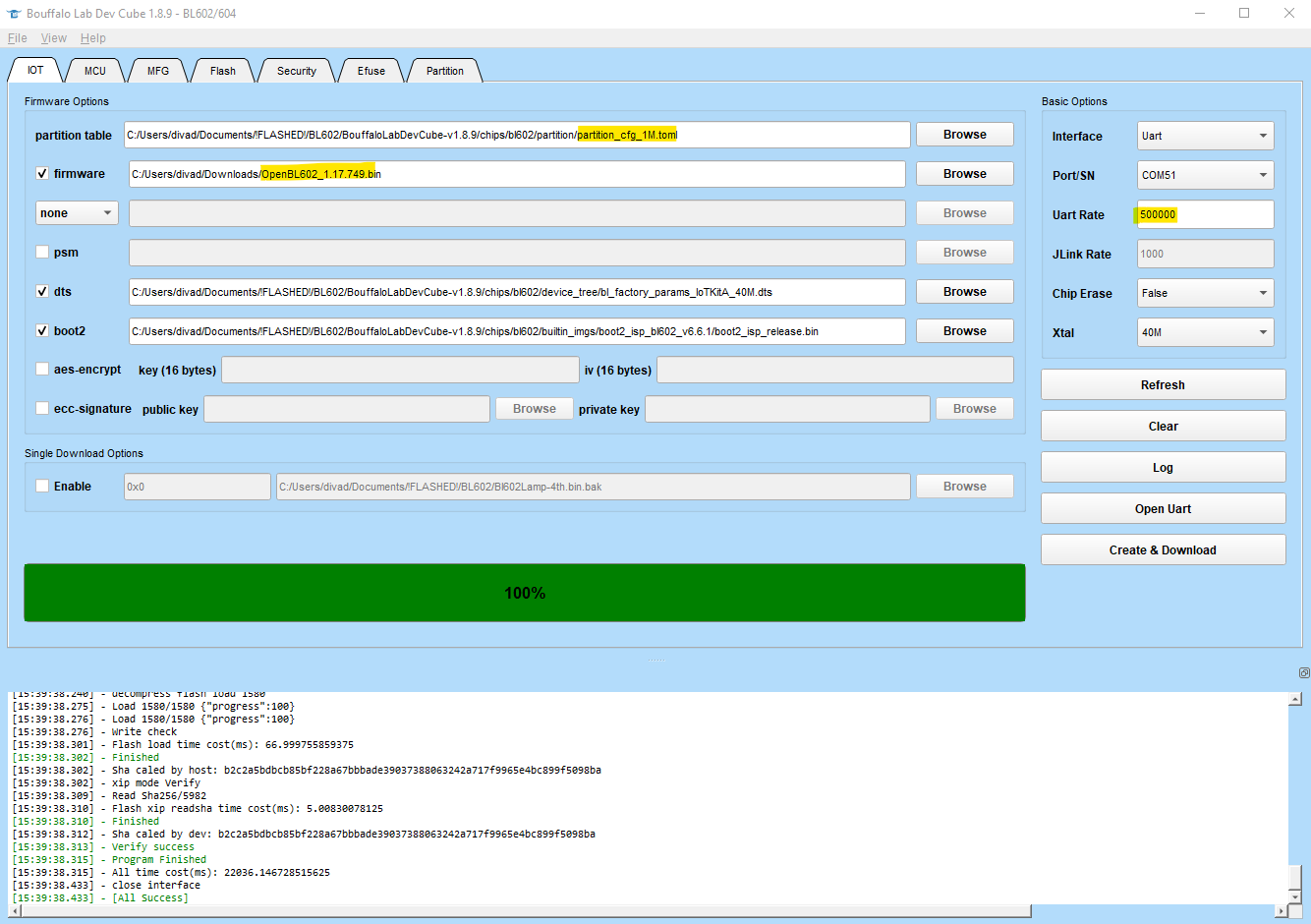

    Mine has arrived. Just gonna add some random pics and bits of info as I work my way with this device.
    Printed circuit board with BL602 chip and other electronic components. Close-up of a circuit board with various electronic components. Printed circuit board with pin labels DL, 3.3V, TX, RX, GND, and EN on a green background. Printed circuit board with connection labels: DL, 3.3V, TX, GND, EN, RX. Printed circuit board with various electronic components on a blue background.
    Added after 38 [minutes]:
    unpaired boot log from RX-labelled test pad - 2000000 baud
    Added after 54 [minutes]:

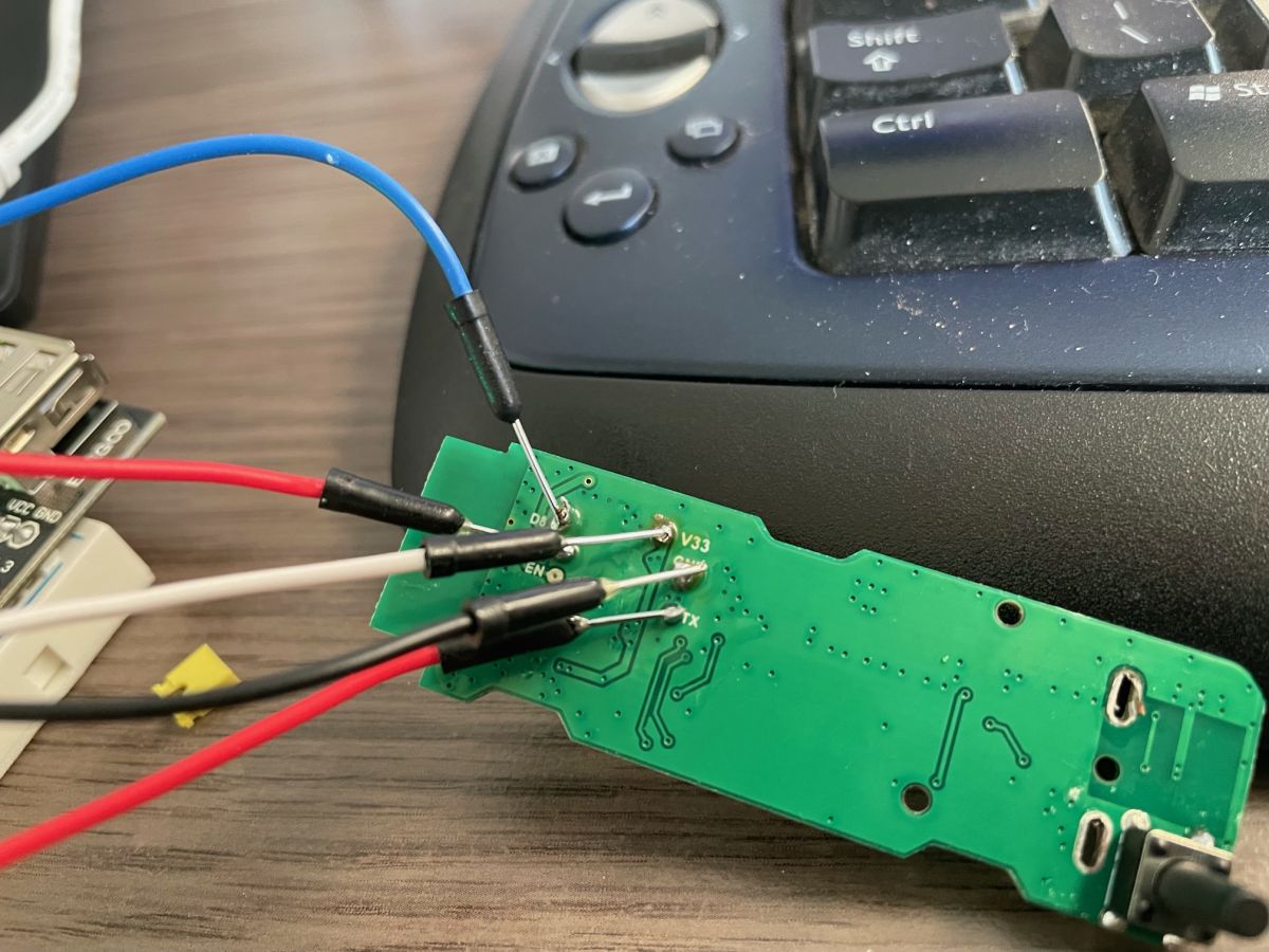

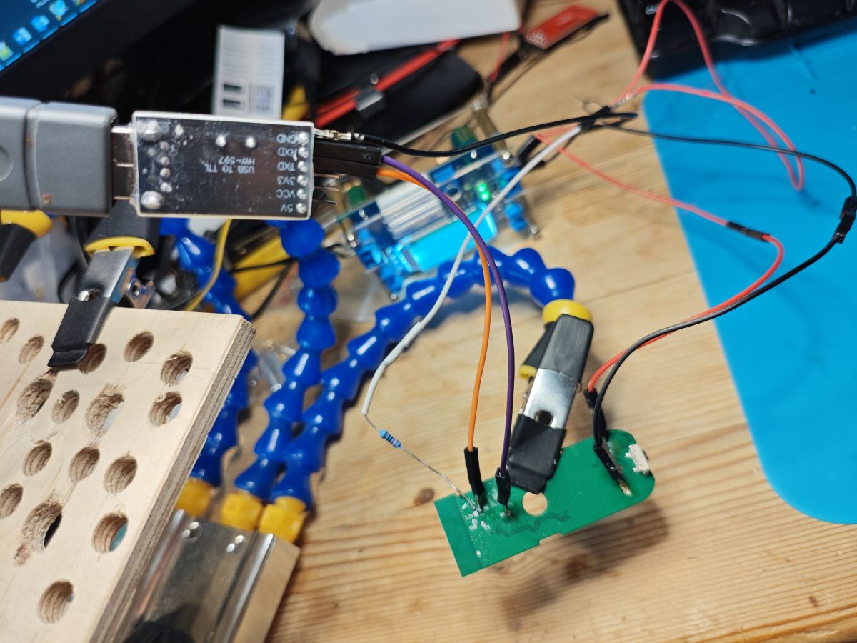

    The pads on this device are labelled as to where they're to connect to, not where they're connected from on the BL602.
    soldered up as follows:
    RX pad -> USB-TTL RX
    TX pad -> USB-TTL TX
    DL pad -> 10k ohm resistor -> 3.3v PSU
    VCC battery contact -> 3.3v PSU
    GND battery contact -> PSU negative
    USB-TTL/PSU/IoT device share common ground.

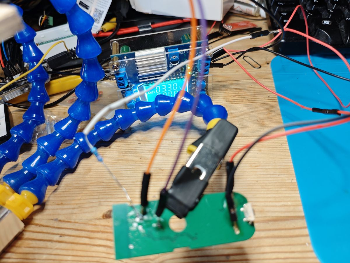

    Compact BL602 device connected to an external 3.3V power supply on a desk. USB-TTL module connected to a circuit board

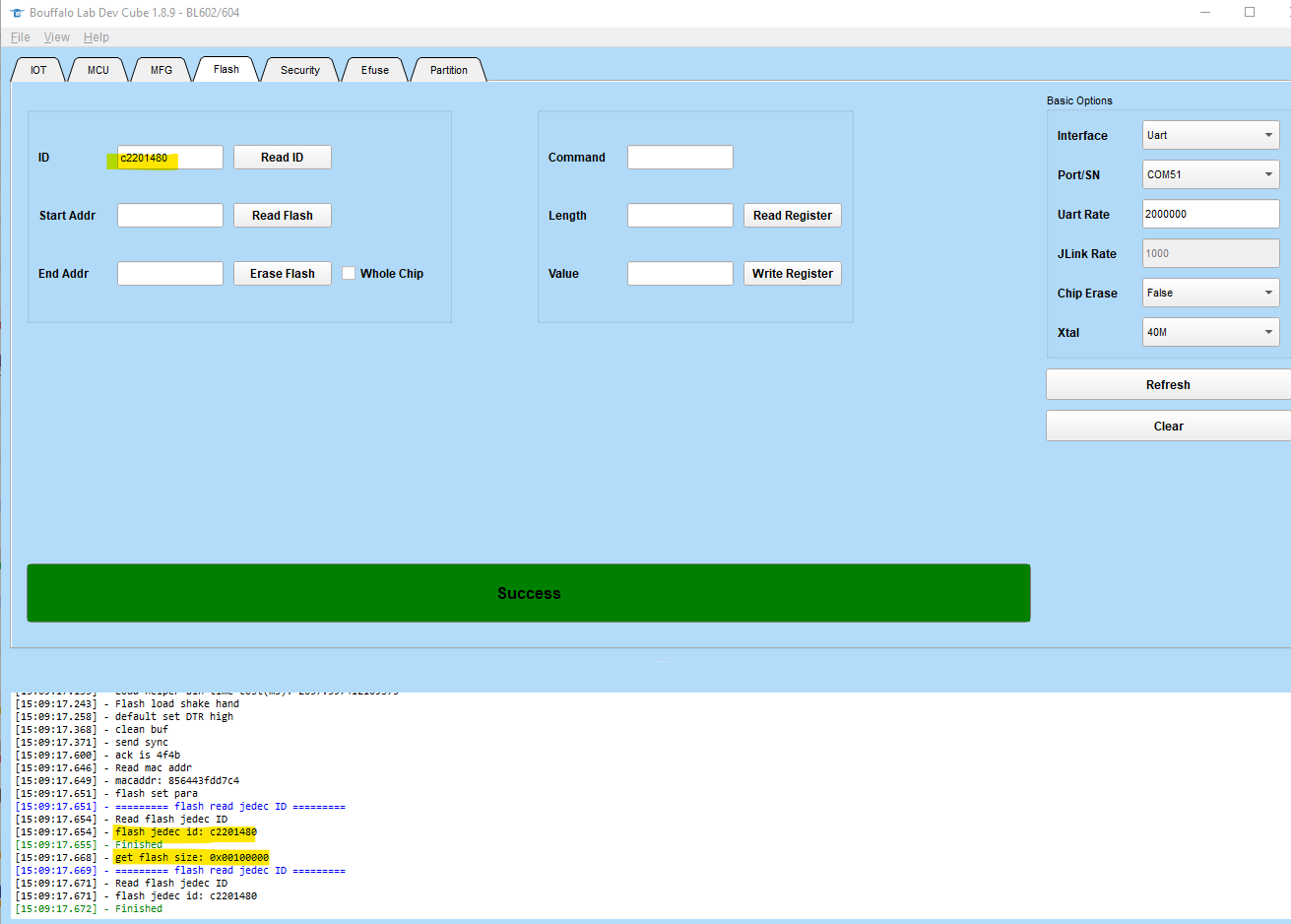

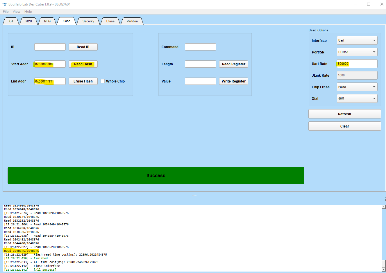

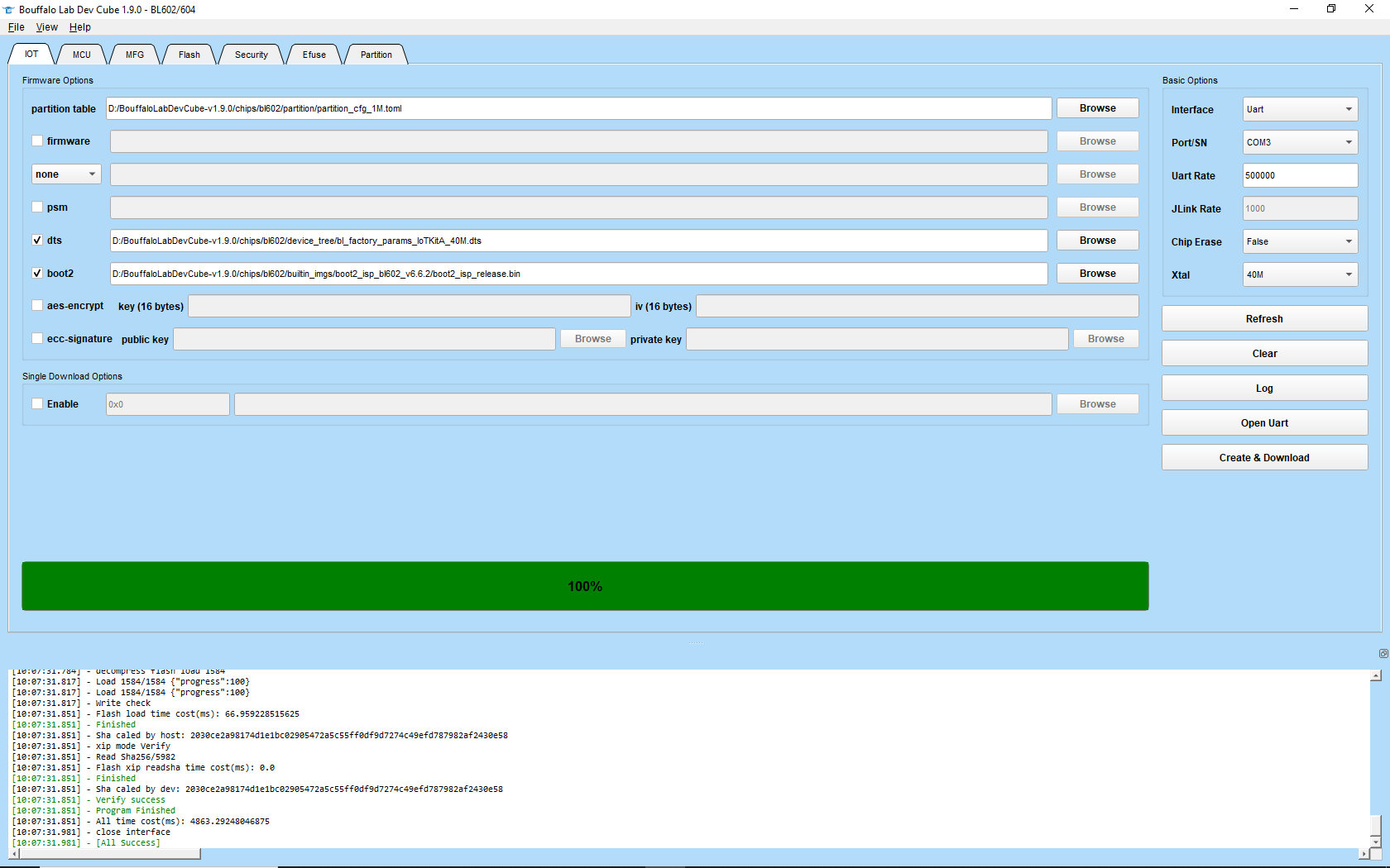

    On power-up the device is in uart download mode so BL Dev Cube can be used to read flash ID, take backup and then flash firmwares.
    Bouffalo Lab Dev Cube interface with flash identification results.
    Backup
    Screenshot of Bouffalo Lab Dev Cube interface displaying configuration options for BL602/604 flash.
    I had to reduce read speed to 500000 because 1000000 and 2000000 were producing errors.
    The backup file is attached.

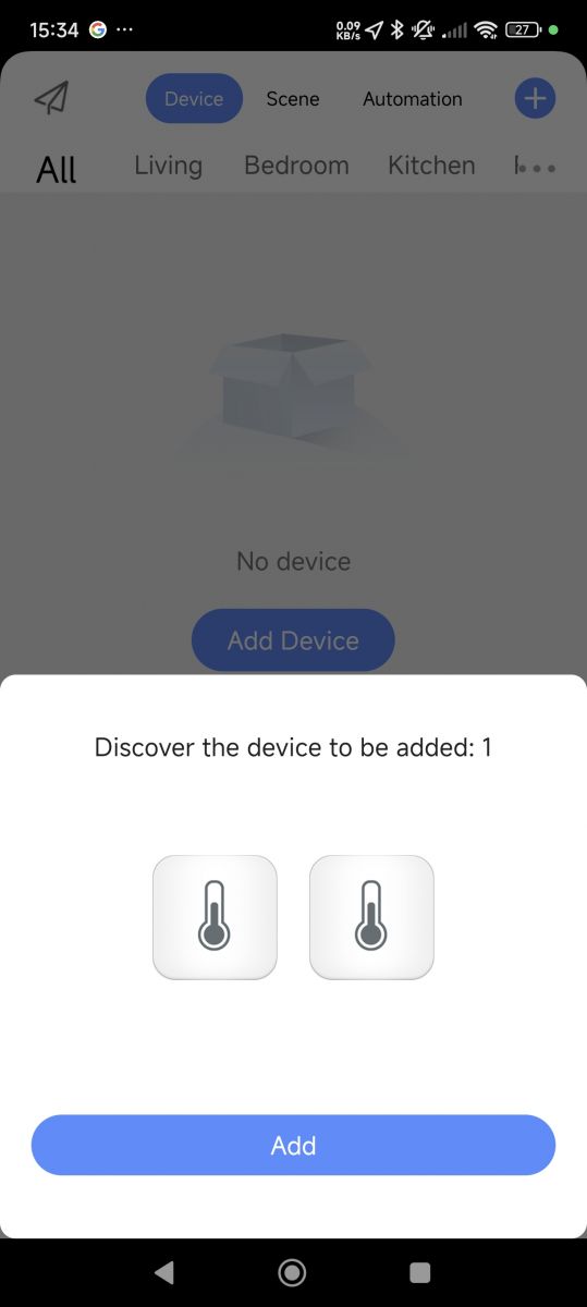

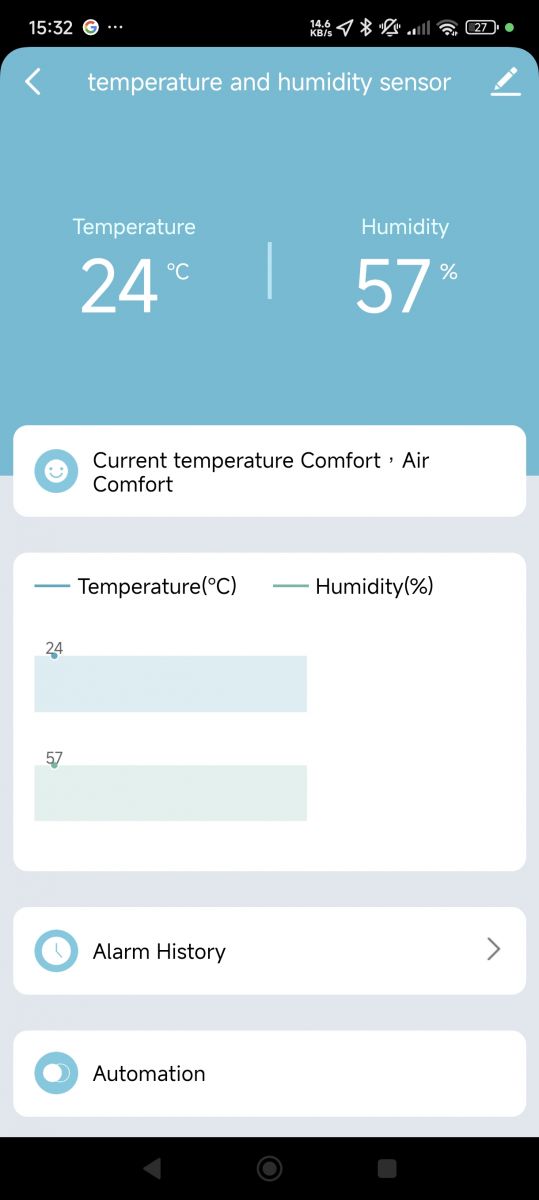

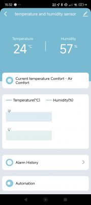

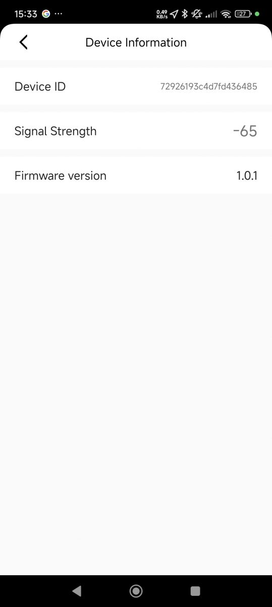

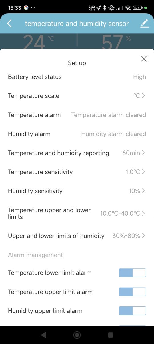

    After disconnecting the 10kohm resistor I paired to the Cozylife app to grab some screenshots
    Mobile app screen with option to add a new device. Device information screen showing ID, signal strength, and firmware version. Settings screen of a temperature and humidity sensor showing various configuration options. Screenshot of a temperature and humidity sensor app displaying 24°C and 57%.
    Then the moment of truth flashing OpenBL
    Bouffalo Lab Dev Cube software configuration window with loaded settings for BL602.
    flash success but it hangs on boot, perhaps not surprising given the experience of @mad_maxs in https://www.elektroda.com/rtvforum/topic4039068.html
    so, investigation required. Maybe OpenBeken is simply a no-goer for 1mb BL602s given how uncommon they are.
    • flash.bin (1 MB) You must be logged in to download this attachment.

    please post some images of your whole wiring setup and the BLDevcube config

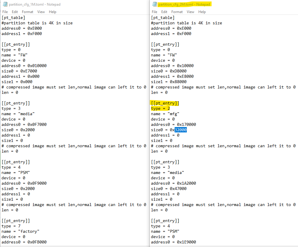

    regarding the flash size issues and OpenBL not booting, I wonder if @p.kaczmarek2 or @insmod has any thoughts. I'm trawling the OpenBL repo for signs something should be set differently depending on the flash size. Or perhaps OBK needs to be told there's no OTA partition at x address.
    Added after 8 [minutes]:
    Screenshot showing two configuration files named partition_cfg_1M.toml and partition_cfg_2M.toml open in Notepad, displaying sections on partitioning.
    Added after 5 [minutes]:
    maybe something in here? https://github.com/openshwprojects/OpenBL602/...components/hal_drv/bl602_hal/hal_boot2.c#L294
    i dunno

    are your cables too long? are you soldered or pogo pins? how are you powering the device?

    RX pad -> USB-TTL RXTX pad -> USB-TTL TXDL pad -> 10k ohm resistor ->USB-TTL 3.3v VCC pad -> USB-TTL 3.3vGND pad -> USB-TTL negative
    Just re-reading and notice you're powering from the USB-TTL. You should definitely use an external 3.3v source, especially with BL602s.

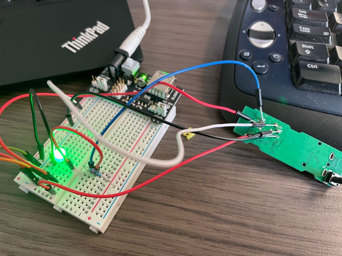

    birdman2010
    Hi all, I can verify that also while having a PSU attached while flashing the device simply will not boot.
    - using dev cube 1.9.0
    - was able to read ID & save original image
    - flash successful
    Please see images attached for my setup. Device is a Cozylife humidity sensor 602L10 based
    Bouffalo Lab Dev Cube 1.9.0 interface for device flashing.
    Printed circuit board with attached wires against a keyboard background.
    Breadboard with connected wires and an electronic sensor.
  • #14 21276187

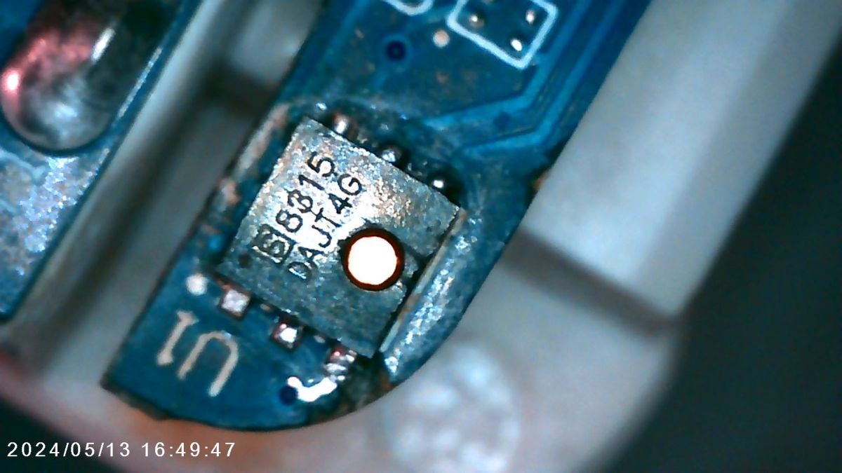

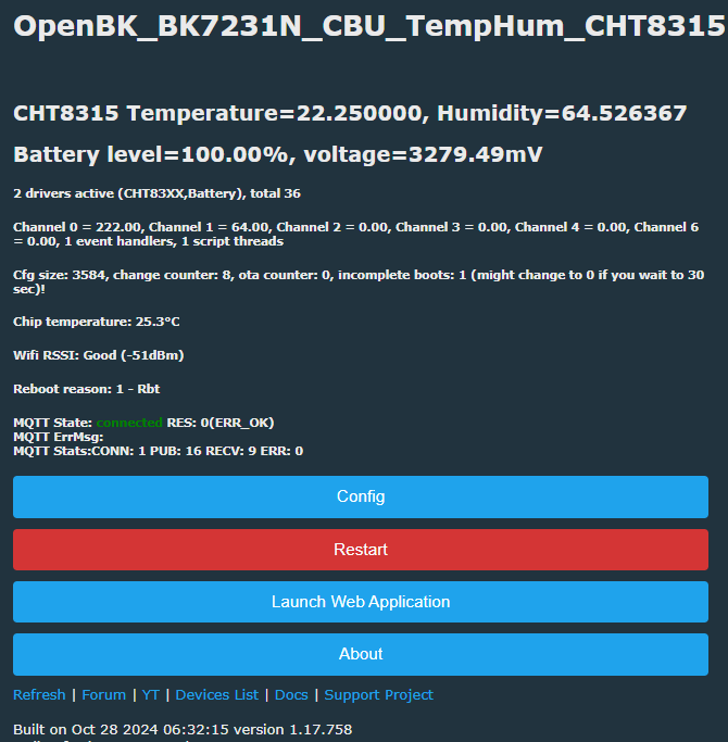

    I transplanted the CHT8315 into a TH01 with CHT8310 and 2mb Beken BK7231N as this is more useful in testing than paired with a BL602L10
    Close-up of CHT8315 microchip on a circuit board. Screenshot of the OpenBK user interface displaying temperature, humidity, battery level, and other diagnostic data.

    https://github.com/openshwprojects/OpenBK7231...db20682f4e6448b08d/src/littlefs/our_lfs.h#L48
    #elif PLATFORM_BL602
    // start media partition in bldevcube 1.4.8 partition config
    #define LFS_BLOCKS_START 0x192000
    #define LFS_BLOCKS_START_MIN 0x192000
    // end media partition
    #define LFS_BLOCKS_END 0x1E9000

    I think that's just the LittleFS stuff though. I'm sure I flashed a few older BL602 releases, some way before LFS was implemented, but there was no change in boot success.
    https://github.com/openshwprojects/OpenBK7231T_App/pull/1159
    could try some releases before then to be sure?

    Has anybody solved flash size limit with BL602L10
    Also, I could finally try again with my own device and it goes fine until I try read it.
    [23:45:37.478] - ========= image load =========
    [23:45:37.580] - get_boot_info
    [23:45:37.587] - data read is b'ffffffff0000000003000400a7f242fdd7c41400'
    [23:45:37.588] - ========= chipid: c4d7fd42f2a7 =========
    [23:45:37.589] - last boot info: None
    [23:45:37.590] - eflash loader present
    [23:45:37.591] - Error: Image load fail
    [23:45:37.592] - shakehand with eflash loader found
    [23:45:37.593] - Load helper bin time cost(ms): 114.858642578125
    [23:45:37.594] - ErrorCode: 0003, ErrorMsg: BFLB LOAD HELP BIN FAIL
    [23:45:37.595] - Burn Retry
    [23:45:37.596] - 0
    [23:45:37.596] - Burn return with retry fail
    Of course when it is not possible to flash this device some read error doesn't matter much.

    Vdragonb
    Hello! Person that works on the Zephyr port for those chips here.
    I have acquired one of those from the aliexpress 'CASECASE' store after seeing this thread (needed to confirm BL602L works as expected and also a temp sensor board is nice to add to my setup), I have successfully flashed it with Zephyr RTOS so it is something small in openbeken. I can confirm there is no efuse protection key and it should work like any other BL602 based device (very few have the lock keys) that work with openbeken beside the small memory.
    My setup for flashing was:
    - 18650 battery to and - where battery goes usually
    - TX RX to adapter TX RX (not inverted as mentioned earlier)
    - GND of adapter to GND on test points
    - DL pulled high to enable flashing mode.
    - used BFLB-MCU-TOOL (from pip) to flash it, but devcube worked when I backed up the flash and checked the efuses.

    I bought another one of these CozyLife BL602L10/CHT8315 to experiment with
    PCB of CozyLife BL602L10/CHT8315 device with exposed electronic components
Discussion centers on flashing and reverse-engineering a CozyLife battery-powered temperature/humidity sensor based on the BL602L10 (1 MB flash) SoC with CHT8315 sensor. The device is not supported by standard OpenBK/OpenBeken flashing instructions, and users report repeated BLDevCube/BFLB tool failures such as “BFLB LOAD HELP BIN FAIL” during read/flash attempts. The thread covers wiring, boot mode requirements, DL/BOOT pull-up, UART settings, and the need for a stable external 3.3 V supply rather than powering from USB-TTL or batteries. Several participants confirm that BL602L10 devices can sometimes be read and flashed with Bouffalo Lab tools, but OpenBeken currently does not boot reliably on 1 MB BL602 variants, likely due to flash size/partition table/LittleFS layout issues. Later posts conclude that these battery Wi‑Fi sensors are impractical for long battery life, and one contributor reports successful flashing with Zephyr RTOS using BFLB-MCU-TOOL.
