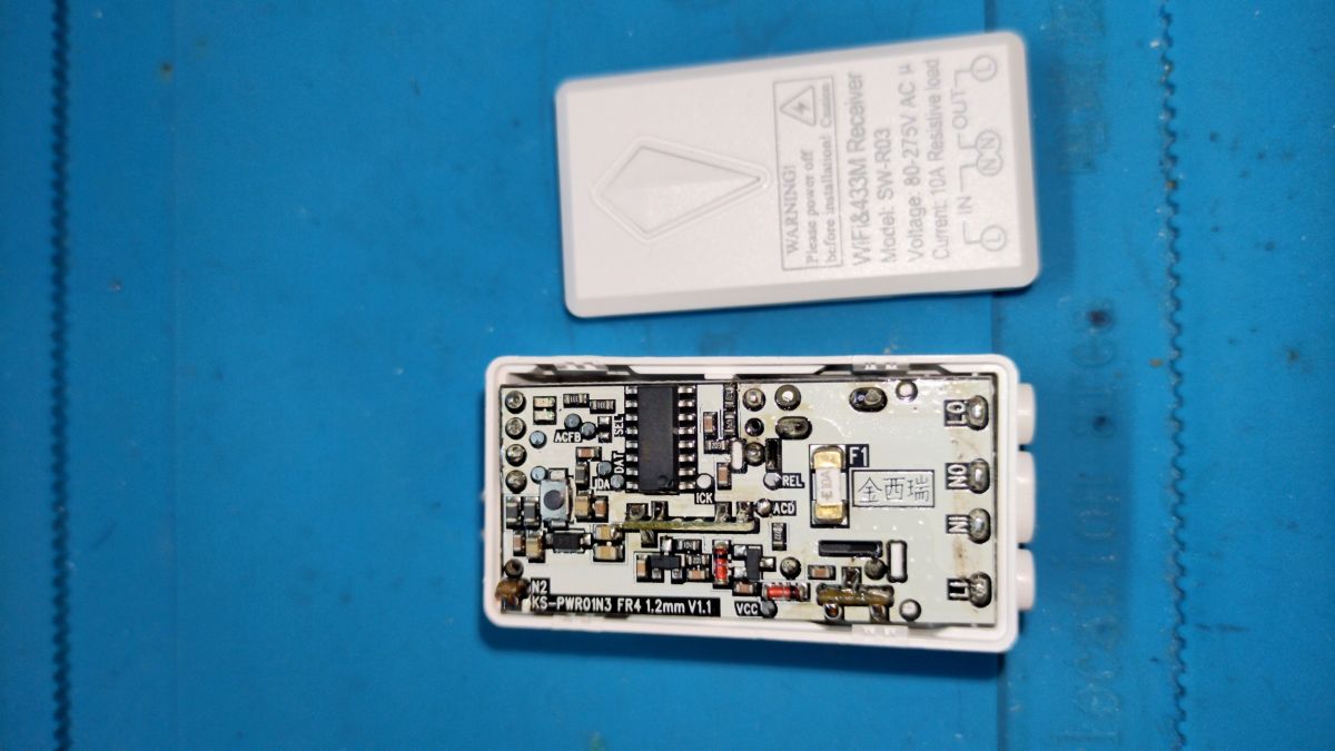

  • P24 button and P26 relay identified

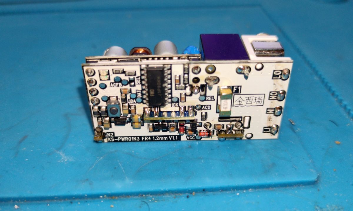

    P24 - button
    P26 - relay

    You've forget about WiFi LED. It's in the JSON you posted, look:
    Device seems to be using CB2S module, which is BK7231N chip.
    - Relay (channel 1) on P26
    - WiFi LED on P6
    - Button (channel 1) on P24
    OBK template:
