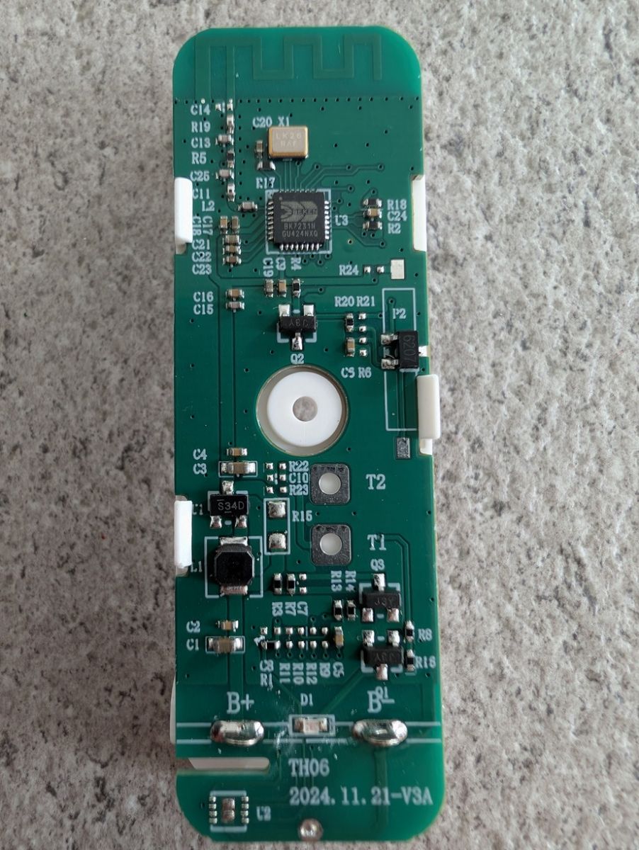

    I bought a Tuya Wifi Door sensor powered by 2xAAA batteries.
    Circuit board of an electronic device.

    But I have a problem with the wake up from deep sleep mode:
    - when the sensor goes into deep sleep from closed (door closed), when the door is opened the device wakes up
    - when the sensor goes into deep sleep from open (door open), closing or reopening the door the device doesn't wake up (I need to remove a battery for restore it)
    Can anyone help me to wake the device from deep sleep mode when the sensor is open?
    Thanks.
  • DSEdge 1 fixes wake edge for door sensor
    #2 21397934
    cerbero85
    I read this post: https://www.elektroda.com/rtvforum/topic4023117.html#20875049
    and I understood that the DSEdge command is missing to adjust the wake up edge of the GPIO.

    Yes, it's DSEdge setting. I wanted to post a reply but I see you resolved it quicker. So, is now everything working good?
