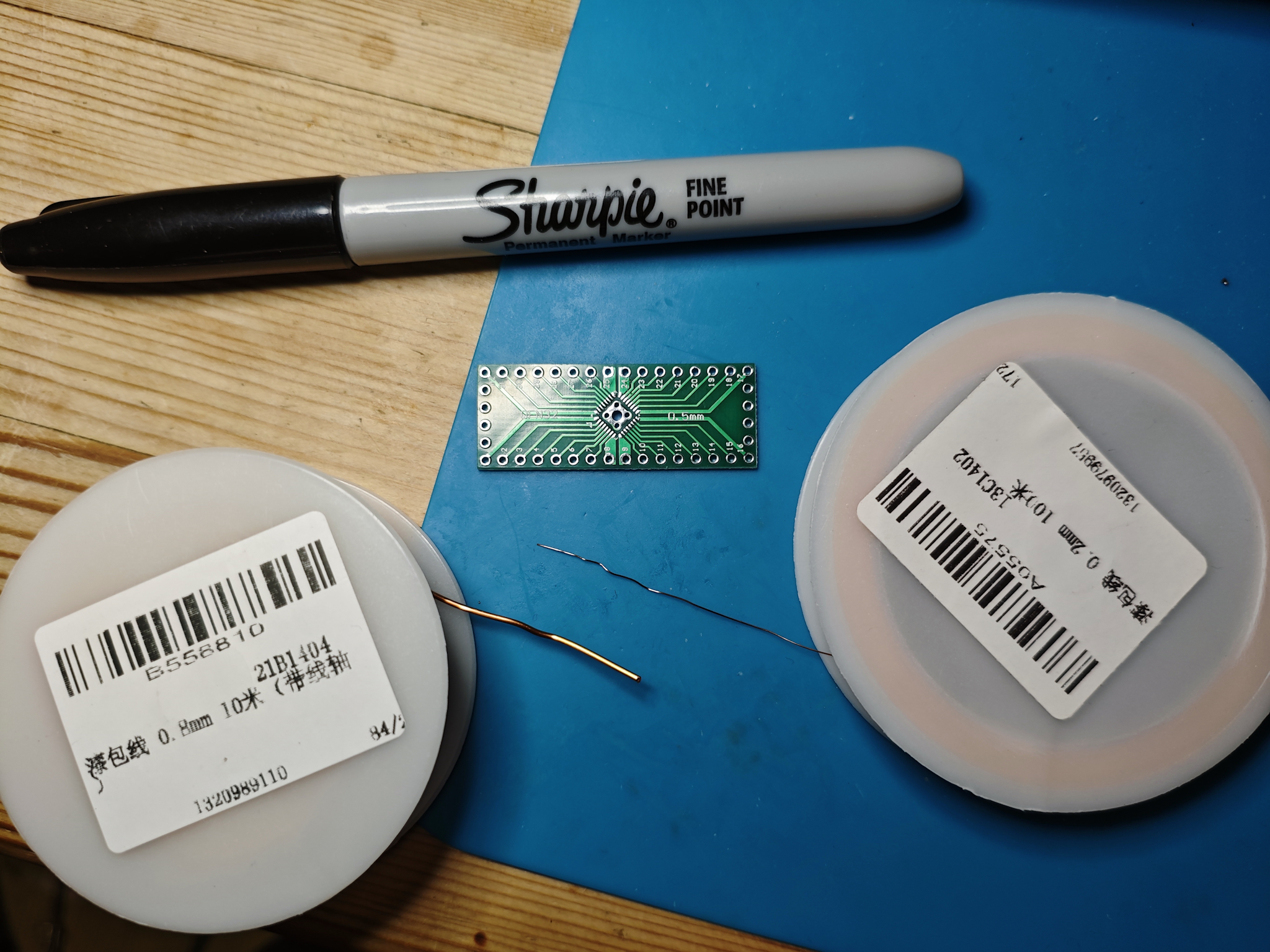

    they're dinky little things. Will start with enamelled wire and case hacking approach first though.

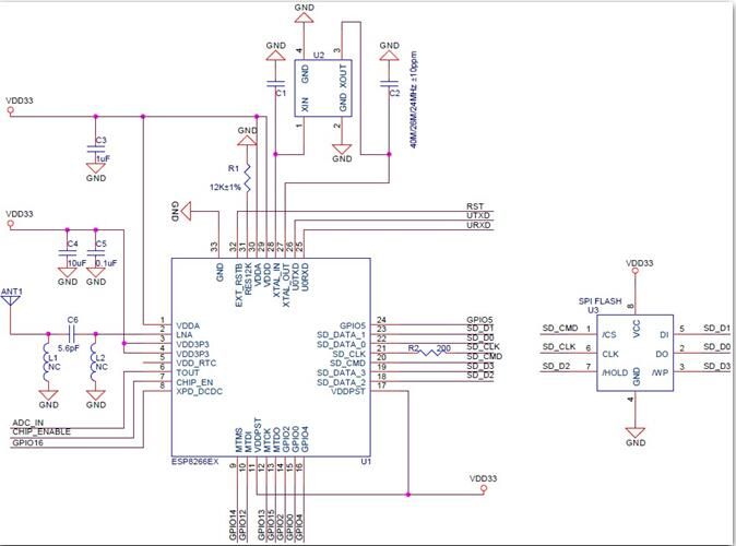

    You will also need to add 100nF capacitors between VDD and GND pins for stable operation. At least one I guess. I'm not sure about other LN8825B pins, but often microcontrollers require a bit more components, like this 12k resistor for ESP8266:

    thank you. maybe that kind of transplant is for another day. Oddly I've chosen 0.8 and 0.2mm wire, something in the middle might have been better. What selections of magnet wire do y'all keep?

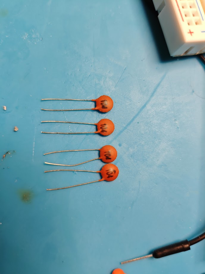

  • LN8825B needs six 3.3 V supply pins tied together
    #36 21264697
    Posts: 5220
    Help: 449
    Rate: 918

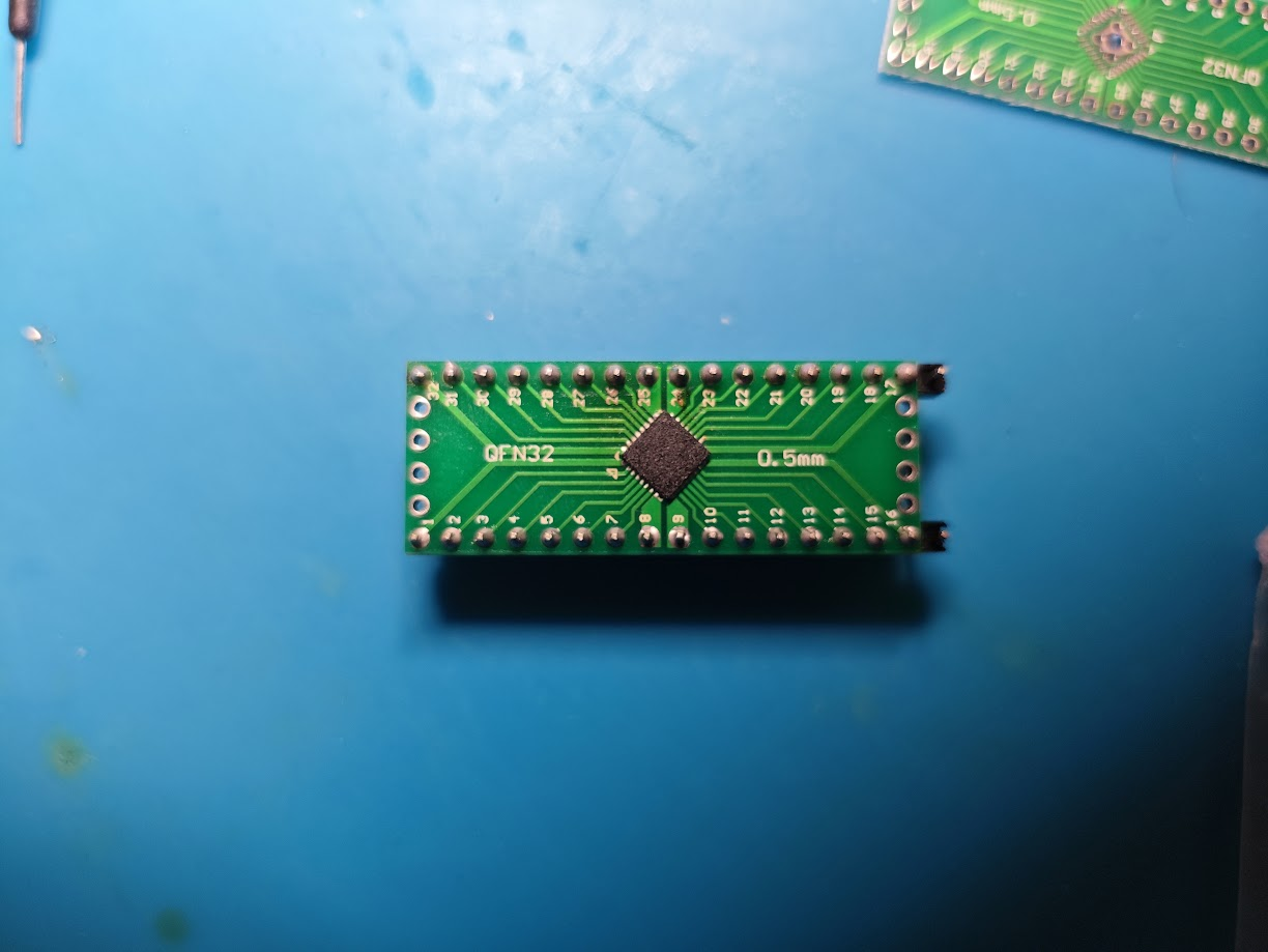

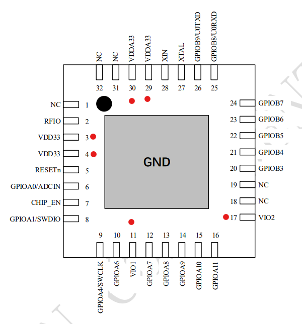

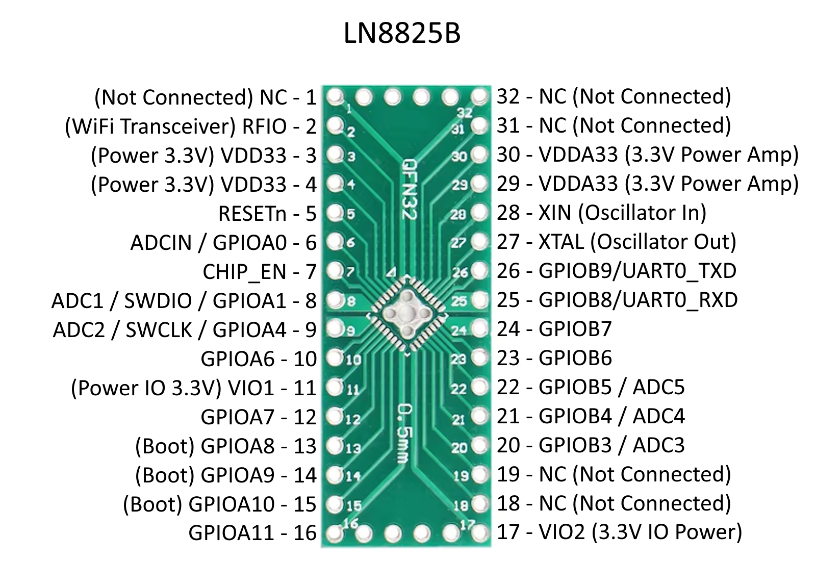

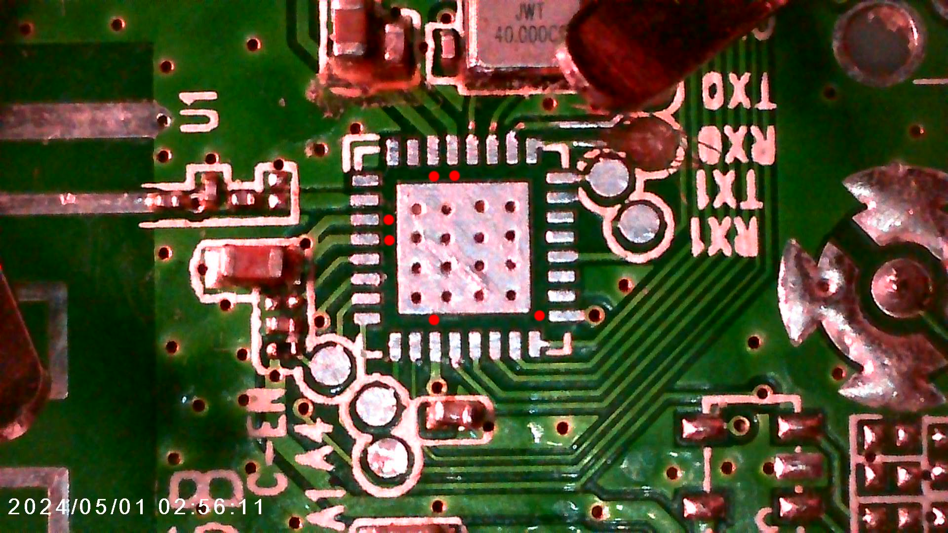

    A start. all 32 pins have continuity to outer header. No shorts. Seems I need to power 6 legs in total with 3.3v and, from what I understand, a 0.1 µF capacitor should be used for each.
    PCB module with a QFN32 chip on a blue background. Five orange ceramic capacitors 0.1 µF on a blue electronics work mat.
    hoping I don't lose steam with it!
    Added after 8 [hours] 28 [minutes]:
    and yes, there is continuity between all 6 pads on the original PCB
    Close-up of a circuit board with a highlighted integrated circuit and solder connections. Pin layout diagram of an integrated circuit with highlighted power pins.
    Added after 1 [hours] 53 [minutes]:
    Diagram of LN8825B module with 32 pins labeled.
  • One 100 nF decoupler may suffice for testing
