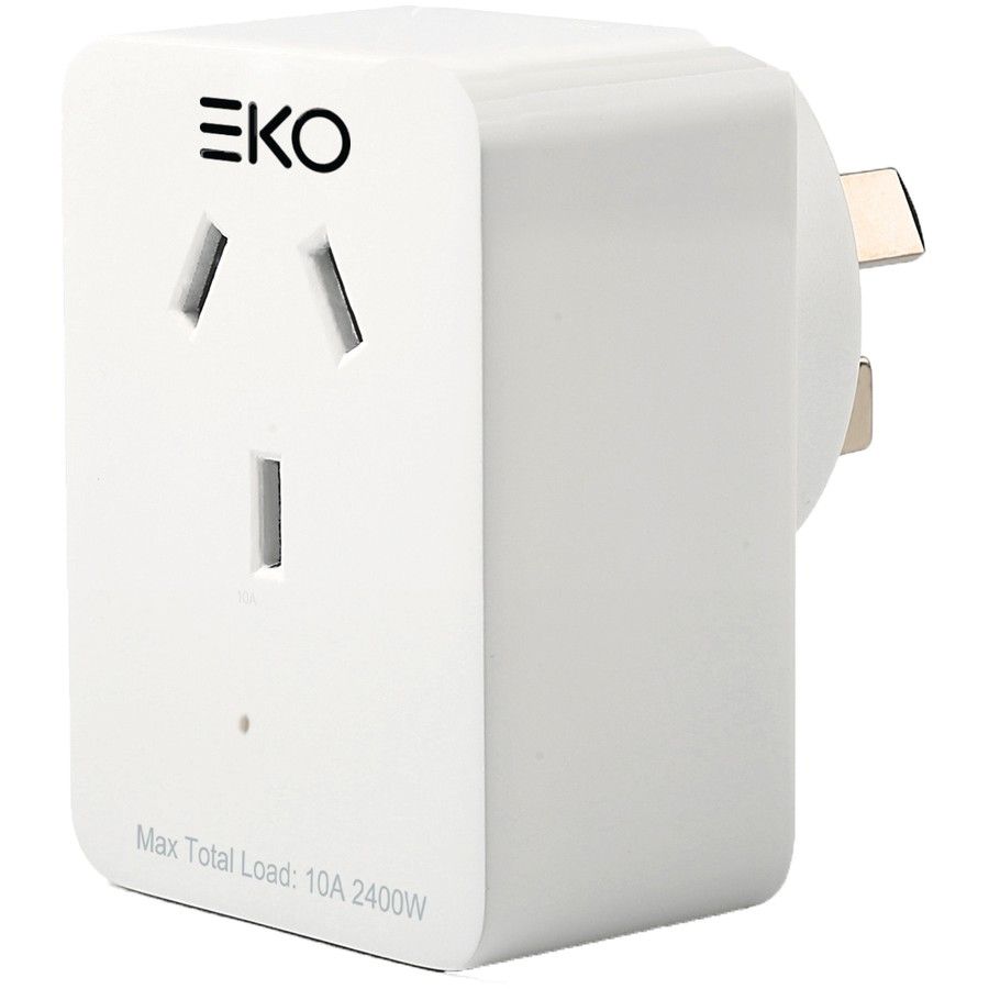

    Tuya AU Avoir IP66 Outdoor Dual Smart Socket has now failed. Scorched board, regulator, IC and CB3S all failed.
    No weather ingress. no obvious cause.
    Quickest/easiest solution for me was to grab the board out of one of these which fitted where the original board was.
    White outdoor dual smart socket by EKO with three plug slots and a maximum load of 10A 2400W.
