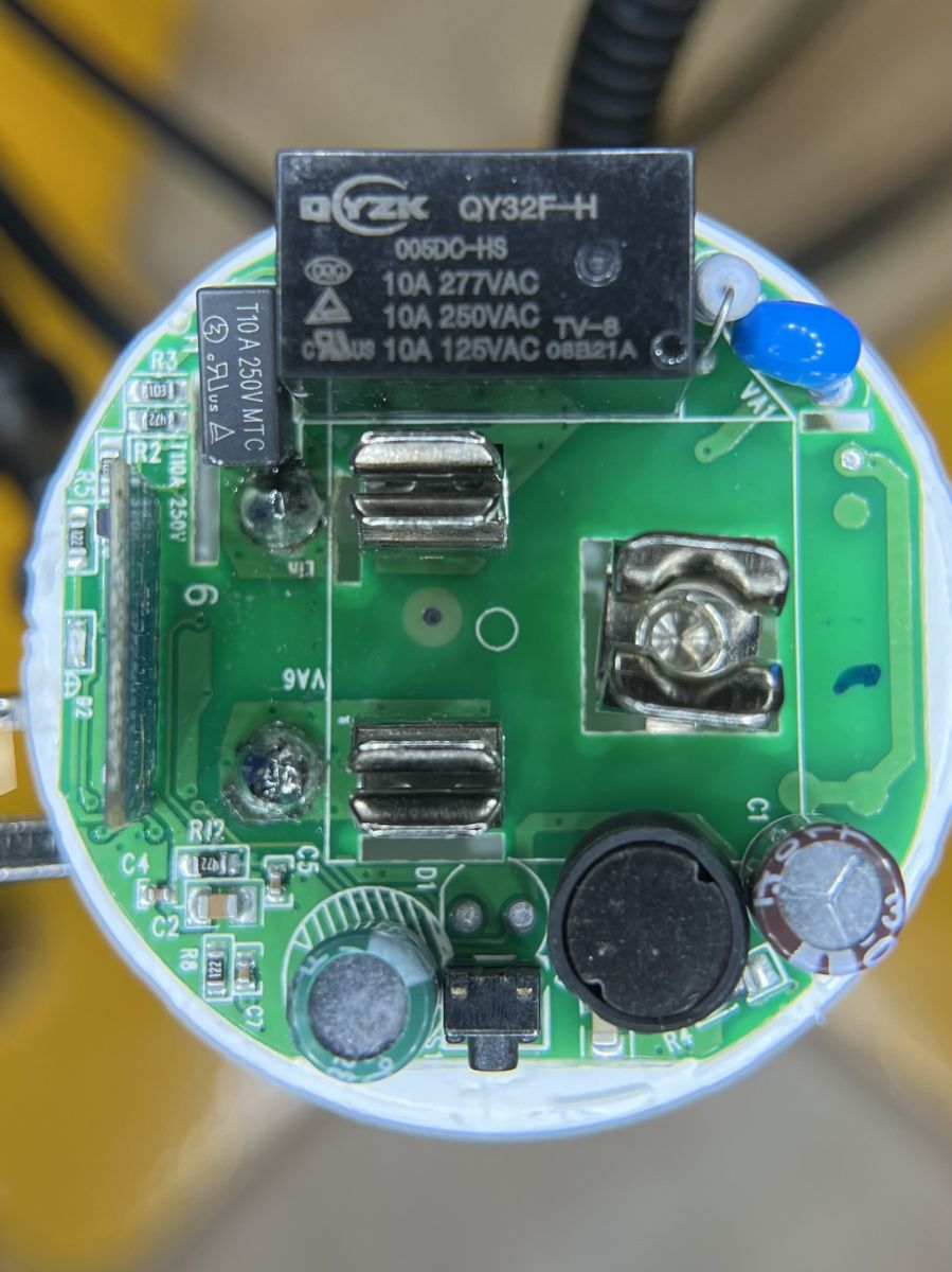

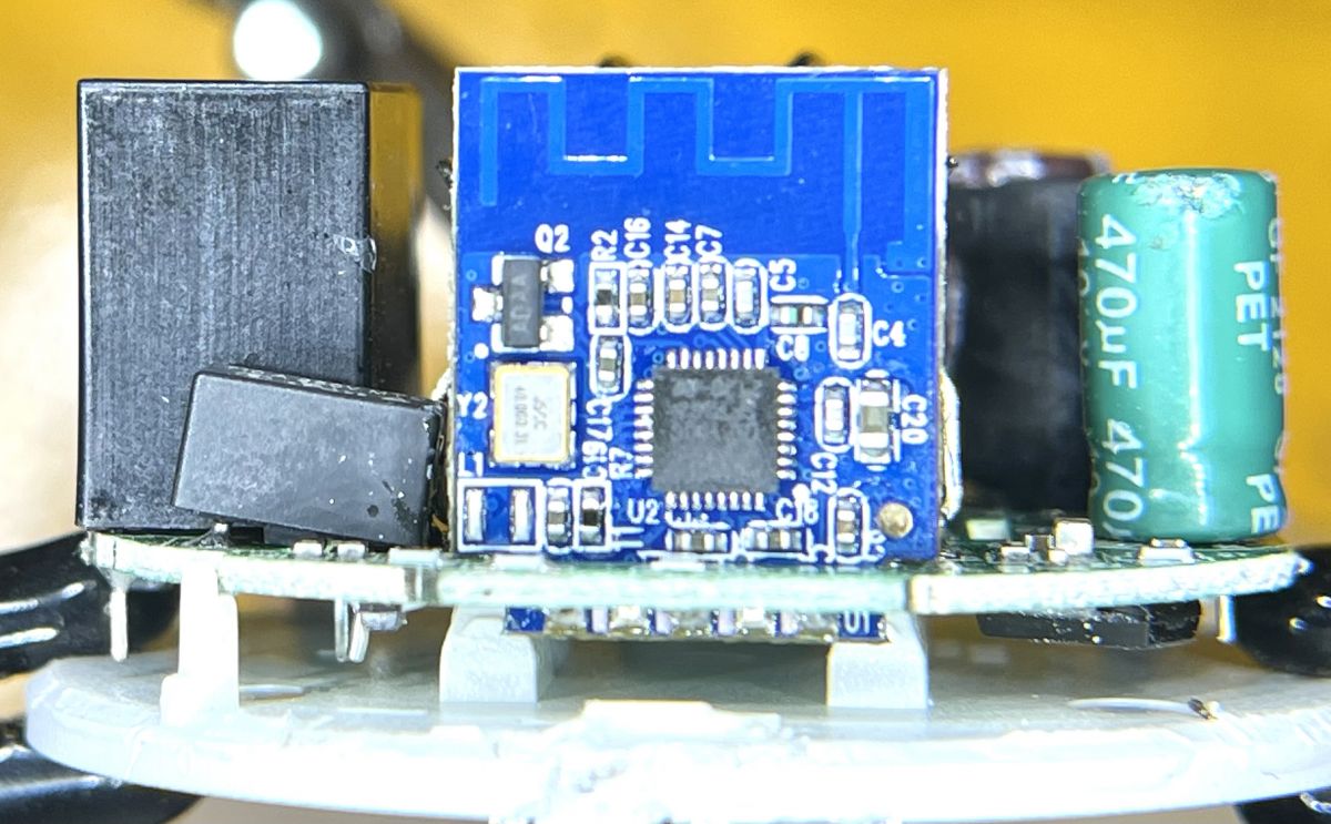

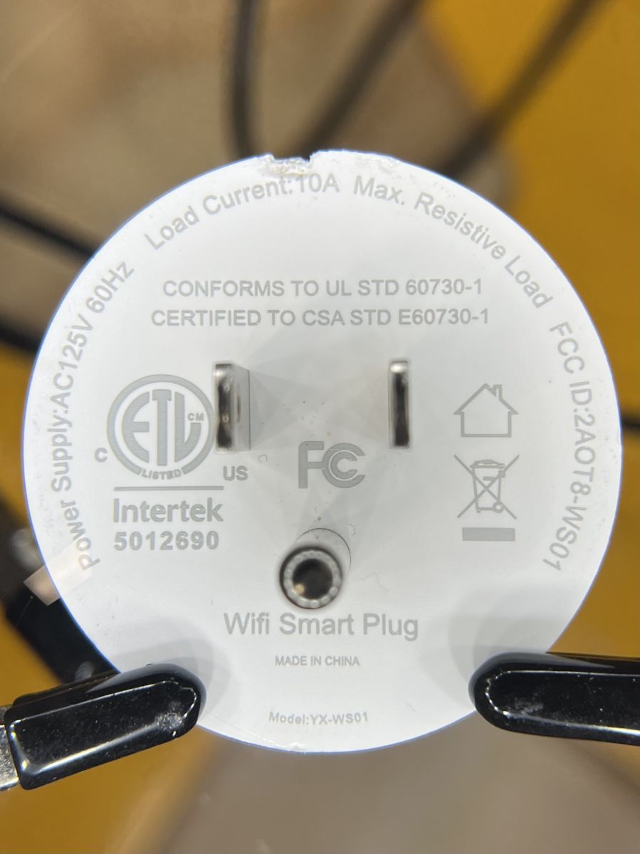

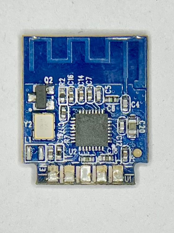

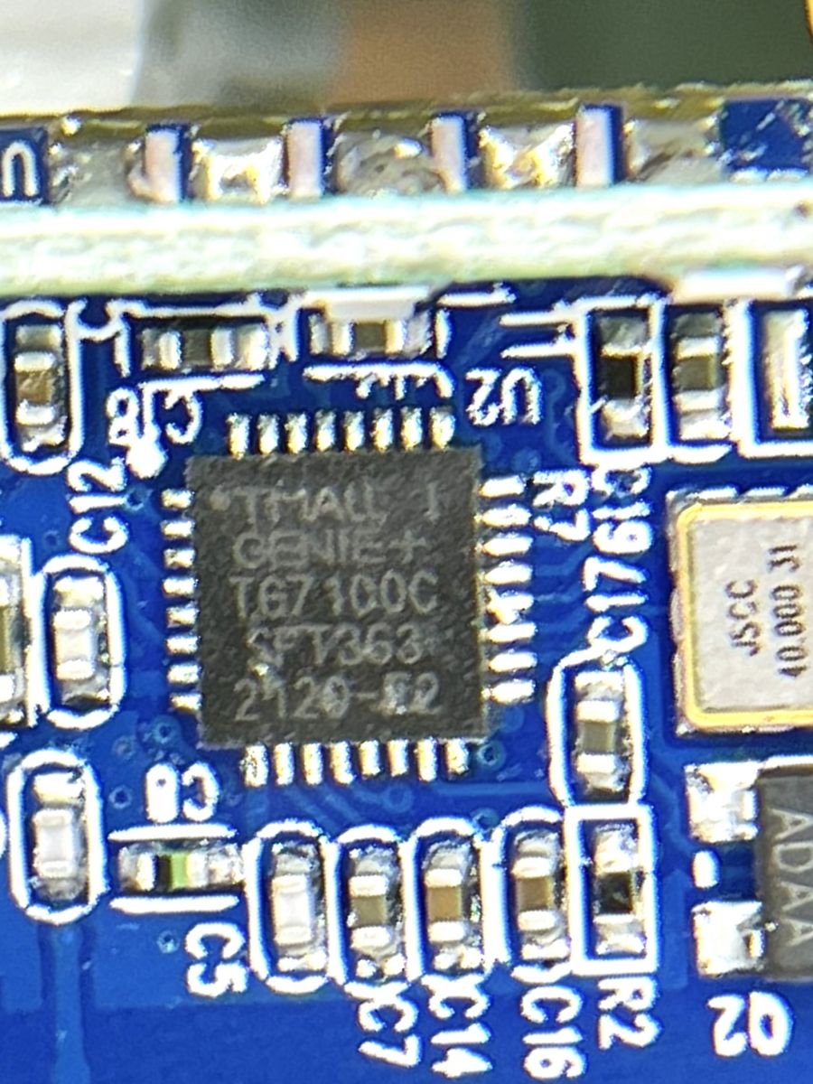

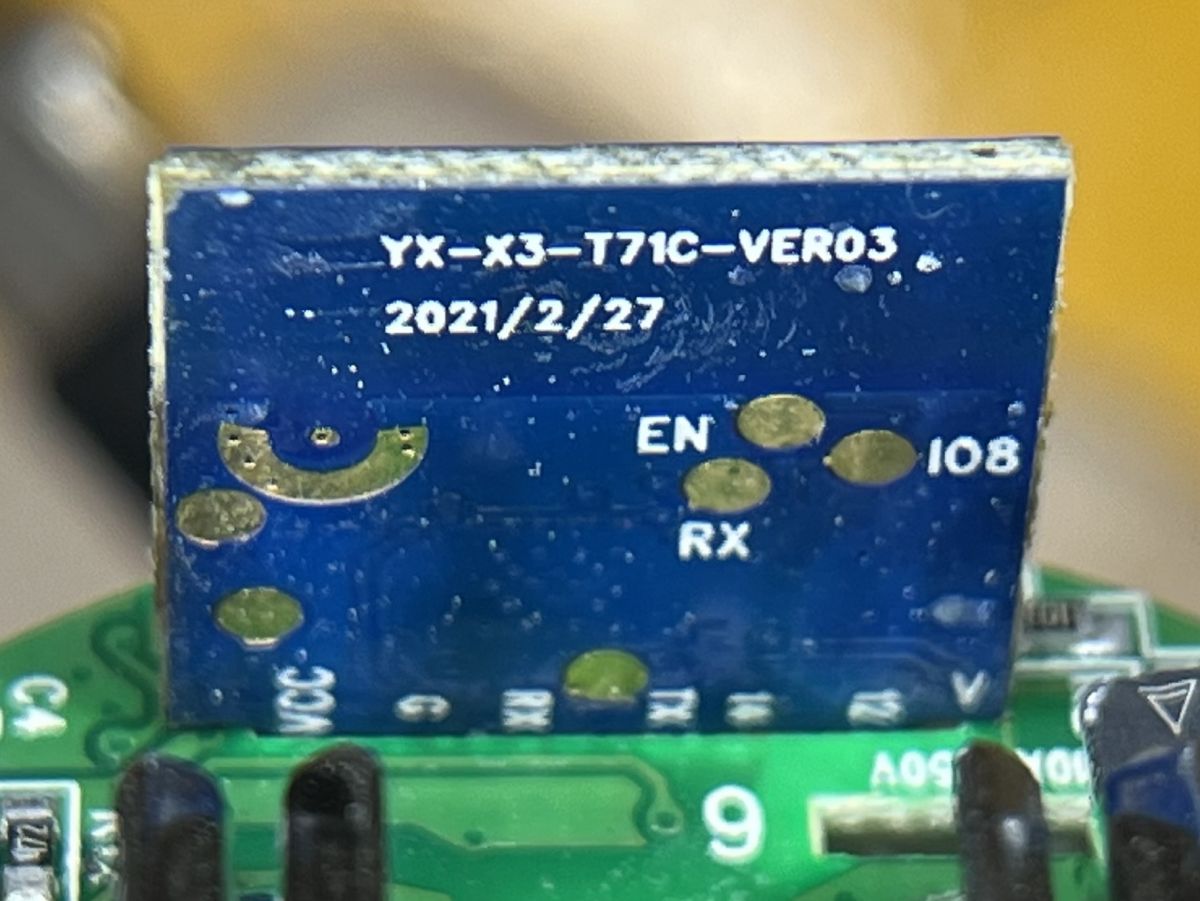

  • Amysen YX-WS01 smart plug teardown, FCC ID 2AOT8-WS01, uses module YX-X3-T71C-VER03 with a TG7100C Wi‑Fi chip.
  • The TG7100C is identified as a BL602 clone, which explains why the plug was neither ESP8266- nor BK7321-based.
  • The plug was bought in Nov 2022 via Amazon.com, and the firmware dump shows AliOS Things with board tg7100cevb.

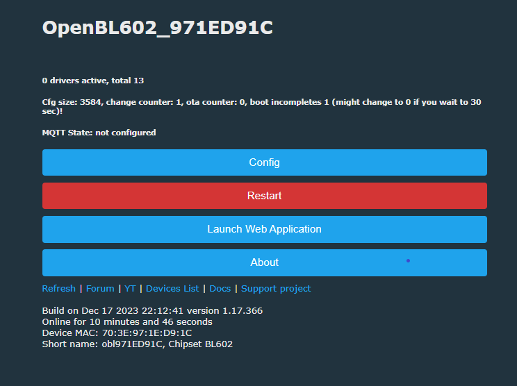

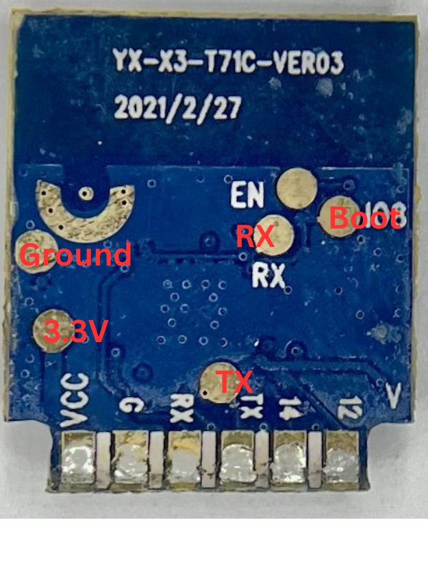

  • Attempting AP mode produced no joy, but removing the module and flashing over UART with Bouffalo Lab Dev Cube and FTDI worked.
  • Amysen YX-WS01, FCC ID 2AOT8-WS01, module YX-X3-T71C-VER03, chip TG7100C (a clone of the BL602)

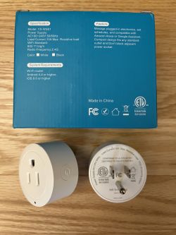

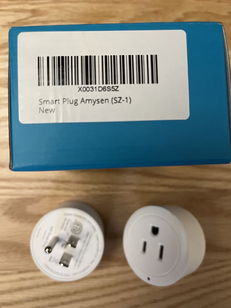

    I purchased these in Nov 2022 via Amazon.com in the US, hoping that they'd be Cloud-Cuttable, but was quickly discouraged after opening one up - the chipset was neither ESP8266 nor BK7321... and I did try to get it to go into AP mode, but no joy there. Upon closer examination, I found the chip on the Wifi module was labeled "TG7100C".
    (Note that at least five different vendors (Esicoo, Ecoey, Amysen, Tuya, Unbranded, etc.) have sold smart plugs labeled YX-WS01, but both the firmware and chipset has changed over the years. The original version was easily convertible to Tasmota and/or Tuya, then some lockdowns due to firmware changes, and then came chipset change(s).
    Amysen YX-WS01 smart plug and its packaging
    Amysen smart plug and packaging on a wooden surface. Amysen YX-WS01 smart plug with ETL and FCC certification. Interior of Amysen YX-WS01 module with visible electronic components, including a QY32F-H relay. Close-up of Amysen YX-WS01 Wi-Fi module with TG7100C chip on a PCB. Close-up of an electronic module with a chip labeled TG7100C. YX-X3-T71C-VER03 module with markings on the PCB.

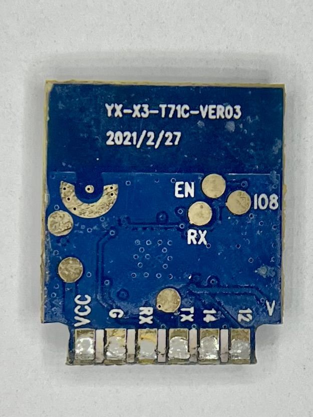

    Wi-Fi module YX-X3-T71C-VER03 from 2021-02-27 with visible markings EN, RX, and VCC on a blue background. YX-X3-T71C-VER03 electronic module with TG7100C chip.
    After some digging [ https://twitter.com/madushan1000/status/1367041198851035137 ] it seems that the TG7100C is just a clone of the BL602. Evidence is in the SDK [ https://github.com/Ai-Thinker-Open/Ai-Thinker...vice_tree/chip_factory_params_IoTKitA_24M.dts ], for instance.

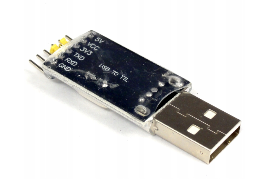

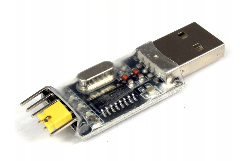

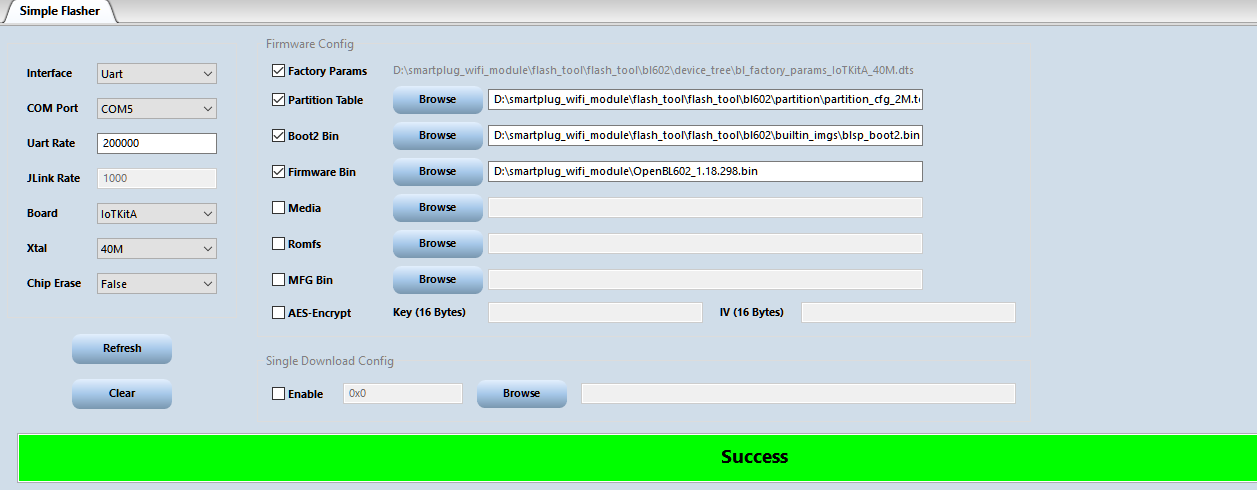

    In order to flash it, I had to do a teardown and solder/connect it via UART/serial, Bouffalo Labs flasher.
    After removing module, connecting it via Bouffalo Lab Dev Cube w/ FTDI USB adapter:
    [00:14:07.525] - serial type is general
    [00:14:07.580] - Open COM3 Success

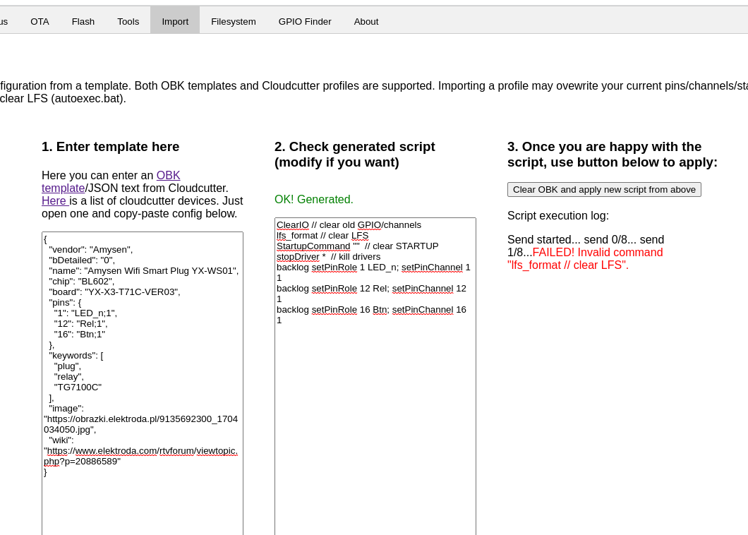

    Flashing the removed module worked fine, and here is a template for it:
      "vendor": "Amysen",
      "bDetailed": "0",
      "name": "Amysen Wifi Smart Plug YX-WS01",
      "chip": "BL602",
      "board": "YX-X3-T71C-VER03",
      "pins": {
        "1": "LED_n;1",
        "12": "Rel;1",
        "16": "Btn;1"
      "keywords": [
        "plug",
        "relay",
        "TG7100C"
      "image": "https://obrazki.elektroda.pl/9135692300_1704034050.jpg",
      "wiki": "https://www.elektroda.com/rtvforum/viewtopic.php?p=20886589"

    That's a nice find, how does the boot log from this device looks like?
    Isn't IO8 a 'BOOT' pin on BL602?
    Have you watched BL602 guides?
  • Power supply issue fixed to enable flashing
    #3 20886589
    davidcpurdy
    Posts: 22
    Success finally! The problem was partly with the power supply. After sorting that out, I did get it to flash. Transcript below, showing first the tail end of an unsuccessful flash, then a successful one:

    [17:53:23.597] - [param]
    interface_type = "Uart"
    comport_uart = "COM3"
    speed_uart = "1000000"
    speed_jlink = "1000"
    bl60x_brd = "IoTKitA"
    bl60x_xtal = "40M"
    aes_key = ""
    aes_iv = ""
    addr = "0x0"
    [check_box]
    partition_download = true
    boot2_download = true
    bin_download = true
    media_download = false
    use_romfs = false
    mfg_download = false
    ro_params_download = true
    ckb_erase_all = "False"
    encrypt = false
    download_single = false
    [input_path]
    pt_bin_input = "C:\\flash_tool\\bl602\\partition\\partition_cfg_2M.toml"
    boot2_bin_input = "C:\\flash_tool\\bl602\\builtin_imgs\\blsp_boot2.bin"
    cfg2_bin_input = "C:\\flash_tool\\OpenBL602_1.17.366.bin"
    meida_bin_input = ""
    romfs_dir_input = ""
    mfg_bin_input = ""
    img_bin_input = "C:\\flash_tool\\OpenBL602_1.17.366.bin"

    [17:53:29.373] - Program operation
    [17:53:29.374] - Dealing Index 0
    [17:53:29.376] - ========= programming bl602/img_create/whole_img_boot2.bin to 0x00000000
    [17:53:29.377] - ========= flash load =========
    [17:53:29.379] - ========= flash erase =========
    [17:53:29.381] - Erase flash  from 0x0 to 0xb98f
    [17:53:29.703] - Erase time cost(ms): 320.8662109375
    [17:53:29.757] - decompress flash load 22164
    [17:53:29.783] - Load 2048/22164 {"progress":9}

    [17:53:40.772] - Program Finished
    [17:53:40.772] - All time cost(ms): 14507.55615234375
    [17:53:40.985] - [All Success]
    Screenshot of the OpenBL602 control panel with three buttons: Config, Restart, and Launch Web Application.
    One oddity is that it came up as 192.168.169.1, rather than the expected 192.168.4.1. Not sure why this was.
    Here is the wiring diagram for UART access, showing Ground, 3.3VDC (actually VCC input), TX, RX and Boot. :
    UART wiring diagram with labeled connection points
    In the end, the process for this was essentially identical to that for regular BL602. Good luck!
    A working pin map:
    "1": "LED_n;1",
    "12": "Rel;1",
    "16": "Btn;1"

    Question: How much better is the CH340G over the older FTDI ttl-232r-3v3?
    With the CH340G, do I need separate PSU to supply the 3.3VDC to the board? If so, is it a high-quality PSU?
    Currently struggling to flash the next TG7100C while it is still on the main board (instead of removing it), using the FDTI serial device which has worked well for 12 years. I thought maybe it was weak, but I tried another FTDI (newer) with same failure. On the other hand, I know it must work OK more or less because I flashed a Sonoff S40 (different since its module has a 5VDC input for power to supply to board).
    The TG100C board I'm using does NOT have the 5VDC input pad, so I can't treat it like the Sonoff's BL602
    Repeatedly getting handshake failure...

    I would say that you need to either use an external 3.3V LDO regulator or a board that has such LDO regulator, if there is no AMS1117-3.3-like LDO regulator on your board, then it will not work.
    This board, for example:
    USB to TTL adapter with pins 5V, VCC, 3V3, TXD, RXD, and GND. USB to TTL adapter with a transparent casing.
    it has pin 3.3V, but it's only for voltage levels selection, it's not a good 3.3V current source. There is no good LDO on this board.
    On the other hand, Arduino board, or NodeMCU board, has a good 3.3V source available so if you use it with MCU put in RESET state, you can flash BK that way

    1. Is a buck converter generally enough to step down, say 6VDC to 3.3VDC? Is the LDO absolutely necessary to get ride of any variation in that voltage (ie. like spikes, ripples)?
    The buck converter I'm using is < https://www.amazon.com/gp/product/B014Y3OT6Y/..._sc_act_title_1?smid=A12MRQC2NA7LMA&psc=1 > , since I had a few left over after converting my Roomba's to Wifi/MQTT.
    I'm wondering if the FTDI Serial converter is less stable than the CH340G (which should arrive in a day or two).
    2. I posted a template at the very bottom of the first post of thread. Does it look complete and correct to you? I was unsure about the "bDetailed" entry. I tried to use the http://host-ip/app? "Import" tool, to validate the template, but it seems to throw an error at the end of that process... Removing the LFS commands does stop the error, but not sure how to finish this up...
    Screenshot of OBK template configuration tool with a script execution error.

    The buck converter you mention supports 3A output current which is way more than any Tuya WiFi module may even require. This should work, altough I'd always make sure to put a decoupling capacitor at the WiFi module VDD just to be sure and follow the generic manufacturer's guidelines.
    Your template looks good, I have added it now, thanks:
    https://github.com/OpenBekenIOT/webapp/commit/34c6c7eb3c02983ef44d597bc7009767dde12662
    The flags value is not crucial and bDetailed flag is for featuring a detailed teardown articles with step by step guide.

    OK, just checking my own sanity here... Desoldering/disassembling the plug leads from the board to get access to the solder joints for the Wifi Module is a pain, but the upside is that flashing the removed Wifi Module is super reliable with the buck converter I mentioned. It flashed on my first try.
    Of note, I had to interconnect my ground leads ( PSU & TTL-232R-3V3) in order for it to boot properly, otherwise, it was in a boot loop. Details:
    Connect
    TX - RX
    RX - TX
    PSU 3.3VDC - VDD/3.3VDC on module
    TTL-232R GRD - PSU GRD - GRD on module
    PSU 3.3VDC - 10k ohm - Boot on module
    Start up the Bouffalo Lab Dev Cube 1.4.8 flashing app, and check your configuration (Factory Params, Partition, Boot2 bin, Firmware).
    Turn on PSU, and flash (Create & Download) .
    Output from UART log/window is below:

    [13:42:21.714] - [param]
    speed_uart = "2000000"
    bl60x_xtal = "40M"
    aes_key = ""
    aes_iv = ""
    addr = "0x0"
    [check_box]
    bin_download = true
    use_romfs = false
    encrypt = false
    [input_path]
    mfg_bin_input = ""
    [13:42:21.730] - ========= Interface is Uart =========
    [13:42:21.751] - eflash loader bin is eflash_loader_40m.bin
    [13:42:21.758] - ========= chip flash id: ef4015 =========
    [13:42:21.774] - Update flash cfg finished
    [13:42:21.780] - create partition.bin, pt_new is True
    [13:42:21.790] - bl60x_fw_boot_head_gen xtal: 40M
    [13:42:21.796] - Create bootheader using C:\flash_tool\bl602\efuse_bootheader/efuse_bootheader_cfg.ini
    [13:42:21.797] - Updating data according to <C:\flash_tool\bl602\efuse_bootheader/efuse_bootheader_cfg.ini[BOOTHEADER_CFG]>
    [13:42:21.803] - Created file len:176
    [13:42:21.807] - Create efuse using C:\flash_tool\bl602\efuse_bootheader/efuse_bootheader_cfg.ini
    [13:42:21.807] - Updating data according to <C:\flash_tool\bl602\efuse_bootheader/efuse_bootheader_cfg.ini[EFUSE_CFG]>
    [13:42:21.807] - Created file len:128
    [13:42:21.823] - ========= sp image create =========
    [13:42:21.823] - Image hash is b'c5e2ce515a5783ac80efdd4910238a466572f882b53b3284e63c763e1da9847f'
    [13:42:21.823] - Header crc: b'52b188af'
    [13:42:21.823] - Write flash img
    [13:42:21.844] - bl60x_fw_boot_head_gen xtal: 40M
    [13:42:21.852] - Create bootheader using C:\flash_tool\bl602\efuse_bootheader/efuse_bootheader_cfg.ini
    [13:42:21.854] - Updating data according to <C:\flash_tool\bl602\efuse_bootheader/efuse_bootheader_cfg.ini[BOOTHEADER_CFG]>
    [13:42:21.859] - Created file len:176
    [13:42:21.865] - Create efuse using C:\flash_tool\bl602\efuse_bootheader/efuse_bootheader_cfg.ini
    [13:42:21.869] - Updating data according to <C:\flash_tool\bl602\efuse_bootheader/efuse_bootheader_cfg.ini[EFUSE_CFG]>
    [13:42:21.870] - Created file len:128
    [13:42:21.870] - ========= sp image create =========
    [13:42:21.896] - Image hash is b'cfdf4c95b160ea8cec9683daf4275917971ee5b248f91a5333f7c9943edb219d'
    [13:42:21.896] - Header crc: b'fc461dee'
    [13:42:21.897] - Write flash img
    [13:42:21.916] - FW Header is 176, 3920 still needed
    [13:42:21.916] - FW OTA bin header is Done. Len is 4096
    [13:42:22.353] - FW OTA bin is Done. Len is 762336
    [13:42:23.634] - FW OTA xz is Done
    [13:42:23.636] - ========= eflash loader config =========
    [13:42:23.760] - =========C:\flash_tool\bl602\device_tree/bl_factory_params_IoTKitA_40M.dts ——> bl602/device_tree/ro_params.dtb=========
    [13:42:24.218] - Version: bflb_eflash_loader_v2.0.0
    [13:42:24.218] - Program Start
    [13:42:24.218] - ========= eflash loader cmd arguments =========
    chipname : None
    chipid : False
    usage : False
    flash : True
    efuse : False
    write : True
    erase : False
    read : False
    none : False
    port : COM3
    baudrate : None
    config : None
    interface : None
    xtal : None
    start : None
    end : None
    addr : None
    mac : None
    file : None
    data : None
    mass : None
    loadstr : None
    loadfile : None
    userarea : None
    csvfile : None
    csvaddr : None
    para : None
    aeskey : None
    aesiv : None
    key : None
    ecdh : False
    echo : False
    auto : False
    version : False
    [13:42:24.283] - Config file: C:\flash_tool\bl602\eflash_loader/eflash_loader_cfg.ini
    [13:42:24.285] - serial port is COM3
    [13:42:24.286] - chiptype: bl602
    [13:42:24.287] - ========= Interface is Uart =========
    [13:42:24.287] - com speed: 2000000
    [13:42:24.288] - Eflash load helper file: C:\flash_tool\bl602\eflash_loader/eflash_loader_40m.bin
    [13:42:24.289] - ========= load eflash_loader.bin =========
    [13:42:24.290] - Load eflash_loader.bin via uart
    [13:42:24.290] - ========= image load =========
    [13:42:24.575] - tx rx and power off, press the machine!
    [13:42:24.576] - cutoff time is 0.1
    [13:42:24.681] - power on tx and rx
    [13:42:25.509] - reset cnt: 0, reset hold: 0.005, shake hand delay: 0.1
    [13:42:25.510] - clean buf
    [13:42:25.619] - send sync
    [13:42:25.730] - ack is b''
    [13:42:25.730] - retry
    [13:42:25.993] - tx rx and power off, press the machine!
    [13:42:25.993] - cutoff time is 0.1
    [13:42:26.108] - power on tx and rx
    [13:42:26.931] - reset cnt: 0, reset hold: 0.005, shake hand delay: 0.1
    [13:42:26.931] - clean buf
    [13:42:27.046] - send sync
    [13:42:27.147] - ack is b''
    [13:42:27.147] - retry
    [13:42:27.147] - shake hand fail
    [13:42:27.147] - ########################################################################
    [13:42:27.147] - 请按照以下描述排查问题:
    [13:42:27.147] - GPIO8是否上拉到板子自身的3.3V,而不是外部的3.3V
    [13:42:27.147] - GPIO7(RX)是否连接到USB转串口的TX引脚
    [13:42:27.147] - GPIO16(TX)是否连接到USB转串口的RX引脚
    [13:42:27.147] - 在使用烧录软件进行烧录前,是否在GPIO8拉高的情况下,使用Reset/Chip_En复位了芯片
    [13:42:27.147] - 烧录软件所选择的COM口,是否是连接芯片的串口
    [13:42:27.147] - 烧录软件上选择的波特率是否是USB转串口支持的波特率
    [13:42:27.147] - 3.3V供电是否正常
    [13:42:27.147] - 板子供电电流是否正常(烧录模式下,芯片耗电电流5-7mA)
    [13:42:27.278] - Load helper bin time cost(ms): 2987.745361328125
    [13:42:27.279] - {"ErrorCode": "0003","ErrorMsg":"BFLB LOAD HELP BIN FAIL"}
    [13:42:27.279] - Burn Retry
    [13:42:27.280] - 0
    [13:42:27.280] - Burn return with retry fail

    [13:42:47.508] - ========= chip flash id: ef4015 =========
    [13:42:47.523] - Update flash cfg finished
    [13:42:47.539] - create partition.bin, pt_new is True
    [13:42:47.543] - bl60x_fw_boot_head_gen xtal: 40M
    [13:42:47.543] - Create bootheader using C:\flash_tool\bl602\efuse_bootheader/efuse_bootheader_cfg.ini
    [13:42:47.543] - Updating data according to <C:\flash_tool\bl602\efuse_bootheader/efuse_bootheader_cfg.ini[BOOTHEADER_CFG]>
    [13:42:47.559] - Created file len:176
    [13:42:47.559] - Create efuse using C:\flash_tool\bl602\efuse_bootheader/efuse_bootheader_cfg.ini
    [13:42:47.559] - Updating data according to <C:\flash_tool\bl602\efuse_bootheader/efuse_bootheader_cfg.ini[EFUSE_CFG]>
    [13:42:47.575] - Created file len:128
    [13:42:47.584] - ========= sp image create =========
    [13:42:47.587] - Image hash is b'c5e2ce515a5783ac80efdd4910238a466572f882b53b3284e63c763e1da9847f'
    [13:42:47.588] - Header crc: b'52b188af'
    [13:42:47.588] - Write flash img
    [13:42:47.604] - bl60x_fw_boot_head_gen xtal: 40M
    [13:42:47.612] - Create bootheader using C:\flash_tool\bl602\efuse_bootheader/efuse_bootheader_cfg.ini
    [13:42:47.613] - Updating data according to <C:\flash_tool\bl602\efuse_bootheader/efuse_bootheader_cfg.ini[BOOTHEADER_CFG]>
    [13:42:47.618] - Created file len:176
    [13:42:47.623] - Create efuse using C:\flash_tool\bl602\efuse_bootheader/efuse_bootheader_cfg.ini
    [13:42:47.626] - Updating data according to <C:\flash_tool\bl602\efuse_bootheader/efuse_bootheader_cfg.ini[EFUSE_CFG]>
    [13:42:47.630] - Created file len:128
    [13:42:47.640] - ========= sp image create =========
    [13:42:47.655] - Image hash is b'cfdf4c95b160ea8cec9683daf4275917971ee5b248f91a5333f7c9943edb219d'
    [13:42:47.656] - Header crc: b'fc461dee'
    [13:42:47.656] - Write flash img
    [13:42:47.670] - FW Header is 176, 3920 still needed
    [13:42:47.670] - FW OTA bin header is Done. Len is 4096
    [13:42:48.122] - FW OTA bin is Done. Len is 762336
    [13:42:49.304] - FW OTA xz is Done
    [13:42:49.306] - ========= eflash loader config =========
    [13:42:49.439] - =========C:\flash_tool\bl602\device_tree/bl_factory_params_IoTKitA_40M.dts ——> bl602/device_tree/ro_params.dtb=========
    [13:42:49.885] - Version: bflb_eflash_loader_v2.0.0
    [13:42:49.885] - Program Start
    [13:42:49.885] - ========= eflash loader cmd arguments =========
    chipname : None
    chipid : False
    usage : False
    flash : True
    efuse : False
    write : True
    erase : False
    read : False
    none : False
    port : COM3
    baudrate : None
    config : None
    interface : None
    xtal : None
    start : None
    end : None
    addr : None
    mac : None
    file : None
    data : None
    mass : None
    loadstr : None
    loadfile : None
    userarea : None
    csvfile : None
    csvaddr : None
    para : None
    aeskey : None
    aesiv : None
    key : None
    ecdh : False
    echo : False
    auto : False
    version : False
    [13:42:49.950] - Config file: C:\flash_tool\bl602\eflash_loader/eflash_loader_cfg.ini
    [13:42:49.952] - serial port is COM3
    [13:42:49.953] - chiptype: bl602
    [13:42:49.954] - ========= Interface is Uart =========
    [13:42:49.954] - com speed: 2000000
    [13:42:49.955] - Eflash load helper file: C:\flash_tool\bl602\eflash_loader/eflash_loader_40m.bin
    [13:42:49.956] - Eflash load helper file: C:\flash_tool\bl602\eflash_loader/eflash_loader_40m.bin
    [13:42:49.956] - ========= load eflash_loader.bin =========
    [13:42:49.957] - Load eflash_loader.bin via uart
    [13:42:49.957] - ========= image load =========
    [13:42:50.243] - tx rx and power off, press the machine!
    [13:42:50.244] - cutoff time is 0.1
    [13:42:50.348] - power on tx and rx
    [13:42:51.181] - reset cnt: 0, reset hold: 0.005, shake hand delay: 0.1
    [13:42:51.181] - clean buf
    [13:42:51.293] - send sync
    [13:42:51.509] - ack is b'4f4b'
    [13:42:51.556] - shake hand success
    [13:42:51.572] - get_boot_info
    [13:42:51.585] - data read is b'010000000000000003000000e97807cf0eb41700'
    [13:42:51.586] - sign is 0 encrypt is 0
    [13:42:51.604] - segcnt is 1
    [13:42:51.632] - segdata_len is 30192
    [13:42:51.728] - 4080/30192
    [13:42:51.818] - 8160/30192
    [13:42:51.920] - 12240/30192
    [13:42:52.003] - 16320/30192
    [13:42:52.103] - 20400/30192
    [13:42:52.203] - 24480/30192
    [13:42:52.303] - 28560/30192
    [13:42:52.351] - 30192/30192
    [13:42:52.367] - Run img
    [13:42:52.493] - Load helper bin time cost(ms): 2535.5986328125
    [13:42:52.603] - ========= flash read jedec ID =========
    [13:42:52.604] - Flash load shake hand
    [13:42:52.604] - clean buf
    [13:42:52.713] - send sync
    [13:42:52.931] - ack is b'4f4b'
    [13:42:52.963] - Read flash jedec ID
    [13:42:52.963] - readdata:
    [13:42:52.963] - b'ef401500'
    [13:42:52.963] - Finished
    [13:42:52.963] - Program operation
    [13:42:52.979] - Dealing Index 0
    [13:42:52.979] - ========= programming bl602/img_create/whole_img_boot2.bin to 0x00000000
    [13:42:52.980] - ========= flash load =========
    [13:42:52.981] - ========= flash erase =========
    [13:42:52.981] - Erase flash  from 0x0 to 0xb98f
    [13:42:53.259] - Erase time cost(ms): 277.30712890625
    [13:42:53.291] - decompress flash load 22164
    [13:42:53.320] - Load 2048/22164 {"progress":9}
    [13:42:53.335] - Load 4096/22164 {"progress":18}
    [13:42:53.351] - Load 6144/22164 {"progress":27}
    [13:42:53.376] - Load 8192/22164 {"progress":36}
    [13:42:53.392] - Load 10240/22164 {"progress":46}
    [13:42:53.408] - Load 12288/22164 {"progress":55}
    [13:42:53.424] - Load 14336/22164 {"progress":64}
    [13:42:53.440] - Load 16384/22164 {"progress":73}
    [13:42:53.456] - Load 18432/22164 {"progress":83}
    [13:42:53.472] - Load 20480/22164 {"progress":92}
    [13:42:53.479] - Load 22164/22164 {"progress":100}
    [13:42:53.479] - Write check
    [13:42:53.520] - Flash load time cost(ms): 260.502197265625
    [13:42:53.520] - Finished
    [13:42:53.520] - Sha caled by host: 194e180166ca945012e261580c23e9a181fb3d34a9e1a50c54d0dd649754a400
    [13:42:53.520] - xip mode Verify
    [13:42:53.551] - Read Sha256/47504
    [13:42:53.553] - Flash xip readsha time cost(ms): 17.813232421875
    [13:42:53.554] - Finished
    [13:42:53.568] - Sha caled by dev: 194e180166ca945012e261580c23e9a181fb3d34a9e1a50c54d0dd649754a400
    [13:42:53.569] - Verify success
    [13:42:53.570] - Dealing Index 1
    [13:42:53.571] - ========= programming bl602/partition/partition.bin to 0xe000
    [13:42:53.571] - ========= flash load =========
    [13:42:53.573] - ========= flash erase =========
    [13:42:53.573] - Erase flash  from 0xe000 to 0xe10f
    [13:42:53.604] - Erase time cost(ms): 31.7646484375
    [13:42:53.620] - Load 272/272 {"progress":100}
    [13:42:53.620] - Write check
    [13:42:53.636] - Flash load time cost(ms): 31.253662109375
    [13:42:53.636] - Finished
    [13:42:53.636] - Sha caled by host: da4d2fe7d42a71246b0e84d64665b70ad701435f89716c48e6f23ef55340eaa0
    [13:42:53.636] - xip mode Verify
    [13:42:53.680] - Read Sha256/272
    [13:42:53.681] - Flash xip readsha time cost(ms): 17.052001953125
    [13:42:53.681] - Finished
    [13:42:53.696] - Sha caled by dev: da4d2fe7d42a71246b0e84d64665b70ad701435f89716c48e6f23ef55340eaa0
    [13:42:53.696] - Verify success
    [13:42:53.697] - Dealing Index 2
    [13:42:53.697] - ========= programming bl602/partition/partition.bin to 0xf000
    [13:42:53.698] - ========= flash load =========
    [13:42:53.698] - ========= flash erase =========
    [13:42:53.698] - Erase flash  from 0xf000 to 0xf10f
    [13:42:53.743] - Erase time cost(ms): 45.81201171875
    [13:42:53.759] - Load 272/272 {"progress":100}
    [13:42:53.760] - Write check
    [13:42:53.775] - Flash load time cost(ms): 29.79052734375
    [13:42:53.776] - Finished
    [13:42:53.776] - Sha caled by host: da4d2fe7d42a71246b0e84d64665b70ad701435f89716c48e6f23ef55340eaa0
    [13:42:53.776] - xip mode Verify
    [13:42:53.806] - Read Sha256/272
    [13:42:53.806] - Flash xip readsha time cost(ms): 29.90087890625
    [13:42:53.806] - Finished
    [13:42:53.822] - Sha caled by dev: da4d2fe7d42a71246b0e84d64665b70ad701435f89716c48e6f23ef55340eaa0
    [13:42:53.822] - Verify success
    [13:42:53.822] - Dealing Index 3
    [13:42:53.822] - ========= programming bl602/img_create/whole_img.bin to 0x10000
    [13:42:53.822] - ========= flash load =========
    [13:42:53.822] - ========= flash erase =========
    [13:42:53.822] - Erase flash  from 0x10000 to 0xca1df
    [13:42:56.339] - Erase time cost(ms): 2517.251220703125
    [13:42:57.062] - decompress flash load 405536
    [13:42:57.082] - Load 2048/405536 {"progress":0}
    [13:42:57.100] - Load 4096/405536 {"progress":1}
    [13:42:57.116] - Load 6144/405536 {"progress":1}
    [13:42:57.132] - Load 8192/405536 {"progress":2}
    [13:42:57.152] - Load 10240/405536 {"progress":2}
    [13:42:57.166] - Load 12288/405536 {"progress":3}
    [13:42:57.183] - Load 14336/405536 {"progress":3}
    [13:42:57.199] - Load 16384/405536 {"progress":4}
    [13:42:57.216] - Load 18432/405536 {"progress":4}
    [13:42:57.232] - Load 20480/405536 {"progress":5}
    [13:42:57.248] - Load 22528/405536 {"progress":5}
    [13:42:57.264] - Load 24576/405536 {"progress":6}
    [13:42:57.280] - Load 26624/405536 {"progress":6}
    [13:42:57.296] - Load 28672/405536 {"progress":7}
    [13:42:57.306] - Load 30720/405536 {"progress":7}
    [13:42:57.321] - Load 32768/405536 {"progress":8}
    [13:42:57.337] - Load 34816/405536 {"progress":8}
    [13:42:57.353] - Load 36864/405536 {"progress":9}
    [13:42:57.376] - Load 38912/405536 {"progress":9}
    [13:42:57.384] - Load 40960/405536 {"progress":10}
    [13:42:57.401] - Load 43008/405536 {"progress":10}
    [13:42:57.417] - Load 45056/405536 {"progress":11}
    [13:42:57.433] - Load 47104/405536 {"progress":11}
    [13:43:00.291] - Load 397312/405536 {"progress":97}
    [13:43:00.334] - Load 399360/405536 {"progress":98}
    [13:43:00.339] - Load 401408/405536 {"progress":98}
    [13:43:00.382] - Load 403456/405536 {"progress":99}
    [13:43:00.387] - Load 405504/405536 {"progress":99}
    [13:43:00.430] - Load 405536/405536 {"progress":100}
    [13:43:00.430] - Write check
    [13:43:00.445] - Flash load time cost(ms): 4106.6123046875
    [13:43:00.446] - Finished
    [13:43:00.458] - Sha caled by host: 42408f5dc71a397041dc5646ee47ec7c058faeebf96b8c92adaf3dab75853335
    [13:43:00.458] - xip mode Verify
    [13:43:00.541] - Read Sha256/762336
    [13:43:00.542] - Flash xip readsha time cost(ms): 81.91845703125
    [13:43:00.542] - Finished
    [13:43:00.557] - Sha caled by dev: 42408f5dc71a397041dc5646ee47ec7c058faeebf96b8c92adaf3dab75853335
    [13:43:00.557] - Verify success
    [13:43:00.557] - Dealing Index 4
    [13:43:00.557] - ========= programming bl602/device_tree/ro_params.dtb to 0x1f8000
    [13:43:00.557] - ========= flash load =========
    [13:43:00.557] - ========= flash erase =========
    [13:43:00.557] - Erase flash  from 0x1f8000 to 0x1f9729
    [13:43:00.637] - Erase time cost(ms): 79.86376953125
    [13:43:00.649] - decompress flash load 1640
    [13:43:00.666] - Load 1640/1640 {"progress":100}
    [13:43:00.666] - Write check
    [13:43:00.681] - Flash load time cost(ms): 42.314453125
    [13:43:00.681] - Finished
    [13:43:00.681] - Sha caled by host: 4fd42b104897efb92f6a396b4e15193b842fd35a4463dacd20f2ea64ff354634
    [13:43:00.681] - xip mode Verify
    [13:43:00.707] - Read Sha256/5930
    [13:43:00.707] - Flash xip readsha time cost(ms): 10.006591796875
    [13:43:00.707] - Finished
    [13:43:00.722] - Sha caled by dev: 4fd42b104897efb92f6a396b4e15193b842fd35a4463dacd20f2ea64ff354634
    [13:43:00.722] - Verify success
    [13:43:00.722] - Program Finished
    [13:43:00.722] - All time cost(ms): 10837.40478515625
    [13:43:00.954] - [All Success]

    Good job, so why didn't it flash in circuit? Maybe RX/TX or boot was used for some other purpose on the board?
  • CH340G wiring restores UART access with Wi‑Fi module attached
    #12 20899184
    davidcpurdy
    Posts: 22
    I may have figured out one piece of the puzzle as to why neither flashing nor even basic UART communication has been working on this plug while the Wifi board is attached before today. I got the CH340G and tried again connecting to the Wifi module on the plug:
    RX -TX,
    TX -RX,
    PSU3.3VDC -> 3.3VDC/VCC on the Wifi module,
    GRD PSU - GRD CH340G - GRD wifi module
    [ PSU 3.3VDC - 10k ohm - Boot pad wifi module -- just for flashing ]
    This seems to make the UART comm work as expected while the Wifi module is still on the Main Board.
    [17:25:58.886] - [WF] country code CN used, num of channel 13

    I still need to verify if actual flashing will work on it, but it seems like a step forward. This is the first time I've been able to correctly read from the UART while board is attached to mainboard.
    Confirmed: This module is flashable on-board (still attached to main board).
    [18:00:46.718] - [param]
    comport_uart = "COM4"
    bl60x_xtal = "40M"
    aes_key = ""
    aes_iv = ""
    addr = "0x0"
    [check_box]
    bin_download = true
    use_romfs = false
    encrypt = false
    [input_path]
    cfg2_bin_input = "C:\\flash_tool\\OpenBL602_1.17.391.bin"
    mfg_bin_input = ""
    [18:00:46.729] - ========= Interface is Uart =========
    [18:00:46.744] - eflash loader bin is eflash_loader_40m.bin
    [18:00:46.749] - ========= chip flash id: ef4015 =========
    [18:00:46.769] - Update flash cfg finished
    [18:00:46.769] - create partition.bin, pt_new is True
    [18:00:46.784] - bl60x_fw_boot_head_gen xtal: 40M
    [18:00:46.789] - Create bootheader using C:\flash_tool\bl602\efuse_bootheader/efuse_bootheader_cfg.ini
    [18:00:46.789] - Updating data according to <C:\flash_tool\bl602\efuse_bootheader/efuse_bootheader_cfg.ini[BOOTHEADER_CFG]>
    [18:00:46.799] - Created file len:176
    [18:00:46.806] - halt_cpu1 not exist
    [18:00:46.808] - Create efuse using C:\flash_tool\bl602\efuse_bootheader/efuse_bootheader_cfg.ini
    [18:00:46.809] - Updating data according to <C:\flash_tool\bl602\efuse_bootheader/efuse_bootheader_cfg.ini[EFUSE_CFG]>
    [18:00:46.809] - Created file len:128
    [18:00:46.825] - ========= sp image create =========
    [18:00:46.829] - Image hash is b'c5e2ce515a5783ac80efdd4910238a466572f882b53b3284e63c763e1da9847f'
    [18:00:46.829] - Header crc: b'52b188af'
    [18:00:46.829] - Write flash img
    [18:00:46.846] - bl60x_fw_boot_head_gen xtal: 40M
    [18:00:46.852] - Create bootheader using C:\flash_tool\bl602\efuse_bootheader/efuse_bootheader_cfg.ini
    [18:00:46.852] - Updating data according to <C:\flash_tool\bl602\efuse_bootheader/efuse_bootheader_cfg.ini[BOOTHEADER_CFG]>
    [18:00:46.861] - Created file len:176
    [18:00:46.861] - halt_cpu1 not exist
    [18:00:46.861] - Create efuse using C:\flash_tool\bl602\efuse_bootheader/efuse_bootheader_cfg.ini
    [18:00:46.869] - Updating data according to <C:\flash_tool\bl602\efuse_bootheader/efuse_bootheader_cfg.ini[EFUSE_CFG]>
    [18:00:46.879] - Created file len:128
    [18:00:46.889] - ========= sp image create =========
    [18:00:46.899] - Image hash is b'cec185951414da9ba661d96ce131c556a7f4d87a5193295654e2f96365551ea5'
    [18:00:46.908] - Header crc: b'084be946'
    [18:00:46.909] - Write flash img
    [18:00:46.929] - FW Header is 176, 3920 still needed
    [18:00:46.939] - FW OTA bin header is Done. Len is 4096
    [18:00:47.409] - FW OTA bin is Done. Len is 762640
    [18:00:48.713] - FW OTA xz is Done
    [18:00:48.713] - ========= eflash loader config =========
    [18:00:48.879] - =========C:\flash_tool\bl602\device_tree/bl_factory_params_IoTKitA_40M.dts ——> bl602/device_tree/ro_params.dtb=========
    [18:00:49.379] - Version: bflb_eflash_loader_v2.0.0
    [18:00:49.379] - Program Start
    [18:00:49.389] - ========= eflash loader cmd arguments =========
    chipname : None
    chipid : False
    usage : False
    flash : True
    efuse : False
    write : True
    erase : False
    read : False
    none : False
    port : COM4
    baudrate : None
    config : None
    interface : None
    xtal : None
    start : None
    end : None
    addr : None
    mac : None
    file : None
    data : None
    mass : None
    loadstr : None
    loadfile : None
    userarea : None
    csvfile : None
    csvaddr : None
    para : None
    aeskey : None
    aesiv : None
    key : None
    ecdh : False
    echo : False
    auto : False
    version : False
    [18:00:49.439] - Config file: C:\flash_tool\bl602\eflash_loader/eflash_loader_cfg.ini
    [18:00:49.449] - serial port is COM4
    [18:00:49.449] - chiptype: bl602
    [18:00:49.449] - ========= Interface is Uart =========
    [18:00:49.449] - com speed: 2000000
    [18:00:49.449] - Eflash load helper file: C:\flash_tool\bl602\eflash_loader/eflash_loader_40m.bin
    [18:00:49.449] - ========= load eflash_loader.bin =========
    [18:00:49.449] - Load eflash_loader.bin via uart
    [18:00:49.449] - ========= image load =========
    [18:00:49.724] - tx rx and power off, press the machine!
    [18:00:49.724] - cutoff time is 0.1
    [18:00:49.839] - power on tx and rx
    [18:00:50.633] - reset cnt: 0, reset hold: 0.005, shake hand delay: 0.1
    [18:00:50.633] - clean buf
    [18:00:50.745] - send sync
    [18:00:50.973] - ack is b'4f4b'
    [18:00:51.019] - shake hand success
    [18:00:51.031] - get_boot_info
    [18:00:51.035] - data read is b'010000000000000003000000edb76b29d8ac1400'
    [18:00:51.035] - sign is 0 encrypt is 0
    [18:00:51.062] - segcnt is 1
    [18:00:51.069] - segdata_len is 30192
    [18:00:51.150] - 4080/30192
    [18:00:51.239] - 8160/30192
    [18:00:51.319] - 12240/30192
    [18:00:51.409] - 16320/30192
    [18:00:51.496] - 20400/30192
    [18:00:51.580] - 24480/30192
    [18:00:51.660] - 28560/30192
    [18:00:51.699] - 30192/30192
    [18:00:51.699] - Run img
    [18:00:51.809] - Load helper bin time cost(ms): 2360.450439453125
    [18:00:51.913] - ========= flash read jedec ID =========
    [18:00:51.913] - Flash load shake hand
    [18:00:51.913] - clean buf
    [18:00:52.019] - send sync
    [18:00:52.260] - ack is b'4f4b'
    [18:00:52.299] - Read flash jedec ID
    [18:00:52.299] - readdata:
    [18:00:52.299] - b'ef401500'
    [18:00:52.299] - Finished
    [18:00:52.304] - Program operation
    [18:00:52.304] - Dealing Index 0
    [18:00:52.305] - ========= programming bl602/img_create/whole_img_boot2.bin to 0x00000000
    [18:00:52.305] - ========= flash load =========
    [18:00:52.306] - ========= flash erase =========
    [18:00:52.307] - Erase flash  from 0x0 to 0xb98f
    [18:00:52.549] - Erase time cost(ms): 241.955078125
    [18:00:52.599] - decompress flash load 22164
    [18:00:52.619] - Load 2048/22164 {"progress":9}
    [18:00:52.636] - Load 4096/22164 {"progress":18}
    [18:00:52.652] - Load 6144/22164 {"progress":27}
    [18:00:52.670] - Load 8192/22164 {"progress":36}
    [18:00:52.679] - Load 10240/22164 {"progress":46}
    [18:00:52.704] - Load 12288/22164 {"progress":55}
    [18:00:52.720] - Load 14336/22164 {"progress":64}
    [18:00:52.729] - Load 16384/22164 {"progress":73}
    [18:00:52.753] - Load 18432/22164 {"progress":83}
    [18:00:52.769] - Load 20480/22164 {"progress":92}
    [18:00:52.779] - Load 22164/22164 {"progress":100}
    [18:00:52.779] - Write check
    [18:00:52.809] - Flash load time cost(ms): 259.613037109375
    [18:00:52.809] - Finished
    [18:00:52.809] - Sha caled by host: 194e180166ca945012e261580c23e9a181fb3d34a9e1a50c54d0dd649754a400
    [18:00:52.809] - xip mode Verify
    [18:00:52.824] - Read Sha256/47504
    [18:00:52.824] - Flash xip readsha time cost(ms): 5.436767578125
    [18:00:52.824] - Finished
    [18:00:52.829] - Sha caled by dev: 194e180166ca945012e261580c23e9a181fb3d34a9e1a50c54d0dd649754a400
    [18:00:52.829] - Verify success
    [18:00:52.829] - Dealing Index 1
    [18:00:52.829] - ========= programming bl602/partition/partition.bin to 0xe000
    [18:00:52.829] - ========= flash load =========
    [18:00:52.829] - ========= flash erase =========
    [18:00:52.829] - Erase flash  from 0xe000 to 0xe10f
    [18:00:52.862] - Erase time cost(ms): 33.189453125
    [18:00:52.866] - Load 272/272 {"progress":100}
    [18:00:52.869] - Load 272/272 {"progress":100}
    [18:00:52.870] - Write check
    [18:00:52.873] - Flash load time cost(ms): 9.018798828125
    [18:00:52.873] - Finished
    [18:00:52.874] - Sha caled by host: da4d2fe7d42a71246b0e84d64665b70ad701435f89716c48e6f23ef55340eaa0
    [18:00:52.876] - xip mode Verify

    [18:12:19.770] - Entering initLog()...
    Commands registered!
    initLog() done!
    [MTD] >>>>>> Hanlde info Dump >>>>>>
          name PSM
          id 0
          offset 0x001e9000(2002944)
          size 0x00008000(32Kbytes)
          xip_addr 0x231d8000
    [MTD] <<<<<< Hanlde info End <<<<<<
    [EF] Found Valid PSM partition, XIP Addr 231d8000, flash addr 001e9000
    *default_env_size = 0x00000001
    EasyFlash V4.0.99 is initialize success
    You can get the latest version on https://github.com/armink/EasyFlash .
    [       696][WARN  : bl_mtd.c: 201] addr@0x2309e640 is xip flash, size 8
    Main_Init_Before_Delay done
    Main_Init_Delay
    Main_Init_Delay done
    Warn:CFG:CFG_InitAndLoad: Correct config has been loaded with 1 changes count.
    Info:MAIN:Main_Init_Delay
    Info:MAIN:Using SSID []
    Info:MAIN:Using Pass []
    Info:MQTT:MQTT_RegisterCallback called for bT obl971E9666/ subT obl971E9666/+/set
    Info:MQTT:MQTT_RegisterCallback called for bT bl602s/ subT bl602s/+/set
    Info:MQTT:MQTT_RegisterCallback called for bT cmnd/obl971E9666/ subT cmnd/obl971E9666/+
    Info:MQTT:MQTT_RegisterCallback called for bT cmnd/bl602s/ subT cmnd/bl602s/+
    Info:MQTT:MQTT_RegisterCallback called for bT obl971E9666/ subT obl971E9666/+/get
    Error
    :CMD:cmd startScript NOT found (args autoexec.bat)
    [18:12:20.714] - Info:MAIN:Time 1, idle 0/s, free 108768, MQTT 0(0), bWifi 0, secondsWithNoPing -1, socks 2/21
    [18:12:21.710] - Info:MAIN:Time 2, idle 0/s, free 108768, MQTT 0(0), bWifi 0, secondsWithNoPing -1, socks 2/21
    [18:12:22.720] - Info:MAIN:Time 3, idle 0/s, free 108768, MQTT 0(0), bWifi 0, secondsWithNoPing -1, socks 2/21
    [18:12:23.707] - Info:MAIN:Time 4, idle 0/s, free 108768, MQTT 0(0), bWifi 0, secondsWithNoPing -1, socks 2/21
    [18:12:24.740] - [lwip] netif status callback
      IP: 192.168.11.1
      MK: 255.255.255.0
      GW: 0.0.0.0
    [WF] MM_ADD_IF_REQ Sending: AP
    歵d_start idx=0
    [WF] MM_ADD_IF_REQ Done
    [WF] vif_index from LAMC is 0
      IP: 192.168.169.1
      MK: 255.255.255.0
      GW: 0.0.0.0
    [DHCP] ip_start: [192.168.169.2]
    [DHCP] ip_start: [192.168.169.254]
    [WF][SM] start AP with ssid OpenBL602_971E9666;###
    [WF][SM]               pwd  ;
    [WF][SM               channel  1;
    [WF] APM_START_REQ Sending with vif_index 0
    [WF] received APM Start apm_start_req_handler:77
    [WF] return with other handler
    [WF] APM_START_REQ Done
    [WF] status is 00
    [WF] vif_idx is 00
    [WF] ch_idx is 00
    [WF] bcmc_idx is 03
    [WF][SM] stateGlobalGuard_AP: AP iface has started!
    Info:MAIN:Time 5, idle 0/s, free 108768, MQTT 0(0), bWifi 0, secondsWithNoPing -1, socks 2/21
    [APP] [EVT] Unknown code 11, 5734
    [18:12:25.740] - [      6738][WARN  : bl_mtd.c: 201] addr@0x2309e640 is xip flash, size 8
    Info:MAIN:Time 6, idle 0/s, free 108456, MQTT 0(0), bWifi 0, secondsWithNoPing -1, socks 2/21
    [18:12:26.728] - Info:MAIN:Time 7, idle 0/s, free 108456, MQTT 0(0), bWifi 0, secondsWithNoPing -1, socks 2/21
    [18:12:27.733] - Info:MAIN:Time 8, idle 0/s, free 108456, MQTT 0(0), bWifi 0, secondsWithNoPing -1, socks 2/21
    [18:12:28.727] - Info:MAIN:Time 9, idle 0/s, free 108456, MQTT 0(0), bWifi 0, secondsWithNoPing -1, socks 2/21
    [18:12:29.740] - Info:MAIN:Time 10, idle 0/s, free 108456, MQTT 0(0), bWifi 0, secondsWithNoPing -1, socks 2/21
    [18:12:30.731] - Info:MAIN:Time 11, idle 0/s, free 108456, MQTT 0(0), bWifi 0, secondsWithNoPing -1, socks 2/21
    [18:12:31.740] - Info:MAIN:Time 12, idle 0/s, free 108456, MQTT 0(0), bWifi 0, secondsWithNoPing -1, socks 2/21
    [18:12:32.733] - Info:MAIN:Time 13, idle 0/s, free 108456, MQTT 0(0), bWifi 0, secondsWithNoPing -1, socks 2/21
    [18:12:33.750] - Info:MAIN:Time 14, idle 0/s, free 108456, MQTT 0(0), bWifi 0, secondsWithNoPing -1, socks 2/21
    [18:12:34.735] - Info:MAIN:Time 15, idle 0/s, free 108456, MQTT 0(0), bWifi 0, secondsWithNoPing -1, socks 2/21
    [18:12:35.738] - Info:MAIN:Time 16, idle 0/s, free 108456, MQTT 0(0), bWifi 0, secondsWithNoPing -1, socks 2/21
    [18:12:36.737] - Info:MAIN:Time 17, idle 0/s, free 108456, MQTT 0(0), bWifi 0, secondsWithNoPing -1, socks 2/21
    [18:12:37.737] - Info:MAIN:Time 18, idle 0/s, free 108456, MQTT 0(0), bWifi 0, secondsWithNoPing -1, socks 2/21
    [18:12:38.739] - Info:MAIN:Time 19, idle 0/s, free 108456, MQTT 0(0), bWifi 0, secondsWithNoPing -1, socks 2/21
    [18:12:39.741] - Info:MAIN:Time 20, idle 0/s, free 108456, MQTT 0(0), bWifi 0, secondsWithNoPing -1, socks 2/21
    [18:12:40.743] - Info:MAIN:Time 21, idle 0/s, free 108456, MQTT 0(0), bWifi 0, secondsWithNoPing -1, socks 2/21
    [18:12:41.742] - Info:MAIN:Time 22, idle 0/s, free 108456, MQTT 0(0), bWifi 0, secondsWithNoPing -1, socks 2/21
    [18:12:42.748] - Info:MAIN:Time 23, idle 0/s, free 108456, MQTT 0(0), bWifi 0, secondsWithNoPing -1, socks 2/21
    [18:12:43.746] - Info:MAIN:Time 24, idle 0/s, free 108456, MQTT 0(0), bWifi 0, secondsWithNoPing -1, socks 2/21
    [18:12:44.762] - Info:MAIN:Time 25, idle 0/s, free 108456, MQTT 0(0), bWifi 0, secondsWithNoPing -1, socks 2/21
    [18:12:45.757] - Info:MAIN:Time 26, idle 0/s, free 108456, MQTT 0(0), bWifi 0, secondsWithNoPing -1, socks 2/21
    [18:12:46.755] - Info:MAIN:Time 27, idle 0/s, free 108456, MQTT 0(0), bWifi 0, secondsWithNoPing -1, socks 2/21
    [18:12:47.770] - Info:MAIN:Time 28, idle 0/s, free 108456, MQTT 0(0), bWifi 0, secondsWithNoPing -1, socks 2/21
    [18:12:48.755] - Info:MAIN:Time 29, idle 0/s, free 108456, MQTT 0(0), bWifi 0, secondsWithNoPing -1, socks 2/21
    [18:12:49.762] - Info:MAIN:Time 30, idle 0/s, free 108456, MQTT 0(0), bWifi 0, secondsWithNoPing -1, socks 2/21
    [18:12:50.757] - Info:MAIN:Time 31, idle 0/s, free 108456, MQTT 0(0), bWifi 0, secondsWithNoPing -1, socks 2/21
    [18:12:51.760] - Info:MAIN:Time 32, idle 0/s, free 108456, MQTT 0(0), bWifi 0, secondsWithNoPing -1, socks 2/21
    [18:12:52.758] - Info:MAIN:Time 33, idle 0/s, free 108456, MQTT 0(0), bWifi 0, secondsWithNoPing -1, socks 2/21
    [18:12:53.760] - Info:MAIN:Time 34, idle 0/s, free 108456, MQTT 0(0), bWifi 0, secondsWithNoPing -1, socks 2/21
    [18:12:54.760] - Info:MAIN:Time 35, idle 0/s, free 108456, MQTT 0(0), bWifi 0, secondsWithNoPing -1, socks 2/21
    [18:12:55.770] - Info:MAIN:Time 36, idle 0/s, free 108456, MQTT 0(0), bWifi 0, secondsWithNoPing -1, socks 2/21
    [18:12:56.763] - Info:MAIN:Time 37, idle 0/s, free 108456, MQTT 0(0), bWifi 0, secondsWithNoPing -1, socks 2/21
    [18:12:57.770] - Info:MAIN:Time 38, idle 0/s, free 108456, MQTT 0(0), bWifi 0, secondsWithNoPing -1, socks 2/21
    [18:12:58.780] - Info:MAIN:Time 39, idle 0/s, free 108456, MQTT 0(0), bWifi 0, secondsWithNoPing -1, socks 2/21
    [18:12:59.770]

    So the previous USB to UART converter did not work?
  • CH340G flashed onboard when FTDI failed
    #14 20899269
    davidcpurdy
    Posts: 22
    I was not able to flash onboard w/ the FTDI adapter, but i was able to w the CH340g.
    I’m not sure what the reason is, but I had read years ago that the CH340g was somehow more stable. If I remember correctly it was in reference to flashing ESP8266 chips.
    Following up.... the YX-WS01 that I was able to flash onboard failed about a day later. Not sure what the problem was.
    I was not able to replicate this w/ two more plugs that I found - they would not flash while on the main board - I had to remove and flash them, but they work well.
  • Clarifying BLDevCube flash files for BL602 AP mode
    #15 21946043
    emailcraigs
    I'm trying to replicate this. I've never messed with any of the tools, or this chip, so I am unfamiliar with what is required. Using BLDevCube 1.4.8 what files should I be flashing? I have tried with the files shown in the image, and the flash is successful, but when I boot it normally I never see any AP show up associated with it. I am not sure on how the provided template should be used either.
    Screenshot of Simple Flasher with firmware configuration fields and a green “Success” status bar.
  • Continuous Chinese output after flashing BL602 plug
    #17 21946380
    emailcraigs
    >>21946059 Nice! I'll look into this one. Do you know what the template that was given for this device is all about?
    Do I need to somehow include that in the flash? The flash process for me completed successfully, but when I open the uart after clean boot all I see are a bunch of Chinese characters scrolling continuously no matter what speed I choose. Also, I never see any SSID appear for it.
    Added after 11 [hours] 19 [minutes]:
    OK, I'm pretty sure my flash is successful, but I never see the AP show up after disconnecting the boot from 3v3 and resetting the device to boot normally. Also, all I get is garbled Chinese characters and such endlessly scrolling when I try to see the serial output using every mentioned baud for this chip, as well as every baud that AI suggested. What settings were used by OP?
    Added after 36 [minutes]:
    >>21946380 OK, I never figured out the baud rate and gibberish serial, but I did get the AP to finally show up. Apparently it liked my external PSU for module power while flashing and BOOT to 3v3, but I had to disconnect that and connect directly to the 3v3 on my CP2102 for module power before the chip would post and allow the AP to show up. Maybe a grounding thing?

    debug log can be read at 2M baud on BL602
  • #19 21947201
    emailcraigs
    I tried this baud. I never get anything but garbled characters. The 200000 baud worked fine for flashing and showed readable output. 8/1/none standard. Tried in the DevCube flasher and in Putty with same result. Weird.

TL;DR: With 3.3V power, a 10kΩ BOOT pull-up, and a CH340G, the YX-WS01 can be flashed like a BL602 device; one expert conclusion was "essentially identical to regular BL602". This FAQ helps modders who hit UART handshake failures, unclear pin maps, or unreliable in-circuit flashing on TG7100C plugs. [#20886589]
Why it matters: This plug looks ordinary, but its TG7100C module changes the flashing method, power requirements, and adapter choice enough to determine whether the project succeeds.
Option In-circuit UART access Flashing outcome in thread Power notes
FTDI TTL-232R-3V3 Often failed Repeated handshake failures Needed shared grounds; still unreliable onboard
CH340G Worked onboard Successful onboard flash confirmed External 3.3V supply still used
Desoldered module + external PSU Most reliable Repeated successful flashes Best when board loading causes issues

  • The working OpenBeken/OpenBL602 pin map was GPIO1 = LED_n, GPIO12 = Rel, and GPIO16 = Btn on the YX-X3-T71C-VER03 module. [#20886589]

  • Bouffalo Lab Dev Cube flashed the module successfully at 1,000,000 and 2,000,000 baud, with full sessions taking about 10.3 s to 14.5 s. [#20899184]
  • The flashing checklist explicitly warned that BOOT uses GPIO8, UART uses GPIO7 RX and GPIO16 TX, and flashing-mode current was about 5–7 mA. [#20886589]
  • A 3A buck converter was considered sufficient for powering the module during flashing, and adding a decoupling capacitor at VDD was recommended. [#20891465]
What is the TG7100C chip, and how is it related to the BL602?
The TG7100C is a BL602-compatible Wi-Fi SoC used here on the YX-X3-T71C-VER03 module. The thread links it to BL602 because the TG7100C SDK references bl602_base.dtsi and identifies the board model as bl602. In practice, the module flashed with BL602 tools and behaved like a regular BL602 target once UART power and BOOT wiring were correct. [#20885158]

Which pin mapping works for the Amysen YX-WS01 smart plug on OpenBeken or OpenBL602?
The working map is GPIO1 for the inverted LED, GPIO12 for the relay, and GPIO16 for the button. The template posted for this device used "1": "LED_n;1", "12": "Rel;1", and "16": "Btn;1". That same mapping was later confirmed again as the working pin map after successful flashing. [#20886589]

What wiring is needed for TX, RX, 3.3V, GND, and BOOT to put a TG7100C or BL602 module into flashing mode?
Use crossed UART plus a shared ground and a pulled-up BOOT line. The proven wiring was: TX to RX, RX to TX, PSU 3.3V to module VDD, TTL ground tied to PSU ground and module ground, and PSU 3.3V to BOOT through a 10kΩ resistor. Without the shared grounds, the module entered a boot loop instead of starting cleanly. [#20891736]
Why is GPIO8 treated as the BOOT pin on BL602-style devices, and how should it be pulled during flashing?
GPIO8 is treated as the BOOT strap because the flashing tool’s own diagnostic checklist explicitly names it that way. The tool asked whether GPIO8 was pulled up to the board’s own 3.3V before reset, and whether reset occurred while GPIO8 stayed high. In this thread, the working method matched that rule by pulling BOOT high through a 10kΩ resistor during flashing entry. [#20886589]

How do I create and validate a correct OpenBeken device template for the Amysen YX-WS01, including the bDetailed flag?
Create the template with vendor, product name, chip, board, working pin map, keywords, image, and wiki link, then import it into the web tool. The posted working template used chip: BL602, board: YX-X3-T71C-VER03, and bDetailed: 0. The maintainer confirmed the template was correct, added it upstream, and explained that bDetailed marks a step-by-step teardown article, not core device functionality. [#20891465]
