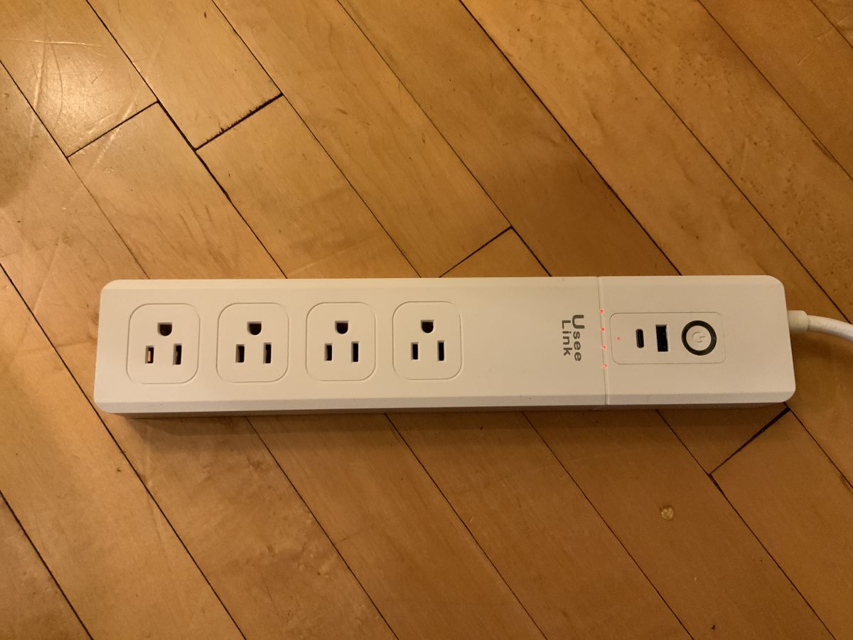

  • Tuya Usee Link USB-C PD Surge Protector SM-306U-PA65 uses a BK7231N CBU board with a JSON pin setup for its relays and LEDs.
  • The pin map assigns GPIO 6, 7, 8, 9, and 24 to Rel1–Rel5, GPIO 17 to LED6, GPIO 22 to Btn_Tgl_All8, and GPIO 28 to WifiLED7.
  • Keywords identify it as a 4-port USB-C PD powerstrip, and the configuration file includes the device image and wiki link.
  • White Usee Link USB-C PD power strip with four outlets on a wooden floor.
    JSON file for the realys, and leds.
      "vendor": "Tuya",
      "bDetailed": "0",
      "name": "Usee Link USB-C PD Surge Protector",
      "model": "SM-306U-PA65",
      "chip": "BK7231N",
      "board": "CBU",
      "flags": "1024",
      "keywords": [
        "USB-C PD",
        "4-port",
        "Powerstrip"
      "pins": {
        "6": "Rel;1",
        "7": "Rel;2",
        "8": "Rel;3",
        "9": "Rel;4",
        "17": "LED;6",
        "22": "Btn_Tgl_All;8",
        "24": "Rel;5",
        "28": "WifiLED;7"
      "command": "",
      "image": "https://obrazki.elektroda.pl/7345684300_1704571106_thumb.jpg",
      "wiki": "https://www.elektroda.com/rtvforum/topic4026639.html"

    You may also consider using click events script for this device. See:

TL;DR: This setup maps 5 relays and one shared button for users flashing the Tuya Usee Link SM-306U-PA65. An expert note says, "You may also consider using click events script" when one button must handle more actions than a plain template exposes. Use the JSON to assign pins 6, 7, 8, 9, 17, 22, 24, and 28, then add click events if you want double- or triple-click behavior. [#20895508]
