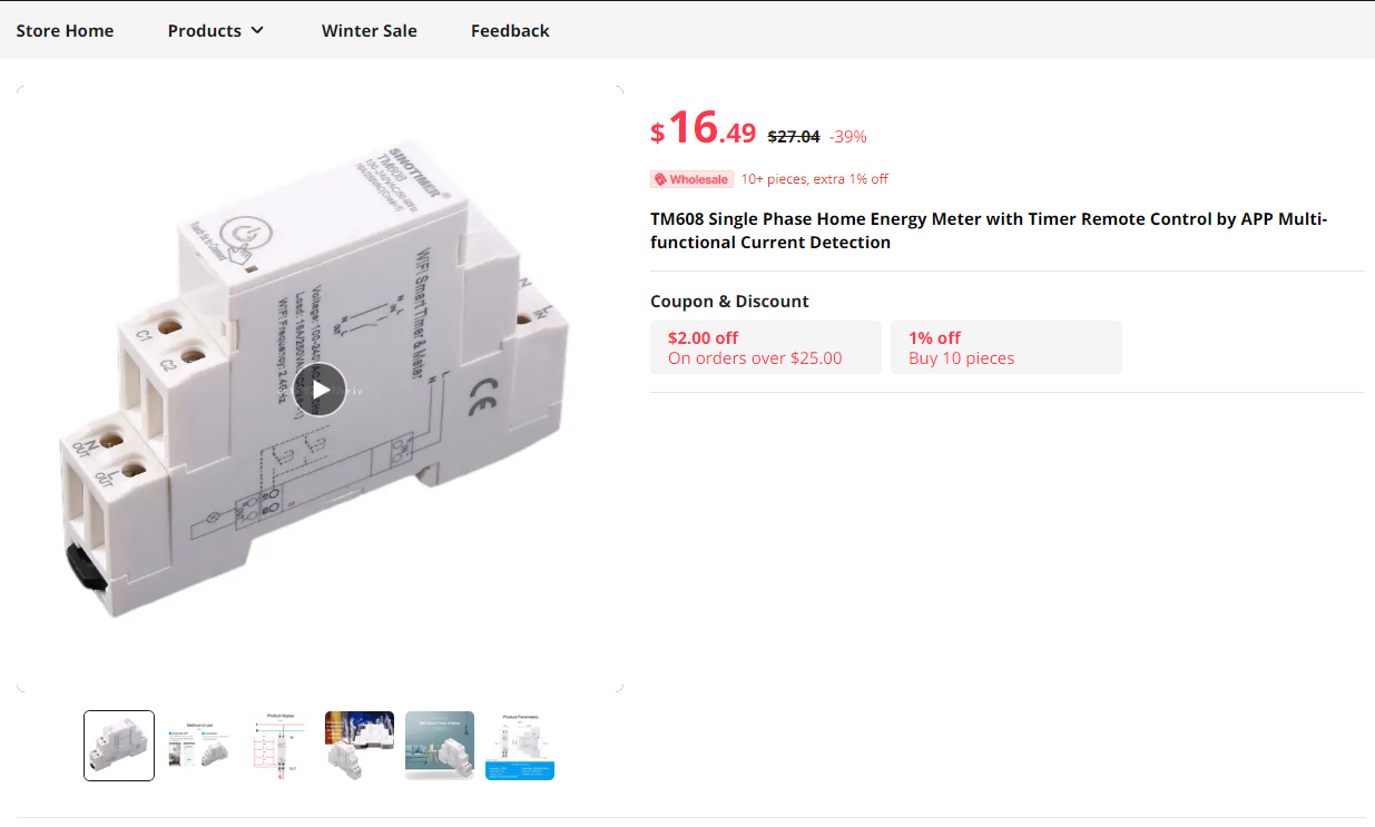

    I got one Sinotimer TM608 Smart Timer and Meter. This is more or less a typical Tuya device. I needed one in DIN rail form factor, so I bought it on Ali, like this one: https://www.aliexpress.com/item/1005006346759481.html
    Image of the Sinotimer TM608 smart timer and energy meter.
    I am not a handyman, so I gave tuya cloudcutter a chance.
