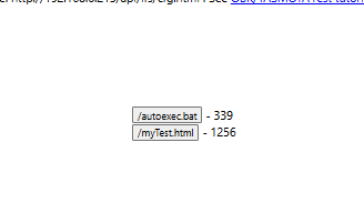

    I tried to build a small shell script to do the minification using my laptop by accessing the API's given for the tools.
    It works except I am having an issue with the large chunk of javascript found in filesystem.vue.
    Anyway that is trivial as I don't mind having to do that manually.
    With your help I now have a means of running OpenBK devices in a closed WiFi network and have access to Logs & Filesystem interfaces for on and off maintenance.
    I even tested configuring the other devices also to use same FS. So these files need to be stored in one device only.
    I also have Tasmota device with a RTC and it is running a NTP Server.
    So for my specific closed network I can now freely add more OpenBK devices.

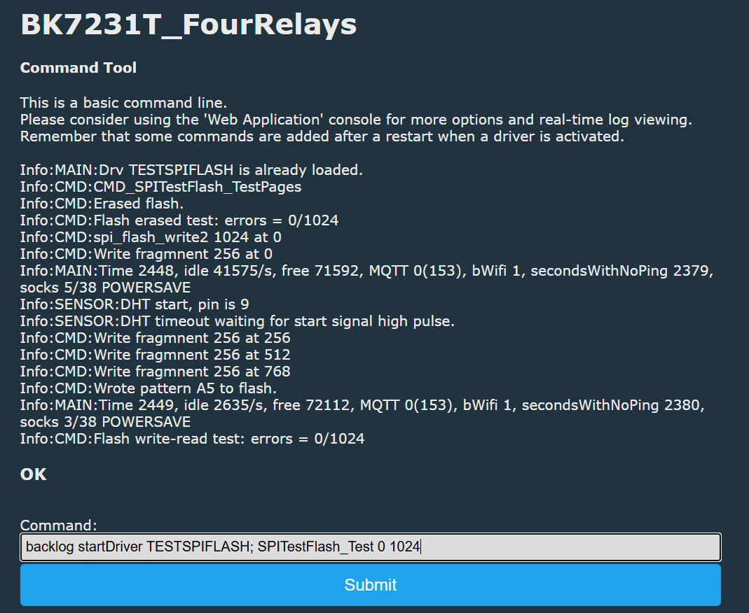

    It seems it's almost working. Currently I decided to hardcode LFS switch to SPI chip, but I am not sure.... but still, who else would use it? It's in obk_config.h
    Hosting OpenBekenIOT Web App's 'Logs' function in the LittleFS of the Device (BK7231T)
    I am doing final fixes, then I will check if it's even useable in current state.

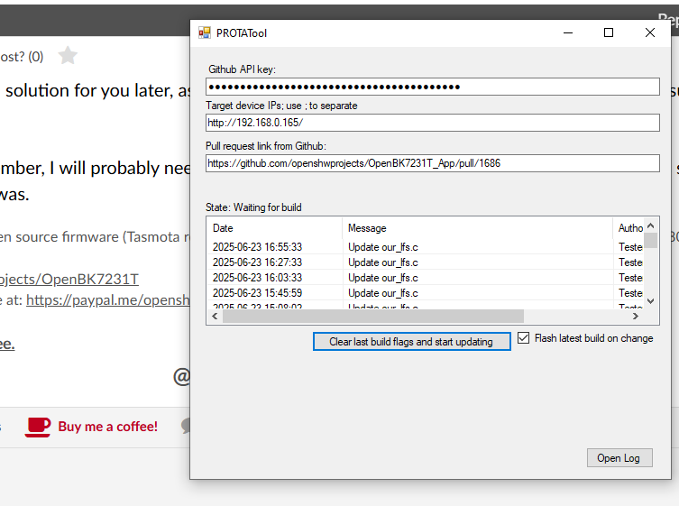

    I can think about SD card solution for you later, as @insmod also requested it, but for my target purpose (measurements storage for history) flash chips are perfect.
    However, as far as I remember, I will probably need to pick some existing FAT32 library for SD card. Still, it was some time since I did SD card support on PIC32 or whatever it was.
    PS: I love this tool:
    With this (and OBK simulator) I can developer for OBK even while extremaly low on free time.

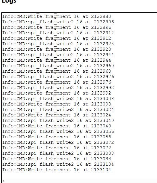

    Added after 4 [minutes]:
    Interesting, it writes in 16 byte chunks internally.
    Added after 13 [minutes]:
    http_rest_post_lfs_file has a delay... inside,

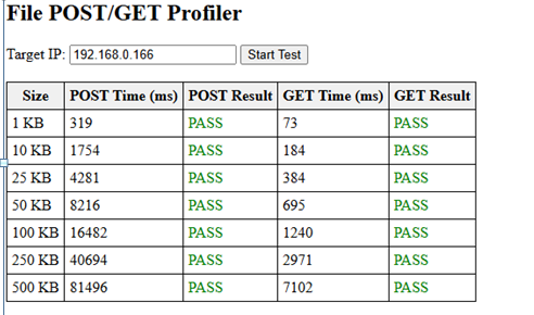

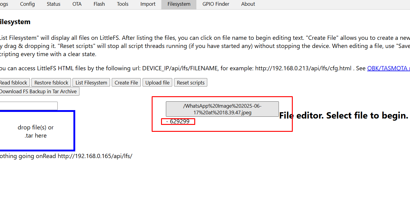

    600 kB file uploaded... but it took way too long.
    I am using my own SPI write/read bitbang code (not yet optimized, I am going to optimize it A LOT) and I write to it through LittleFS

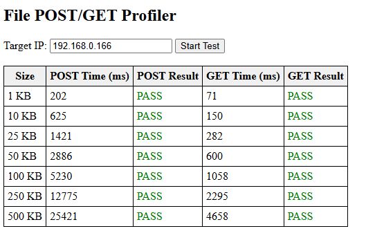

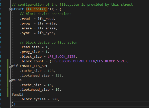

    I think the 16 byte writes are caused by LFS cache limited to 16 bytes. I will try increasing it. Maybe we should also increase it in the main tree?
    Added after 30 [minutes]:
    Comparison, first with 16 cache, second 128. LFS on Software SPI Flash.

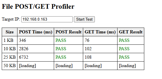

    For comparison - stock OBK. LFS on internal flash with cache 16. Crashed on the last entry.

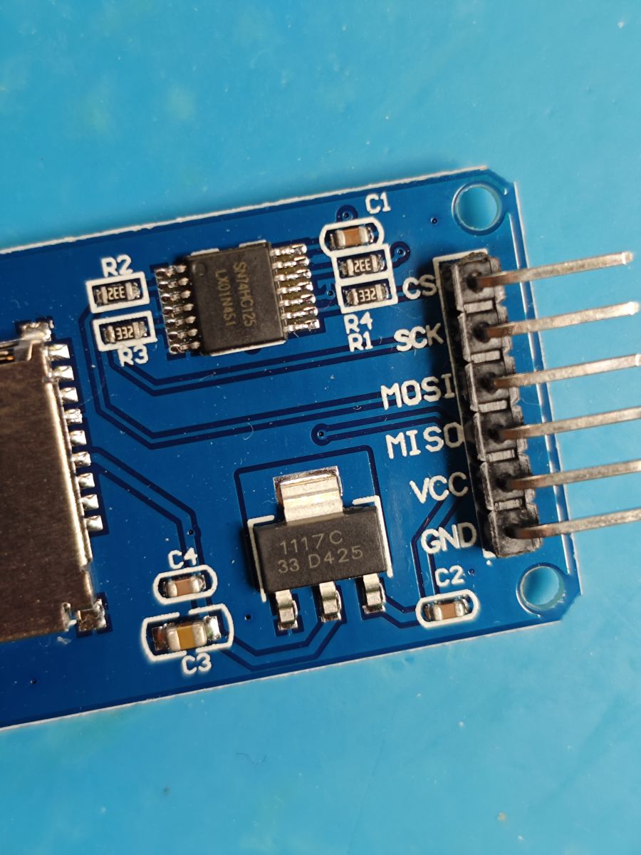

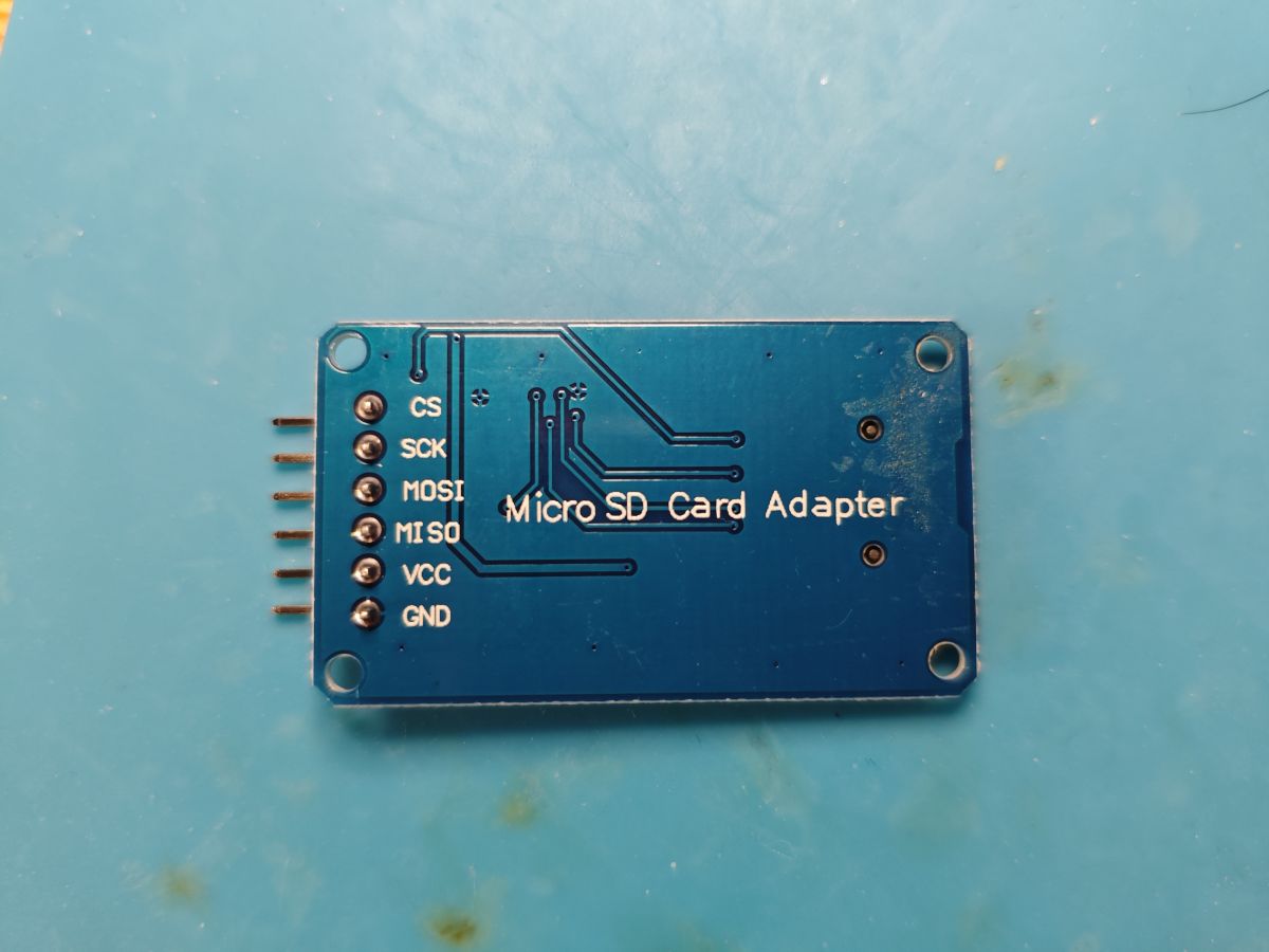

    divadiow wrote:
    I do have BK7252N/U, TXW817 (😁) and of course XF16 cams with micro-SD in place
    :D
    MicroSD card reader module on a blue PCB Micro SD card adapter with six pins labeled CS, SCK, MOSI, MISO, VCC, GND
  • #59 21654251
    Posts: 14770
    Rate: 12913
    What is this chip on board? Voltage levels converter?
