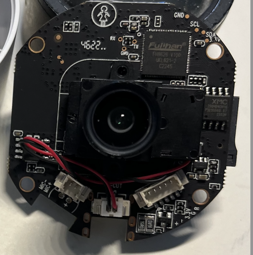

    I purchased the indoor IP camera Packaging of an indoor IP camera with a phone app.
    And it was simple to open. ..... Interior of an IP camera showing a PCB with components.
    I was hoping to find a little sub PCB as I found in the LS9a power plug, but this is a different item. I checked out the components on the PCB and came to the following set:

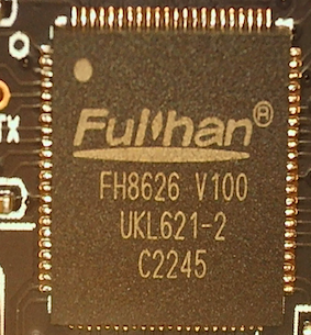

    FH8626V100: 1080P IP Camera SoC
    https://fullhan.com/en/uploads/2021/11/163722473694644.pdf
    Close-up of Fullhan FH8626 V100 integrated circuit on a PCB.

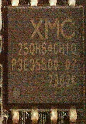

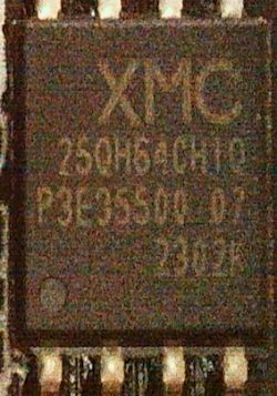

    XM25QH64C 3V 64M-BIT SERIAL FLASH MEMORY WITH DUAL/QUAD SPI & QPI Close-up of a chip labeled XMC on a PCB.

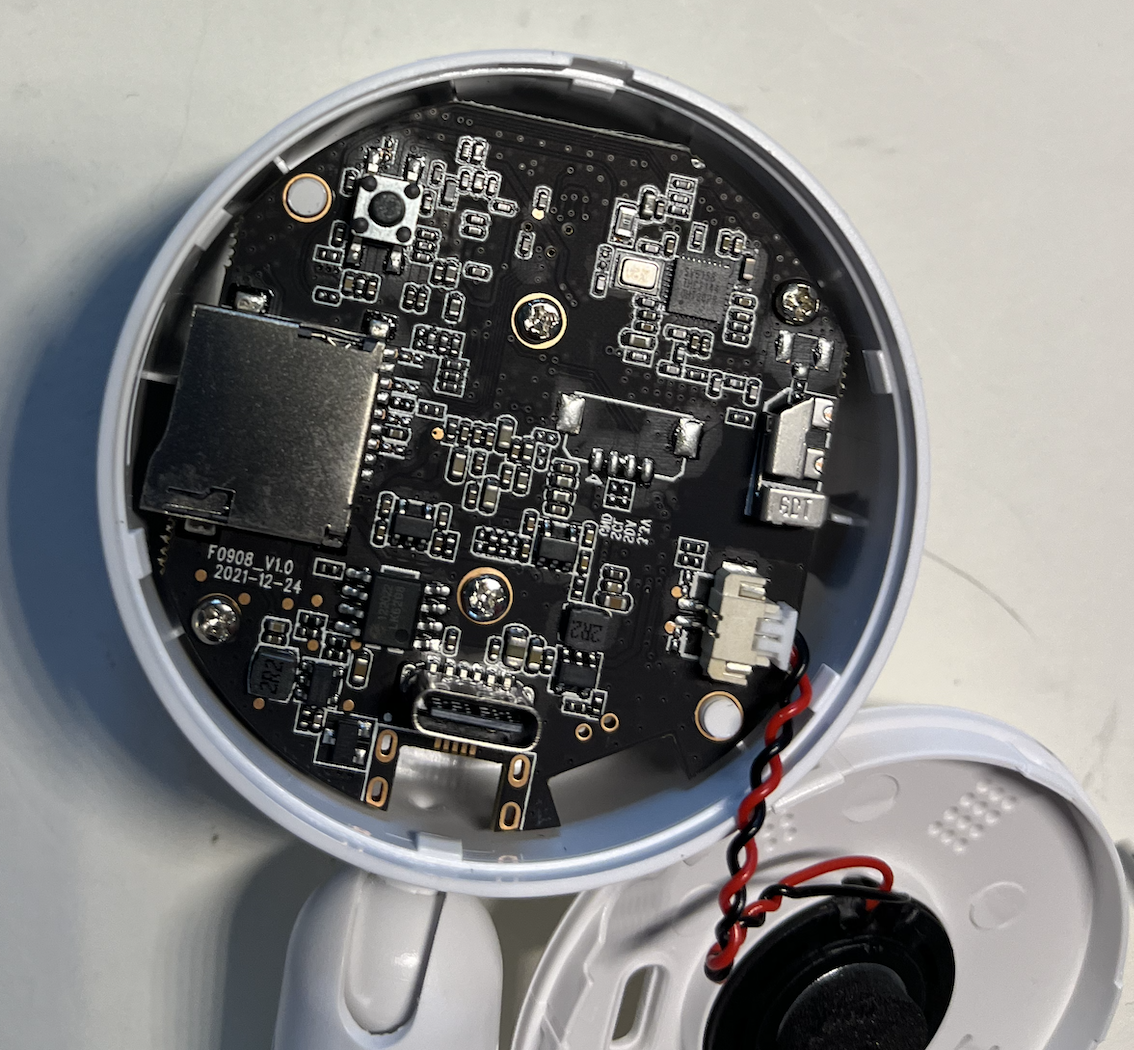

    On the PCB, I see possibly some connection to flash the system... However, I am currently completely in the dark as to how to get into this system and modify or recreate some firmware
    Close-up of a PCB with components from an IP camera.
    I would very much appreciate some help or suggestions as to how I (we) could proceed
