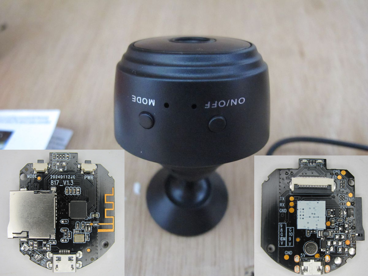

  • A Feb 2024 FTY A9 WiFi Mini Camera variant uses a Taixin TXW817-810 MCU and a black PCB marked 20240112JC 817_V1.3.
  • Inside, it pairs the QFN48 TXW817-810 with a 640x480 SuperPix SP0A19 sensor, identified as LT1757-OA-10 V1.0.
  • DebugIO (PA9) and DebugCLK (PA10) are correctly labelled, enabling a 1 MB firmware backup with C-SKY Flash Programmer.
  • The camera is detected by ftycampro, HD IOT Camera, and YsxLite, and cam-reverse enables local use without cloud.
  • PA10 shares the blue LED, so timing is critical because GPIO switching quickly interrupts the boot-time debug window.
  • Another FTY A9 camera variation. This was bought in Feb 2024 and I no longer have record of where from exactly - Ali Express for sure. Not seen this posted anywhere I don't think, so here's some info:

    AP SSID broadcast is FTYC535866GRDBZ
    I don't know which battery it came with as I have several in a pile from a few cams.
    Inside of a round electronic device showing a PCB with a micro USB port and a microSD card slot. Disassembled camera with electronic circuit board, lens, and casing parts on a blue surface. Small modular camera placed on a blue surface. Printed circuit board with various electronic components and connectors. Printed circuit board with microSD slot, micro USB port, electronics, and antenna. A round printed circuit board with a micro USB port, a microSD card slot, and electronic components. Round printed circuit board with micro USB port, microSD slot, and built-in antenna. Close-up view of a round printed circuit board with a micro USB port, electronic components, and conductive traces. Printed circuit board with various electronic components and connectors. Close-up of a round printed circuit board with electronic components, micro USB port, and PCB antenna.

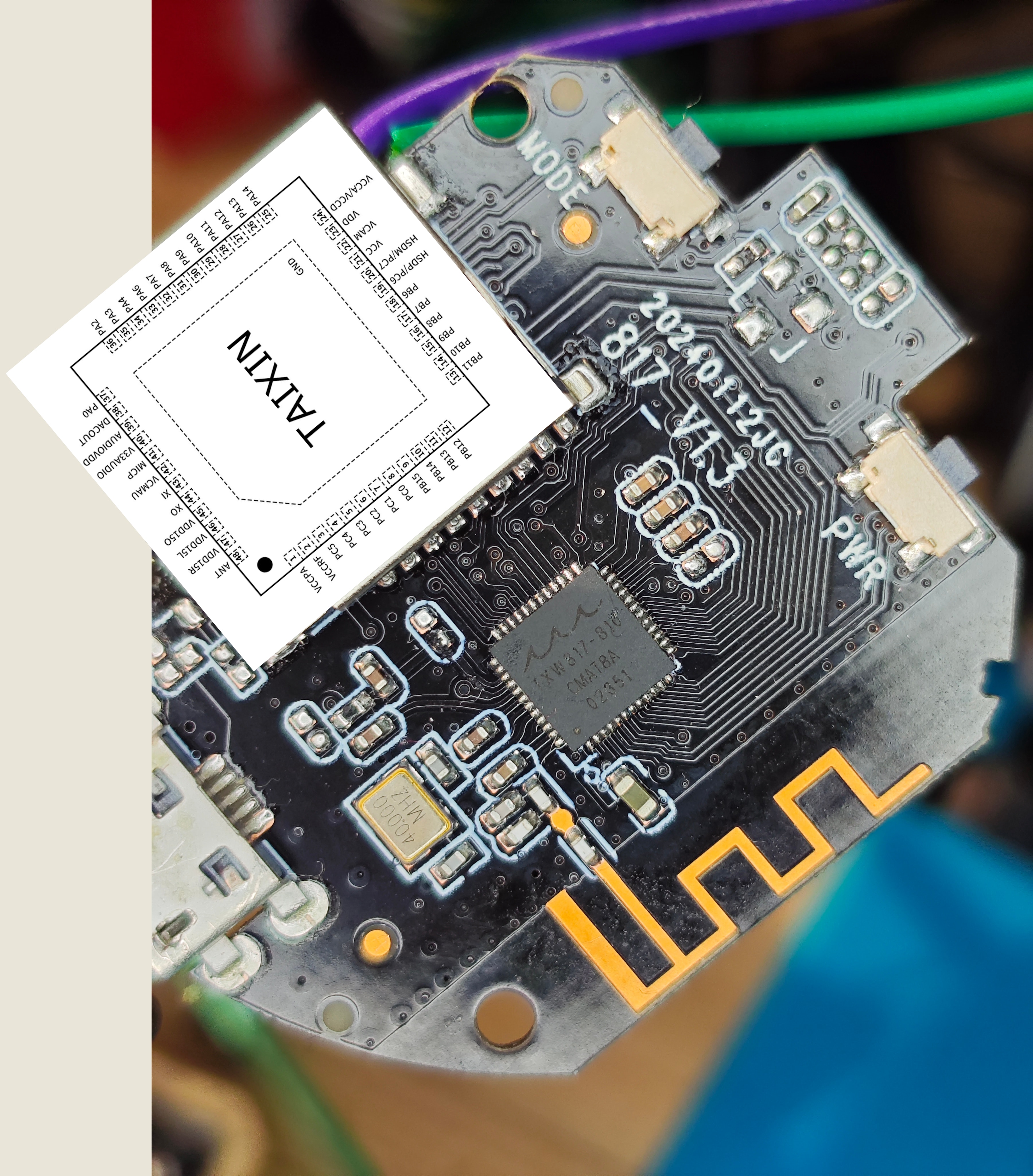

    MCU is the popular QFN48 Taixin Semi TXW817-810 - eg https://www.elektroda.com/rtvforum/topic4121456.html
    cam sensor is a 640x480 SuperPix SP0A19 (LT1757-OA-10 V1.0) also included in the XF16 cam module ID parade https://www.elektroda.com/rtvforum/topic4121965.html
    PCB markings: 20240112JC 817_V1.3
    from RX pad at 921600 baud
    For once DebugIO (PA9) and DebugCLK (PA10) are correctly labelled so a backup can be taken with those - see topic C-SKY Flash Programmer with STM32 CK-Link Lite: Reading/Writing to Taixin TXW817-810 MCU for firmware backup instructions. BUT note that PA10 is shared with the blue LED so almost immediately the GPIO switches to flashing the LED. Precise timing is required to catch the firmware before it boots far enough to change GPIO function. In the T-Head Debugging Server once connected:
    and 1mb dump with C-SKY Flash Programmer

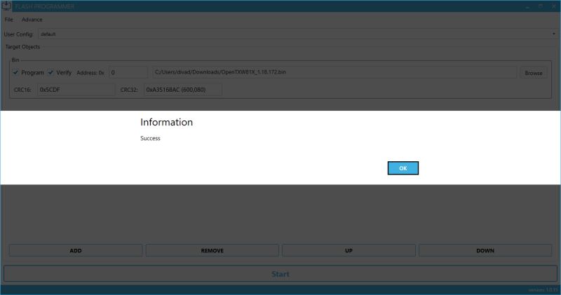

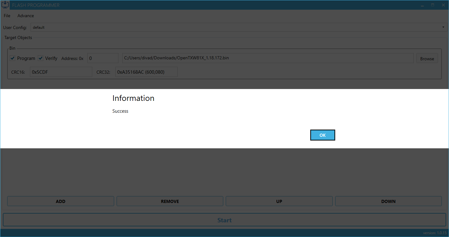

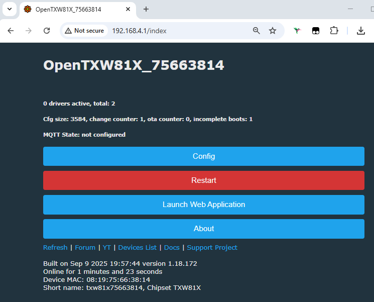

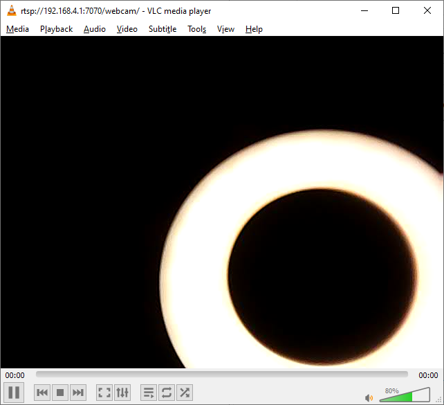

    and now for OpenTXW817
    Information: Success message after successful firmware flashing
    AP joined and browsed to at 192.168.4.1 after initial boot
    OpenTXW81X web interface at 192.168.4.1 with configuration options
    not yet got any modules detecting/streaming an image, log as txwcam is started with the sensor this shipped with (below), the SuperPix SP0A19 LT1757-OA-10 V1.0

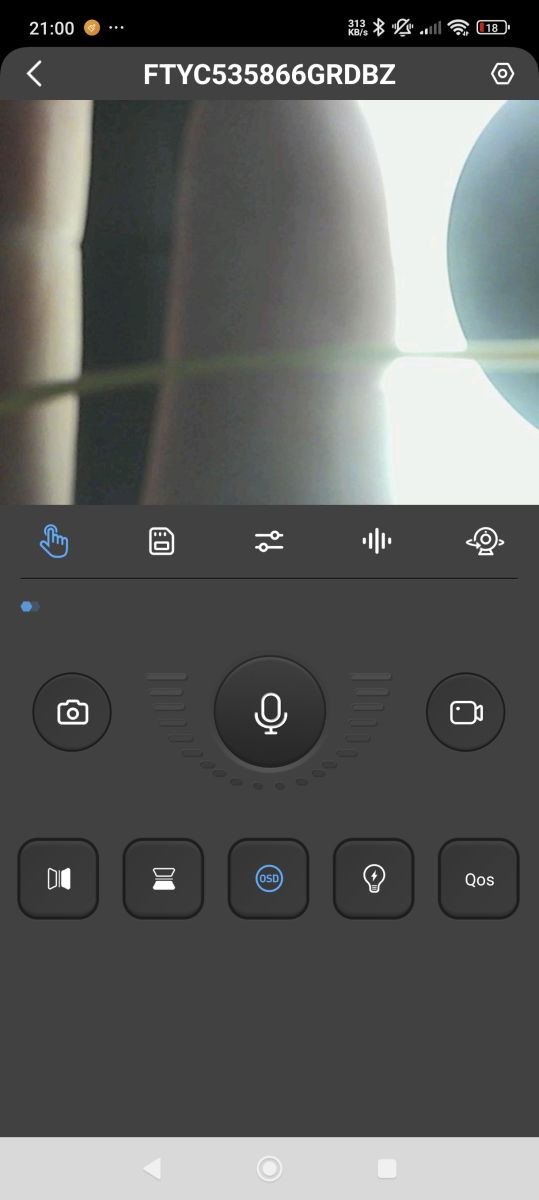

    the mic seems be OK when rtsp streaming. I'll flash back factory to be sure connector on PCB is OK.
    Added after 25 [minutes]:
    damnit. the connector seems OK.
    Camera app interface with microphone enabled and blurred lens view

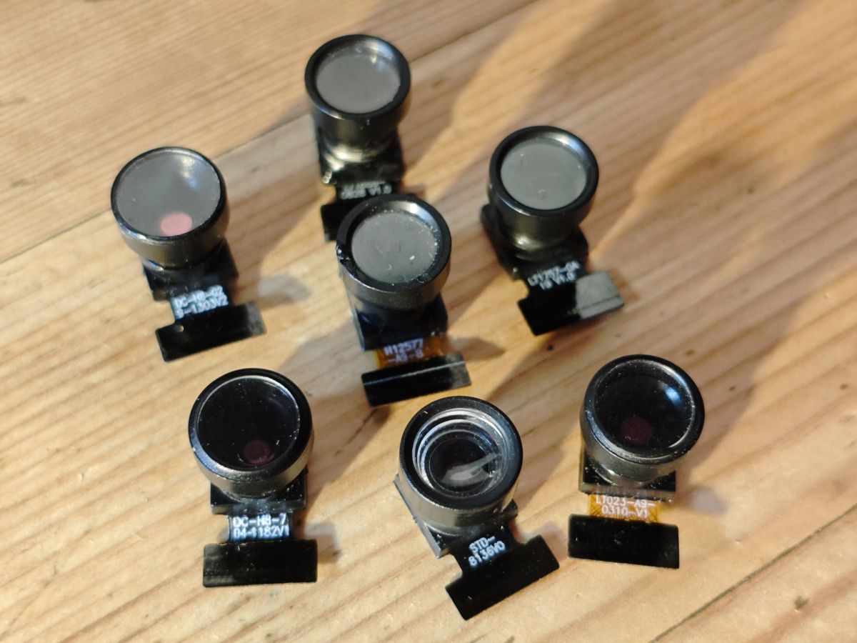

    I guess maybe they do. I was expecting some to work https://www.elektroda.com/rtvforum/topic4033757-30.html#21646042
    Seven small camera modules lying on a wooden surface
    >>21688440
    ooh ok.

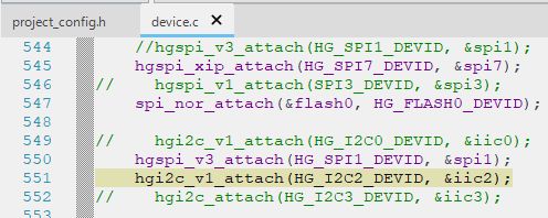

    With GPT I made an IO probe thing to see which pairs might report back an address
    https://github.com/divadiow/txw81xcam/blob/9d...6f/sdk/lib/video/dvp/cmos_sensor/csi_v2.c#L26
    no cam sensors are getting detected with
  • #10 21688807
    insmod
    Posts: 1432
    Help: 168
    Rate: 455
    I see that after PB_8/9 no other pin combinations are checked.
    Remove it from array and check again?

    negative. not yet. mostly because of:

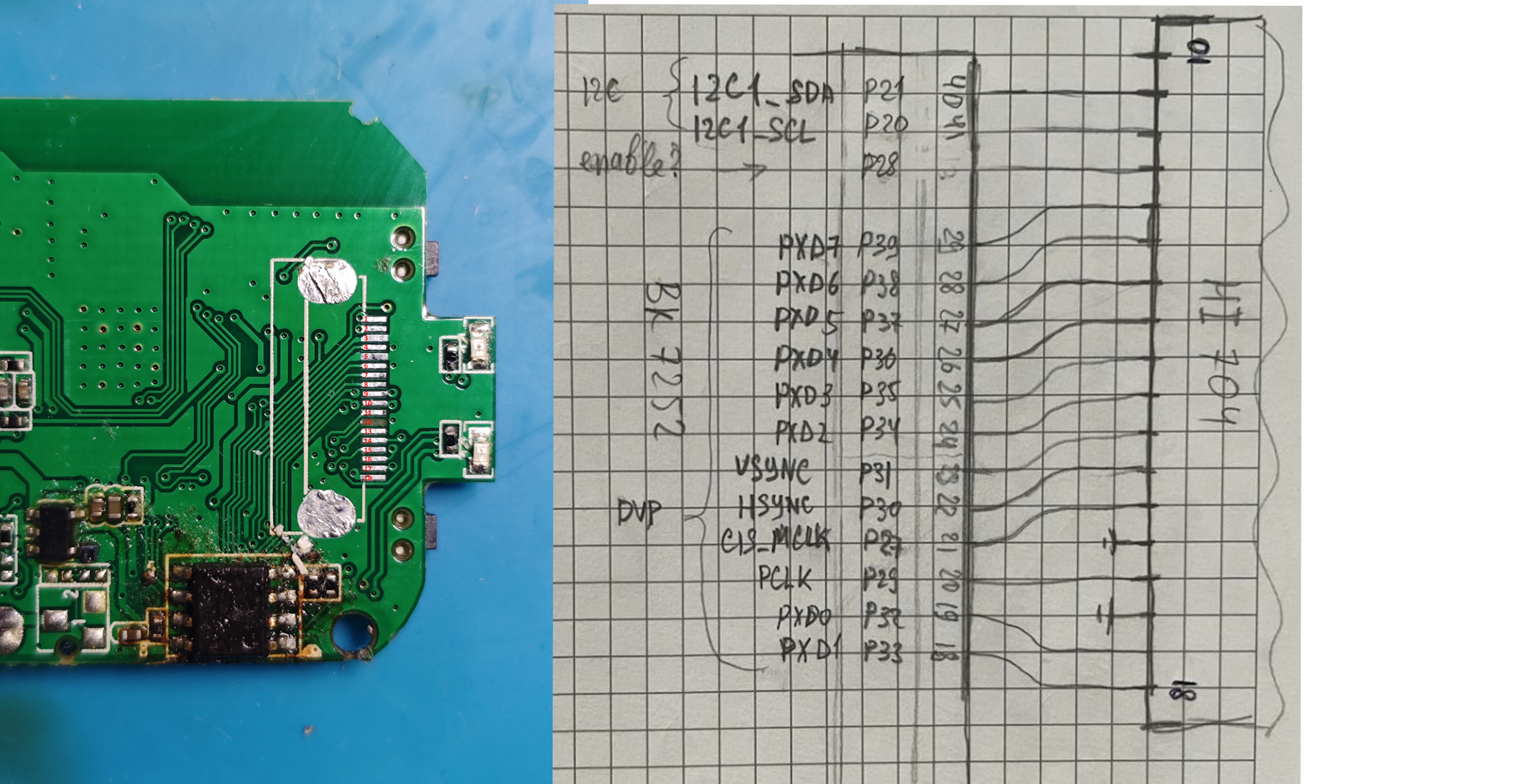

    divadiow wrote:
    most pins do seem to be routed somewhere. awkward for multimeter tracing is that the IC is on the opposite side to the cam connector
    but I'm sure I could get a thin wire on SDA right at the end. surely.
    I am aware of that diagram yes, and started one time to map it out in my own head and check it against a cleared XF16 PCB. Don't know why I didn't finish
    PCB with pins and a handwritten pinout diagram for HI704 to BK7252
  • TXW817-810 pin mapping and sensor init working

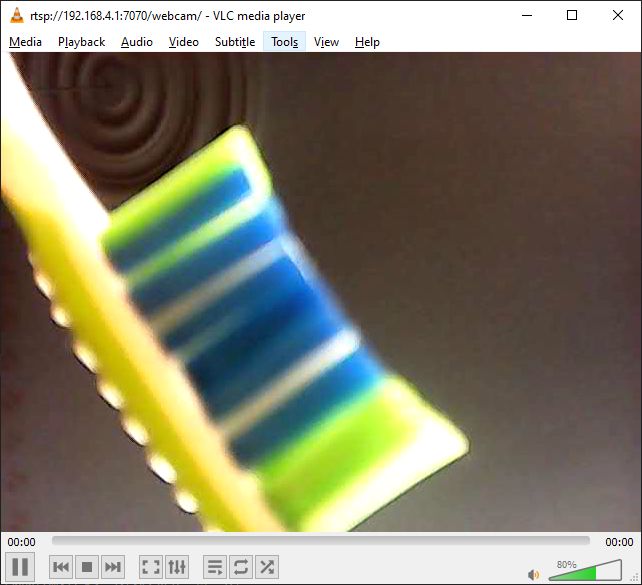

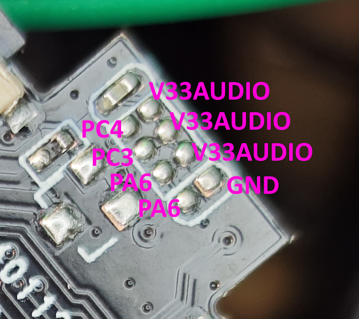

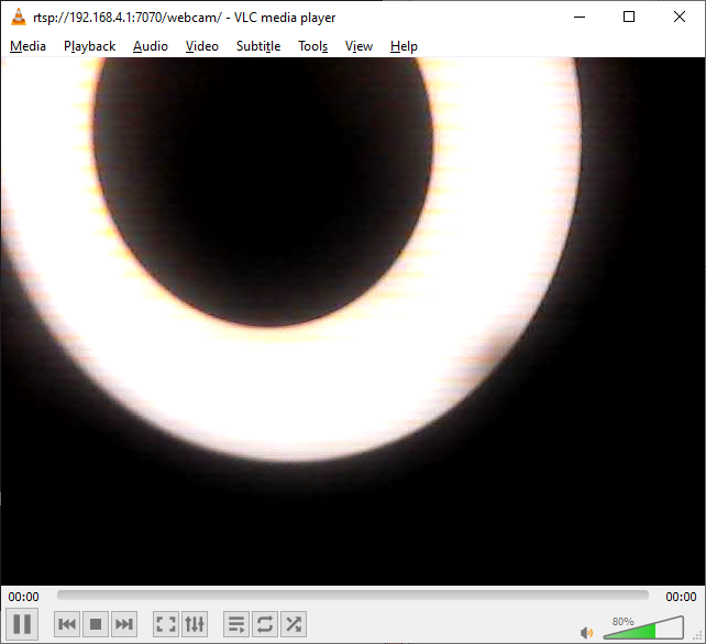

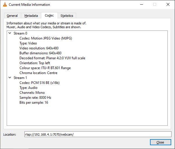

    oh my days. finally. Should have spent more time probing what other test pad looking things are on the PCB.
    these work
    Close-up of PCB with labeled pins: PC4, PC3, PA6, GND, and V33AUDIO
    Close-up of a toothbrush head with colorful bristles
    VLC window showing stream info for 640x480 video and mono PCM audio at 8000 Hz
    mic remains default

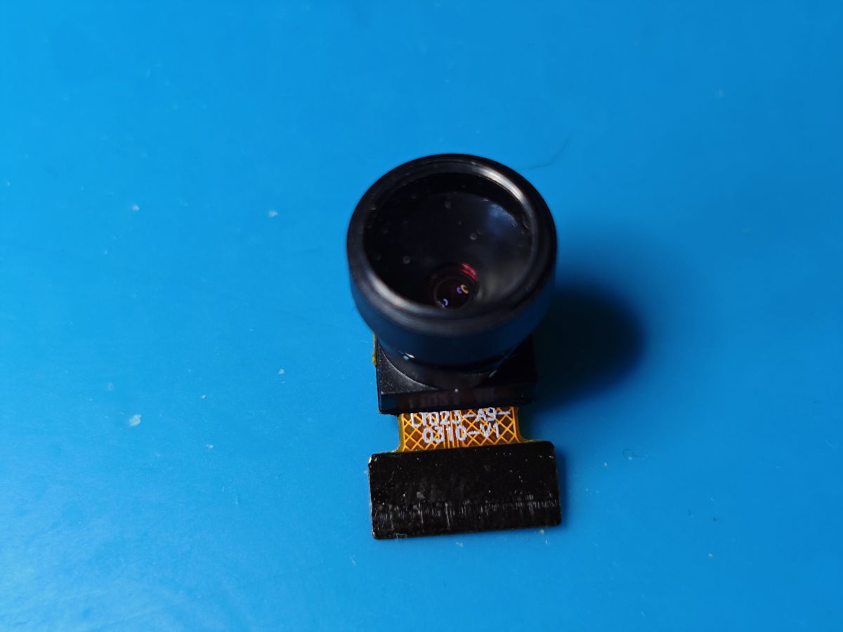

    as useful as that may appear though, this GC0310 appears to init with the GC0312 TXW driver
    FTY A9 WiFi Mini Camera 2024 Variant Details and Photos: 1mb Taixin TXW817-810, Black PCB [817_V1.3]
    Added after 8 [minutes]:
    and others that were seen to be GC0328 (for eg) on XF16 are not detected by TXW despite there being a GC0328 driver defined. I'll see if I can try to make new drivers with different init tables to see if any of these unknown modules can be made to work.

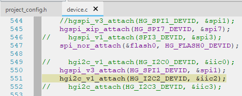

  • Soft I2C scan fails after txwcam init
    #16 21692269
    Posts: 5208
    Help: 446
    Rate: 914
    insmod wrote:
    Nope, not even close.
    insmod wrote:
    Hm, and does softi2c scan in OBK works? (without camera init ofc)
    you just get the megalist on soft scan
    is i2c2 still attached before txwcam runs?

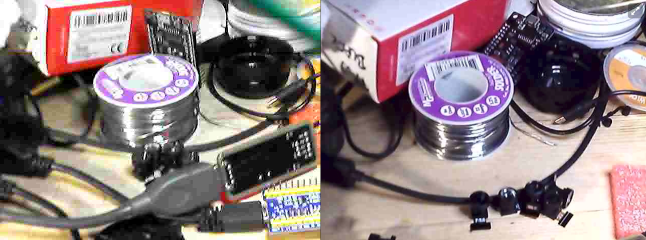

    OK, so that was with a HI704 sensor so no working driver. switched to known working cam and now no result from softscan.
    this is boot (with added info code) of working cam
    Added after 3 [minutes]:
    pick a different cam it won't match and init and we do get a scan result again
    Added after 45 [minutes]:
    in other news I seem to have a working HI704 driver. Detects and gives image anyway
    need to compare colours tomorrow maybe in daylight with XF16 or whatever pcb/firmware it came with from factory

    if assignment is wrong it'll freeze here at driver start requiring power cycle

    >>21692383
    Did you check HI704 on XF16?
    If image colours are fine on TXW, can you open a pull req with it and extended logging?
  • #22 21692966
    Posts: 5208
    Help: 446
    Rate: 914
    sadly no, hell work day. will asap
    Added after 3 [hours] 15 [minutes]:
    poor test. different angles, different subjects in frame. real pain getting images out of YsxLite and FTYpro apps.
    XF16 driver on right. HI704 /TXW on left (VLC screenshot). XF16/FTY ended up being a screenshot of the image on phone :/
  • #23 21693152
    insmod
    Posts: 1432
    Help: 168
    Rate: 455
    >>21692966
    While XF16 image looks better to me, TXW is still good enough.
  • #24 21693170
    Posts: 5208
    Help: 446
    Rate: 914
    Can always add and tweak later I guess. A proper comparison required for this and future drivers

    SoftSDA PC_4
    SoftSCL PC_3
    startdriver txwcam
