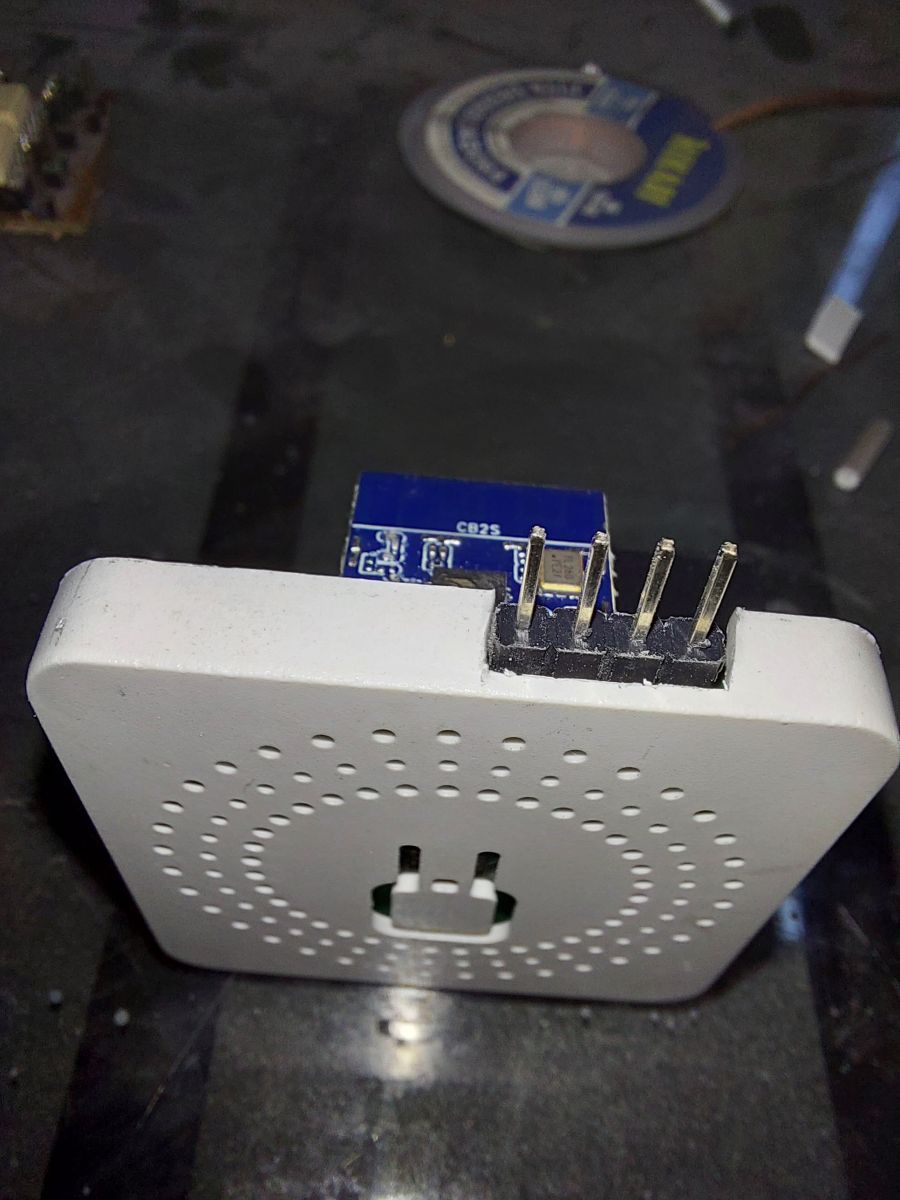

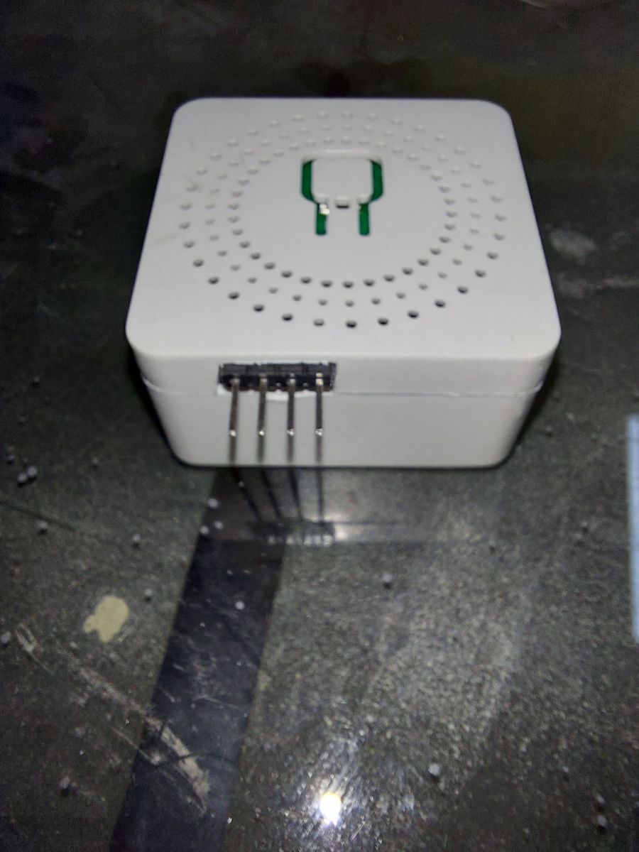

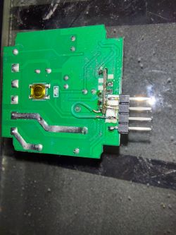

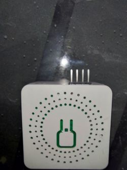

  • My first hack on this device is the possibility of using pins 6 and 7 to include functions on this device.
    It's very simple to do and all you need is a wire and a pin terminal to do it.
    With it, I will start to put other sensors to it.
    Last Topic with photos before the hack.
    https://www.elektroda.com/rtvforum/topic4003330.html
    The new photos
    Photo of a green circuit board with visible pins and wires. Close-up of a green printed circuit board with protruding pins. Close-up of an electronic board with a CB2S module and protruding pins. Electronic device with pins protruding from the side on a dark surface. Electronic device with visible pins and a symbol on the casing. Photo of a white electronic device with pin connectors on the side.
    Obs.: The white part is just a piece of paper folded to isolate and space the pins from the board

  • #2 20757128
    Posts: 14749
    Rate: 12856
    Warning! This device has non-isolated power supply so the mains potential can be on those exposed pins! Take extreme caution, avoid exposing pins in such a way, you can try to use a female header instead of male if you really need to route them out...

  • #4 20757283
    Posts: 14749
    Rate: 12856
    Apart from that, it's not that bad idea... if done in a safe manner. You can connect DHT11 or something and turn that device into an extra temperature sensor, or an extra switch, or a display (we have a support for I2C displays), etc
