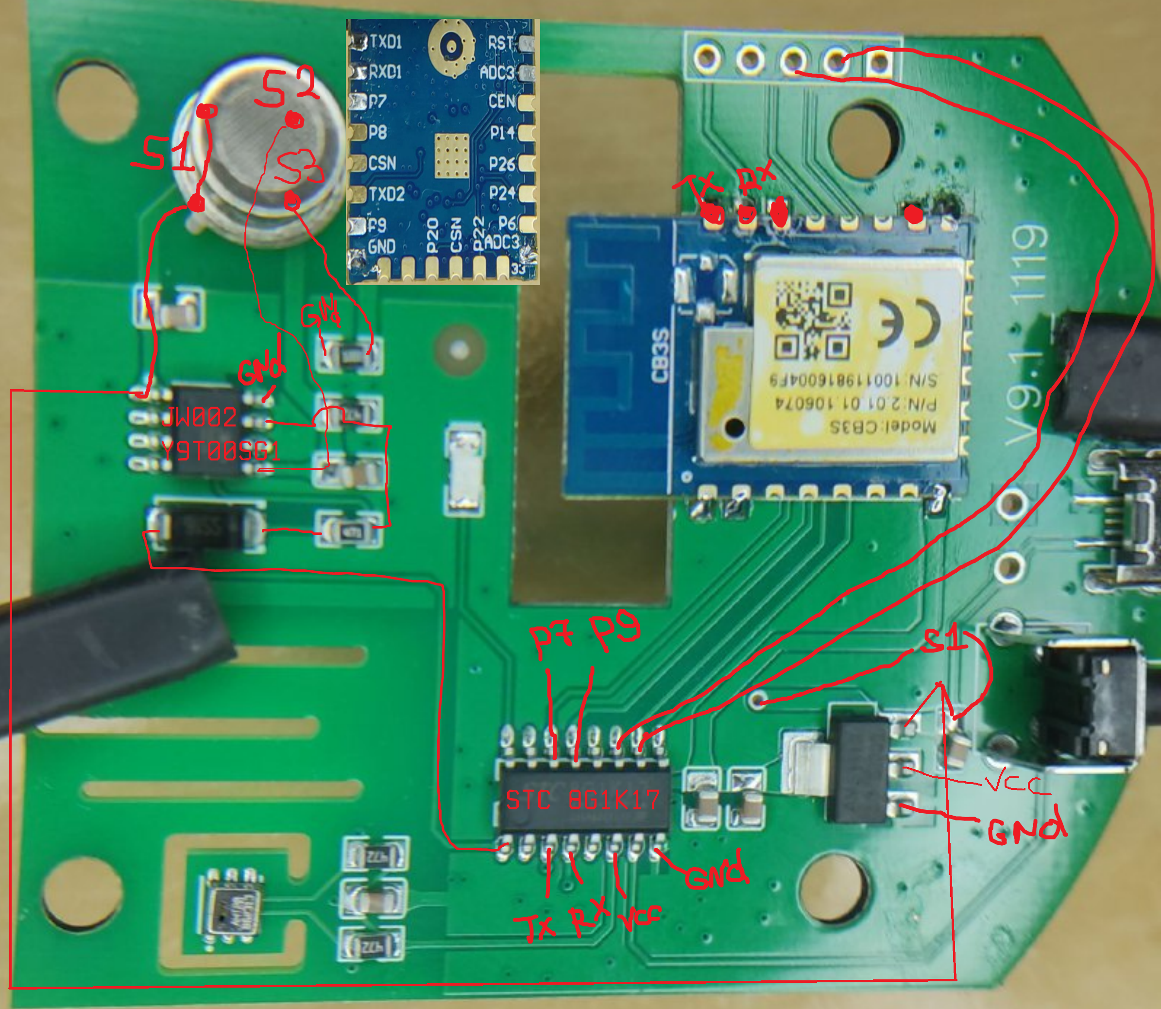

    This usb powered sensor should give 5 values.
    I was able to flash cb3s via bkn app, but no config available
    >Sorry, no meaningful pins data found. This device may be TuyaMCU or a custom one with no Tuya config data.
    >Baud keyword found, this device may be TuyaMCU or BL0942. Baud value is 9600}e
    >No module information found.
    >And the Tuya section starts, as usual, at 2023424
    White WiFi-enabled air sensor displaying its functions.
    Circuit board with pin and component markings.
    Two white air sensors on a purple background with Russian text describing 5 in 1 features.

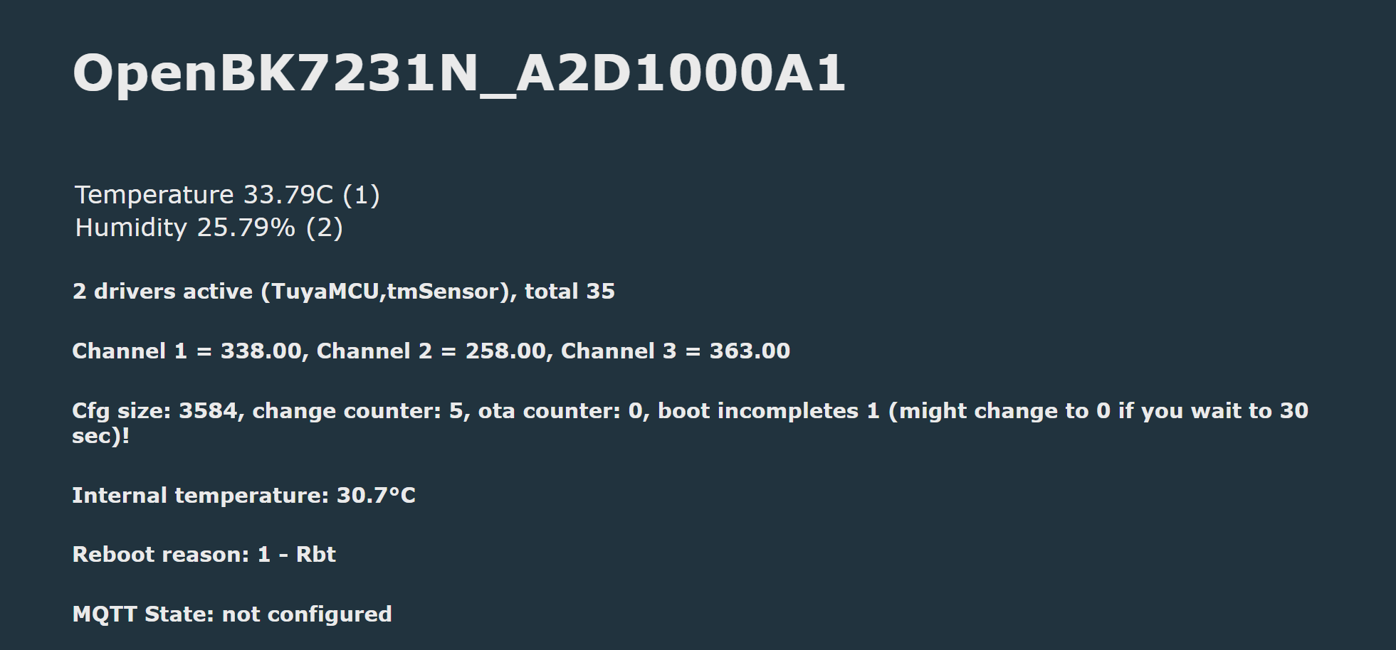

    Only 3 channels on web
    Screenshot of diagnostic information from OpenBK7231N.
    with config
    startDriver tuyaMCU
    startDriver tmSensor
    linkTuyaMCUOutputToChannel 18 val 1
    setChannelType 1 Temperature_div10
    linkTuyaMCUOutputToChannel 19 val 2
    setChannelType 2 Humidity_div10
    linkTuyaMCUOutputToChannel 22 val 3
    setChannelType 3 Custom
    SetChannelLabel 3 CO2 ppm
    setChannelVisible 3 1
    linkTuyaMCUOutputToChannel 2 val 4
    setChannelType 4 Custom_div100
    SetChannelLabel 4 HCHO mg/m^3
    setChannelVisible 4 1
    linkTuyaMCUOutputToChannel 21 val 5
    setChannelType 5 Custom_div100
    SetChannelLabel 5 VOC ppm
    setChannelVisible 5 1
    How to make Custom channels with div ?
    upd.
    with just Custom as type all values available
    Channel 1 = 334.00, Channel 2 = 252.00, Channel 3 = 594.00, Channel 4 = 3.00, Channel 5 = 6.00
