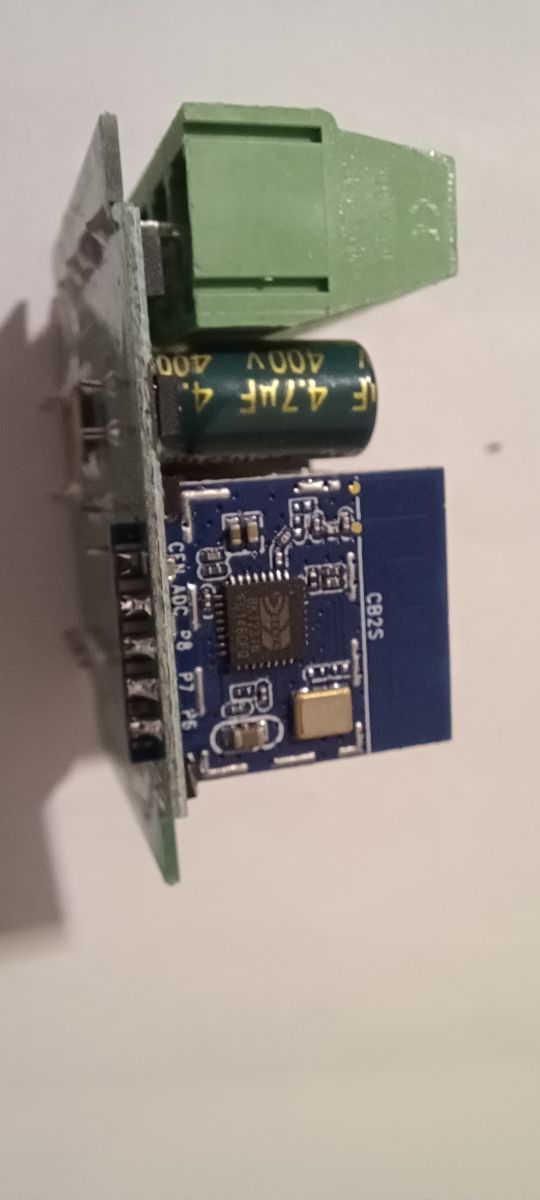

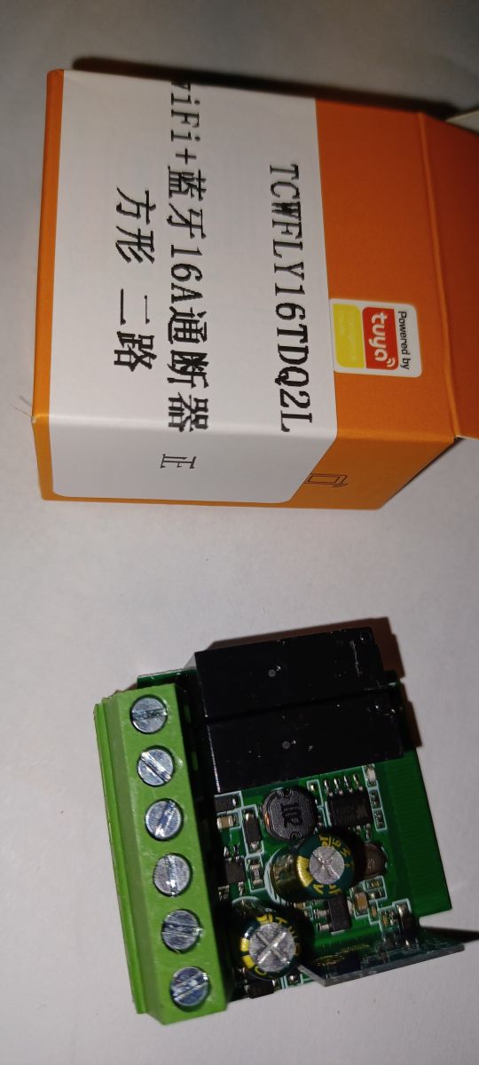

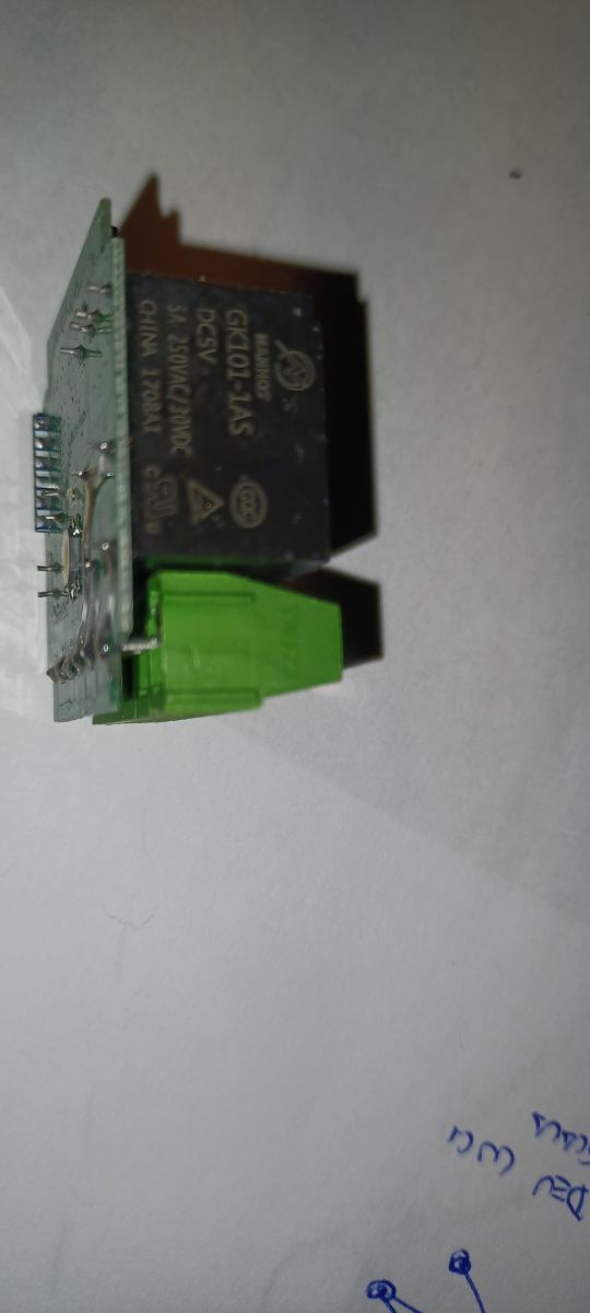

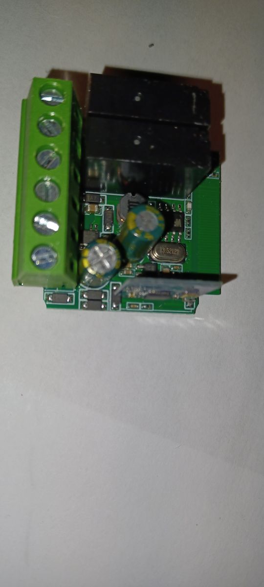

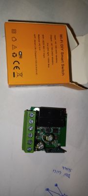

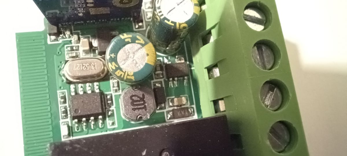

    I bought an unbranded double smart switch from Aliexpress:
    The image shows a Mini Smart Switch device with power input and output labels on the casing.
    https://it.aliexpress.com/item/10050057250229...t_main.31.21ef3696NSIW01&gatewayAdapt=glo2ita

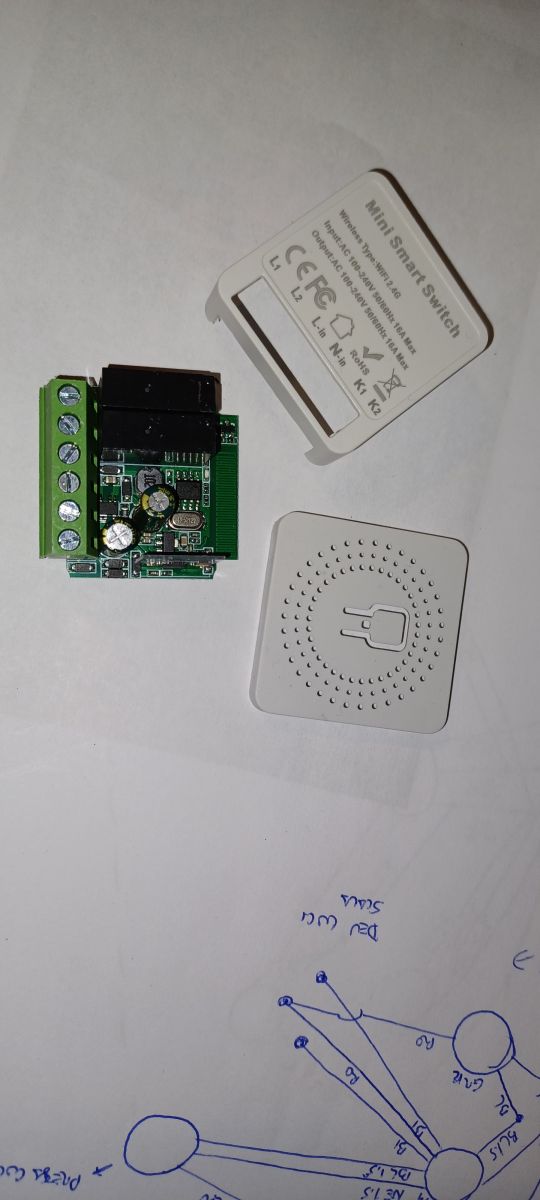

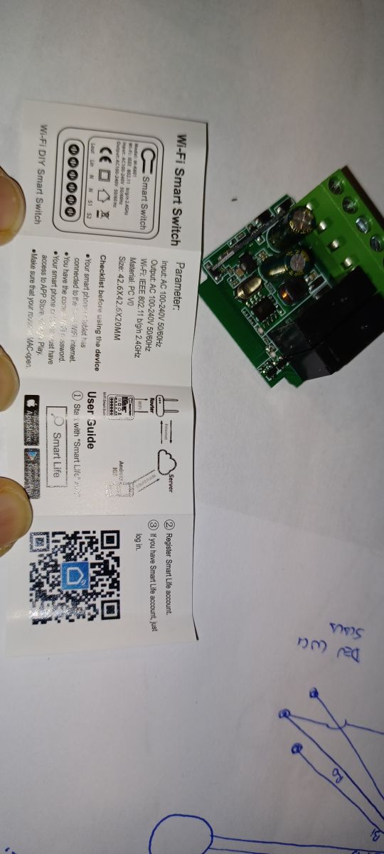

    In a short time the item arrived but with wrong manual (it is related to a single switch where the S1 and S2 must be used to turn on/off the connected device) so at the moment I do not know if I must apply a phase (L) or neutral (N) to the K1 and K2 plug.
    Here some picture:

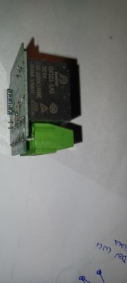

    CB2S dual switch module with cover and diagram. Dual Switch Module Wi-Fi Smart Switch with packaging. Double switch module with packaging Close-up of an unbranded dual switch module with a PCB board. Photo of a green printed circuit board with visible traces, solder points, and a small button. Close-up of the CB2S switch module electronics with a visible PCB and large capacitor. Close-up view of an electronic module with green terminals and a blue printed circuit board. Close-up of electronic components of a smart switch from Aliexpress. Close-up of an electronic module with two large capacitors and a black relay. Close-up of the user manual and circuit board of a smart dual switch module. Photo of instructions and a fragment of a circuit board for a smart switch. Photo of the CB2S dual switch module from Aliexpress, showing the circuit board and green connector.

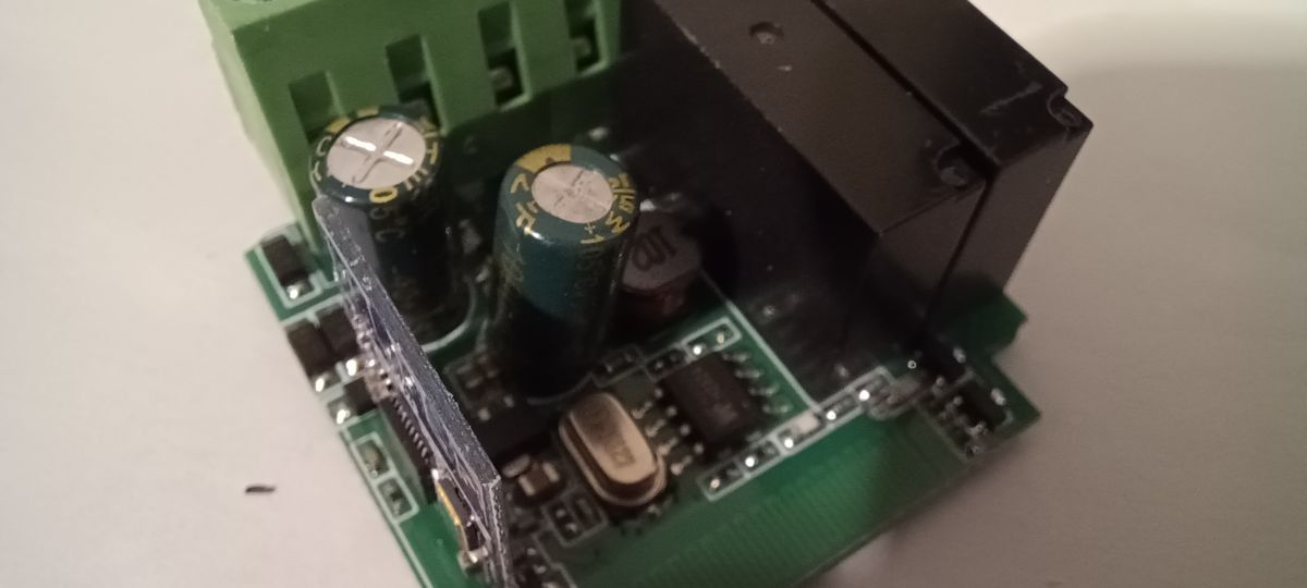

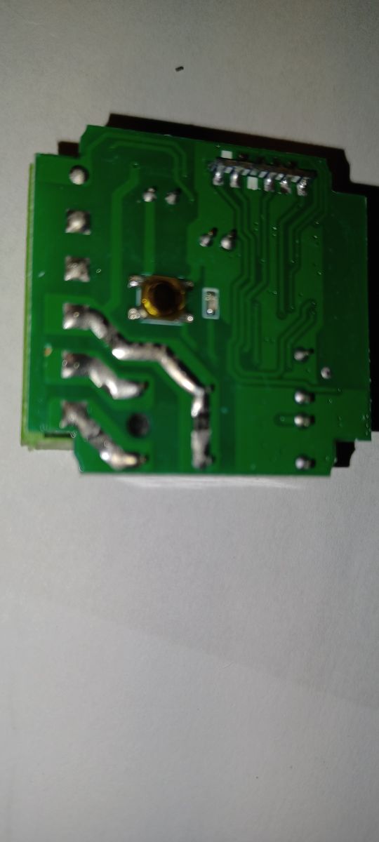

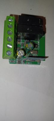

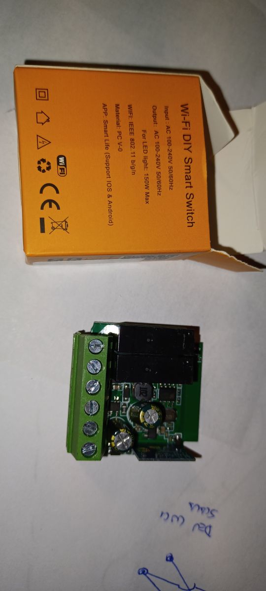

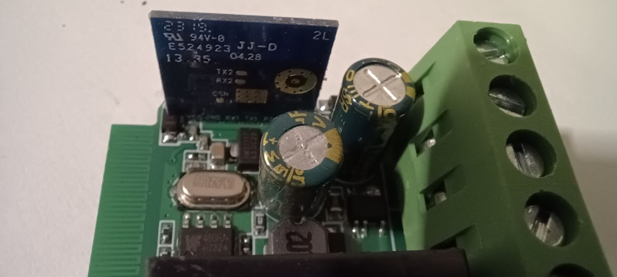

    Anyway, I haven't connect it to Chinese server and immediately I re-flash the device with this beautiful firmware (I done it with other devices). In order to do it I cut the tx signal from the board and with this modification I was able to replace the firmware without de-solder the CB2S board.
    The flash program was unable to identify the pins so I tried to find the functions with the GPIO finder menù: I found the two relè, the led and the button on the device. At the moment I do not risk to burn the device using a wrong command (L or N) to K1 and K2 plug, so I can't identify the right input but selecting the connected CB2S pins to the board as "input" sometimes cause the relè to switch on/off.
    Looking to the board I saw that there is a 480RA chip that I understood is a RF chip; it can be possible that this device has got RF capability? If yes, it is possible to understand the functionality with the original firmware?
    readResult...-40-13.bin (2 MB)You must be logged in to download this attachment.
    Someone has got the same device and can tell me if I can use the L signal to K1 and K2?
    Thanks.
    Luca

    This looks problematic indeed. If you have a wrong manual, then you don't know how to connect K1 and K2. You can only experiment or look up the similiar devices on our list:
    Here is one:
    https://www.elektroda.com/rtvforum/topic3982614.html
    Second one:
    https://www.elektroda.com/rtvforum/topic3976806.html
    No matter what you try, take extreme caution. Mains voltage is very dangerous.
    Once connected, you can use GPIO doctor to find out pin roles.
    How is that RF chip connected?

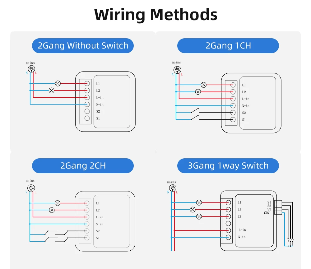

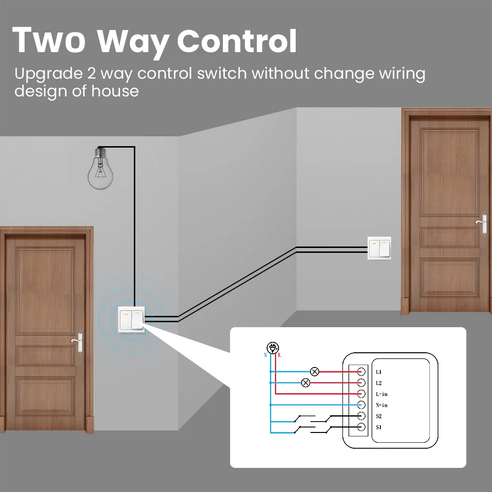

    EDIT: Your switch looks like more that:
    https://www.elektroda.pl/rtvforum/topic4026798.html
    Manual:
    Diagram of a two-way switch connection in a house.
    Wiring diagrams for different switches.
