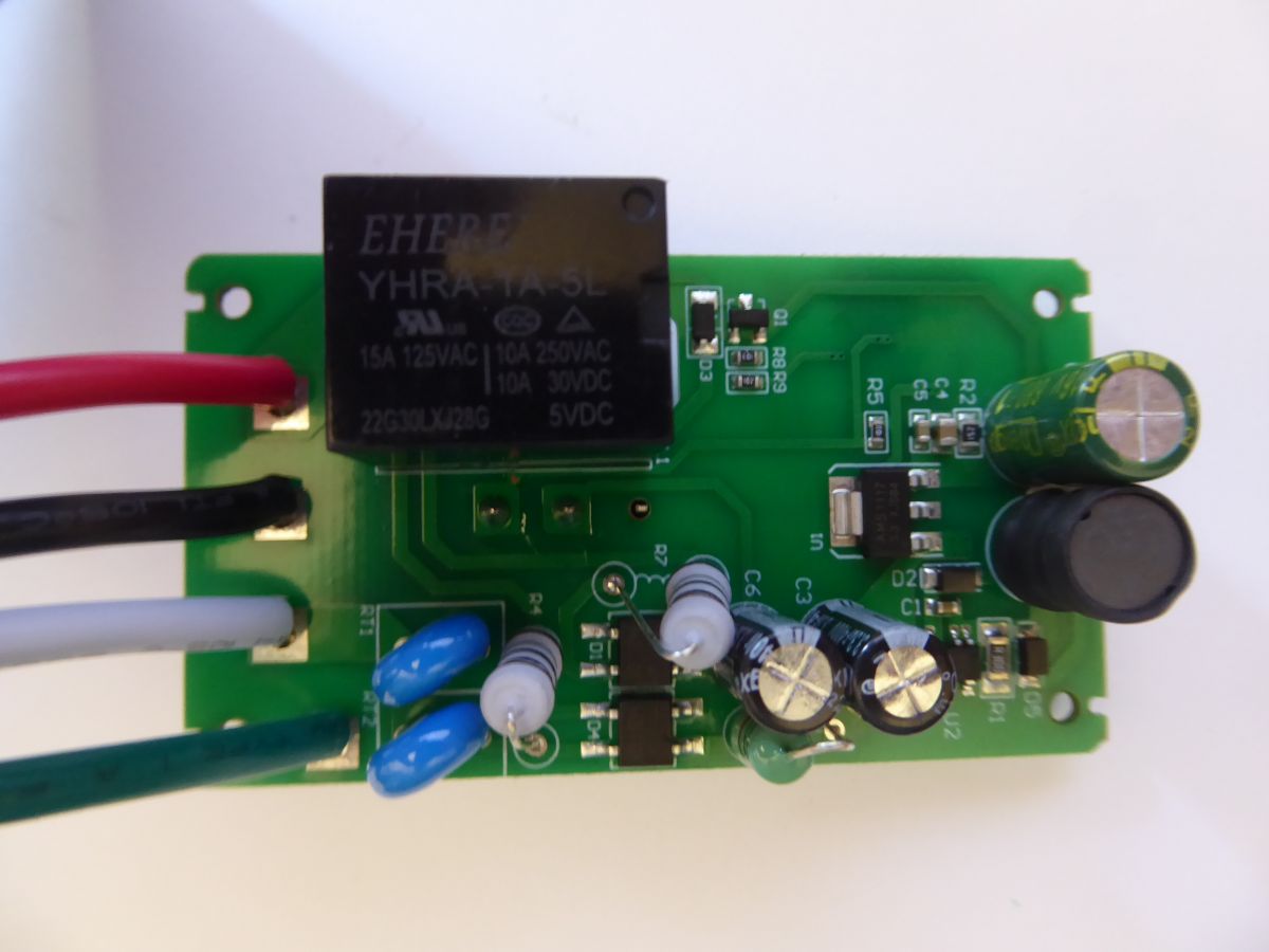

    [BK7231/CB3S] TreatLife SS01S Single pole switch with neutral, Tuya-CloudCutter remote flashing[BK7231/CB3S] TreatLife SS01S Single pole switch with neutral, Tuya-CloudCutter remote flashing[BK7231/CB3S] TreatLife SS01S Single pole switch with neutral, Tuya-CloudCutter remote flashing[BK7231/CB3S] TreatLife SS01S Single pole switch with neutral, Tuya-CloudCutter remote flashing[BK7231/CB3S] TreatLife SS01S Single pole switch with neutral, Tuya-CloudCutter remote flashing
    This Treatlife SS01S switch has been available for a while but this version bought July 2023 has the CB3S module with BK7231N chip which does not appear to be supported in tuya-cloudcutter.
    Rear label info:
    - Model: SS01S
    - Input: AC 100V-240V, 50/60Hz
    - Output: 10A Maximum Resistive Load, 5A Incandescent
    - Wireless Standard: IEEE802.11b/g/n
    - Wireless Frequency: 2.4GHz
    - FCC ID: 2ANIFSS01S
    - IC: 24572-SS01S
    - ETL US Listed
    - Intertek 5012525
    - Conforms to UL. STD. 60730-1
    - Conforms to UL. STD. E60730-1
    - Wires: Load, Live, Neutral, Ground
    Tuya app info:
    - Main: v1.1.0
    - MCU: v1.1.0
    Tuya-CloudCutter Info:
    The switch would not flash using the existing Treatlife SS01S profile stating that the exploit failed. I tried multiple profiles and finally successfully flashed to ESPHome Kickstart using interactive mode with the following:
    - Start CloudCutter Interactive mode
    - 2) Flash 3rd Party Firmware
    - > By Firmware version and name
    - > 1.1.0 - BK7231N / oem_bk7231n_dctrl_switch
    - > ESPHome-Kickstart-v23.04.28_bk7231n_app.ota.ug.bin
    - Provide power to switch.
    - Hold main button until LED starts flashing quickly which took about 7s
    - Let go of main button for 1s
    - Hold main button until LED starts flashing slowly which took another 7s
    - CloudCutter detects AP and performs exploit, asks to reboot device, Red LED turns on constant
    - Disconnect power from switch for 1s and apply power again
    - Repeat main button hold 7s , release 1s , Hold 7s until LED is flashing slow again
    - CloudCutter detects again and configures WiFi
    - Do not do anything. LEDs turn off and switch reboots after ~30s.
    - Connects to CloudCutter AP after additional 30s and installs firmware
    - Wait about 45s and look for ESPHome Kickstart AP. If it does not show up then remove power from switch and apply after 1s. Wait another 45s.
    - Connect to the ESPHome Kickstart AP. Should direct you to config page at http:192.168.4.1
    - Select or enter your Wifi Login info and click save.
    - Disconnect from ESPHome Kickstart AP (makes it reboot faster)
    - Wait 60s as it reboots and connects
    - Should see it on router, If not check if ESPHome Kickstart AP is still which probably means login info was wrong.
