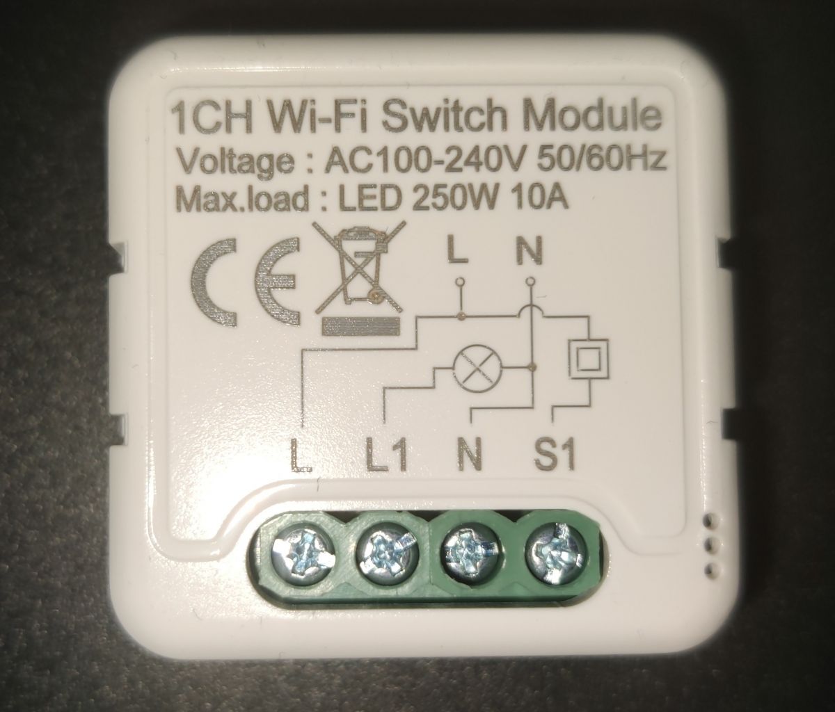

    This switch is the 1CH variant of the Gerier WiFi Switch series. It is really a small device...

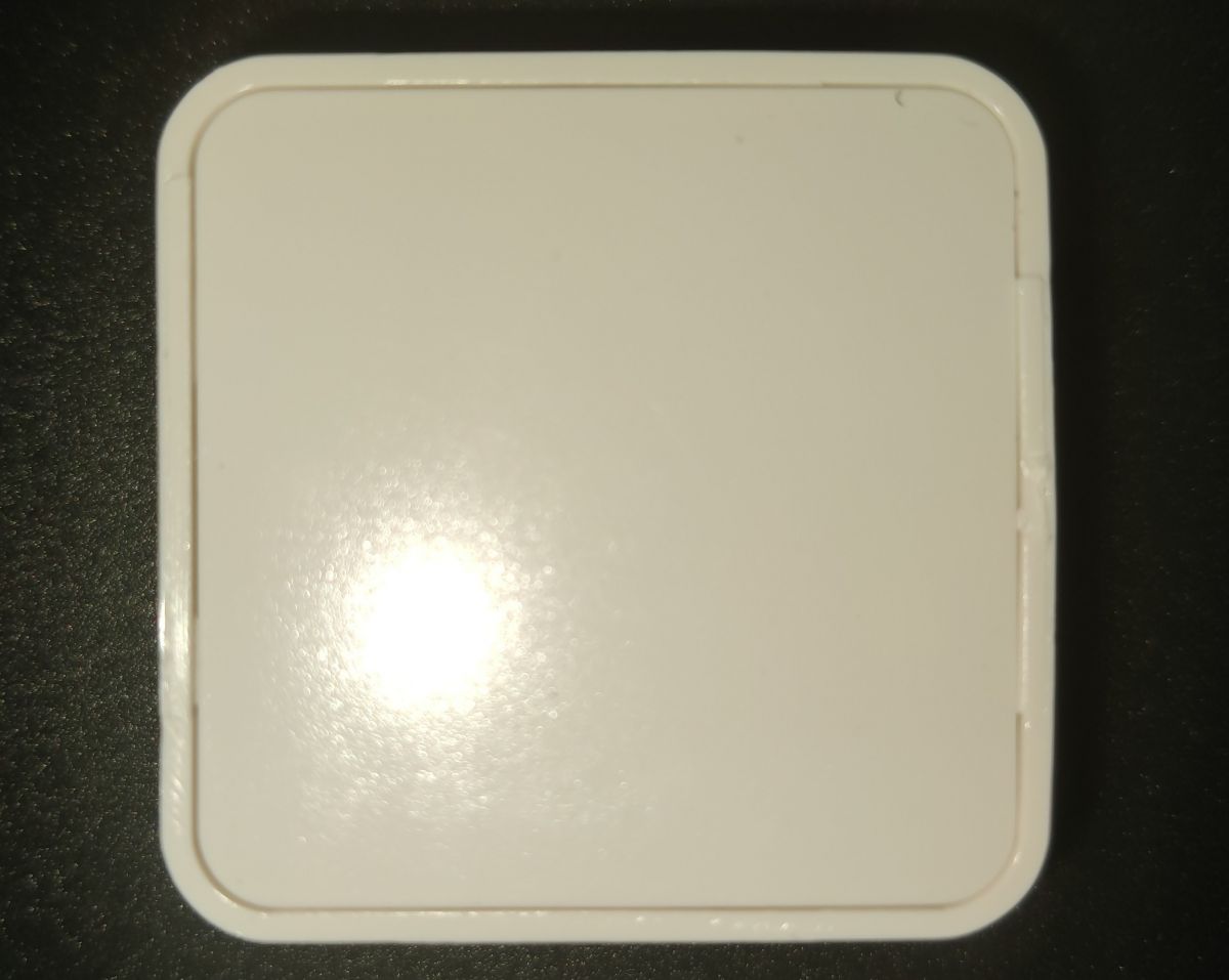

    Back of 1-channel WiFi switch module with specification label and wiring screws. Rectangular device with a white casing on a black background.

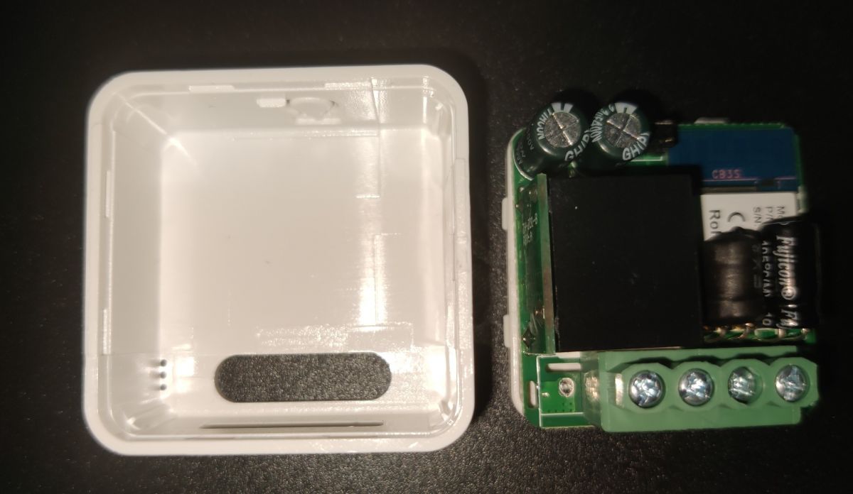

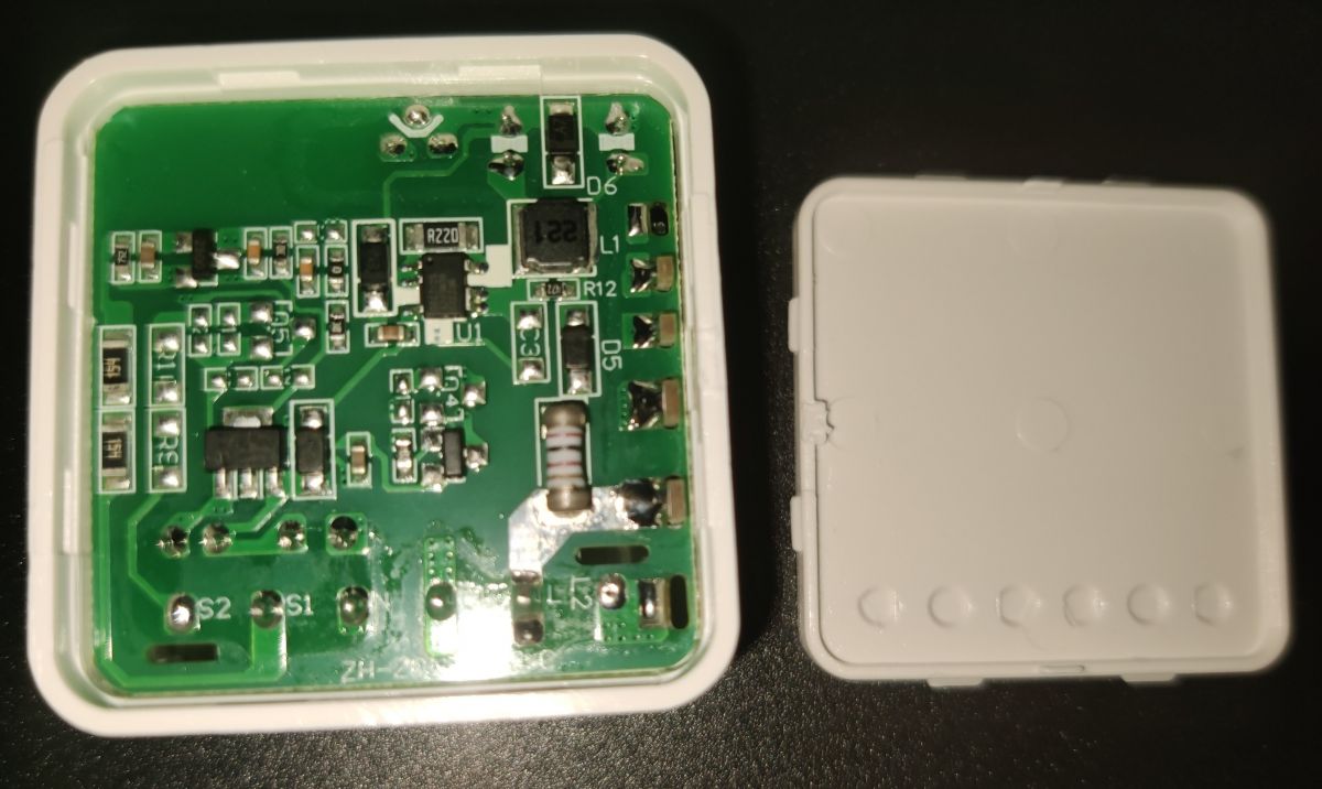

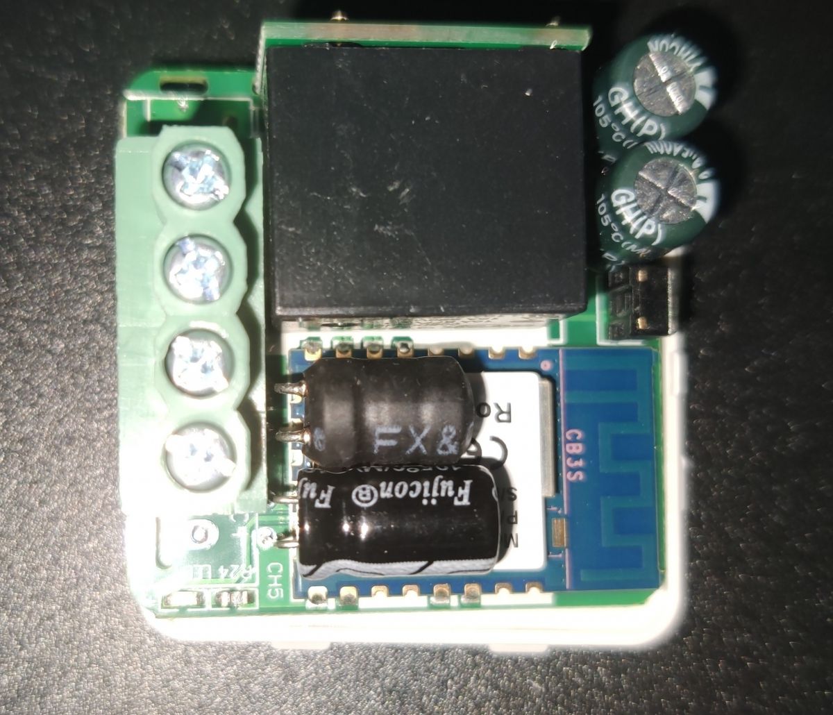

    Start the teardown by turning the device so that you have the back on top. Use a small knife to open it from any side. Just in the middle of each side you can push a small knife in and open the case without destroying it. After opening the case backside take of the PCB by pressing on the green wire screwbar.
    Image of an open 1-channel Gerier WiFi switch showing the circuit board. Opened device showing plastic casing and circuit board with electronic components. Interior of Gerier WiFi switch with visible CB3S module and electronic components.

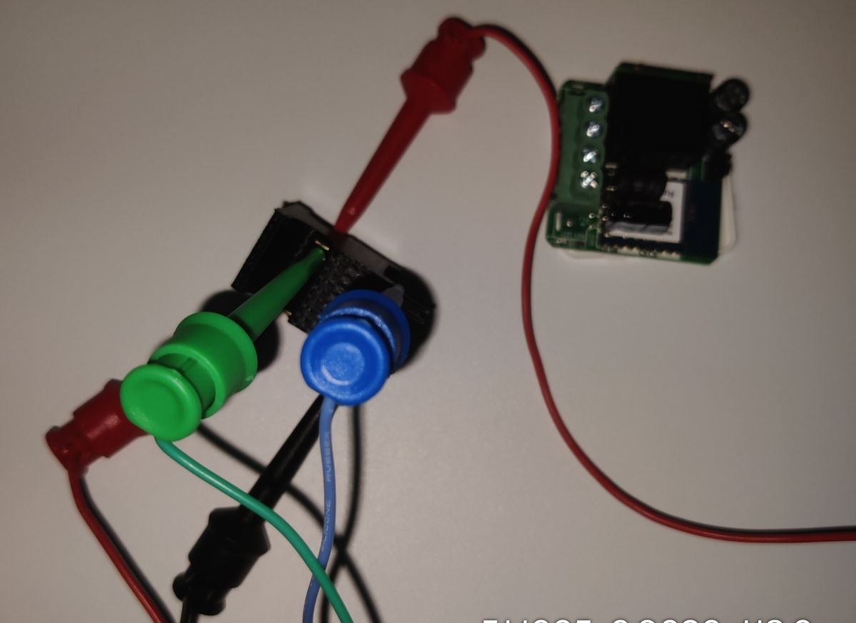

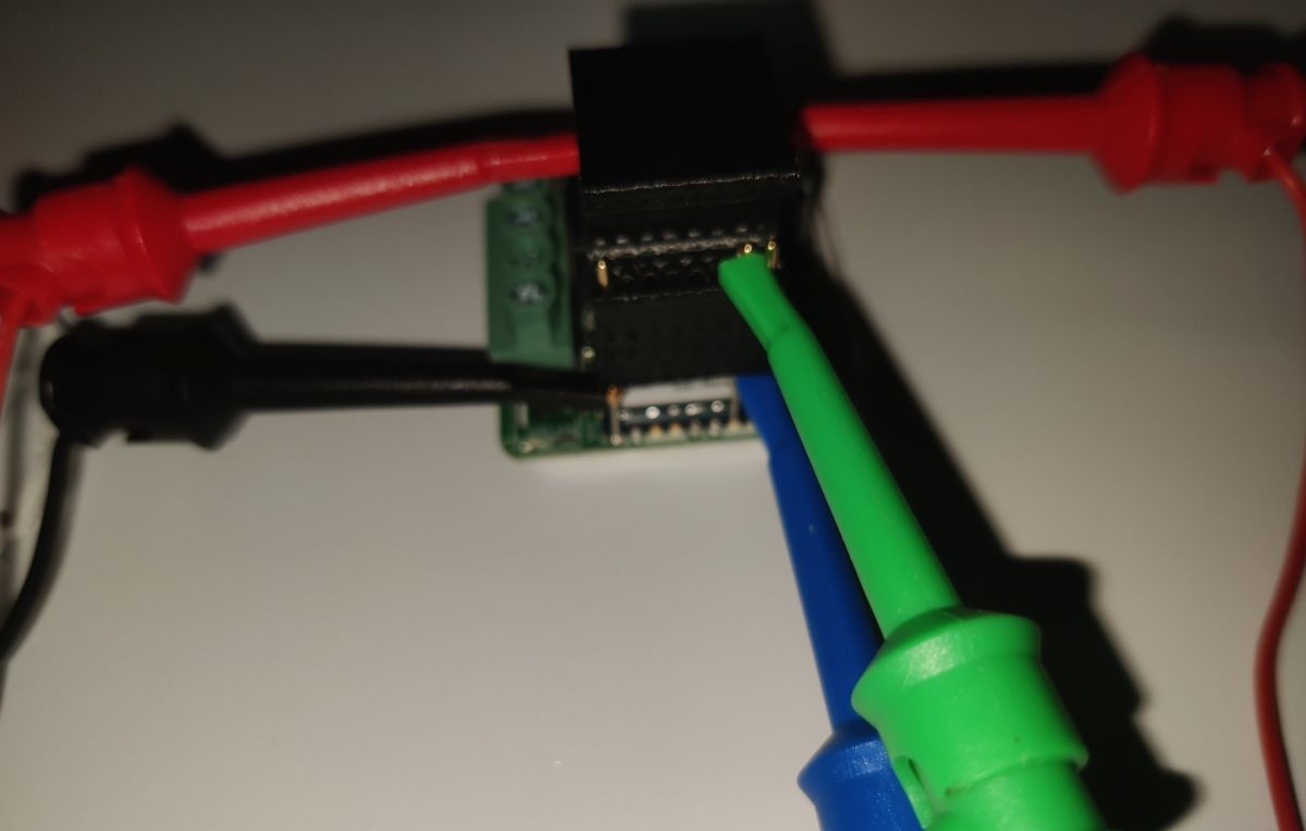

    The device uses the CB3S Module. I used this time a 3D Printed PogoPin Adapter I've got aware of in a YouTube Video ( https://www.thingiverse.com/thing:4099748 PogoPins from Amazon https://www.amazon.de/dp/B007Q8JILQ ). After connecting everything necessary for flashing, just start the usual procedure.
    Close-up of a 1-channel Gerier WiFi switch with connected test leads. Connected circuit board with colored wires and PogoPin adapter.

    Actually this is shown in 1st picture last row. I've used the PogoPin adapter by pressing it on the Module...
    So if you ask for the PINs I used
    3=Reset connect it to GND on PIN 9 for short moment to start reading/writing when Programming App asks you to do.
    8=3V->3V on USB Adapter
    9=GND->GND on USB Adapter
    15=RX->TX on USB Adapter
    16=TX->RX on USB Adapter
    So you see - I even didn't solder at all ;-)

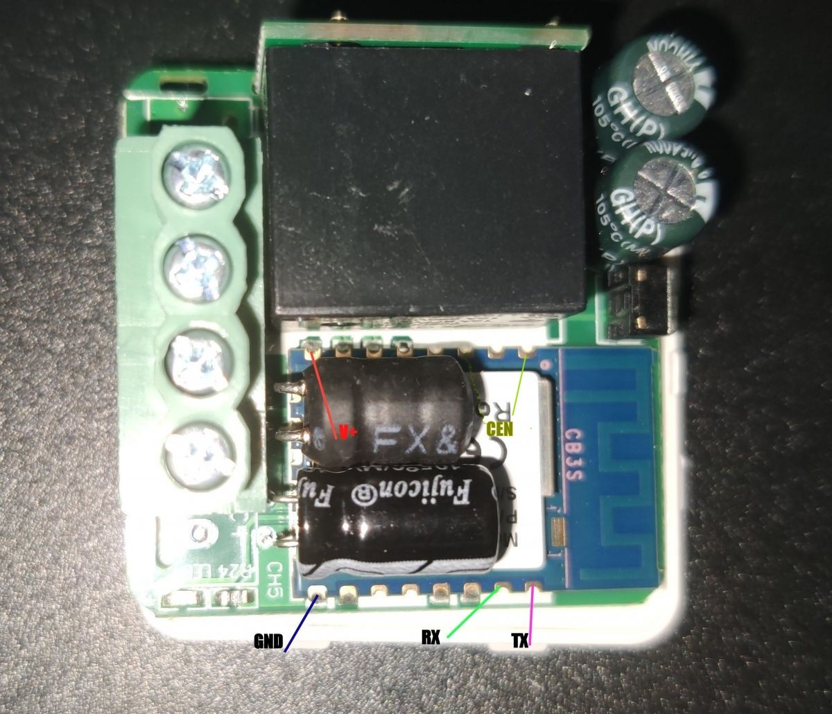

    Thanks for your fast reply. I'm still Beginner level, but I prefer to solder in order to get stable connections.
    So Pins should be those on the attached photo
    A circuit board with visible pins labeled as GND, RX, TX, CEN, and capacitors.
    It will be my first flash of those IoT stuff. Is there a small but good Beginners guide available somewhere? Is any USB-FlashDevice suitable? I still have here a CH340G (used for ESP01-programming). Probably good enough for that (?)

    The pins you've marked are the ones I used. I actually didn't want to solder because of 3.3v and Reset are both at places where there is too much risk to heat up everything else and to melt the plastic from the relay...
    The CH340G is actually that what I use to flash my devices to OpenBeken.
    Careful - Reset by Power Off means in my case that the device is fully reconnected and com connection gets lost so you have to use the Pin3 RESET to Pin8 GND Method. And keep in mind - you just have a short moment and just need a short shortening moment.

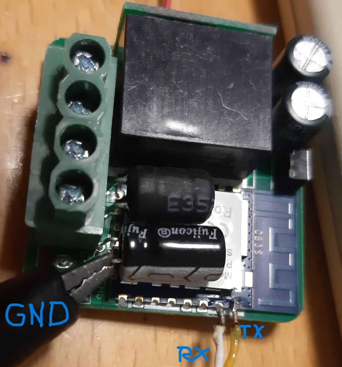

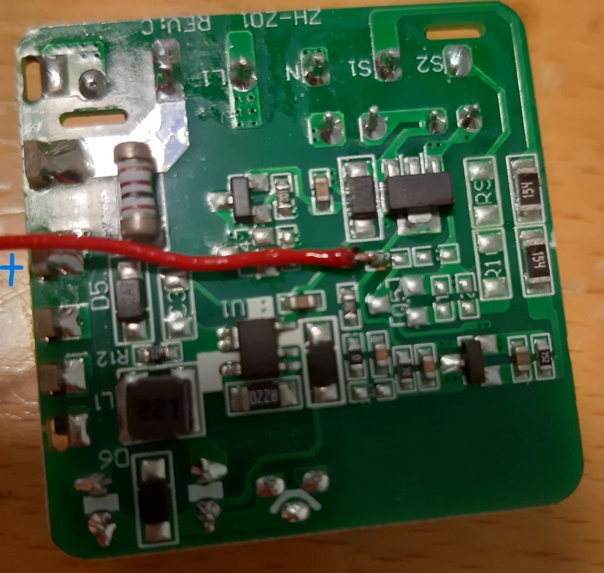

    A hint for making it a little easier to flash:
    Just solder TX and RX on the upside of the board and V+ (3,3V) on the other side (see photos). Use the outer pin of the big capacitor on the upside as ground pin:

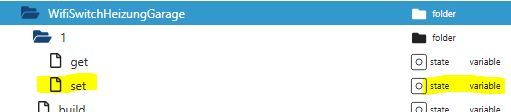

    If you are on ioBroker, you'll have to create the "set" value manually (as always):
    In MQTT-Tree under <device name>, 1, you'll find the "get" value. Under 1 you create now manually a new entry as "state", type "number" and name "set". Now make a right click on "set" to edit, change the role to "variable".
