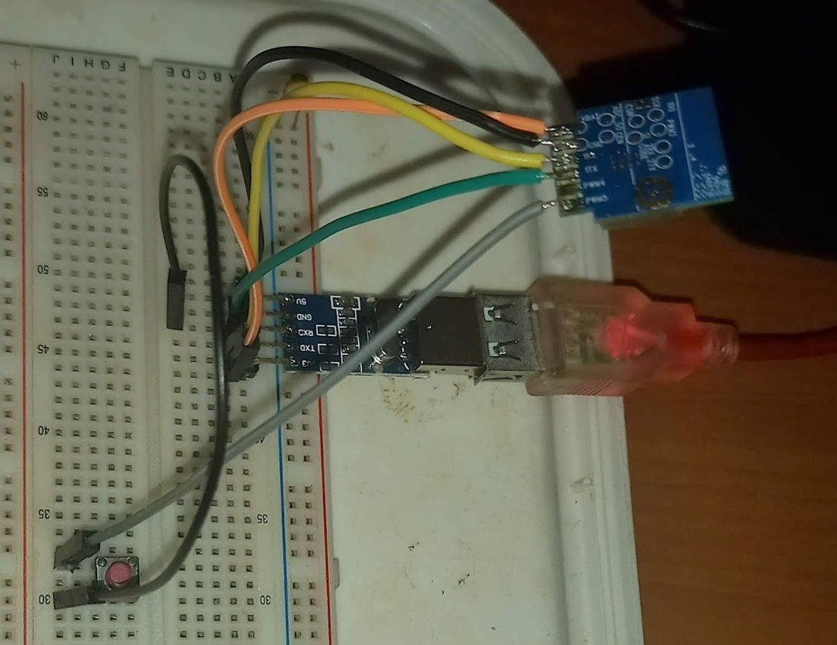

    Hi all. I hope I'm in the right place here. I just bought 8 of these "Connex Connect CC-P2000" devices (see https://connexconnect.com/product/smart-wifi-switch-10a/) from a local hardware store (see https://www.builders.co.za/Electrical/Plugs%2...-Wi-Fi-Switch-%2810A%29/p/000000000000769133), thinking that they were clones of the well-known "Sonoff Basic" switches. I opened them up and found a WB2S inside, which after some searching led me to this forum and the software available at https://github.com/openshwprojects. I will try to flash it and post my progress here. If I'm successful, I'll try to write a teardown/tutorial/guide for this device later. Here are some photos: https://photos.app.goo.gl/9Xw9ZpNJPSMSVaFD8
    Added after 1 [hours] 58 [minutes]:
    Step 1 was to read the WB2S datasheet at https://developer.tuya.com/en/docs/iot/wb2s-module-datasheet?id=K9ghecl7kc479 and compare it to the instructions at https://github.com/openshwprojects/BK7231GUIFlashTool#brief-usage-instructions. I'm assuming that the "Beken TXD1/RXD1" referred to by those instructions are the 1TX and 1RX pins of the WB2S. (If not, could someone correct me, please?)
    I first tried flashing in-circuit. I was hoping that I don't have to desolder the WB2S since I have quite a few of these to do. Here are photos of the setup:
    Breadboard setup with connected PCB module, wires, and labeled UART lines and power supply.
    Close-up of a PCB with five colored wires soldered to the pins of a WB2S module.
    It powers on, and my reset button also works, but alas, it fails to flash. I have tried both power cycle and pressing the reset button many times.

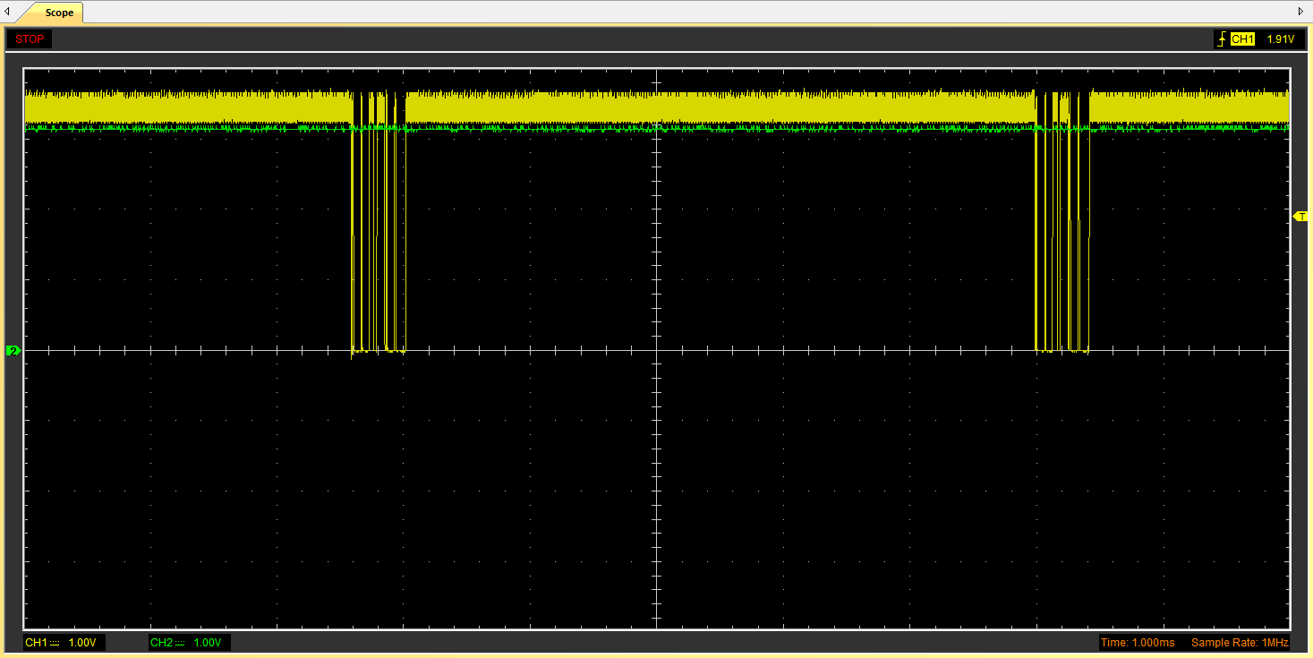

    I had my oscilloscope hooked up to the UART lines. Yellow is PC TX -> WB2S 1RX. Green is WB2s 1TX -> PC RX. It never replies. Something must be pulling that pin high.
    Oscilloscope display with two traces, yellow and green, showing digital signal activity on a black grid background.
    Any bright ideas before I desolder it and try to flash out-of-circuit?

    Your wiring connection looks long, in noisy environment it's not recommended to connect that way, we had already users on the forum where making wires shorter helped.

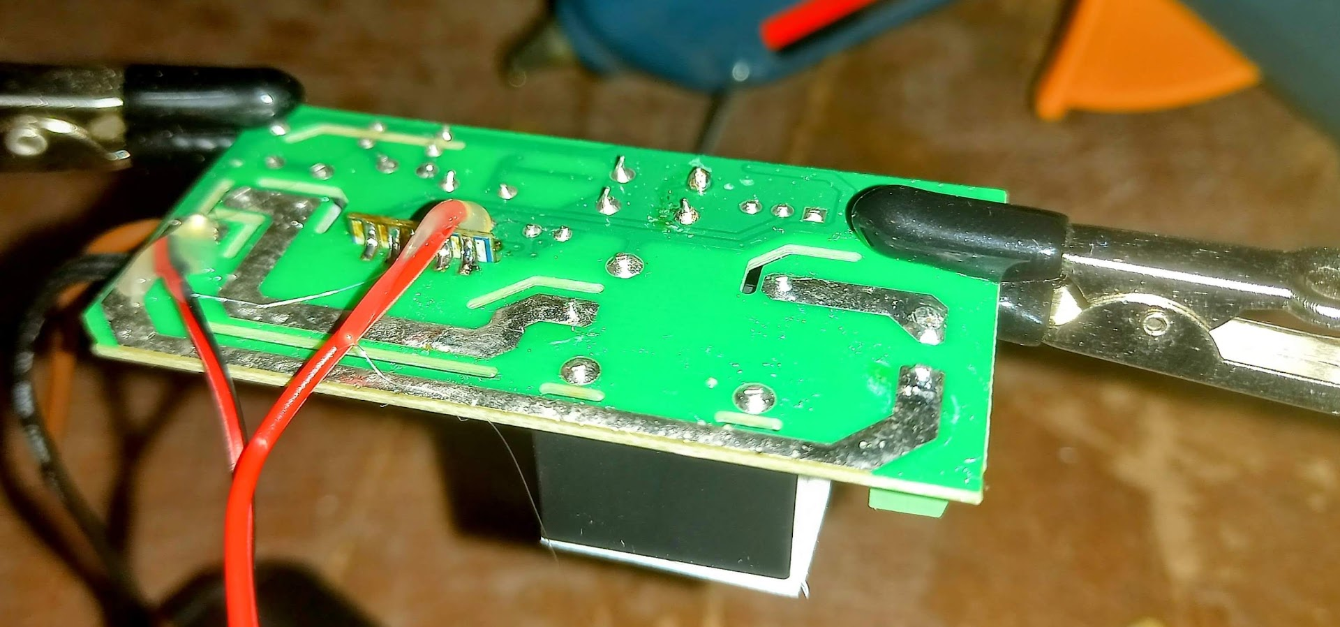

    CEN RESET may not be reliable, I usually do power off/on cycle.

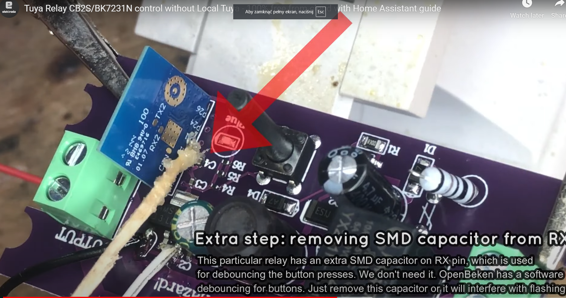

    If something is pulling UART high, you may have the same situation as we had on that video (GPIO had a capacitor connected, the useless capacitor, by the way, because we do debouncing in code):
    Close-up of a PCB with a relay module showing the process of removing an SMD capacitor from the RX pin.
    You can try the method from this video, even with hid_download_py, it should work.

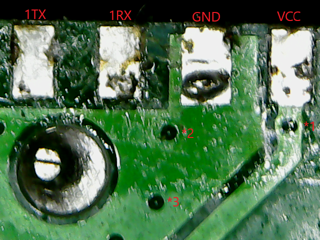

    I had a look at the circuit under a USB microscope. Assuming that it's only a 2-layer PCB, I can't see anything connected to TX or RX!
    Close-up of a two-layer PCB with markings TX, RX, GND, and VCC, and vias labeled *1, *2, and *3.
    Image of a PCB with two elements marked as vias, possibly bypass capacitors, labeled as *1 and *2.
    *1, *2 and *3 are vias to the capacitors on the other side, so they must be bypass capacitors.
    It looks like only VCC, GND, PWM0 and PWM5 are used. Is it possible?
    In any case, I have desoldered the WB2S and will try to flash it separately.

    No, I would rather say that you need at least 3 GPIOs here, because you need:
    - relay
    - pairing led
    - button
    So at least one more GPIO is most likely used here.
    Please do a 2MB flash backup before flashing OpenBeken, because we can extract GPIO roles easily from that 2MB flash. This will be helpful later, when we'll be configuring the device.

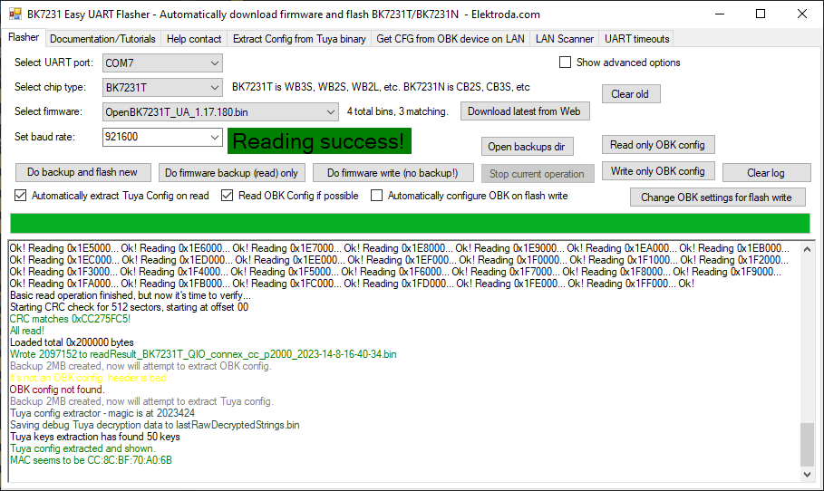

    When you say "2MB flash backup", do you mean this button? Or is it something else?
    Button labeled Do firmware backup (read) only
    Luckily, I have 8 of these, so I can use another one if I mess things up.

    Ok, so maybe try with a multimeter? Use continuity test to check whether is there a connection from one of GPIOs (from RX to TX) to a button or to a nearby capacitor?
    As we've said on that "smart switch flashing" video, the capacitors on RX and TX are not needed, you can remove them permanently.

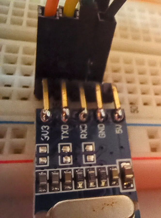

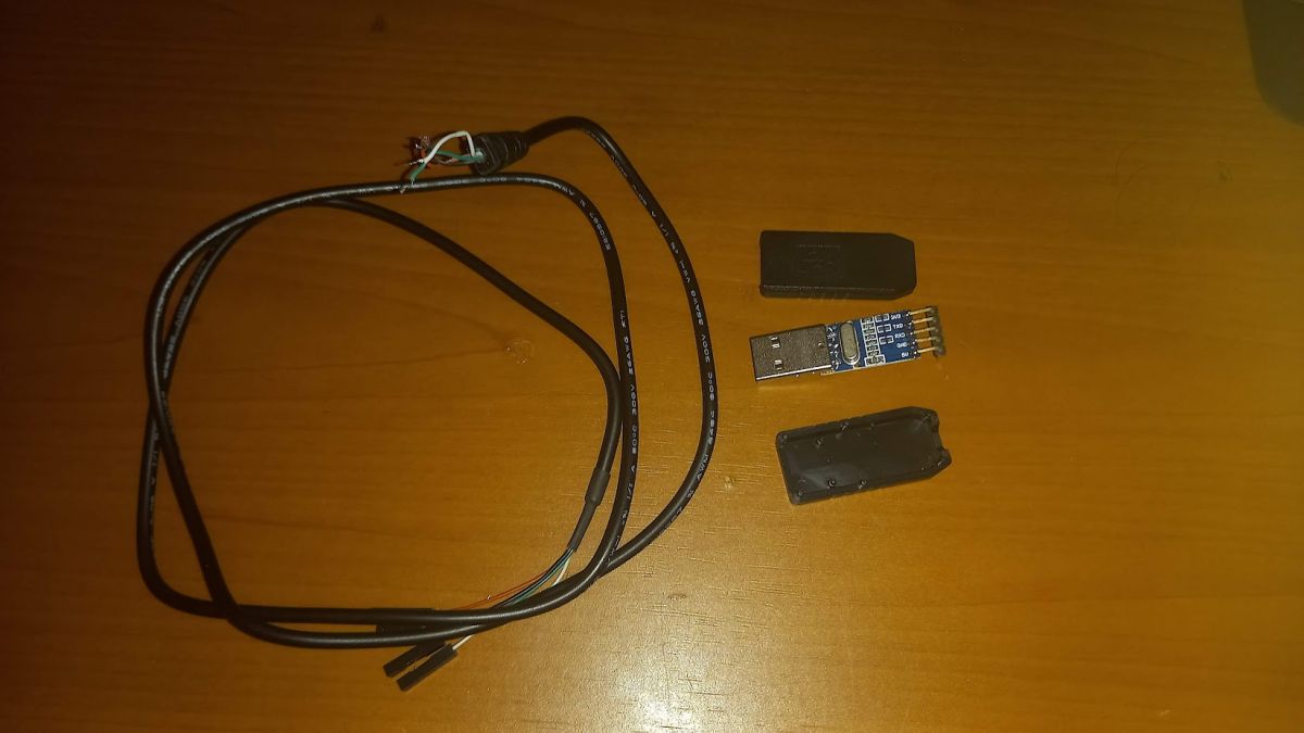

    I was using this USB-UART converter. https://www.netram.co.za/adapters/9611-pl2303...to-uart-rs232-com-cable-module-converter.html I opened it up and removed the long wires:
    A photo of a USB-UART converter with partially removed casing on a wooden surface next to a cable.
    The setup is much cleaner now:
    USB-UART adapter connected to a breadboard.
    Close-up of a circuit board with connected colored wires.
    Close-up of a USB-UART converter connected to a breadboard.
    I'm getting this error now, but I'll try again after a reboot:

    Great success, after rebooting my machine :) I don't know what was using the COM port, but it's gone now.

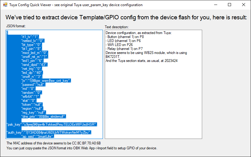

    Screenshot of BK7231 Easy UART Flasher software with successful data reading.
    Screenshot of Tuya device configuration with GPIO port information and JSON data.
    Text description:
    - Button (channel 1) on P8
    - LED (channel 1) on P6
    - WiFi LED on P26
    - Relay (channel 1) on P7
    Device seems to be using WB2S module, which is using BK7231T.
    JSON format:
    	"rl1_lv":"1",
    	"netled_lv":"0",
    	"bt_type":"0",
    	"bt1_pin":"8",
    	"mxcl_led_m":"0",
    	"onoff_rst_m":"1",
    	"led1_pin":"6",
    	"rand_dpid":"43",
    	"net_trig":"0",
    	"led_dp":"40",
    	"onoff_n":"3",
    	"jv":"1)9Bgw_wsm{fsw_cnt_key",
    	"passwd":"null",
    	"md":"0",
    	"random":"0",
    	"wfb64":"1",
    	"stat":"0",
    	"token":"null",
    	"region":"null",
    	"reg_key":"null",
    	"dns_prio":"00$Bis_stridenull",
    	"psk_key":"u9yrej9Khjw4kTvkkedPmuTELOExWlFUxdHSR",
    	"auth_key":"7jY3AD084jnaU6DLbNTWoksnNeMTyZbu",
    	"ap_ssid":"SmartLife",
    	"ap_passwd":"null",
    	"country_code":"CN",
    	"bt_mac":"null",
    	"bt_hid":"null",
    	"prod_test":"false }.0.0",
    	"lock_dp":"41",
    	"nety_led":"0",
    	"netled_pin":"26",
    	"total_stat":"2",
    	"bt1_lv":"0",
    	"reset_t":"4",
    	"ch_flag1":"1",
    	"inch_dp":"44",
    	"module":"WB2S",
    	"ch_cddpid1":"9",
    	"clean_t":"5",
    	"init_conf":"38",
    	"led1_lv":"0",
    	"cyc_dpid":"42",
    	"ch_num":"1",
    	"reuse_led_m":"0",
    	"rl1_pin":"7",
    	"netn_led":"1",
    	"ch_dpid1":"1",
    	"crc":"56",
    	"}BAfsw_cnt_key0fsw_cnt_key":"2"
    The 2MiB backup is attached. I never paired this device, so it does not contain anything sensitive, other than maybe the MAC address.
    • readResult_BK7231T_QIO_connex_cc_p2000_2023-14-8-16-40-34.bin (2 MB) You must be logged in to download this attachment.

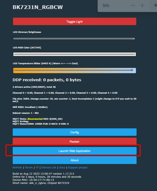

    Do you have any suggestions how to improve the docs?

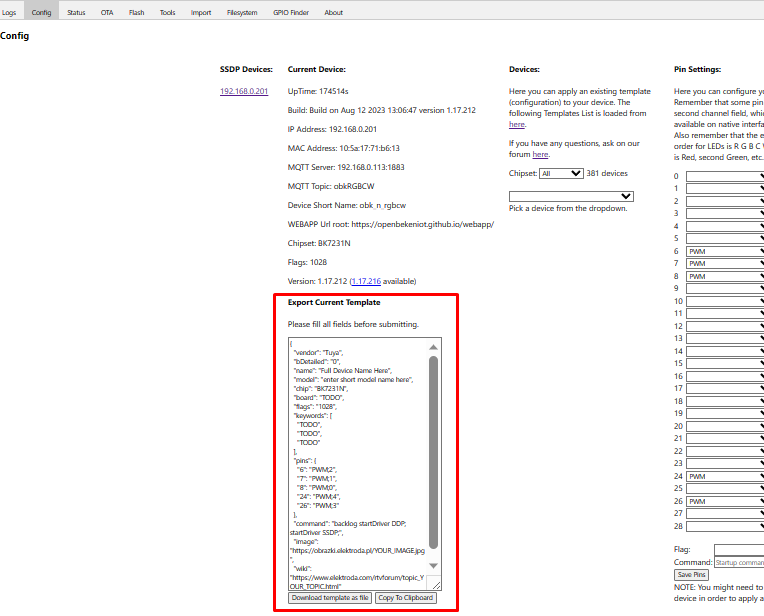

    User interface with options for the BK7231N_RGBCW device.
    Here is final OBK template (not the Tuya JSON):
    Screenshot of OBK template documentation highlighting export option.
  • #13 20693879
    rudolfbyker
    Level 4  
    Posts: 29
    Do you have any suggestions on how to improve the docs?
    I will try to make constructive suggestions when I have improved my understanding of what is going on. Currently, I'm still too confused.
    I filled in my WiFi details in the flasher and flashed the chip successfully, but I don't see it connecting to my WiFi yet. I'm assuming that it does not need to be soldered back to do this because it has the antenna on board.
    Configuration interface for BK7231N_RGBCW device with LED control options.
    Where do I find this program? In all of the videos I have watched, the instructions jump from soldering/cleaning the PCB to this screen without saying how to get there.
    Screenshot of a device configuration interface showing network details and an export template option.
    Same question. Where do I find this program?

    You either connect to OBK AP and open page at 192.168.4.1 or if OBK is already configured, it connects to your WiFi and you just connect to it's IP from DHCP.
    It should automatically connect when configured, you only need to power off it and power on, even if you have module just powered by 3.3V. If it's not, then you either have wrong password or ssid, or you are experiencing some strange rare WiFi problem.
    I think it was reported 2 or 3 times already on this forum, and some guy also solved it with changing some WiFI setting on router or something. Maybe also clearing RF partition could help, but this can harm your signal quality so don't try it first.
    Maybe let's start by doing quick 5 power off/on cycles to boot into safe mode and check whether OBK Access Point shows up? Can you connect to OBK access point then?

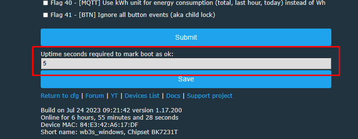

    It depends. There are two factors at play:
    - the off cycle must be long enough for capacitors to discharge, so the BK really turns off. That cycle may need to be longer if you have PowerSave enabled. Basically, BK must turn off, because you know, if you have a very low load on power supply then turning of power for 0.25s may not be long enough for capacitors to discharge...
    - the on cycle must be shorter than "boot ok mark" setting from OBK options:
    Screenshot of a setting for uptime seconds required to mark boot as ok.
    I would say that 2 seconds is a safe value in both cases.
    The logic behind scenes is very simple. On boot start, the boot counter is increased. After 5 (CONFIGURABLE - see above) seconds, if device still runs, the correct boot counter is set to the current boot counter.
    Futhermore, also on boot start, the correct boot counter is compared with current boot counter. If the difference is 5 or higher, then safe mode kicks in and opens access point.

    rudolfbyker wrote:
    I tried to open the web app in safe mode, but it said "Not Found".
    There should be a button "do unsafe start" or something like that, that enables Web App in safe mode, but.... but Web App fetches from Github, so you need to have internet connection for that.
  • #21 20695791

    Triple check the MAC address displayed on your WWW panel
    Build on Aug 15 2023 15:26:48 version 1.17.219
    Online for 5 minutes and 45 seconds
    Device MAC: CC:8C:BF:70:A0:6B
    Short name: sk1, Chipset BK7231T
    Connect to TX2 pin and get the debug UART log from Beken
    I did this with the chip configured to be an access point uart_acces..._point.txt (6.77 kB)You must be logged in to download this attachment. AND with the chip configured to be a client uart_cli..t.txt (5.24 kB)You must be logged in to download this attachment. . The latter periodically says "WIFI_STA_DISCONNECTED".

    Updated:
      "vendor": "Connex Connect",
      "bDetailed": "0",
      "name": "Smart WiFi Switch 10A",
      "model": "CC-P2000",
      "chip": "BK7231T",
      "board": "WB2S",
      "product": "https://connexconnect.com/product/smart-wifi-switch-10a/",
      "flags": "0",
      "keywords": [
        "WIFI401-N-V1.2",
        "OB2222MCP",
        "AMS1117",
        "YX202-S-105D"
      "pins": {
        "6": "LED;1",
        "7": "Rel;1",
        "8": "Btn;1",
        "26": "WifiLED_n;0"
      "command": "backlog PowerSave 1;",
      "image": "https://obrazki.elektroda.pl/7322999100_1692195471.jpg",
      "wiki": "https://www.elektroda.com/rtvforum/topic3995489.html"

    Looking at https://developer.tuya.com/en/docs/iot/wb2s-module-datasheet?id=K9ghecl7kc479 to get the mapping of WB2S pins to BK7231T pins,
    - Pin 6 of the BK7231T is PWM0 on the WB2S, which is connected to the relay status LED.
    - Pin 7 of the BK7231T is PWM1 on the WB2S, which is connected to the relay.
    - Pin 8 of the BK7231T is PWM2 on the WB2S, which is connected to the button.
    - Pin 26 of the BK7231T is PWM5 on the WB2S, which is connected to the WiFi LED.
    So nothing is connected to 1TX or 1RX as I suspected at the start, so in-circuit flashing should be possible?
    Also, I should be able to use pin PWM4 to read the state of a toggle switch (not a momentary switch)?

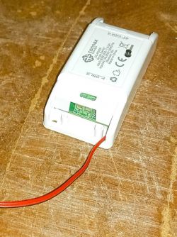

    Nice. I managed to configure an extra pin as a digital input, and now I don't have to replace the toggle switches in my house. It follows the switch when it changes, but it can also be changed from Home Assistant (in which case the switch is in the "wrong" position until someone comes along and interacts with it again). Perfect.
    Close-up of a circuit board with soldered wires and a mounting clamp.
    A white Connex Connect Smart WiFi Switch 10A module with a red wire attached, resting on a wooden surface.
    I also saw that the relay's LED needs to be inverted, so the template becomes:

    Just please be aware that this particular model of smart device runs on non-isolated power supply, so there is a risk of getting live potential on the wire you route out. It may be a serious safety issue, depending on how and where you connect that.
    Hmm but are you sure that you want digital input? From your description, it sounds like you want a "TglChannelOnToggle" pin type.
  • #29 20696508
    rudolfbyker
    Level 4  
    Posts: 29
    I saw that. Indeed, not ideal. Just to make it clear for people reading this who don't see why this is dangerous: It means that the GND pin of the WB2S chip is connected directly to the Neutral wire. So if you were to accidentally swap Neutral and Live, one of the new wires that I brought out in the photo above would be connected to Live (which is around 220V – 240V in South Africa). So make sure you get the polarity right, and double-check everything with a multimeter.
    Yes. I tested it, and it's the behavior I want. I.e. I want a specific switch position to have a specific meaning, rather than just toggling it and seeing what the light does.
    Lastly, do we have enough info in this thread for me to make a PR for https://github.com/OpenBekenIOT/webapp/blob/gh-pages/devices.json or do you prefer that I make a tidy write-up about this module in a separate thread? (It might take a while before I find the time.)

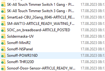

    Screenshot of a folder with file names of devices and dates.
    Our list here: https://openbekeniot.github.io/webapp/devicesList.html is steadily growing and we are going to make it even bigger soon.
