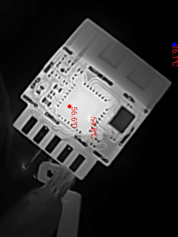

    Hi,
    Finally had time to check out the newest version (1.17.501) and seems a lot has happened since I last checked in! While being busy improving my wifi and getting into OpenWrt I especially appreciated the wifi rsi sensor - I can now have one card with multiple RSI sensors from all over my house to check the effect of wifi configuration changes at a glance, so cool!
    The temperature sensor is also a nice addition but for some reason with my BK7231T based smartplugs it adds 100 degrees to the measurement. After the initial shock I checked and can surely say the plugs are not running at 130 degrees Celsius :) It's these standard AliExpress ones you get for a few bucks in the 3 for 6 dollars section https://www.aliexpress.com/item/1005003640070178.html
    A couple of touch light switches (BK7231N based) are also running 1.17.501 now and they report the temperature correctly.
    Would be great if this could be fixed in one of the next versions. Also: How could I make the temperature a sensor for Home Assistant, too? With all the cheaply produced stuff running 24/7 in my house it would add a bit of peace of mind if I could use this for a warning if they get too hot.
    Let me know if I can add more information about the issue and thanks in advance for looking into it!

    I think it's not calibrated. The temperature readout was submitted by a contributor. We need to figure out a way to get a real value. Maybe recheck source code and measure the real temperature and then use it to adjust the conversion constant.

    We need to know how to convert that "120 degrees" to real temperature, then I can change the code to adjust that.
    For now, maybe I can just add a warning on GUI?

    Wow that was fast, thanks so much! The temperature reading also seems a bit more correct now, in my case from before update 120 to after 52

    We are trying to calibrate it a bit, but it seems we also need to raise N temperature by about 10 degrees:
    Thermal image of an electronic circuit board with temperature markings.
