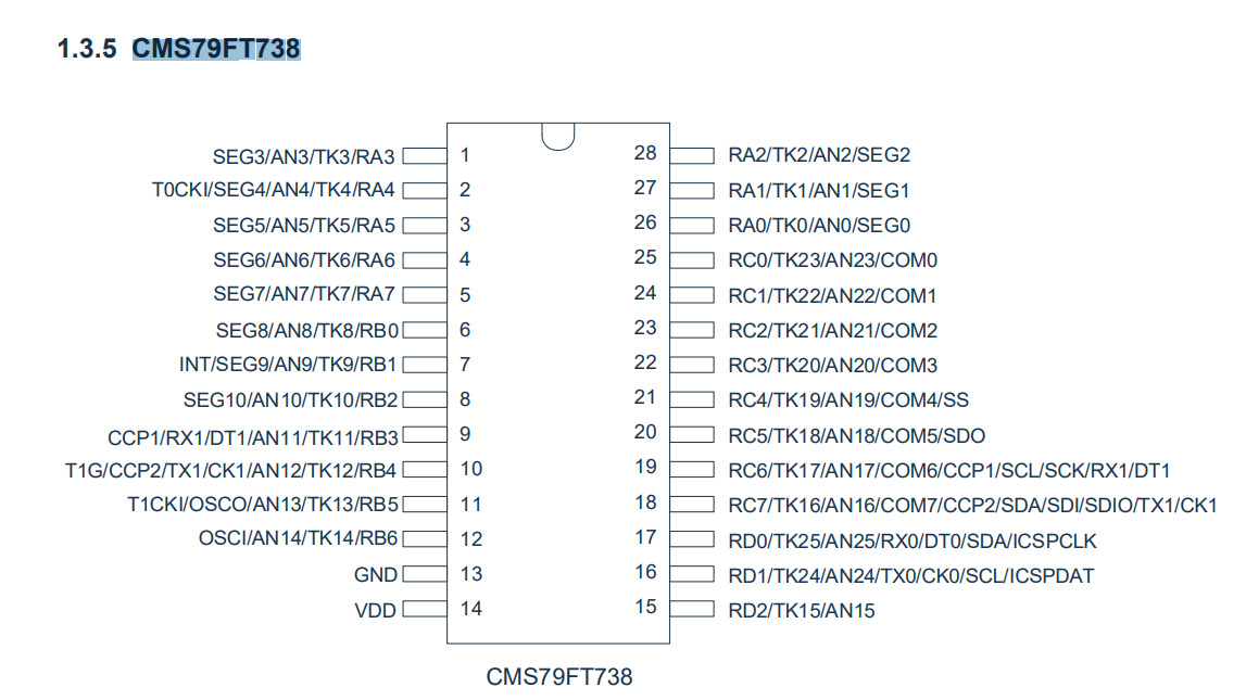

    Here is the pinout of your MCU:
    Diagram of the CMS79FT738 microcontroller pinout, showing pin layout and labels.
    I have skimmed both the pinout and the GPIO list at the page 13 and I can't see any RESET pin there. You may just need to use the soldering method. Do you know how to desolder the SOIC chip? It may be sometimes easier than cutting the traces.

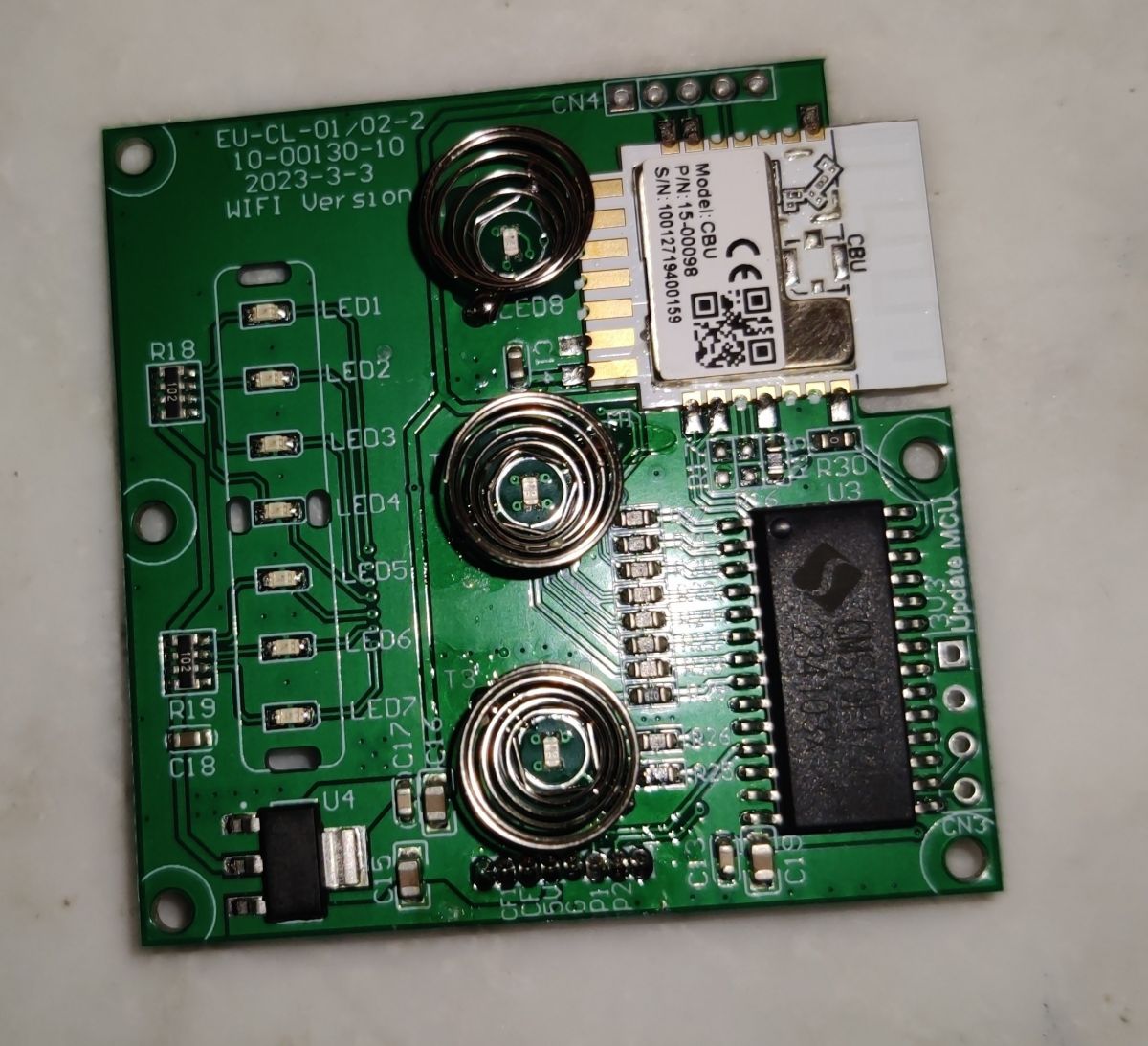

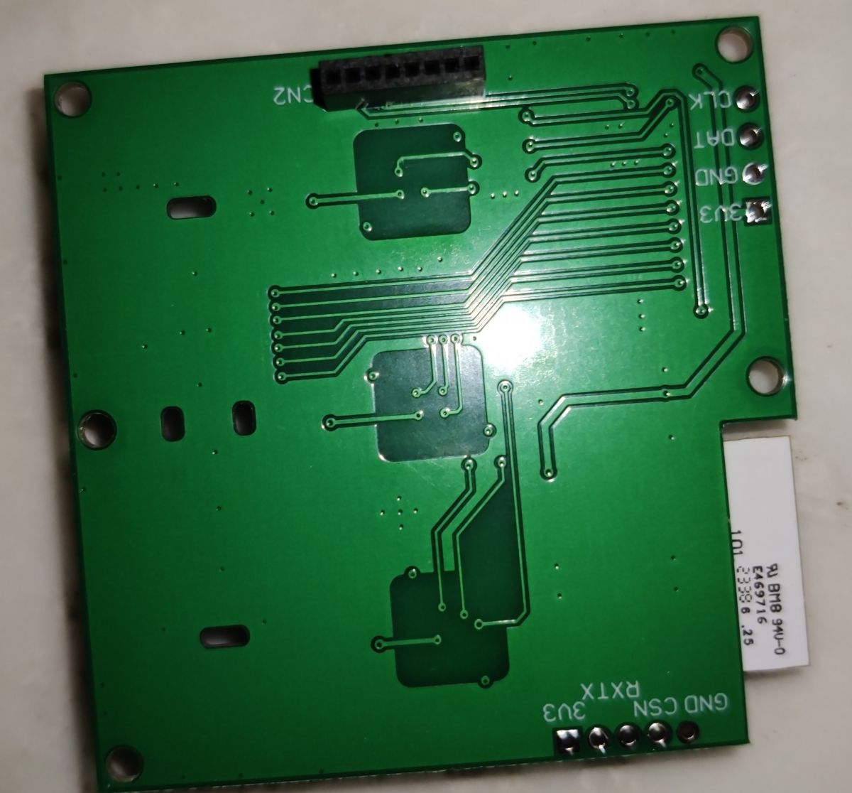

    Hey - OK... Well... Wanted to disclose it in Teardown ;-) Have a look at this here:
    Close-up of a green PCB with marked traces, CN2 port, and labels CLK, DAT, GND, and RX/TX. PCB with electronic components including a Wi-Fi module.
    These is the upper part. It connects via CN2 to a secondary PCB where the relays are located.

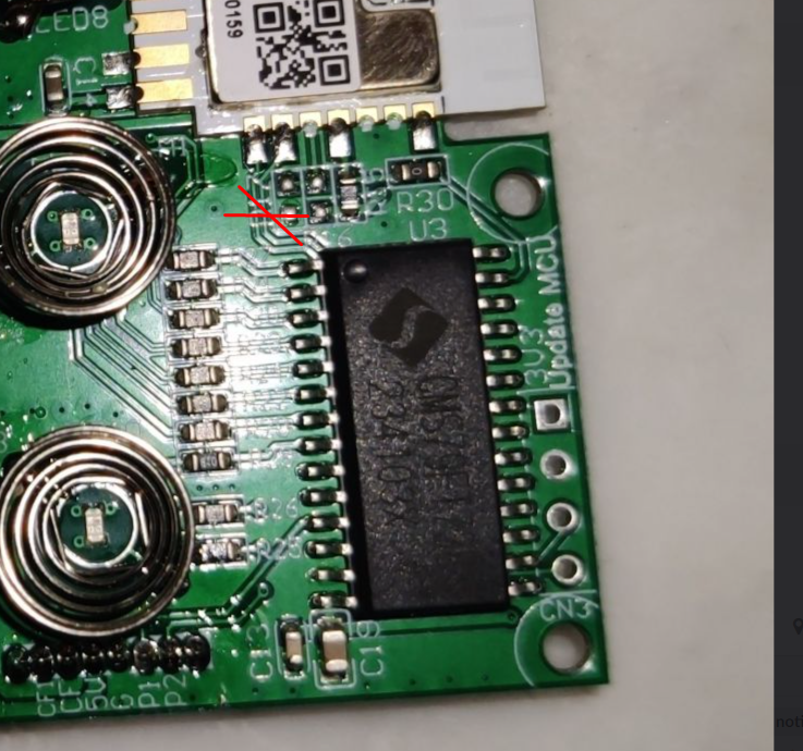

    #6 20999418
    Posts: 14756
    Rate: 12881
    Ok so if you don't want to reconstruct traces then what about it.
    1. Find with multimeter where TX and RX leads on the SOIC chip
    2. cut here:
    Close-up of a circuit board with highlighted soldering paths.
    3. instead of simply reconstructing the traces, solder wires to RX and TX of CBU and route them directly to the SOIC chip pins. This may be easier than reconstructing traces because those SOIC pins are larger than the tiny traces.
    Or wait, let's ignore that, you know what?
    You said yourself that you have RX/TX header of the MCU on the board. Doesn't it lead to the same RX/TX we speak about?
    If it leads, then you can just do jumpers there:
    Photo of a circuit board with red text annotations suggesting example connections.
    Added after 30 [seconds]:
    but I will repeat - I didn't check the pinouts on my image, it's just an example, it doesn't show correct connections.

    Unfortunately this will not work out I think. I've measured where TX and RX of the CBU ends on the MCU - to keep it short and sweet... At the wrong PINs I would say since the CLK/DAT Pinouts connect to different PINs.
    To be precise PIN9 and PIN10 on MCU connect to the TX/RX of the CBU - but well... What about either disconnect the MCU TX->RX wire on PCB by scalpel and after flashing reconnect it by a little bit soldering "dot". Else option would be to disable power supply at the MCU... What about desoldering the 3V input so that the whole MCU is without Power? The 3V seems to be easier to reach and desolder (PIN 14 that is directly at the Edge of the MCU). I could either desolder this PIN or directly cut it and after flashing the CBU reconnect it.
    Other idea is to connect the CLK Pin to GND Pin. Should actually mean a short-circuited CLK = the MCU will maybe not work under these circumstances...
