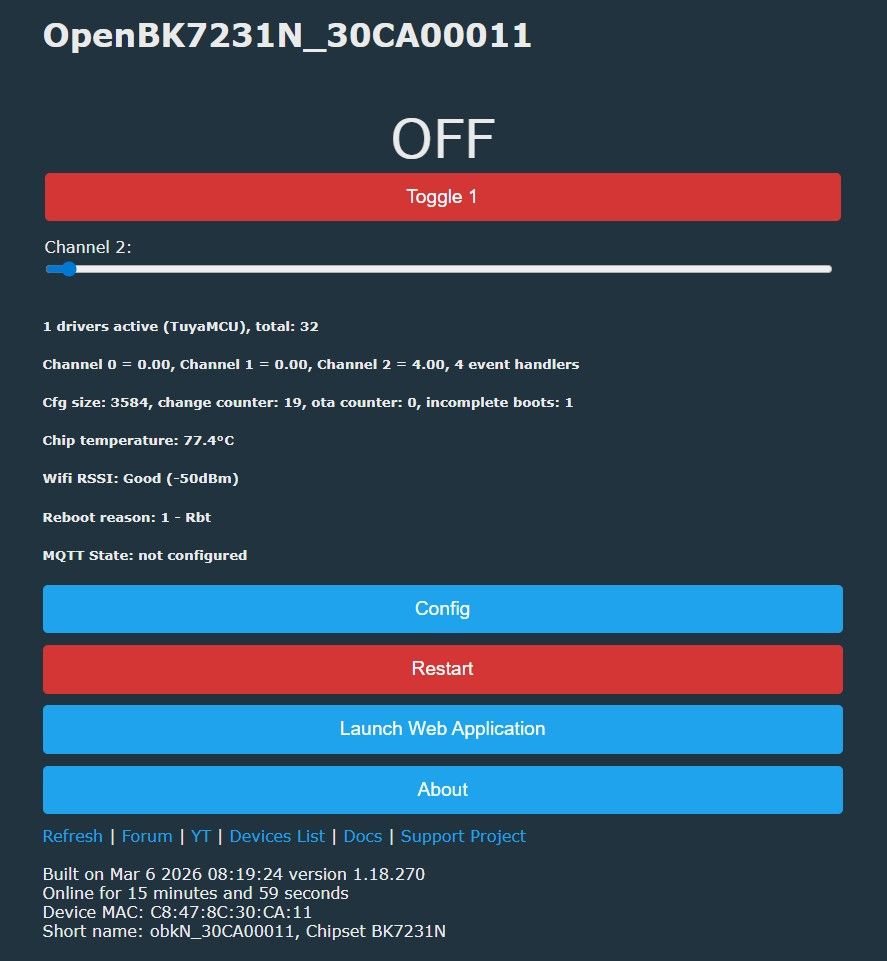

    Update:
    i was able to get the module working, it is possible that the wrong flags were causing the device to be killed....
    pin setting:
    "7": "Btn;1",
    "8": "LED_n;1",
    "24": "Btn_ScriptOnly;0",
    "26": "Btn_ScriptOnly;0"
    autoexec.bat
    Spoiler:
    // this is not really tuyaMCU but we will treat it as such
    startDriver TuyaMCU
    // set baud rate
    tuyaMcu_setBaudRate 115200
    // create a toggle and a dimmer
    setChannelType 1 toggle
    setChannelType 2 dimmer256
    // invoke refresh on change
    addEventHandler OnChannelChange 1 startScript autoexec.bat refresh
    addEventHandler OnChannelChange 2 startScript autoexec.bat refresh
    refresh:
    // channel 5 is temporary variable, from 0 to 255*3, multiplied also by toggle value
    setChannel 5 $CH2*3*$CH1
    // split into two bytes
    setChannel 3 $CH5/256
    setChannel 4 $CH5%256
    // send the two bytes
    tuyaMcu_sendCmd 0x30 00$CH3$$CH4$
    OpenBK7231N web panel screenshot showing OFF, Toggle 1 button, and a Channel 2 slider
    after further reading of the related topics actually the slider or button does not always work, sometimes you have to press several times i.e. I understand that this is not yet a polished and closed topic....
    My request, because I'm not proficient enough to create these scripts myself, can someone help me to make a ready script without additional options such that I can configure this device properly for its intended use so that the button on the device turns on and off (can also be hold-dimming/brightening) and the 3 contacts power,+ and - as intended to perform their function ?
    thank you in advance
