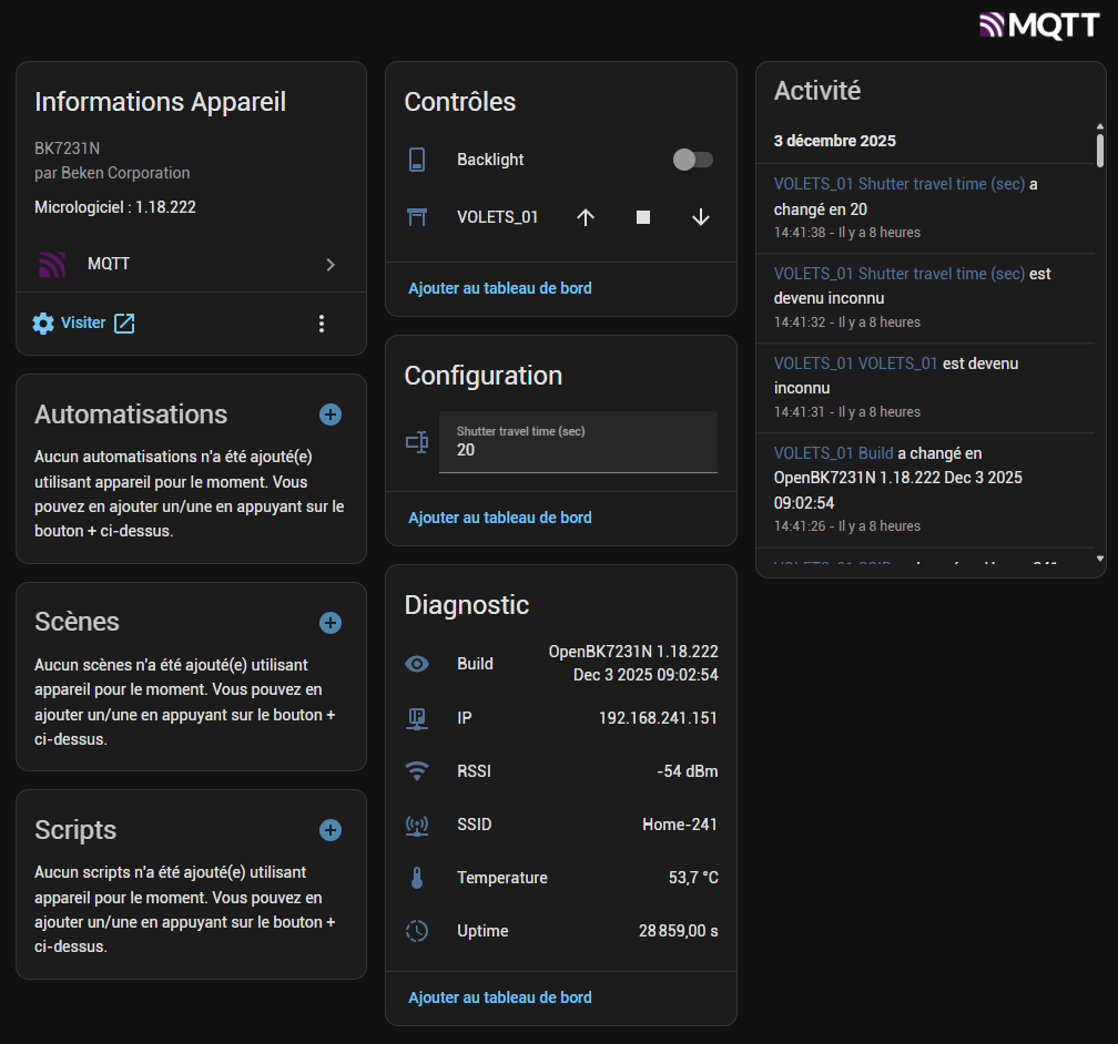

// create GUI buttons for HTTP panel
startDriver httpButtons
// Define displayed text on button 4/5
setChannelLabel 4 "Shutter travel time (sec)"
setChannelLabel 5 "Backlight"
setButtonEnabled 1 1
setButtonLabel 1 "Open"
setButtonCommand 1 Start_Opening
setButtonColor 1 CornflowerBlue
setButtonEnabled 3 1
setButtonLabel 3 "Close"
setButtonCommand 3 Start_Closing
setButtonColor 3 CornflowerBlue
setButtonEnabled 2 1
setButtonLabel 2 "Stop"
setButtonCommand 2 Stop_All
setButtonColor 2 CornflowerBlue
// Hide the default GUI buttons
setChannelVisible 1 0
setChannelVisible 2 0
setChannelVisible 3 0
SetChannelPrivate 1 1
SetChannelPrivate 2 1
SetChannelPrivate 3 1

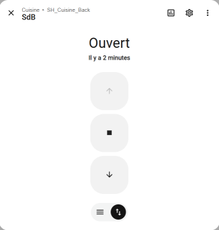

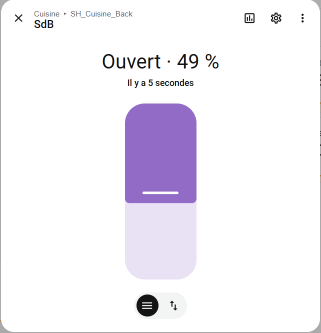

// --- HomeAssistant discovery ---
addEventHandler OnDiscovery 0 publishFile homeassistant/cover/$mqtt_client_cover/config d.json 1
scheduleHADiscovery

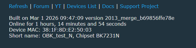

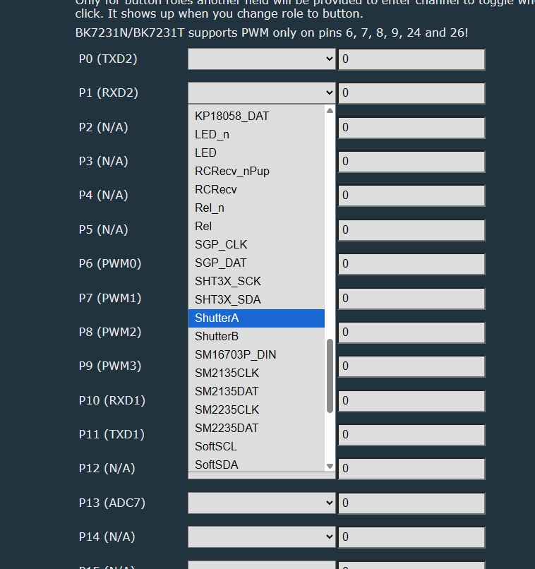

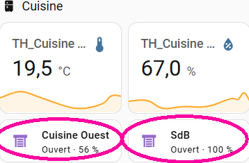

Error:CMD:LFS_ReadFile: lfs is absent// autoexec.bat Shutter driver test
// adapted to SC420W-EU (Loratap dual shutter) (c)JYO2026
startDriver Shutters
ClearIO // clear old GPIO/channels
StartupCommand "" // clear STARTUP
// Shutter 1 (left buttons)
backlog setPinRole 7 ShutterA; setPinChannel 7 1
backlog setPinRole 24 ShutterB; setPinChannel 24 1
backlog setPinRole 9 BtnShutterUp; setPinChannel 9 1
backlog setPinRole 20 Btn; setPinChannel 20 1 // btn stop 1
backlog setPinRole 14 BtnShutterDown; setPinChannel 14 1
// Shutter 2 (right buttons)
backlog setPinRole 8 ShutterA; setPinChannel 8 2
backlog setPinRole 26 ShutterB; setPinChannel 26 2
backlog setPinRole 11 BtnShutterUp; setPinChannel 11 2
backlog setPinRole 23 Btn; setPinChannel 23 2 // btn stop 2
backlog setPinRole 10 BtnShutterDown; setPinChannel 10 2
backlog setPinRole 6 WifiLED_n

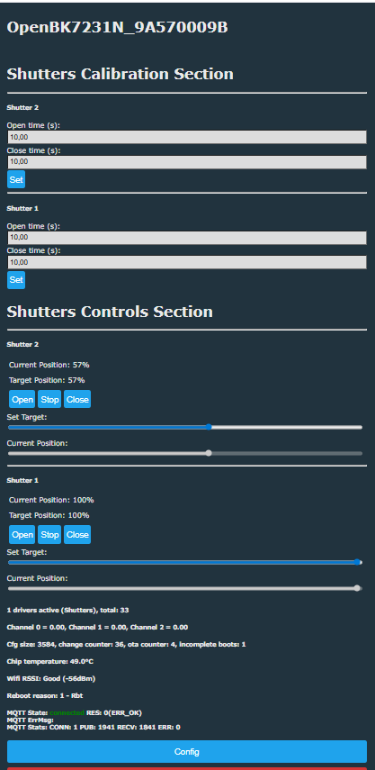

// autoexec.bat Shutter driver test (PR#2022)
// Shutter 1
backlog ShutterChannels 1 10 11 12 - stores shutter 1's state in channels 10-12
// Shutter 2
backlog ShutterChannels 2 20 21 22 - stores shutter 2's state in channels 20-22

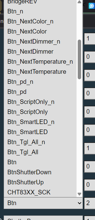

// Shutter 1
backlog setPinRole 20 Btn_ScriptOnly; setPinChannel 20 1 // btn stop 1
addEventHandler OnClick 20 ShutterMove 1 Stop
// Shutter 2
backlog setPinRole 23 Btn_ScriptOnly; setPinChannel 23 2 // btn stop 2
addEventHandler OnClick 23 ShutterMove 2 Stop
TL;DR: Etersky WF‑CS01 uses multiple Wi‑Fi boards; “the constructor used many different cards.” Pressing Stop 10 times triggers Safe Mode 3. Use the provided OpenBeken scripts, correct pin maps, and HA discovery to get a safe Cover entity. [Elektroda, benjaminklamerek, post #21006126]
Why it matters: Mixing pin maps or exposing raw relays in Home Assistant can short a shutter motor and destroy it.
