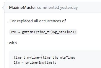

    I think there are some other code parts with the same function, which should be addressed, too. Namely in ntp_events.c and the json code in the httpserver directory (as stated in the "issue"). I think I won't be able to look into this today cause I'm quite busy today.
    And we need to get straight, why this fails here: was the code not totally correct or is there an issue with LN882H implementation of gmtime or casting of addresses...

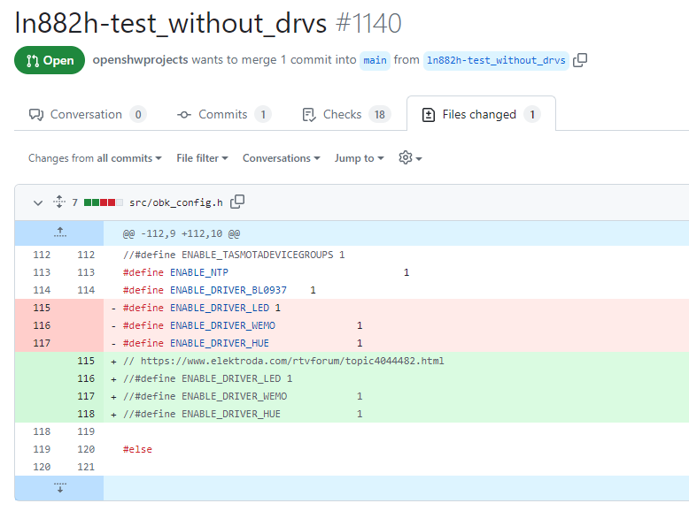

  • #39 21019175
    Posts: 14595
    Help: 654
    Rate: 12613
    Why do you think that adding "static" changes anything?
    Adding "static" will makes this array live only in this file.
  • #40 21019188

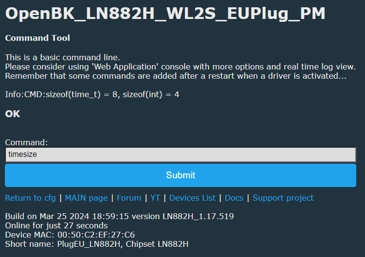

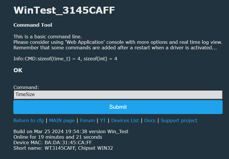

    This only hides the issue by changing the order stuff is allocated in RAM. I think the sizeof(time_t) is different than sizeof(int).

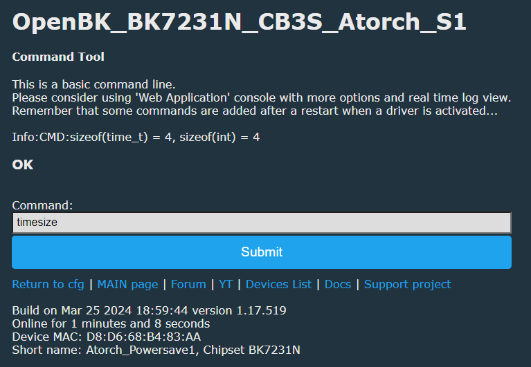

    Can anyone with BL602 or LN882H update to latest public release and run TimeSize command?
    See my results on Windows:
    Screenshot of the command line tool named WinTest_3145CAFF displaying the result of the TimeSize command.
  • #43 21019532
    Posts: 14595
    Help: 654
    Rate: 12613
    And this is the solution, just as I said. The time_t is 64 bit on that platform, so using a global integer (32 bit) pointer as time_t pointer results in using time_t with half of bits unspecified (depending on the content of RAM).
    This is not a perfect solution:
    Code comment fragment about changing the use of the time_t structure in programming.
    I need to change the type of g_ntpTime to time_t, just I hope it won't break anything else

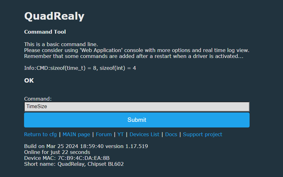

    #44 21019543
    Posts: 5039
    Help: 438
    Rate: 891
    Screenshot of the OpenBK Command Tool interface.
  • #45 21019555
    Posts: 14595
    Help: 654
    Rate: 12613
    Again 64-bit? So two platforms were affected! Good job finding that, thanks to all people who reported issues. Now, well, what does the same command say on Beken?

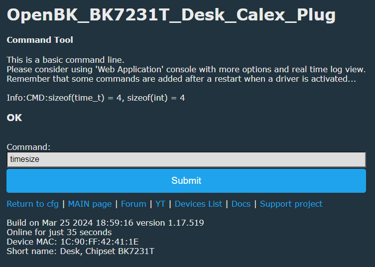

    #46 21019571
    Posts: 5039
    Help: 438
    Rate: 891
    Screenshot of the OpenBK_BK7231T_Desk_Calex_Plug tool interface. Screenshot of OpenBK tool with command timesize entered in the console.

    So this explain why it was working on the initial version for Beken. So, to sum up, time_t is 32-bit size on Beken but it's already 64-bit on LN882H and BL602. Futhermore, on Windows, I can control the size of time_t by using _USE_32BIT_TIME_T define.
    Here is a correct fix:
    https://github.com/openshwprojects/OpenBK7231T_App/pull/1146
    Can you check this on devices with:
    - BK7231
    - LN882H
    - BL602
    while making sure that in worst case scenario you can recover via UART?
    Still, it should be good, as I already got report from @DeDaMrAz saying that it works for him...

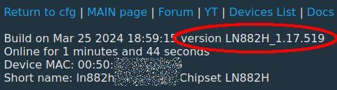

  • #54 21019651
    max4elektroda
    Posts: 754
    Help: 48
    Rate: 187
    We also run in the same issue in "src/httpserver/json_interface.c" (issue #1076), where it's "even worse ;-)", for there we are using no unsigned, but signed int!
    Added after 21 [minutes]:
    I like it ;-)
    Screenshot of device firmware showing version LN882H_1.17.519.
    But maybe we should drop prepending "LN882H_" like in the other versions?
    I just added it, for it was there with the "LN882H_Test", too...

  • #57 21019882
    silvestro_gatto
    Posts: 30
    >>21019583
    Tested on my LN882H bench module and OpenLN882H_1146_merge_64f6c6101544 is working fine: no more errors in serial log and module is stable and reliable with NTP driver.

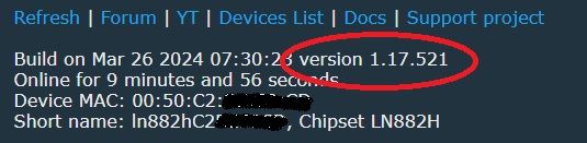

  • #59 21020355
    silvestro_gatto
    Posts: 30
    I tested OpenLN882H_1.17.521 release for a few minutes now and everything seems to be fine: no more errors in serial log, module is stable and fully functional and settings are consistent with the template previously loaded.
    Once again thank you @p.kaczmarek2 and @max4elektroda for the excellent work in solving this issue.
    I can also confirm that now the correct version is showed on the footer of each web page:
    Screenshot of an interface showing software version details.

Why did a gmtime and time_t mismatch break NTP on LN882H and BL602 while BK7231 kept working?
Because LN882H and BL602 used 64-bit time_t, but the code passed a 32-bit global integer as if it were a time_t*. That meant gmtime read extra, undefined bytes from RAM on those platforms. BK7231 kept working because its time_t was still 32-bit, so the bad cast did not immediately corrupt the value. [#21019583]
What does the TimeSize command show on LN882H, BL602, and BK7231, and how can it help diagnose time_t-related bugs?
It shows the platform-dependent size of time-related types, which helps confirm whether pointer casts are unsafe. The thread used TimeSize to verify that LN882H and BL602 had 64-bit time_t, while BK7231 had 32-bit time_t. That one command explained why the same NTP code failed on LN882H and BL602 but initially behaved on BK7231. [#21019555]
