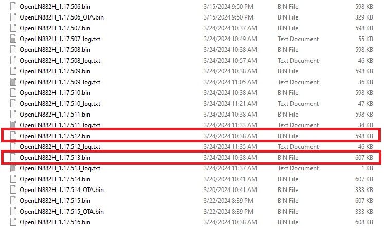

    As suggested, I tried some version in between to narrow down the possibilities of what may be a problem, and this is the outcome:
    OpenLN882H_1.17.507 - Mar 15 2024 21:27:30 - fully functional - log not showing any error
    OpenLN882H_1.17.508 - Mar 16 2024 16:40:13 - fully functional - log not showing any error
    OpenLN882H_1.17.509 - Mar 17 2024 08:59:05 - fully functional - log not showing any error
    OpenLN882H_1.17.510 - Mar 18 2024 17:58:00 - fully functional - log not showing any error
    OpenLN882H_1.17.511 - Mar 18 2024 20:02:07 - fully functional - log not showing any error
    OpenLN882H_1.17.512 - Mar 18 2024 22:23:23 - fully functional - log not showing any error
    OpenLN882H_1.17.513 - Mar 19 2024 09:10:15 - unresponsive - [WLIB_E]HwEr:EC = 16 - [WLIB_E]HwEr:EC = 12
    The problem occurred after upgrading to OpenLN882H_1.17.513 release.
    The module lost all the settings from the template and after 20/30 seconds from boot became unresponsive.
    I noticed a slight increase of the .bin size from OpenLN882H_1.17.512 and the following releases:
    File list showing issue with OpenLN882H_1.17.513 version
    To make sure the problem is not related to my hardware, I also tested the OpenLN882H_1.17.512 release on another WL2S module and it showed the same issue after upgrading to OpenLN882H_1.17.513

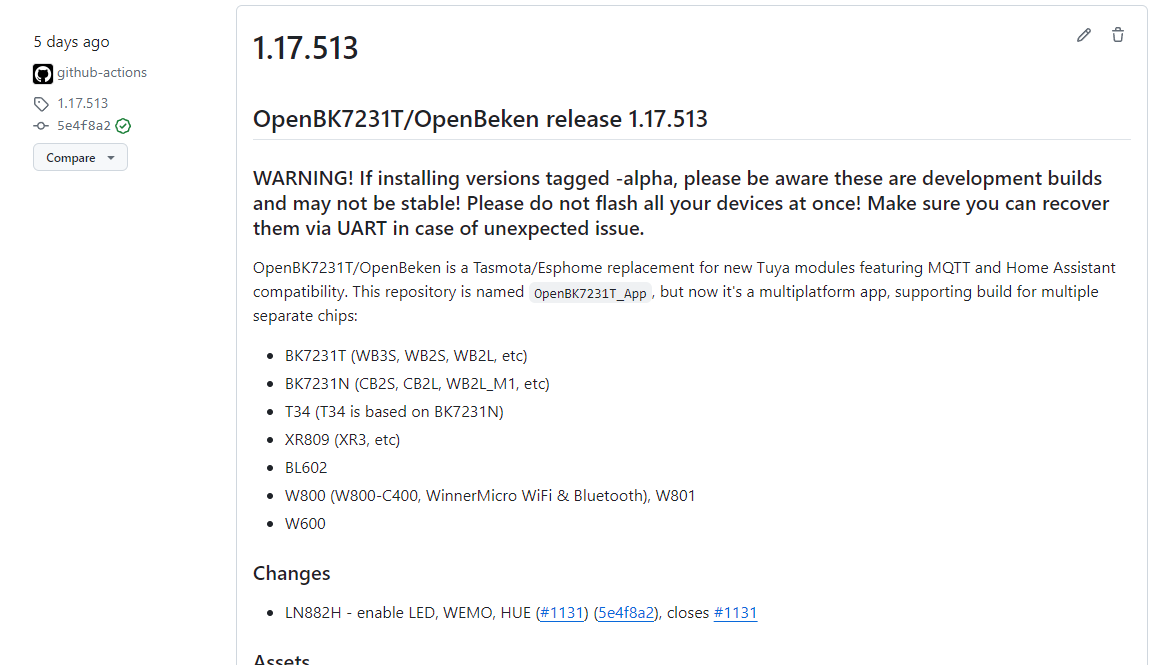

    OpenLN882H 1.17.513 is "LN882H - enable LED, WEMO, HUE (#1131) (5e4f8a2), closes #1131"
    Information about the OpenBK7231T/OpenBeken release version 1.17.513.
    Here is the changes log:
    https://github.com/openshwprojects/OpenBK7231...mmit/5e4f8a23a274cb1bcb61a2bfb3a626769ca5e931
    I have created a version disabling it:
    https://github.com/openshwprojects/OpenBK7231T_App/pull/1140
    Can you try using this version?
    If you don't know how to get binary from PR, see this topic

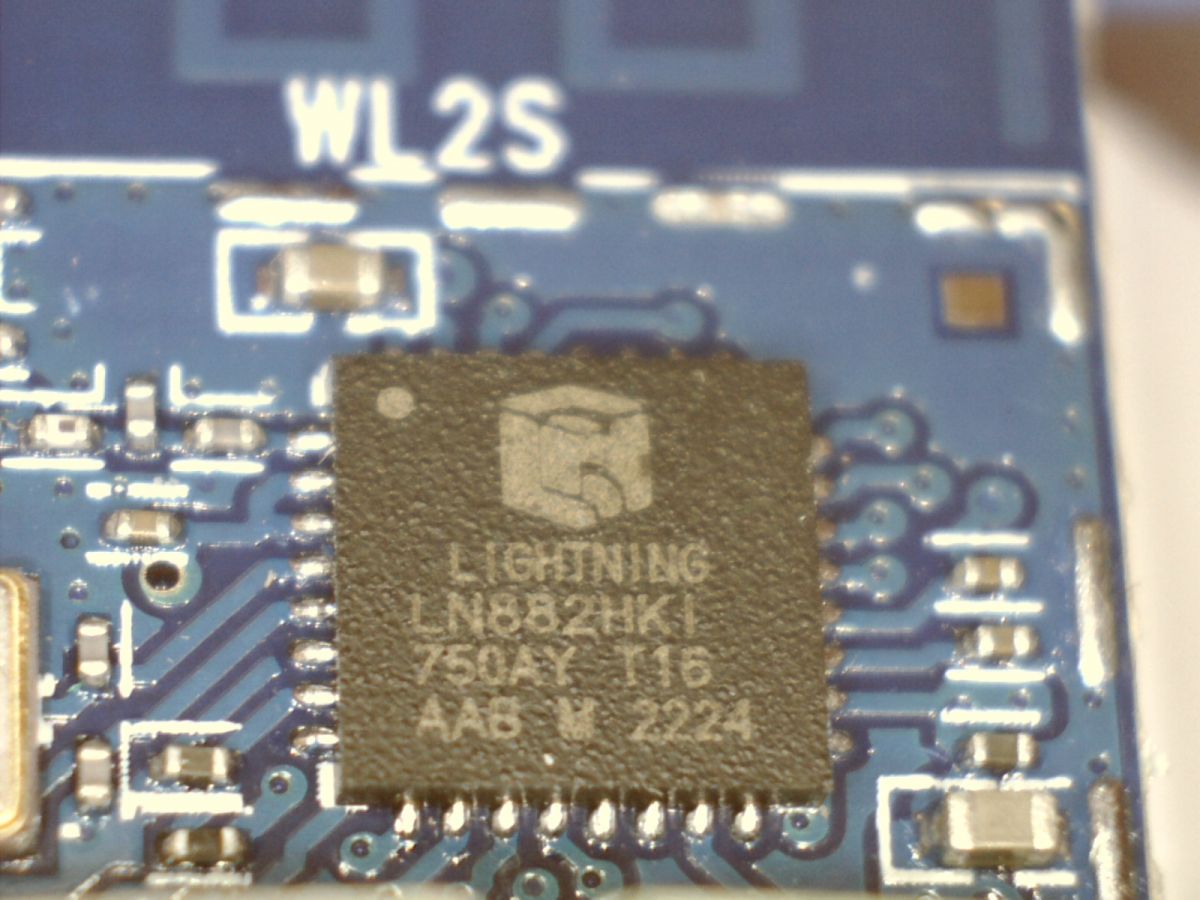

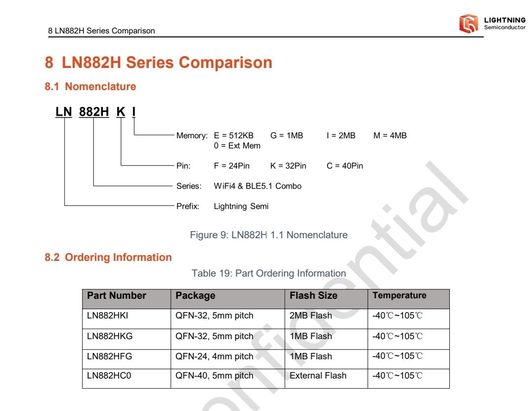

    @silvestro_gatto what's the exact chip markings? I assume HKI, so 2mb? LN882H series comparison chart with chip nomenclature and ordering information from Lightning Semiconductor.

  • LN882HKI marking confirms 2 MB flash size
    #19 21017596
    silvestro_gatto
    Posts: 30
    >>21017558
    @divadiow chip marking is LN882HKI, therefore flash size should be 2MB

    So, after some tests it seems like the problem only occurs with
    #define ENABLE_DRIVER_LED 1
    It was the first change from the three drivers enabled in this commit, so I built 516 with this line disabled: NTP works.
    To be sure I tested the other way round: Disabling both "ENABLE_DRIVER_WEMO" and "ENABLE_DRIVER_HUE" and enabling only "ENABLE_DRIVER_LED": NTP crashes the module.

  • ENABLE_DRIVER_LED only affects LED driver entries
    #23 21018009
    Posts: 14750
    Rate: 12866
    As far as I am aware there is no connection between ENABLE_DRIVER_LED and the NTP. Still, you can check it out yourself:
    https://github.com/search?q=repo%3Aopenshwpro...OpenBK7231T_App%20ENABLE_DRIVER_LED&type=code
    The ENABLE_DRIVER_LED define basically only enables LED driver entries in the drv_main.c array and also enables the color forwarding to "I2C" LED drivers.
    Does it mean that it's still just a flash size issue?

    But it should not be flash size:
    Working version with "ENABLE_DRIVER_WEMO" and "ENABLE_DRIVER_HUE" and disabling "ENABLE_DRIVER_LED" is 616.8 kB
    "Crashing" version with only "ENABLE_DRIVER_LED" (disabling "ENABLE_DRIVER_WEMO" and "ENABLE_DRIVER_HUE") is 615.5 kB
