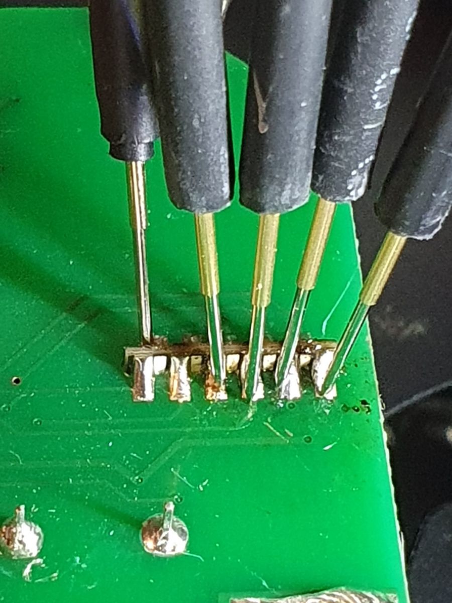

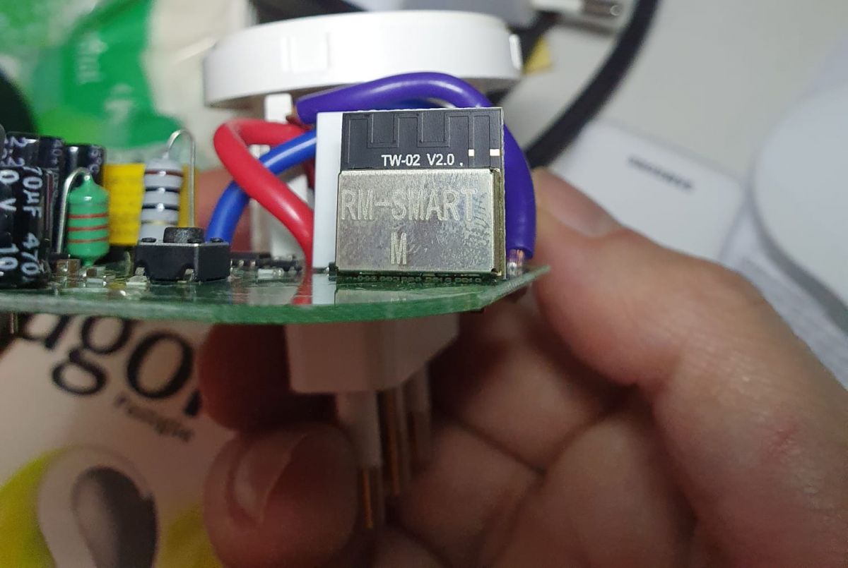

    well i have two TUYA italian PLUG
    Two white TUYA plugs with a three-pin connector, featuring blue buttons on top.
    I open it to FLASH Tasmota, but I not find the "correct chip", so I search online and I find the OpenBK project... very interesting.
    RM-SMART M module on a board with connectors.
    I try to flash directly but 1 of the 4 pin not works correctly, so I have to desolder one pin, then the flash works
    The image shows an electronics workstation with an Italian TUYA plug, a circuit board, and soldering wires. Close-up of a circuit board with several plug-in pins in a connector.

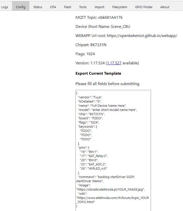

  • #7 21028096
    Posts: 5216
    Help: 448
    Rate: 917
    pop it in here. copy-paste the template from the web app
    Screenshot from the OpenBeken web app with a device configuration template.

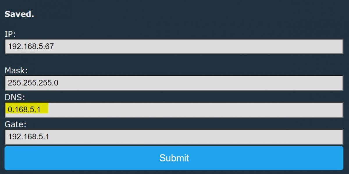

    cicciobastardo
    Posts: 17
    miegapele wrote:
    Fixed dns bug here
    it is not fixed (for me) with firmware version 1.17.538
    after submit the DNS change with 0.x.y.z
    Screenshot of a network configuration form with an incorrect DNS address.
    also the LOG info is still "inverted":
    Info:GEN:ip=192.168.5.67,gate=255.255.255.0,mask=192.168.5.1,dns=0.168.5.1
  • #13 21035843
    miegapele
    Posts: 173
    Help: 15
    Rate: 29
    The fix is not in any version yet, you can download separate build here. I did not look into inversion issue
  • #14 21035916
    cicciobastardo
    Posts: 17
    Now I tried OpenW600_1173_merge_686bc653e8be_gz.img
    but no luck,
    the problem with DNS is still there
    I'll wait for the next release
  • #15 21035928
    miegapele
    Posts: 173
    Help: 15
    Rate: 29
    Works for me, so I am not sure what could be wrong
    Added after 27 [minutes]:
    Don't forget you need to edit setting again for it to be fixed
    #16 21037711
    miegapele
    Posts: 173
    Help: 15
    Rate: 29
    This is now fixed in 1.17.539
  • #17 21037804
    cicciobastardo
    Posts: 17
    I try 1.17.540 and it works !!!
    In the LOG is always inverted gate with mask:
    Info:GEN:ip=192.168.5.67,gate=255.255.255.0,mask=192.168.5.1,dns=192.168.5.1
    But you can see the correct DNS
    thanks
