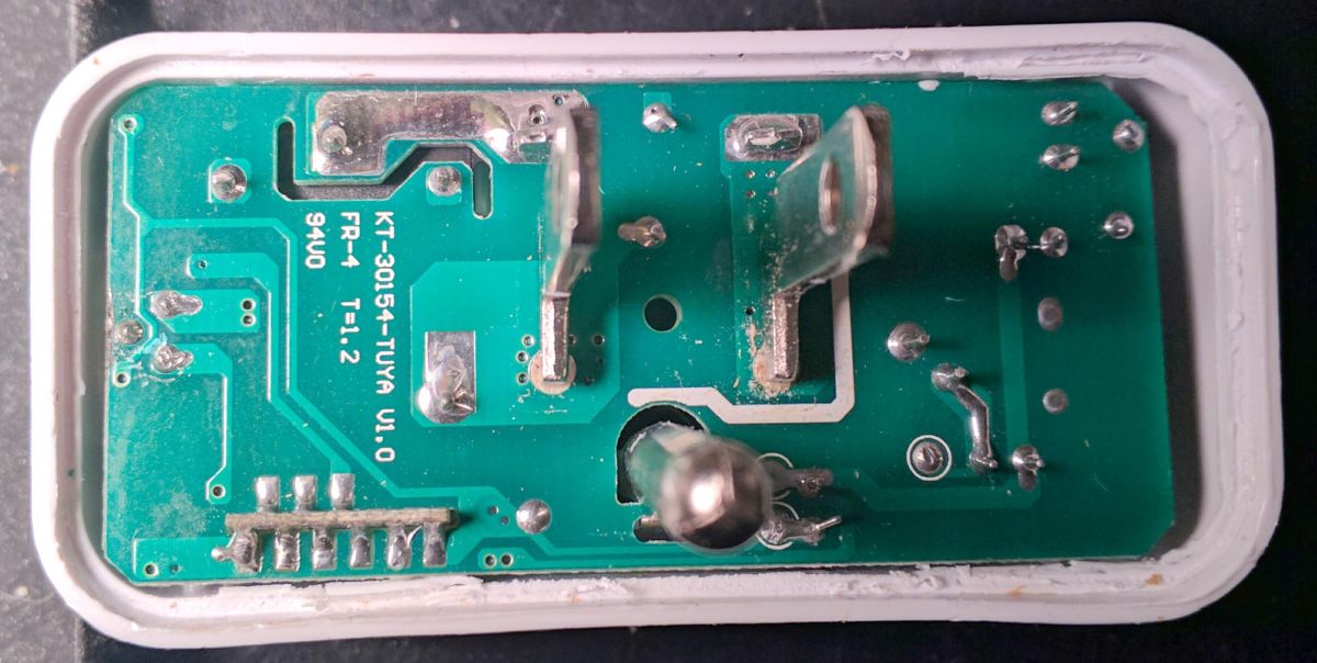

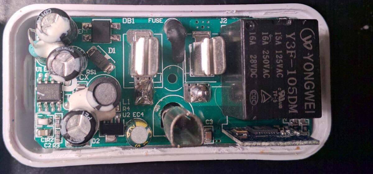

    Hi all,
    got me a bunch of these $2.56 smartplugs from KMC.
    KMC smart plug four-pack with product offer description on a webpage.
    Quality is quite good, must see how long they work before capacitors give way.
    BTW, I got me 22uF/25 ceramic capacitors and add them to the secondary stage of all these units, and switched power supplies in general.
    This reduces the stress on the existing electrolytic caps and enhances efficiency.

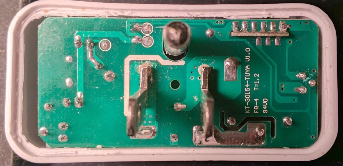

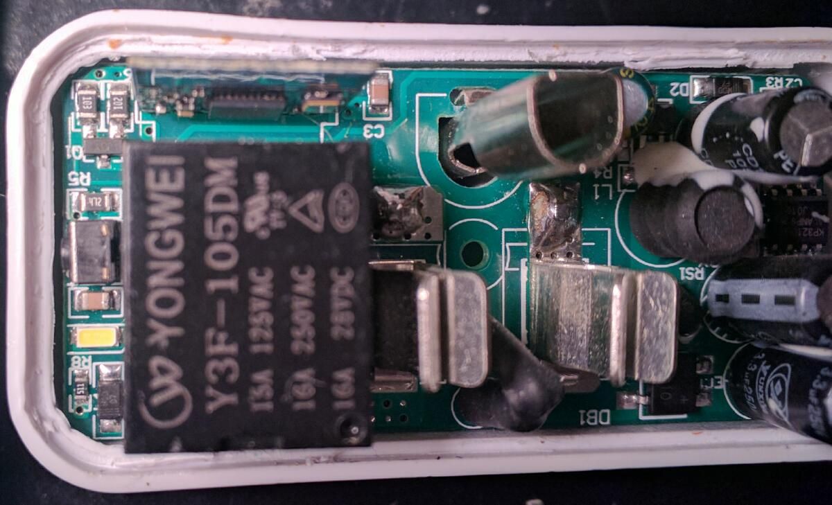

    Opening was easy, just a glued back lid.
    Interior of a smart plug with electronic components on a PCB. Circuit board of KMC smart plug with electronic components and traces. Close-up of a smart plug circuit board with visible traces and electronic components. Opened KMC smart plug with visible electrical components, including capacitors and a relay. Close-up of the inside of a smart plug with visible electronic components on a green circuit board.

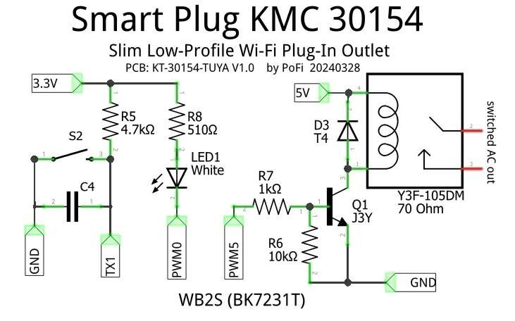

    Schematic:
    Schematic of smart plug KMC 30154 with WB2S module.
    I'm still in awe why they don't use 3.3V relays?
    This is the fourth unit where they scale down the AC to 5V (for the relays) and then with another DC/DC converter down to 3.3V (for the uController etc).
    In all these units the 5V is *ONLY* used for the relay!
    Why not scale down to 3.3V only and use a 3.3V relay???

    Thanks for sharing. I haven't indeed seen any Tuya devices using 3.3V relays, but on the other hand I don't remember seeing ANY 3.3V relays at all. It seems they are not that common. Futhermore, I think using separate LDO for WiFi module may reduce the potential interference from the relay.
    Which tool do you use to draw schematics?
  • Latching relays could cut standby power significantly
    #3 21024622
    omniron
    Posts: 114
    Yes, 3.3V relays don't exist much (yet), but there are 3V.
    Most 3V relays can be driven up to 4.5V, and many 5V relays can be driven by 3.3V.
    There were Tasmota units with 3V (latched) relays, had to replace some caps after 5ish years, other than that still working strong.
    This unit here would be a perfect example to use a latched relay.
    Controller has plenty of unused pins, it takes just a transistor and a resistor some software to use sooo much less energy over the life of the unit.
    I don't know how much power the output pins from these tuya chips can handle, but I'm driving 3V latched relays directly from ESP units by paralleling a few.
    I first activate the pins with pullups, and then go full force.
    Not only are latching relays (pulse) powered by less than half of the current relays (360mW vs 170mW), but they don't use power when on.
    There is no interference from the relay itself, maybe by the load attached, but not the relay itself. The diode at the coil takes care of that.
    And powerswise those ~72mA inrush current are also not an issue.
    I am ashamed to admit that I'm using Fritzing (the last really free version). My Orcad and other tools from 30 years ago don't run reliably on new systems.
    Fritzing is quick and dirty but bad.
  • Latching relays suggested for lower power IoT designs
    #4 21026611
    Posts: 14756
    Rate: 12883
    I am not sure about using 3V relays because they would need to be powered from the same rail as WiFi module, but that certainly would be an interesting experiment. Are you planning to try?
    The latching relays, on the other hand, are great and it's a shame that they are not used more. I have indeed seen some latching relays in the IoT products already but they were mostly used in the battery-powered light switches controlled via RF. I think using latching relays in IoT products could really have made a change but chinese manufacturers prefer to lower the cost of the product at the expense of the higher power consumption when relay is on...
