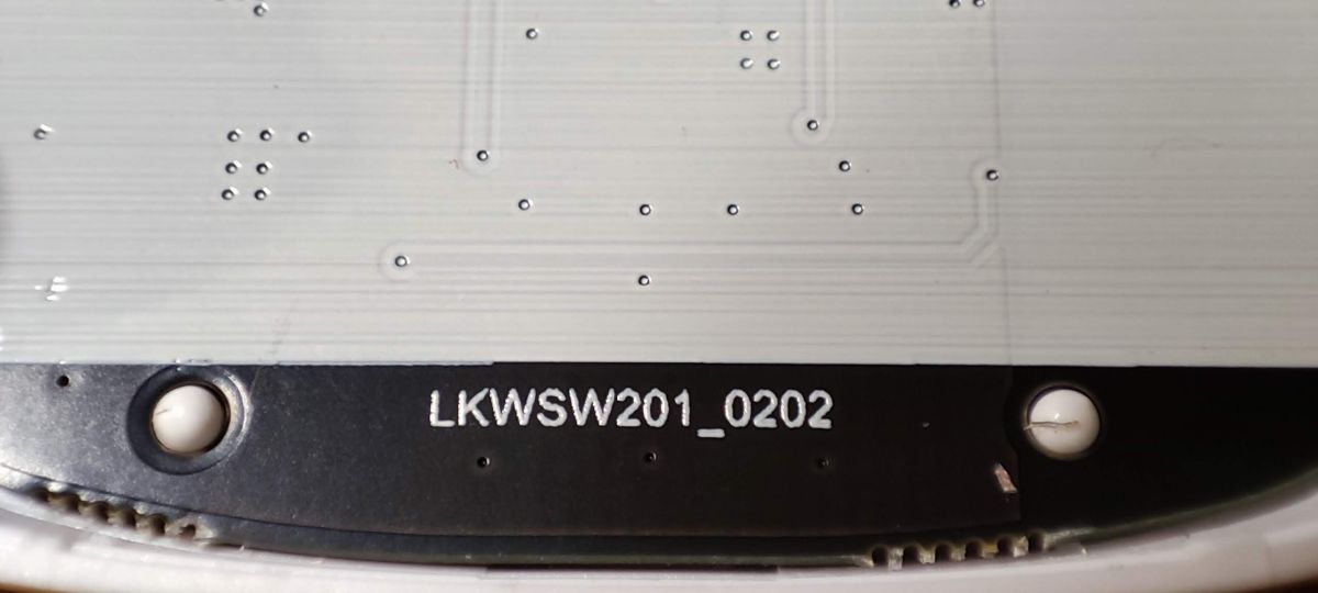

    I have flashed the Beken firmware to the device, but I failed to copy the template from the original device.
    Now I can manage the single click on both buttons, but I can't manage the battery status and double or long click.
    Can anyone help me?
    ThankYou
    Torsten

    Ha. You beat me to the first post of this device. I dumped and flashed one of these last week and was working on an autoexec to complete the button usefulness in home assistant. I'll post what I have tomorrow, but from memory BAT_ADC is P23 (as always) and BAT_Rel is P17. The measurements will be ~300mA too high until further config.
    Added after 10 [minutes]:
    Also. It's clear this scene switch build shares some pcb/chassis moulds with this https://www.elektroda.com/rtvforum/topic4042463.html
    Which I thought was interesting

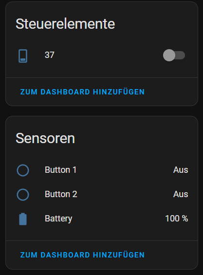

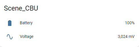

    Screen view of a user interface showing control status and battery level.
    Battery is working now.

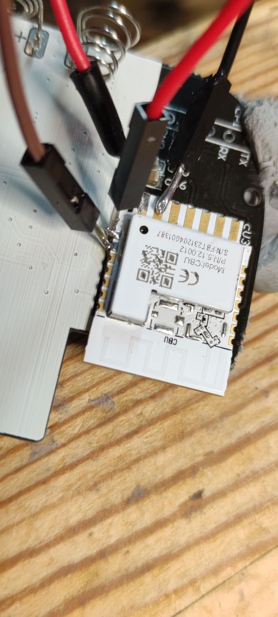

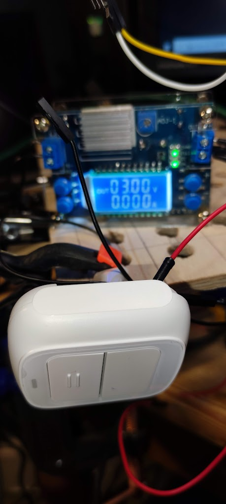

    Or, more likely, I was going to make a hole in the back of the device and solder in an AMS117/USB 5V cable to give a constant 3v or 3.3v, so it's always on.
    if on battery I'd want something to make it go into safe mode. that battery_setup is what gave me accurate battery voltage at 100% - I was powering it from a 3v external PSU. my basic autoexec beginning:
    Widget displaying battery level and voltage of the device.

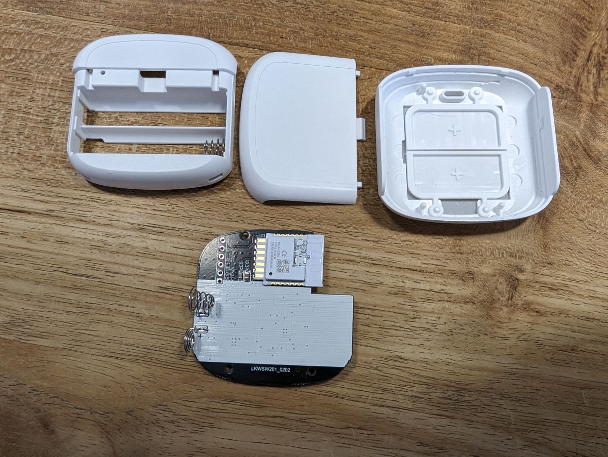

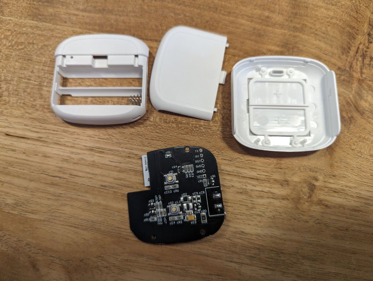

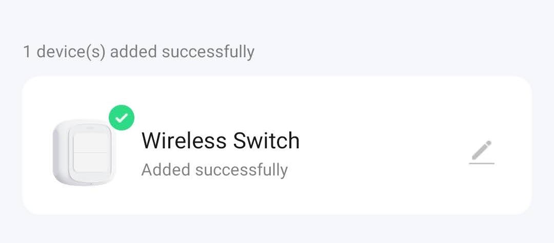

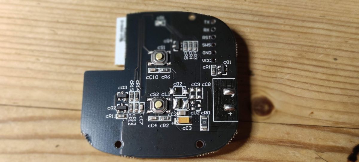

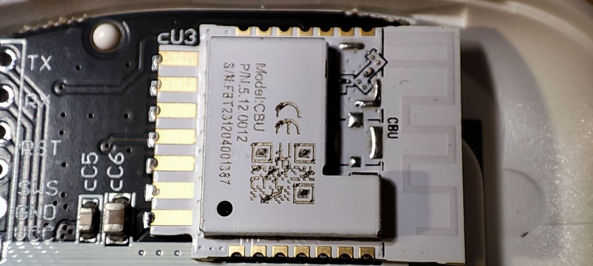

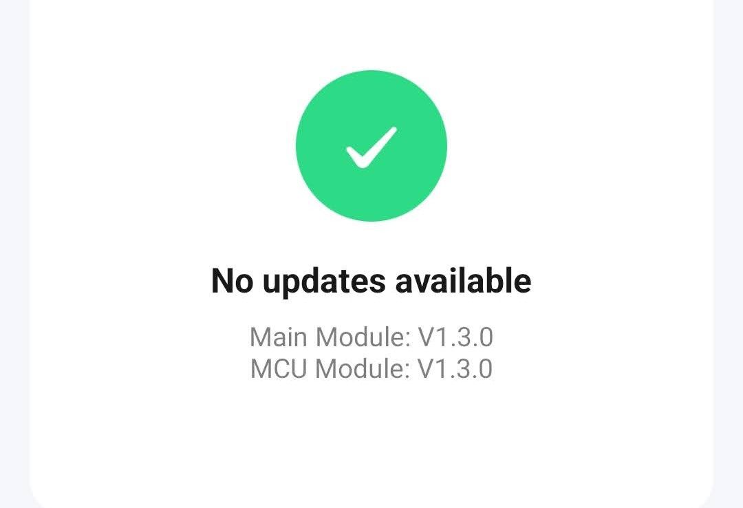

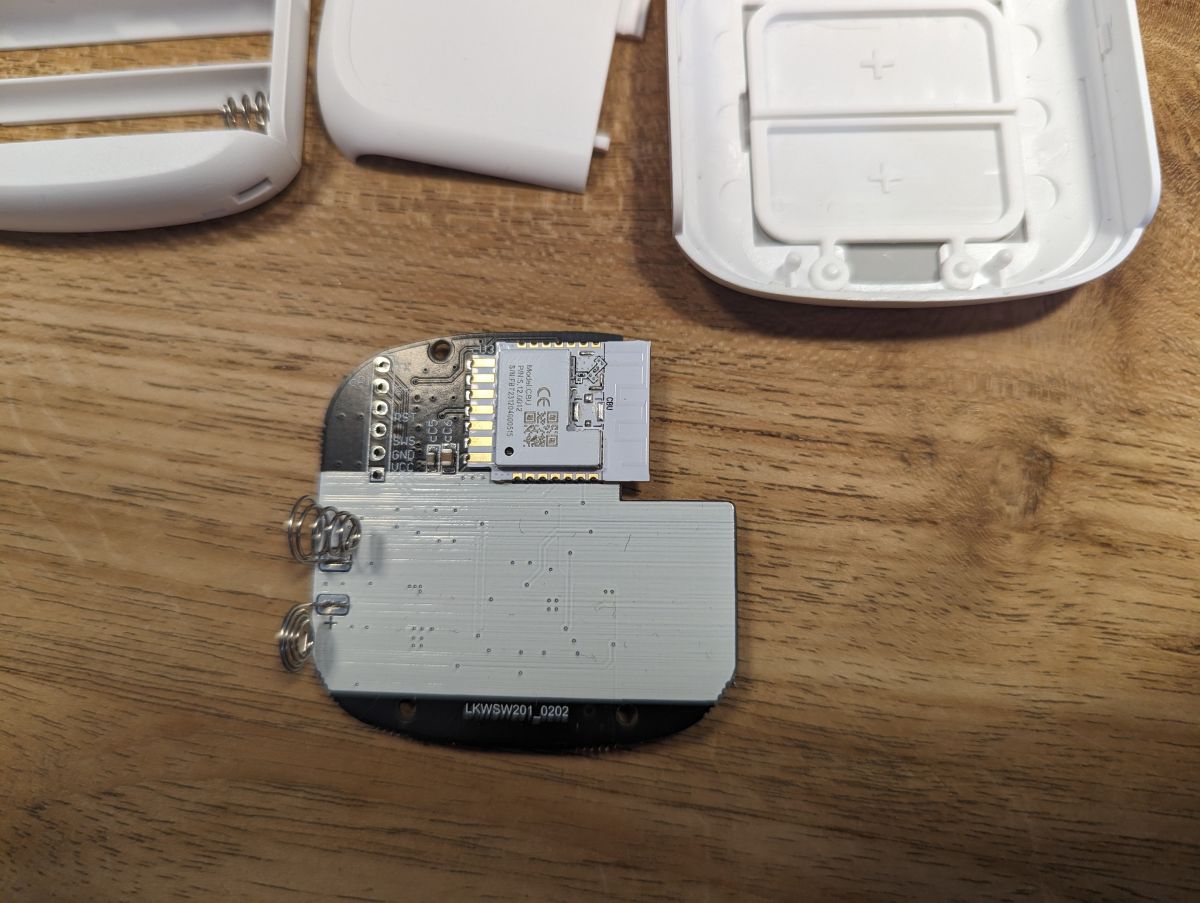

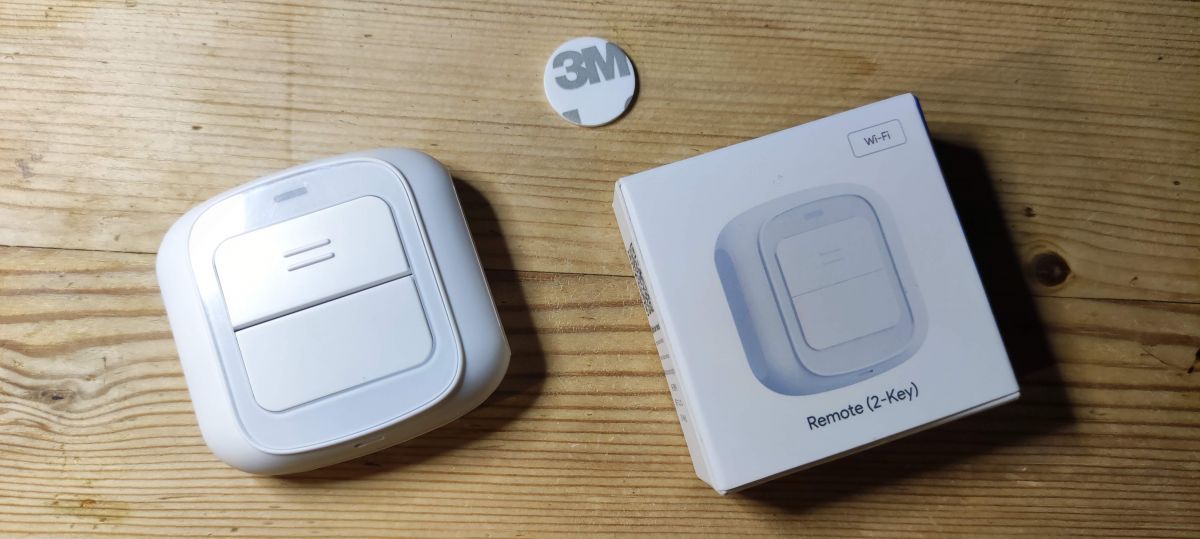

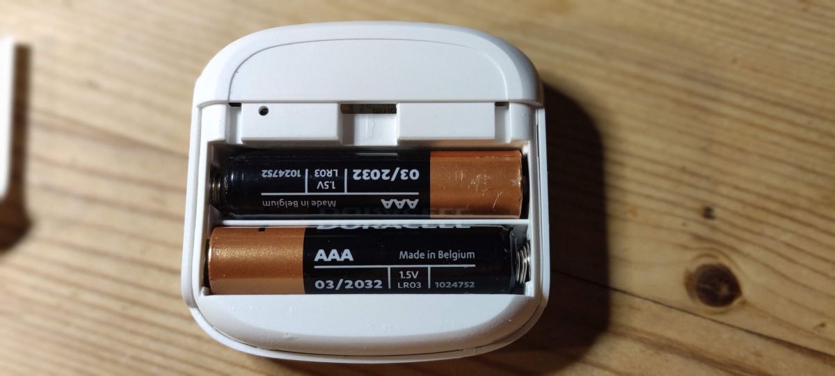

    pics and things for the library/device list
    Wireless two-key switch and its box on a wooden surface. View of AAA batteries in an electronic device Close-up of an electronic module Model CBU on a PCB, showing pins and markings. Part of a device casing with the model designation LKWSW201_0202. Interior of a plastic battery compartment showing slots for two AAA batteries. Printed circuit board with buttons and electronic components. Printed circuit board with electronic components. Close-up of an electronic module with wires and soldered connections. Box of a Wi-Fi-enabled two-key remote. Notification of adding Wireless Switch device in the app. App interface for managing a wireless smart switch with different gesture clicks. Action selection menu for a wireless switch with options: Single Click, Long Press, Cancel. App screen showing no updates available.
    UART boot output
    Tuya API
    JSON
    https://github.com/OpenBekenIOT/webapp/pull/9...mits/c79c58d37697358f7ec4b6eb263d08038c0c2c26
    Device uses a custom firmware, so no GPIO extraction in Easy Flasher

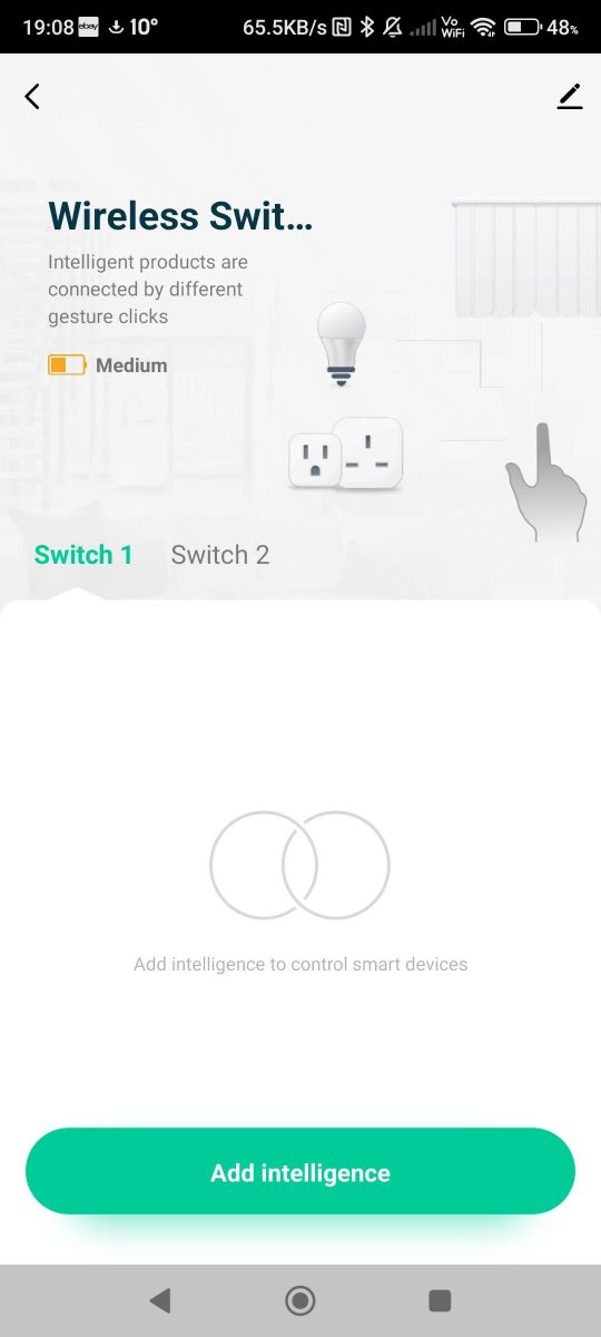

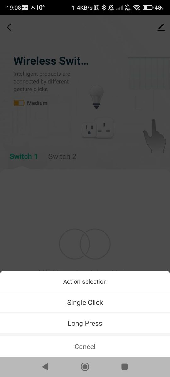

  • Questioning double and long click support
    #5 21031178
    torte
    Hi,
    I am very very new to the beken devices. This was the first time I flashed one.
    So I have zero idea :-)
    I only got this so far by reading here in the forum and youtube.
    My Autoexec.bat only contains "PowerSave 1"
    The batteries have lost 18% since yesterday.
    I will now try your Autoexec.
    But you can't do the double or long clicks, can you?
    I plan to use the switch for a roller shutter, a click is then up or down by step double click would then be automatically up or down
    Thank You
    Torsten

    Ah yes. We need a lot more to finish setup. Powersave 1 will not be enough to stop the batteries dying within a day or two.
    My device is not of use so far. I'll do some more playing.

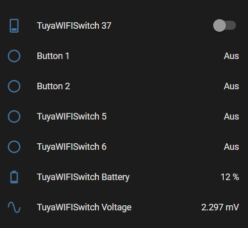

    Screen displaying status of various switches and battery information.
    Battery power may be too slow for wake and MQTT

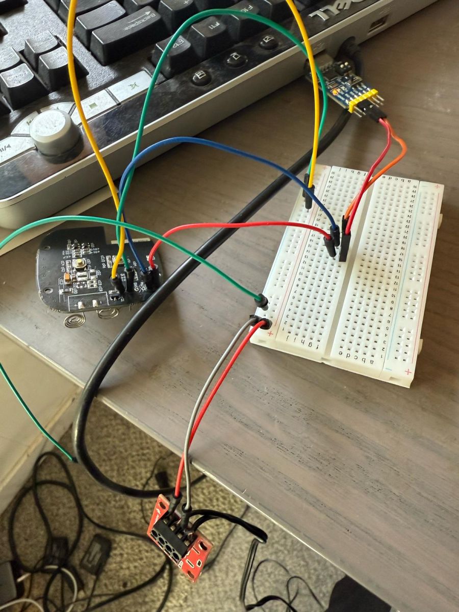

    For the life of me I can't get this switch to boot into download mode. There's not a ton of information about this specific switch so I thought I'd reach out in case any of you are willing to share some tips.
    Thanks in advance.

    >>21520643
    what does your wiring look like? how are you powering the device/module?
  • USB adapter was in TTL-to-232 mode
    #14 21521306
    glate
    >>21520881
    I have the switch connected to a breadboard and a Sparkfun AP63203 - I had it connected to a cheap power supply but the voltage drop wasn't giving me confidence so I moved to use the buck converter.
    I only have one USB/UART adapter.
    Things I'm unsure of:
    1. I'm unsure whether I should have a common ground between my (single) usb/uart adapter and the power supply connected to GND. I've tried both ways.
    2. Some sites say I should connect SWS to ground as well?
    3. If I need to solder directly to the chip, if the pin headers are sufficient or if I have to desolder the CBU (scary)
    I've tried swapping TX/RX multiple times, etc. I can get boot logs off TX1/RX1 (pins 10 and 11) but besides that nothing. Have tried with both ltchiptool and BK7231Flasher.

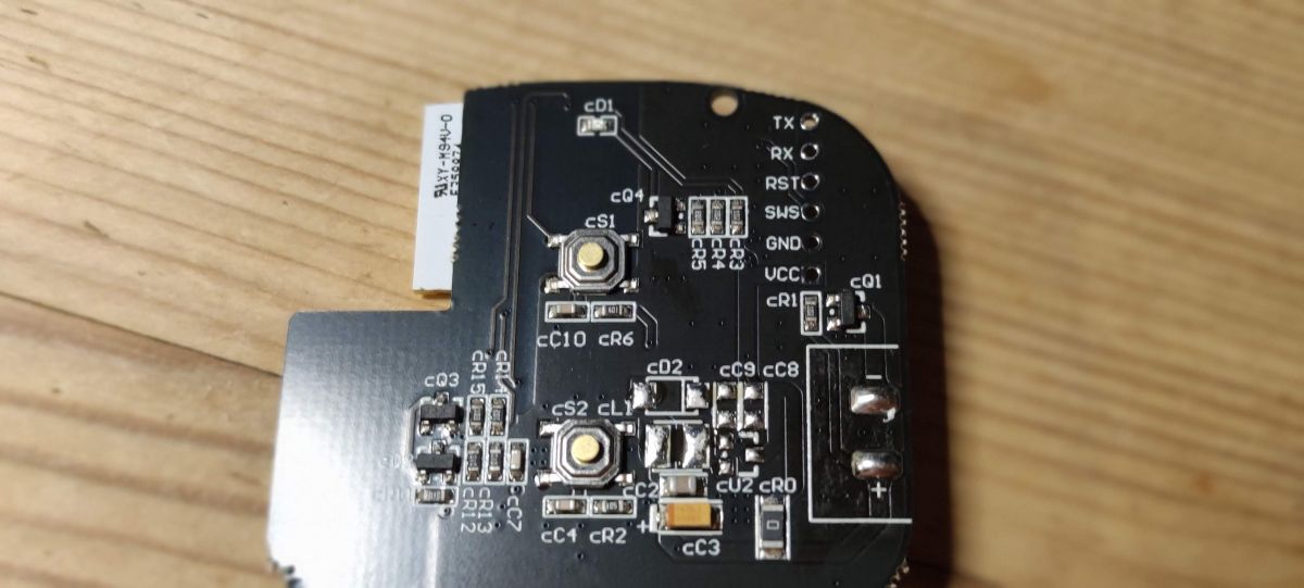

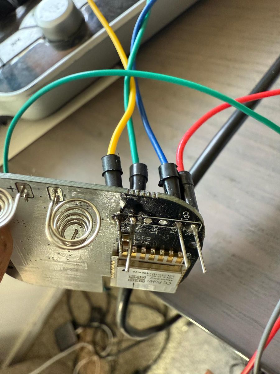

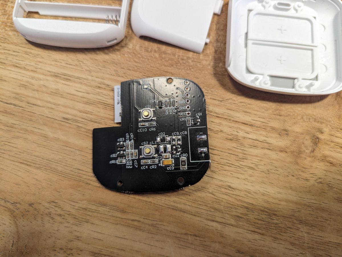

    Pics:
    A breadboard with connected jumper wires, a UART module, and a push button, all set on a desk next to a keyboard.
    Electronic board with connected wires and visible programming pins.
    Thanks very much.
    Added after 7 [hours] 4 [minutes]:
    after all that it turns out the jumpers on my usb adapter had been bumped and it was in TTL to 232 mode. Overly complicated a simple process. Thanks!
  • #15 21521878
    Posts: 5236
    Help: 449
    Rate: 918
    good job!
