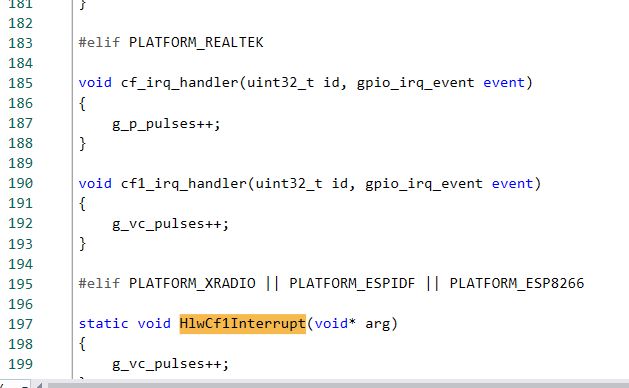

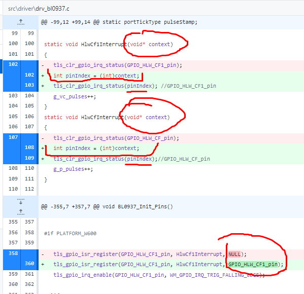

    I've started playing around interrupts.
    It seems that on BL602, we need to pass pin index to the interrupt to clear the flag - it can be done via user data.
    First step:
    https://github.com/openshwprojects/OpenBK7231T_App/pull/1768
    I assume that we would do a wrapper call via function pointer in HAL...
    Added after 3 [minutes]:
    Same for W600
    Screenshot of C code changes in drv_bl0937.c showing GPIO interrupt handling updates
    Added after 33 [seconds]:
    Those platforms seem easier - no flag clear needed:
    Screenshot of C code showing GPIO interrupt handler functions for multiple platforms
    It seems that only PLATFORM_LN882H is tricky

    Update: currently not sure about gpio_install_isr_service, need to read up on it, seems like it will be called globally once?
    Added after 1 [hours] 28 [minutes]:
    Not sure about Realtek - how to access last argument (NULL), user data?
    Code: C / C++
    hmm event is an enumeration:
    Code: C / C++
    Added after 46 [seconds]:
    ah last argument is ID:
    Code: C / C++
    so it shall be passed as first one to interrupt

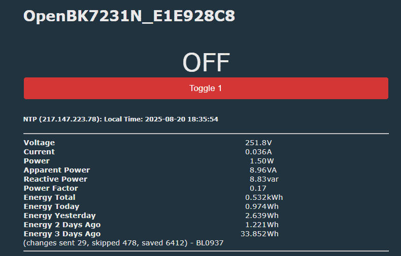

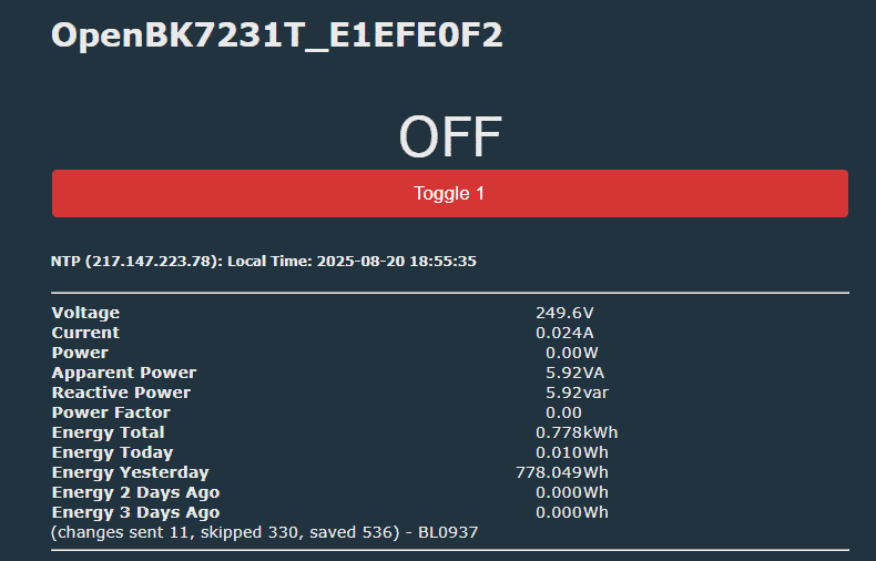

    @insmod can you check? @divadiow do you have any devices with BL0937?
    The most uncertain part is passing GPIO index to interrupt in HAL so it can call external handler.
  • #74 21639409
    Posts: 5220
    Help: 449
    Rate: 918
    not all platforms but yes to at least LN882H, BK7231N, BK7231T, ESP8266, RTL8710B, BL602

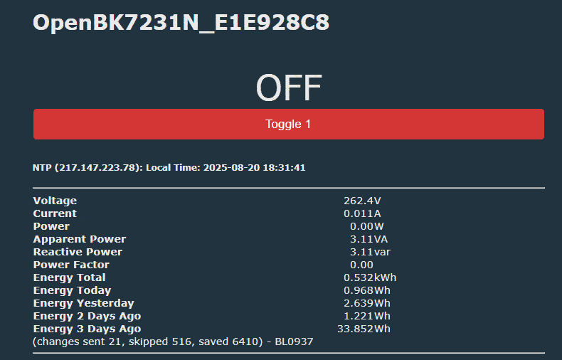

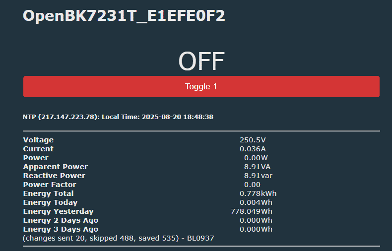

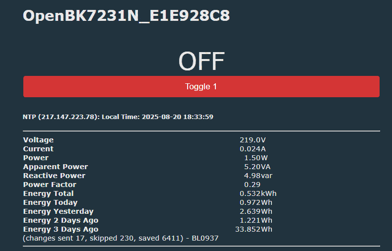

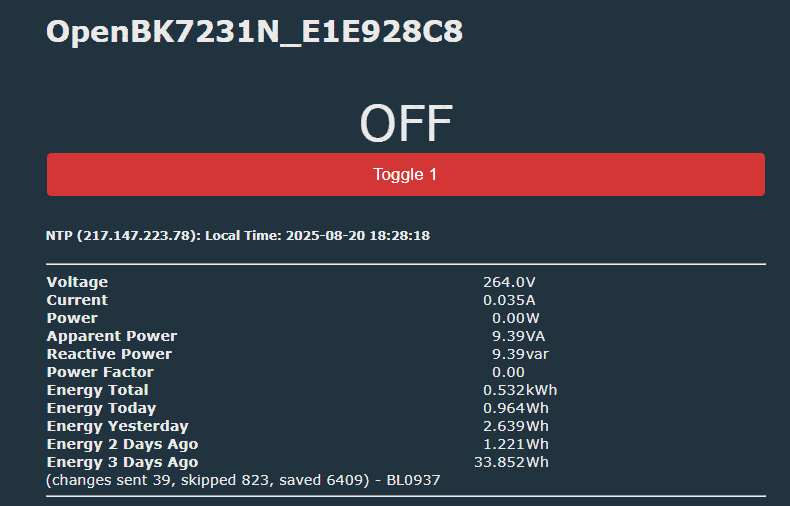

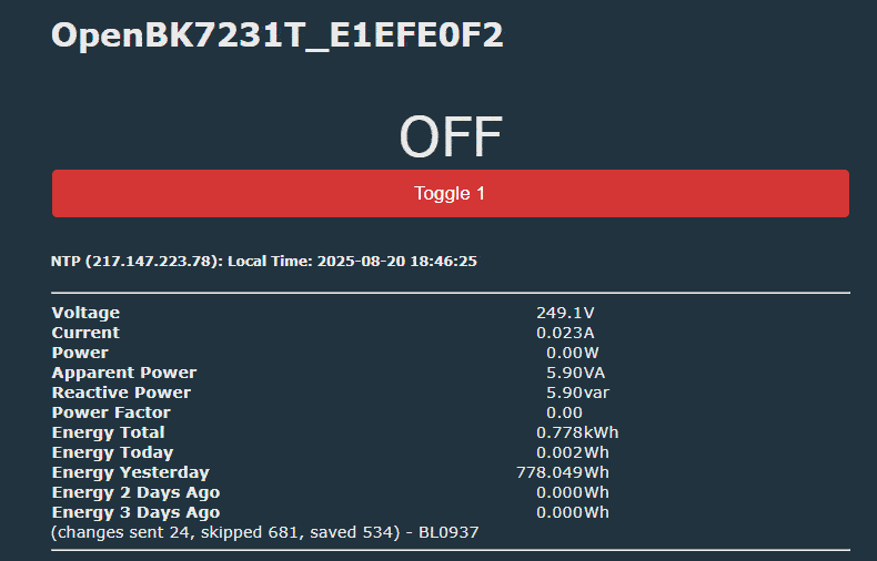

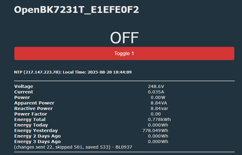

  • Use RTOS ticks for a more reliable clock
    #76 21639787
    max4elektroda
    Posts: 758
    Help: 49
    Rate: 189

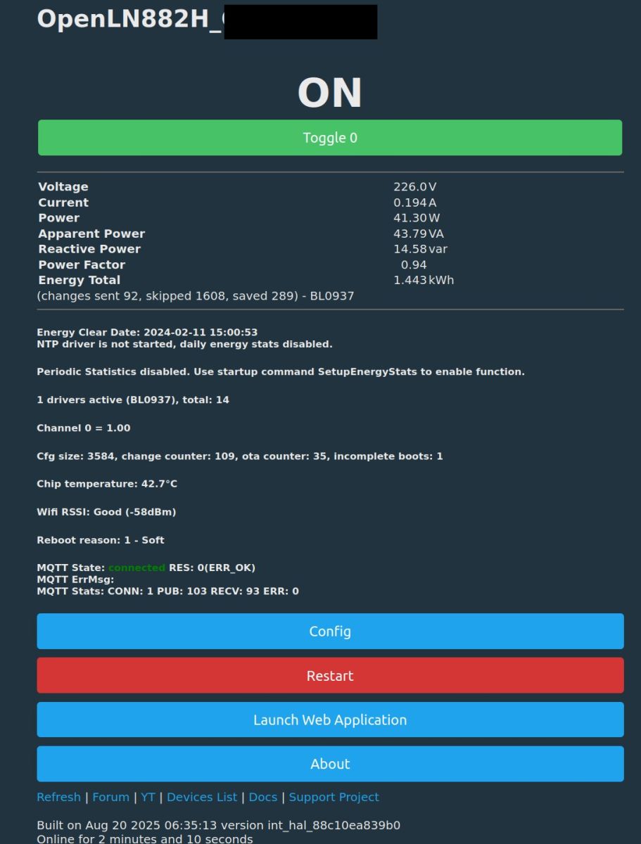

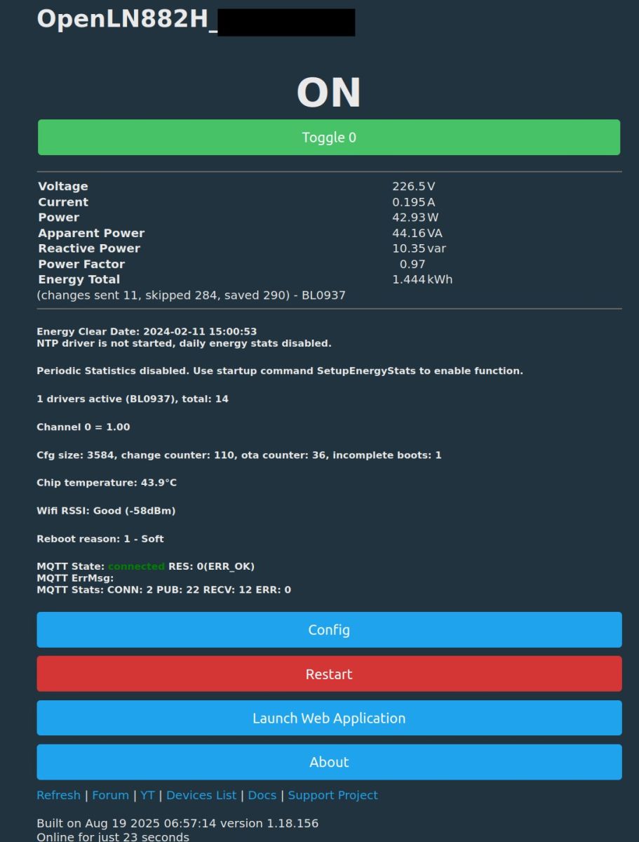

    I can confirm LN882H working:
    OpenLN882H web panel showing power data and device control options Web interface of OpenLN882H showing voltage, power, and network status.

    >>21639409
    animated images
    BK7231N 1.18.156
    OpenBK7231N interface showing voltage, current, and energy metrics
    BK7231N 1768_merge_cf30e28012eb ✅
    OpenBK7231N interface showing power usage and status data
    BK7231N_ALT 1.18.156
    OpenBK7231N interface with OFF status and detailed power metrics
    BK7231N_ALT 1768_merge_cf30e28012eb ✅
    OpenBK7231N web interface showing energy data and OFF device status
    BK7231T 1.18.156
    OpenBK7231T interface showing status OFF and electrical energy metrics
    BK7231T 1768_merge_cf30e28012eb ✅
    OpenBK7231T interface showing power data and OFF status
    BK7231T_ALT 1.18.156
    OpenBK7231T interface showing voltage, current, and energy usage details
    BK7231T_ALT 1768_merge_cf30e28012eb ✅
    OpenBK7231T interface showing energy readings and OFF power state
    (new SDK still does its spikey/jumpy reading thing on any release)
  • #88 21640070
    insmod
    Posts: 1432
    Help: 168
    Rate: 455
    >>21640066
    Set loglevel to 0 and spikes will 'magically' disappear.
  • #89 21640079
    Posts: 5220
    Help: 449
    Rate: 918
    ooh ok.
    damn. ESP8266 BL0937 device is 1mb.
