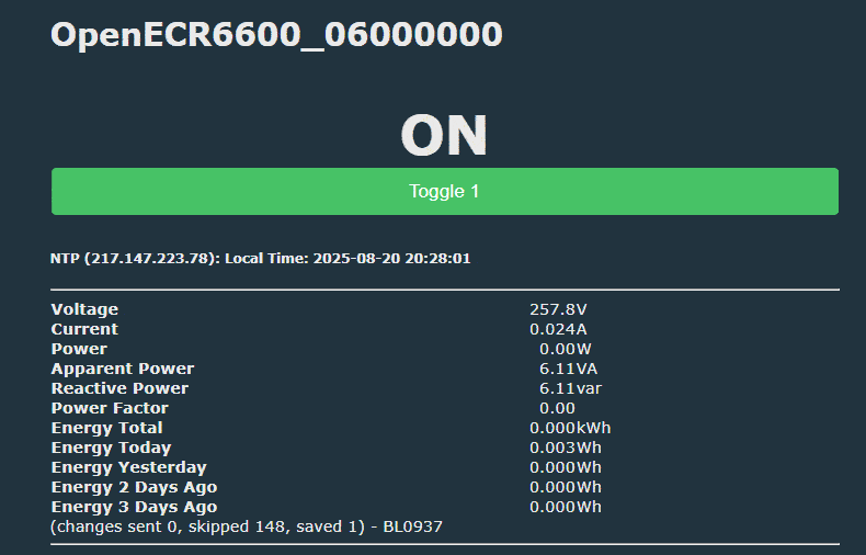

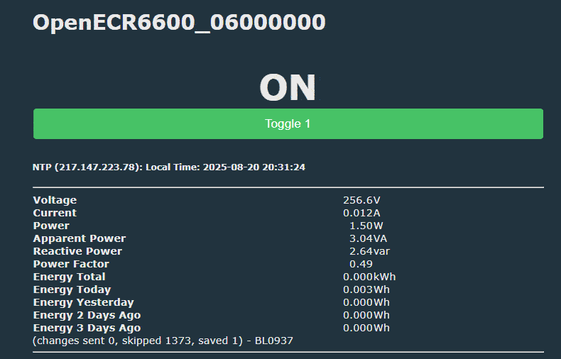

    ECR6600 1.18.156
    OpenECR6600 interface screen showing ON state and energy measurement data
    ECR6600 1768_merge_cf30e28012eb ✅
    OpenECR6600 control interface with voltage, current, and energy data

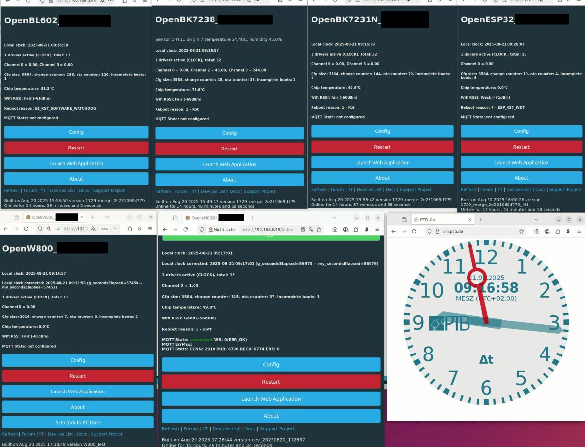

    #93 21640278
    max4elektroda
    Posts: 758
    Help: 49
    Rate: 189
    Probably store deltas and collect them in quick tick...
    Btw, anyone knows in which periods quickticks are called in real life?
    If I understood it right, it will get the real time in Beken and ESP and else assume 25ms?
    We might even here go for the "right time" with xticks and possibly even set g_secondsElapsed while at it?
    Just thinking out loud...

    Tested over night with BL602, BK7238, BK7231N, ESP32, W800, LN882H:
    Screenshots of OpenBK UIs on various IoT devices and a PTB time sync clock.
    For LN882H its 3 seconds off after 15 hours, rest ~ 1 second (plus there's a small gap in how exactly time was set).
    Only "big" difference on ESP32, which is 12 minutes(!) off.
    Maybe @insmod xTicks are "second choice" and I should try to use esp_timer_get_time() , like for quickticks?
