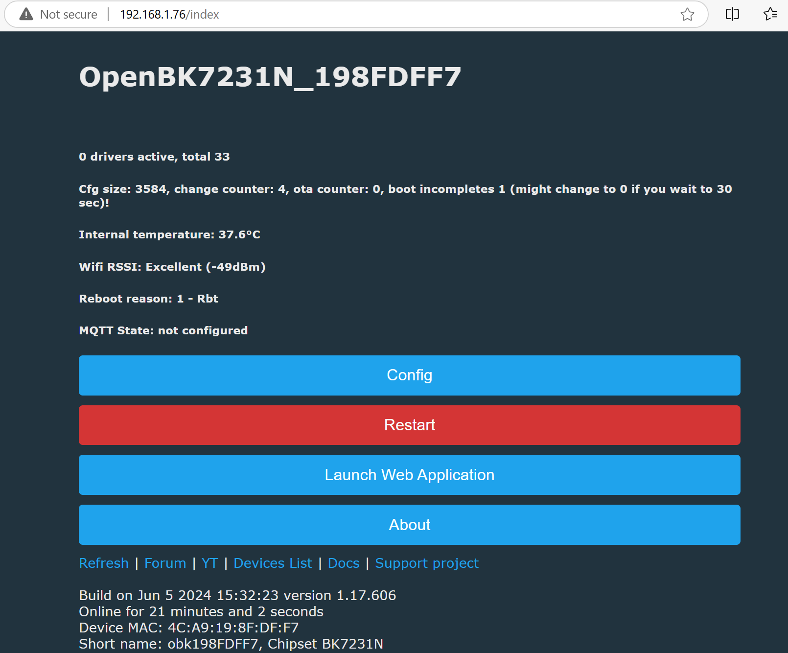

    #35 21296271
    amymariegerlach
    Can someone help me please. I bought a couple of these switches to replace some cheap hubspace motion switches that were malfunctioning in my home. I successfully flashed openbeken onto the first one but I unchecked the auto config button in the easy UART flasher because I kept receiving errors, thinking I would be able to configure the device like I normally do with Tasmota devices, through the device access point. I have logged into the access point and configured my SSID info. I'm not really computer smart and don't know how or where to paste the data that is found in the beginning of this thread (dpIds, device status from tuya website, and autoexec.bat). I'm in the online app for my device and can view all of the different tabs but again don't know what to paste or where to put it to define this switch. I've found the template in screen shot 2 below but it looks like no pins or flags are transferring over and the device is still not configured even though I have "green" in the last photo.
    in case it matters...I did update to the newest firmware via OTA
    OpenBK7231N user interface with buttons for configuration, restart, and launching the web application. OpenBeken device configuration page with various settings. Screenshot of the Tuya device configuration interface.

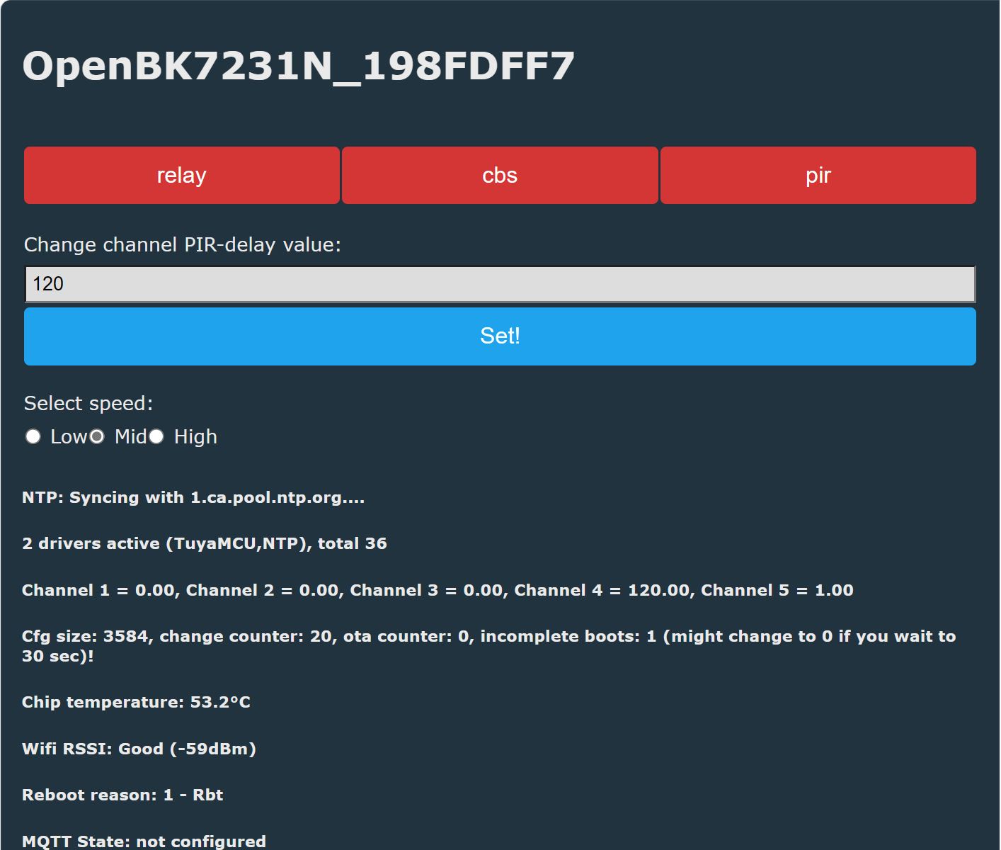

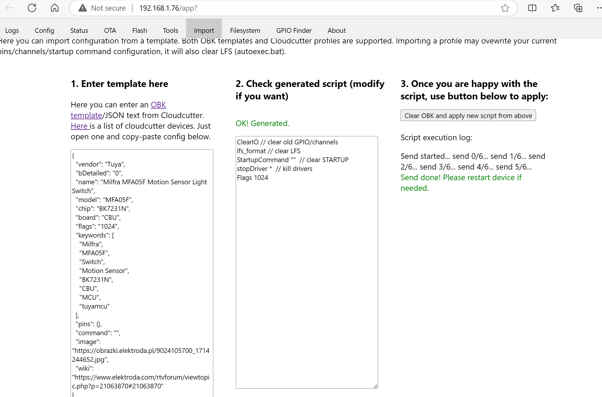

    #37 21300900
    amymariegerlach
    Thanks for the link.
    OK, I got the autoexec.bat file pasted into the correct location and my switch has been partially configured (see 1st pict)
    User interface for configuring OpenBK7231N device.

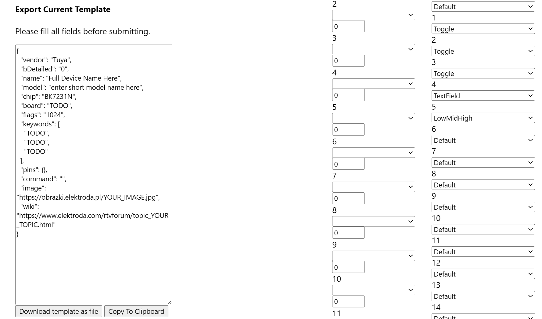

    I say partially because the template still has all of the generic info and nothing showed up in the pins section (pict 2)
    Device configuration template with empty fields and Tuya chip identifier.
    Am I needing to insert the other two files from the first post, the dplds, and the device status from tuya website? If yes, where do they go?
  • #38 21305821
    Posts: 14797
    Rate: 12954
    You only need autoexec.bat. This is TuyaMCU device, so no pins are used except the UART1 port, which is used for MCU communication.
