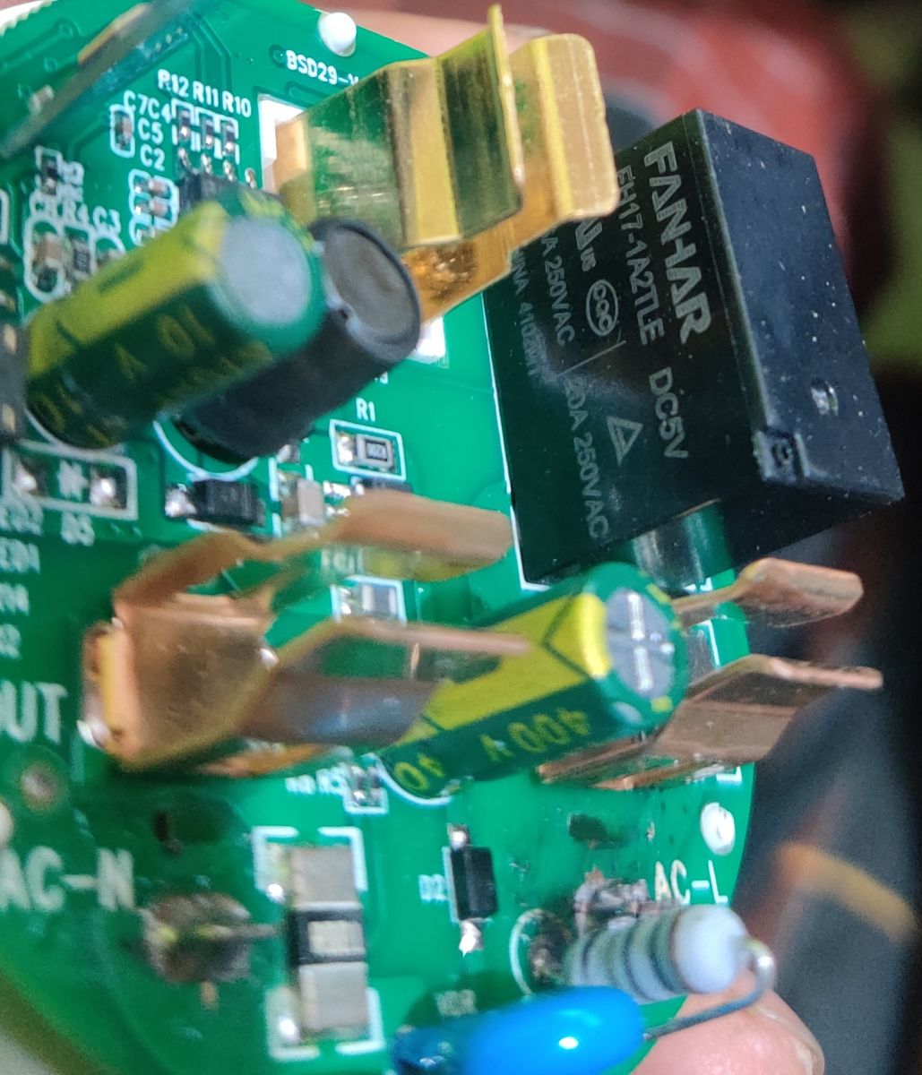

    The relay inside the plug has a 20A label, but from the size of it, I wouldn't trust it. Close-up of a circuit board with a FANHAR relay and other electronic components.

    Use something passing safety standards like Shelly. If using Ali stuff, replace relay with some good name brands (if they make such size relays).
    Other than that capacitors from these sockets are known to fail pretty often, can be replaced with good brands for reliability.
  • Relay and capacitor brand recommendations for AliExpress switches

    Preferably no more than 50% of the claimed current by the Chinese and better still 30% ;) For me at ~50% load the relays started to fail after a time of ~1.5 years.
