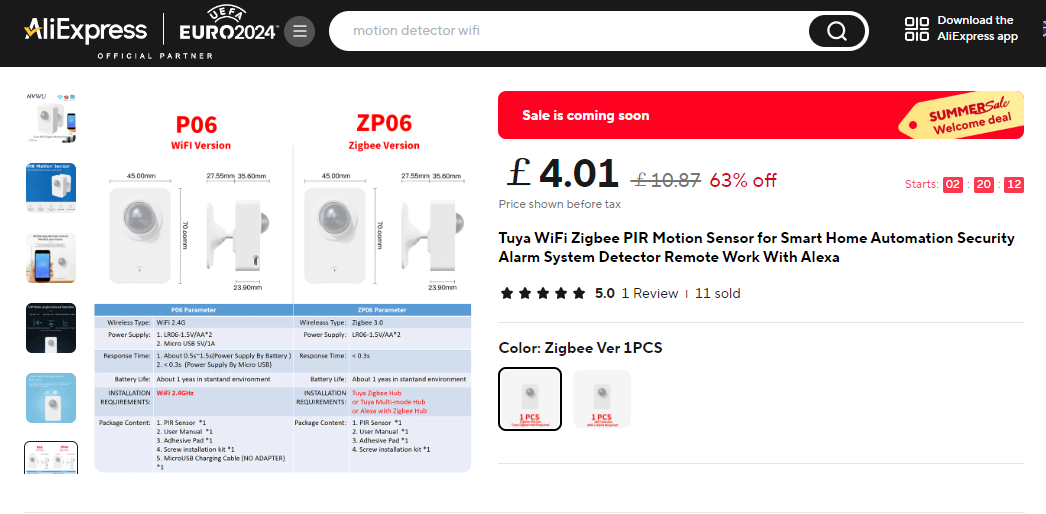

    This item was purchased from https://www.aliexpress.com/item/1005004083257831.html from the NVWU store
    Screenshot of an AliExpress product page featuring the Tuya PIR motion sensor.

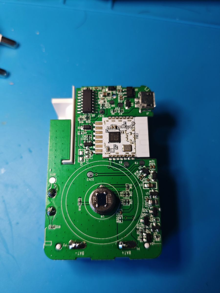

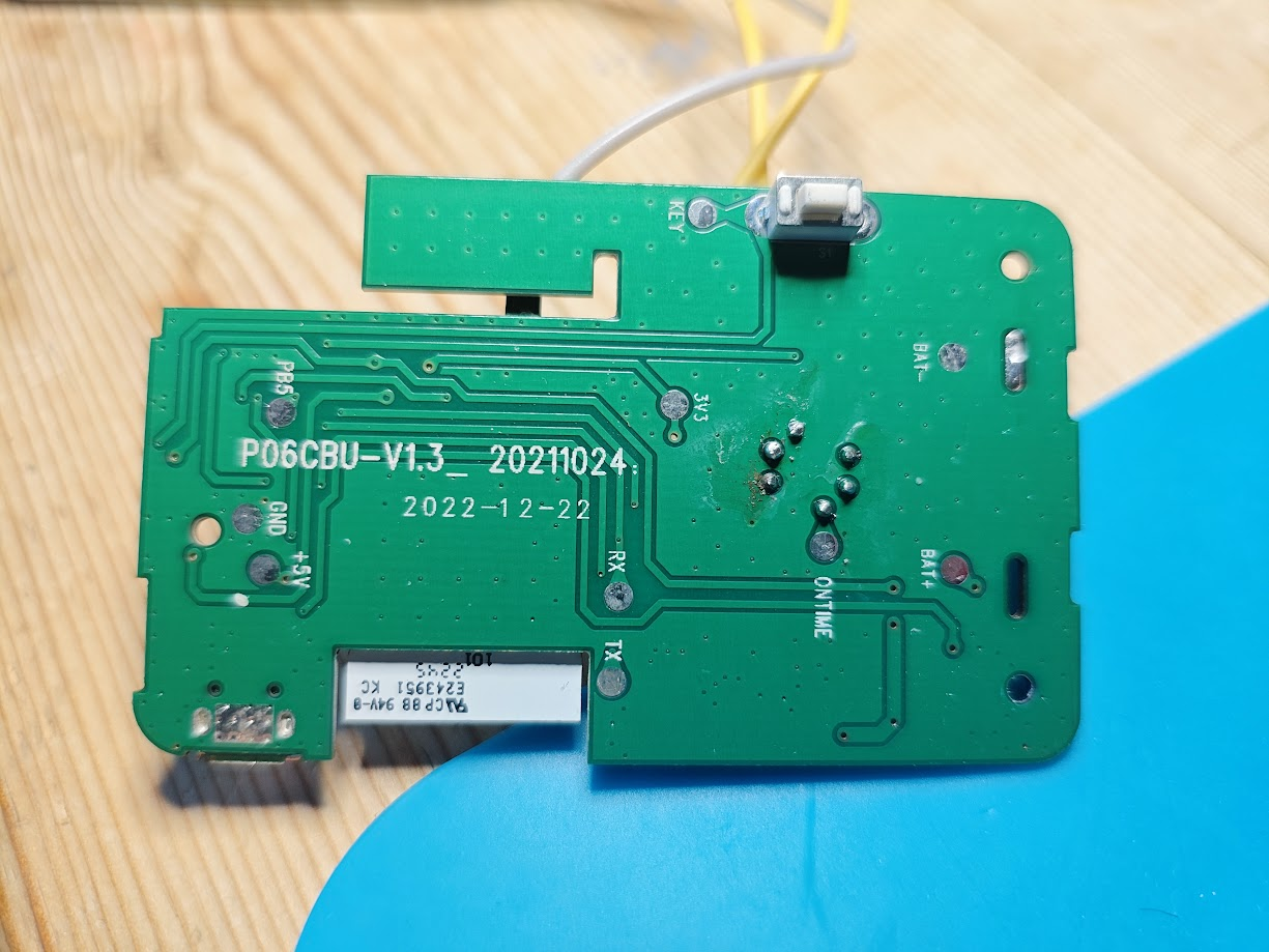

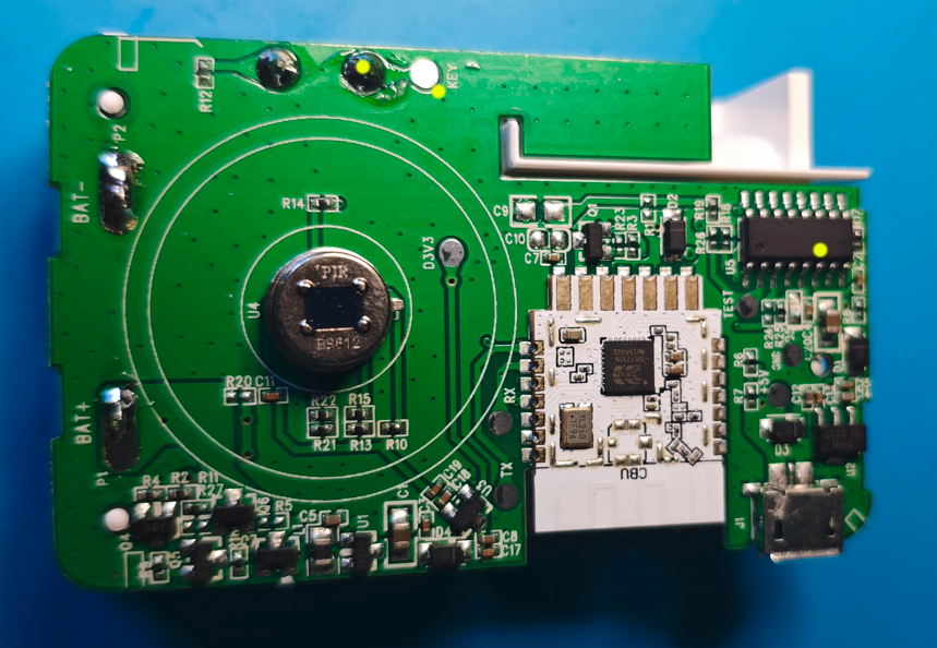

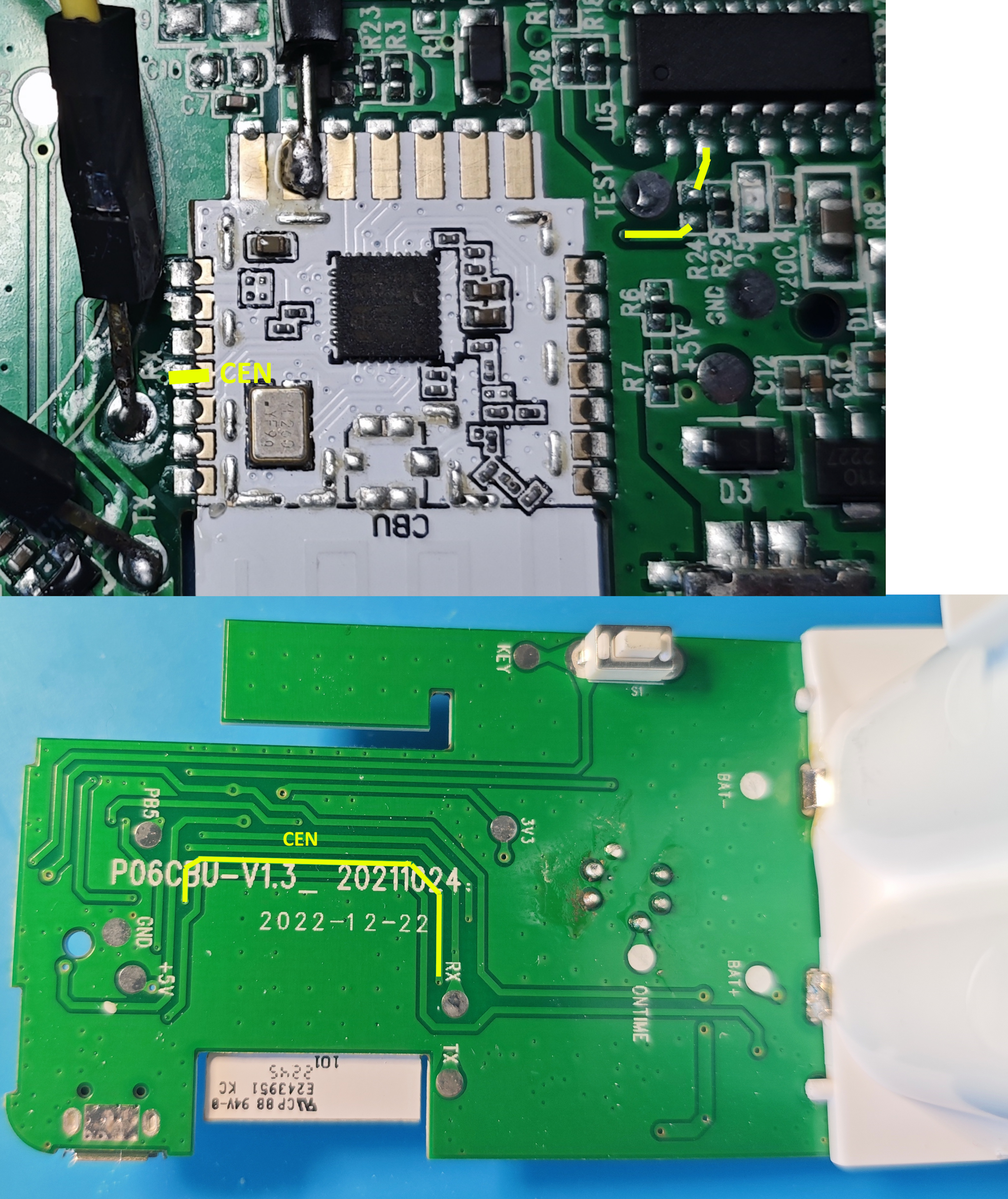

    Opening we see it comes with a CBU module. Unlike this P06 which comes with an XR3 (which is what I was hoping for). We also see it's accompanied by a Tuya MCU.

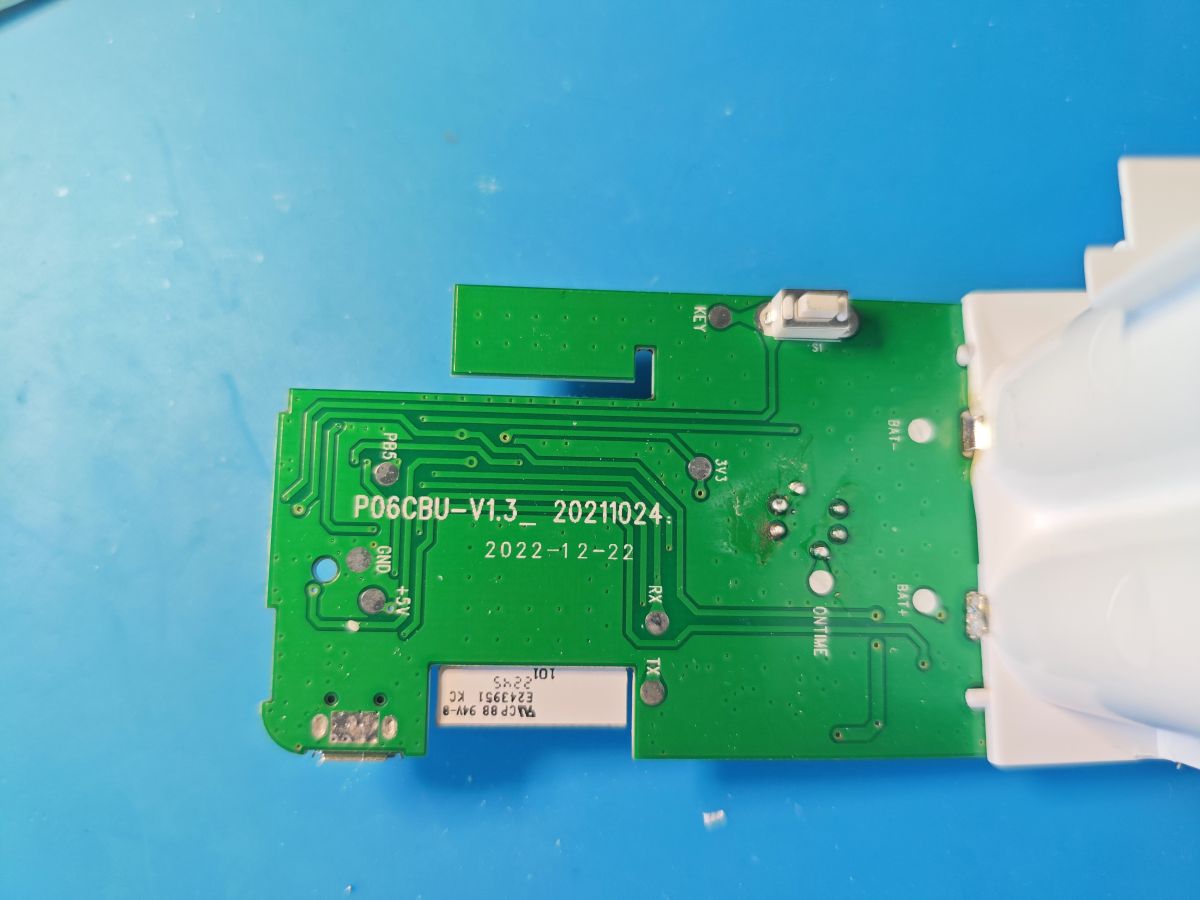

    View of the P06CBU-V1.3 motion sensor circuit board with the date 2022-12-22. Circuit board with P06 Tuya PIR electronic module. Circuit board of the P06 Tuya PIR device with markings and a micro-USB port. PCB from a Tuya PIR P06 motion sensor with connected wires.
    from TX2:
    As expected the RX1/TX1 communication with the Tuya MCU gets in the way of dump/flash
    Screenshot of TuyaMCU Explorer/Analyzer software for OpenBeken.

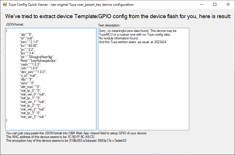

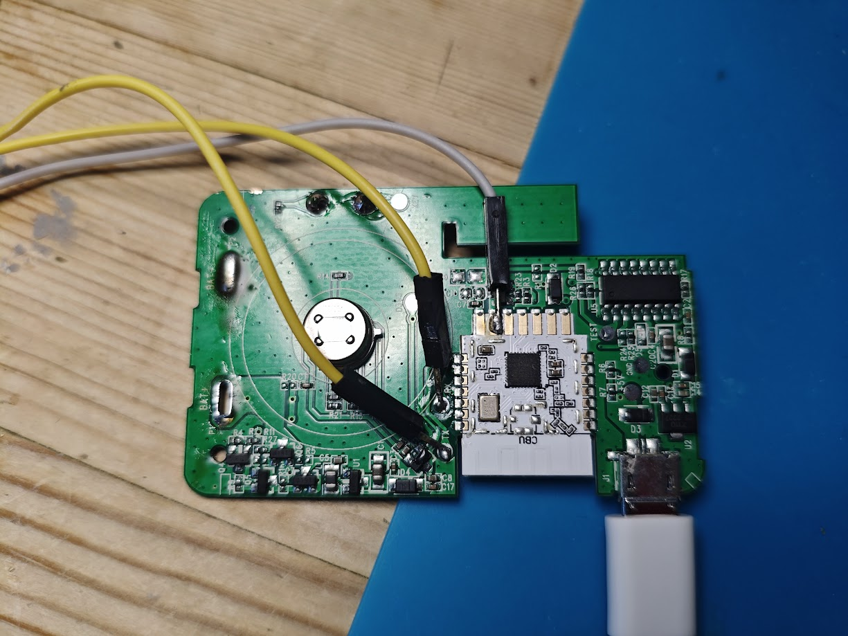

    There is no continuity between RX/TX and any of the MCU legs but instead there is continuity to the small resistors beside the MCU. So, I severed the RX trace just where it leaves the CBU, after which the dump could be obtained, attached. Being Tuya MCU, there's no pin extraction

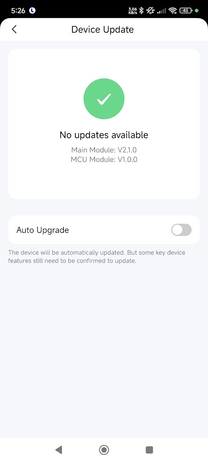

    Screenshot from Tuya Config Quick Viewer showing GPIO configuration in JSON format.
    firmware version 2.1.0 so no good for cloudcutter.
    Flashed with OBK and then soldered a little pb bridge over the cut RX.
    And that's as far as I can go tonight.

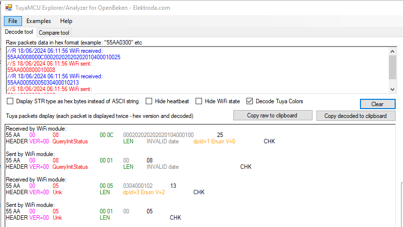

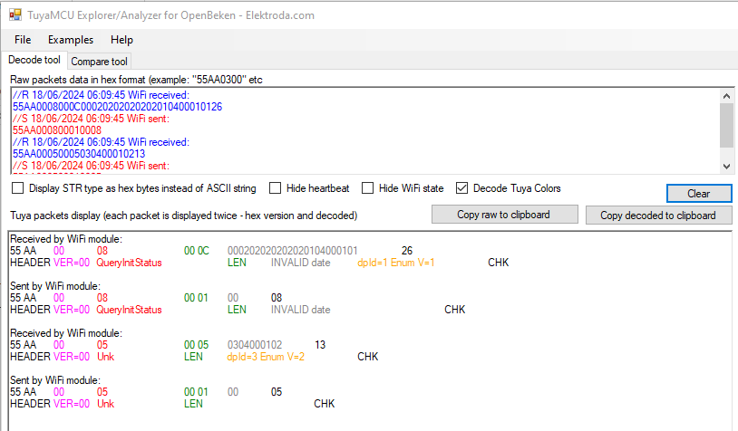

    curious, the only dpID appears to be
  • #6 21122804
    Posts: 14754
    Rate: 12875
    so what kind of values does this enum have?
  • dpID 3 maps to battery_state
    #7 21122815
    Posts: 5206
    Help: 446
    Rate: 914
    actually dpID 3 too
  • #8 21122839
    Posts: 14754
    Rate: 12875
    Battery enum is nothing new.
    So, pir state is an enum but has only two values possible?

    seems so.
    result of tuyaMcu_sendQueryState

  • Missing CEN path explains absent button packets
    #16 21123104
    Posts: 5206
    Help: 446
    Rate: 914
    yes. I expected that too but that was not the experience. button pushes didn't seem to produce any MCU packets.

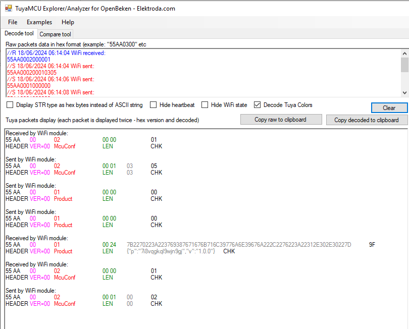

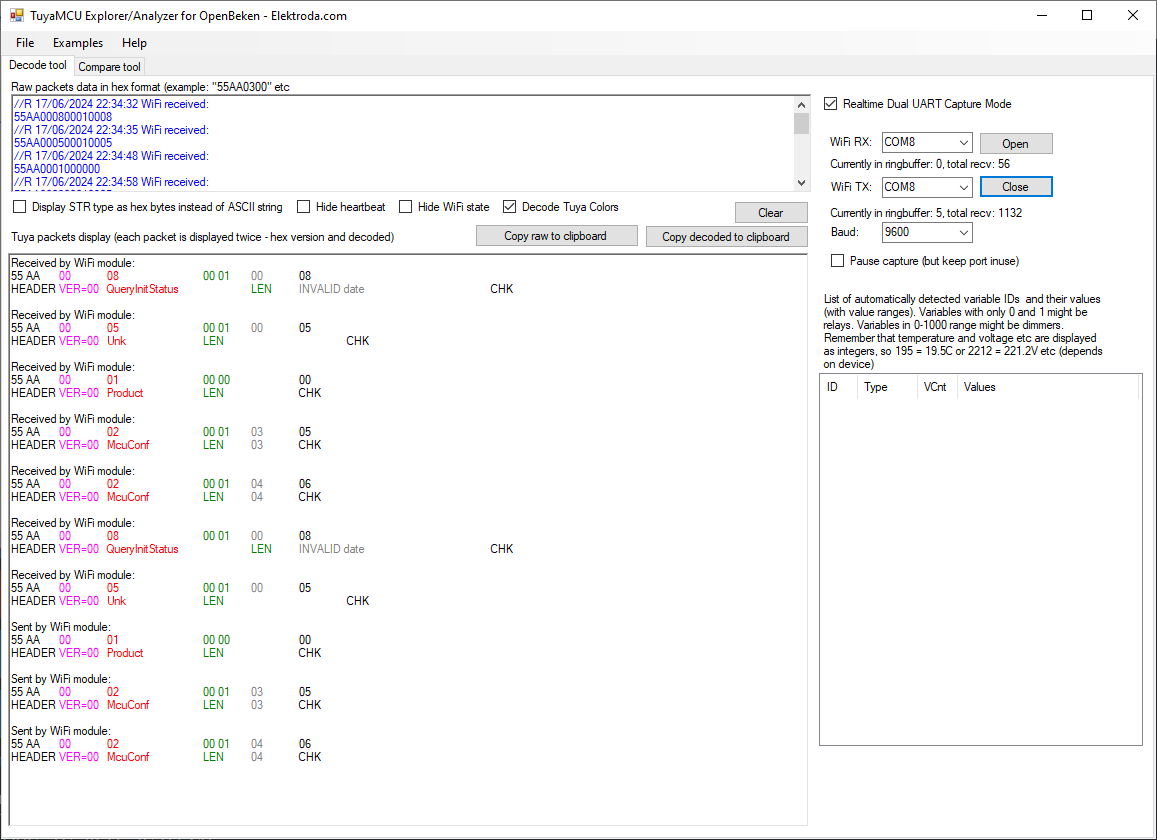

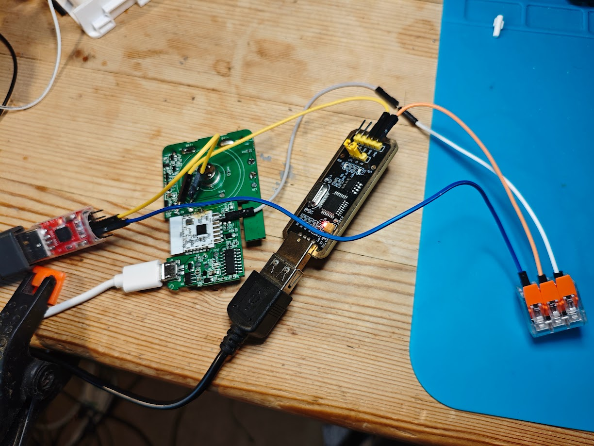

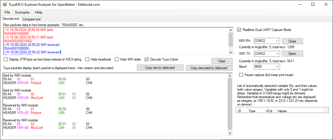

    I've gone back to factory and hooked up a second USB-TTL so I can properly see what factory is doing. Also, believe it or not, I've not really done much with TuyaMCU Analyser, so good practice,
    Electronic setup on a wooden desk with connected USB-TTL devices on a test board.
    COM10 = USBTTL_RX - RX test pad on PIR device
    COM22 = USBTTL_RX - TX test pad on PIR device

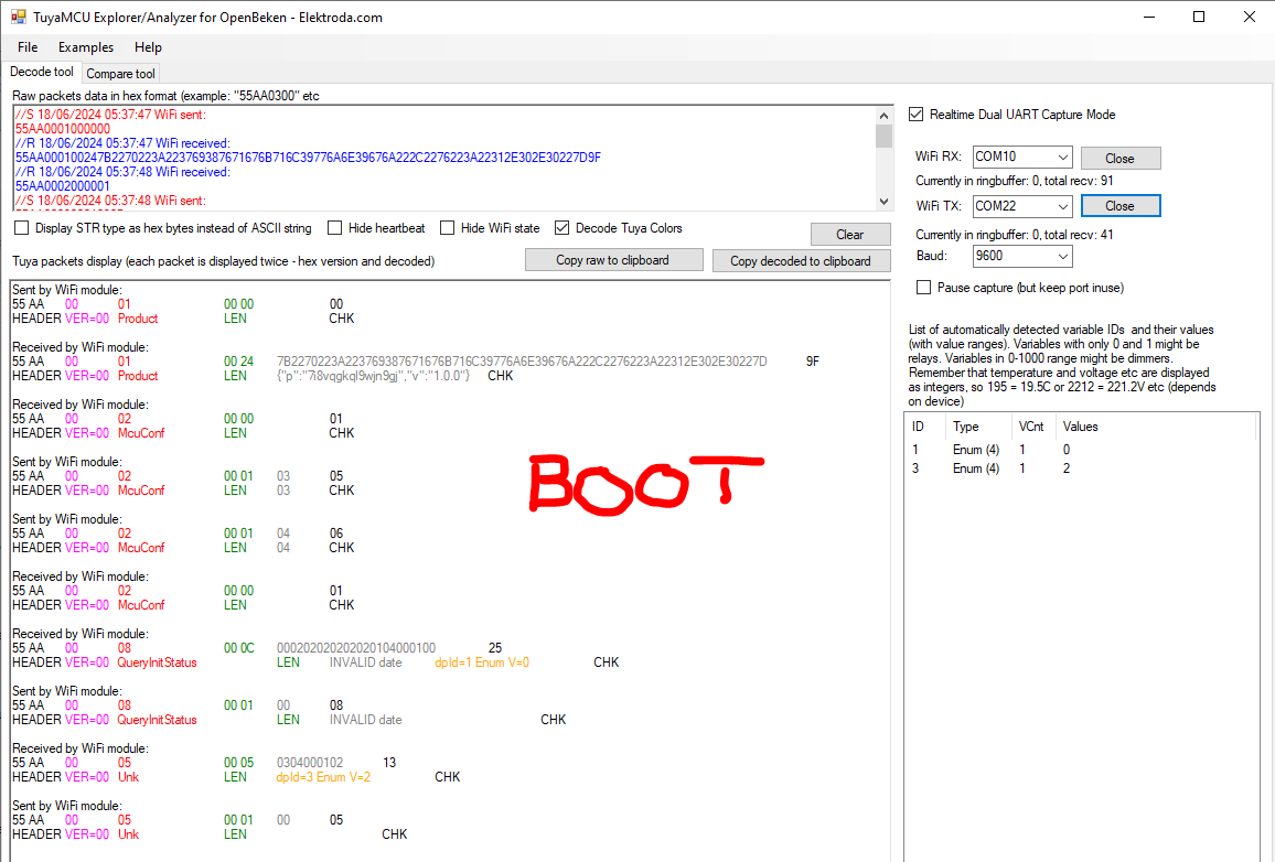

    boot log:
    Screenshot of TuyaMCU Explorer/Analyzer tool with Wi-Fi data packets.

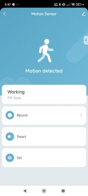

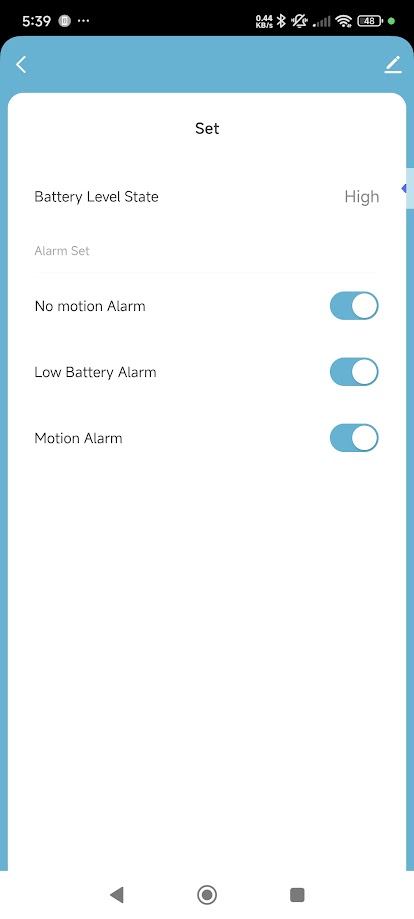

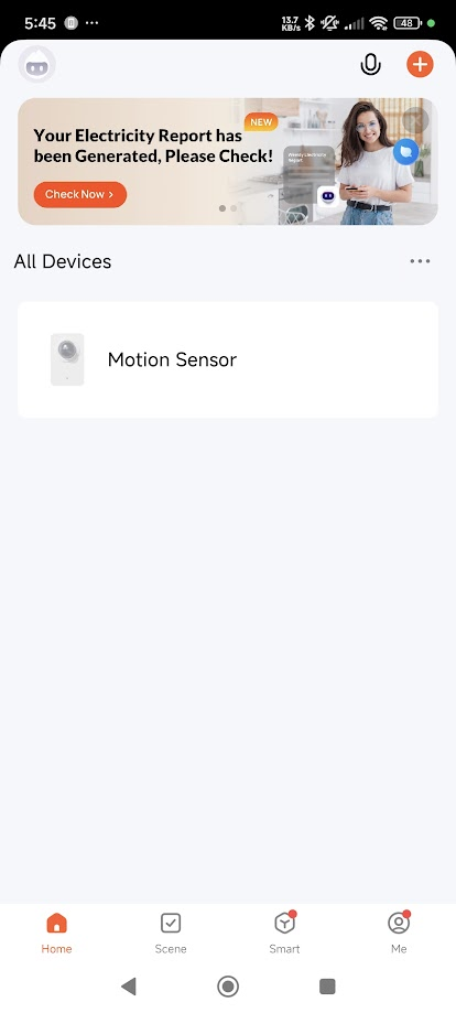

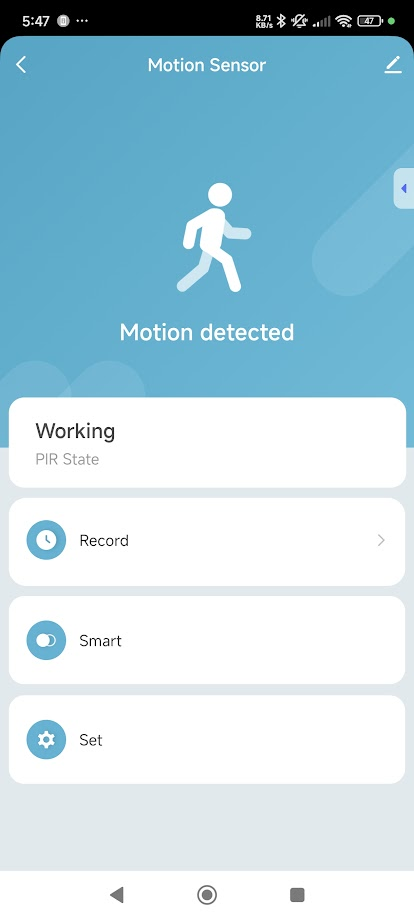

    and a bit of Tuya app info too while I'm here
    Screenshot of a mobile app showing a detected motion sensor. App settings screen with motion detection and low battery alarms enabled. Device update screen showing no updates available. Motion sensor app screen indicating Motion detected.

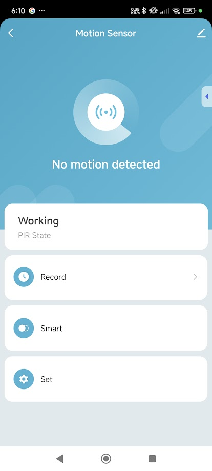

    Added after 24 [minutes]:
    change from motion detected to no motion detected status:
    Screenshot of TuyaMCU Explorer showing decoded packets incoming and outgoing from the WiFi module. Tuya app screen on a smartphone displaying No motion detected.
    and reverse:
    Screenshot of TuyaMCU Explorer tool showing packet data.
    Added after 3 [minutes]:
    unpairing/wipe data and reboot from Tuya app. LED fast flash;
    Screenshot of TuyaMCU Explorer/Analyzer program with communication between Wi-Fi module and MCU.
    Added after 7 [minutes]:
    motion detected = dpId=1 Enum V=0
    no motion = dpId=1 Enum V=1

    Added after 1 [hours] 18 [minutes]:
    CEN has a trace but the path is missing a component so ultimately doesn't have continuity to the MCU leg highlighted
    Two images of circuit boards from an electronic device, showing test points.
    #17 21125392
    Posts: 14754
    Rate: 12875
    Thank you for sharing. This is very strange that the RESET button does not seem to work.
    The CEN trace without component, on the other hand, seems normal. They don't need CEN. They just cut the power to the whole module.

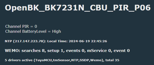

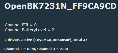

    OK so with the autoexec above (tmsensor now added) we get this on USB power
    Screenshot of the OpenBK interface showing PIR sensor and battery level information.
    when no motion PIR = 1 and this is changed when the MCU sends this:
    motion detected PIR = 0 - MCU sends this
    Added after 4 [minutes]:
    after 30s of the sensor being covered after motion, it will go back to no motion detected. The MCU flashes the red LED once when motion is detected and again when asserting no motion state

    I can indeed see that this channel type is missing http display. Can you check this commit, after it builds?
    https://github.com/openshwprojects/OpenBK7231...mmit/a70bd96ee1275ec3b65572c56166b8d532404f8a

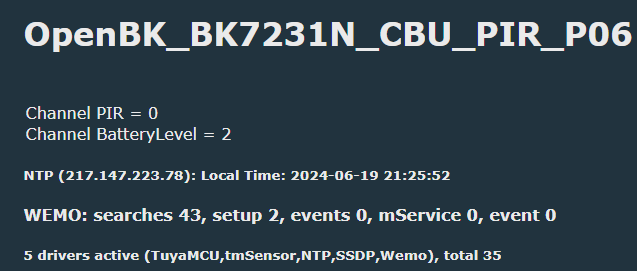

    Screen displaying information about the device OpenBK_BK7231N_CBU_PIR_P06, including PIR channel status and battery level.
    :D
    does this mean there could be ReadOnlyMotion for 0 + 1 byte translation to plain-text status? What was the case for doing ReadOnlyLowMidHigh for battery and not other RO enum values?

Is this firmware compatible with Cloudcutter?
No. The captured factory firmware was version 2.1.0, which was reported as not compatible with Cloudcutter for this device. Use the manual UART method described instead if you need local firmware. [Elektroda, divadiow, post #21121587]

Is the CEN pin used to manage the Wi‑Fi module on this board?
A CEN trace exists but lacks the needed component, so it isn’t used. Instead, the design cuts power to the whole module when required. "They don't need CEN. They just cut the power to the whole module." [Elektroda, p.kaczmarek2, post #21125392]
