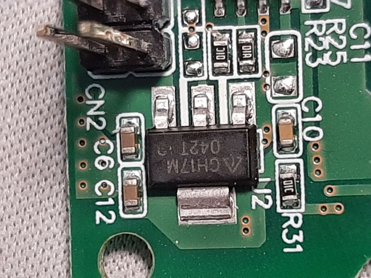

  • The Deta Grid Connect Smart Single Gang Touch Light Switch 6911HA uses a WB3S module with a BK7231T chip.
  • The main chip was manually flashed with the BK7231 GUI Flash Tool, and the module pins were mapped for relay, Wi‑Fi LED, and button control.
  • It was purchased at Bunnings Warehouse for $56.63AUD.
  • Device Name: Deta Grid Connect Smart Single Gang Touch Light Switch - 6911HA
    Device Type: Light switch
    Device Chip: WB3S - BK7231T
    Device Purchased: Bunnings Warehouse - $56.63AUD

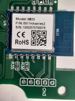

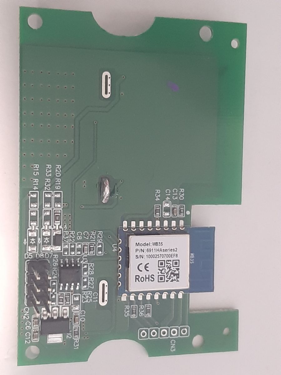

    Flashing of Main Chip
    Manually flashed the chip with BK7231 GUI Flash Tool.
    WB3S Module Datasheet
    Configuration of Module
    Pins
    P6 - Relay - Channel 1
    P9 - WifiLED_n - If you want the White LED on when Wifi is connected
    or WifiLED for White LED on when Wifi is disconnected
    P14 - Button - Channel 1

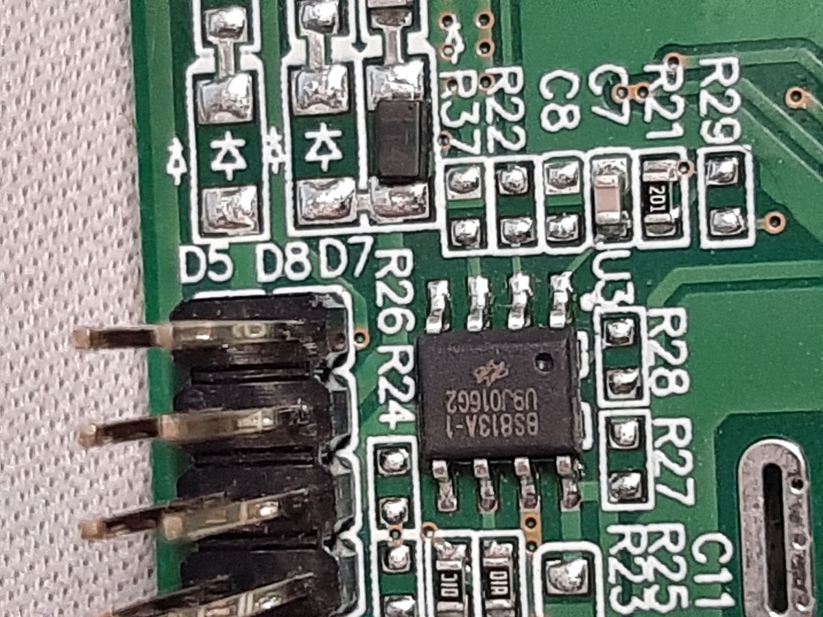

    Very nice and simple device. Does it have also a LED linked to relay? It should be possible to disconnect that LED and use a free GPIO of WB3S to control that, if required.
    I can also see a BS813A IC, which a touch button controller in SOIC-8 case, made by Holtek.

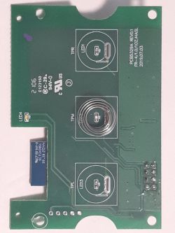

    Yeah, the button has a blue led light on the board. You can see it (LED 2) just in the middle of the TPM button. It turns on when the relay is powered so maybe there could be a way to disconnect it from the relay.
    I'm sure there are some that don't like the LED but it is not overly bright and looks nice so not really a big issue for me. Makes a nice little night light. The WIFI light (LED 4) is more of an issue for me. I just turn it off as it is very bright and looks horrible on the black cover plates.
    It's a very nice light switch but it does require a neutral wire which can make it difficult to install. The original firmware was horrible. Apparently, it has a hard time with dual-band modems. It would always disconnect randomly or have to be resynced with the app at least once a week. I haven't had to do any of that with the OpenBK firmware. Once it's set up it works well with Home Assistance.

    Nice, btw, consider adding "PowerSave 1" to startup and report to me if it works well. This will reduce heating, electricity consumption and even might prolong life of cheap power supply inside the switch.
