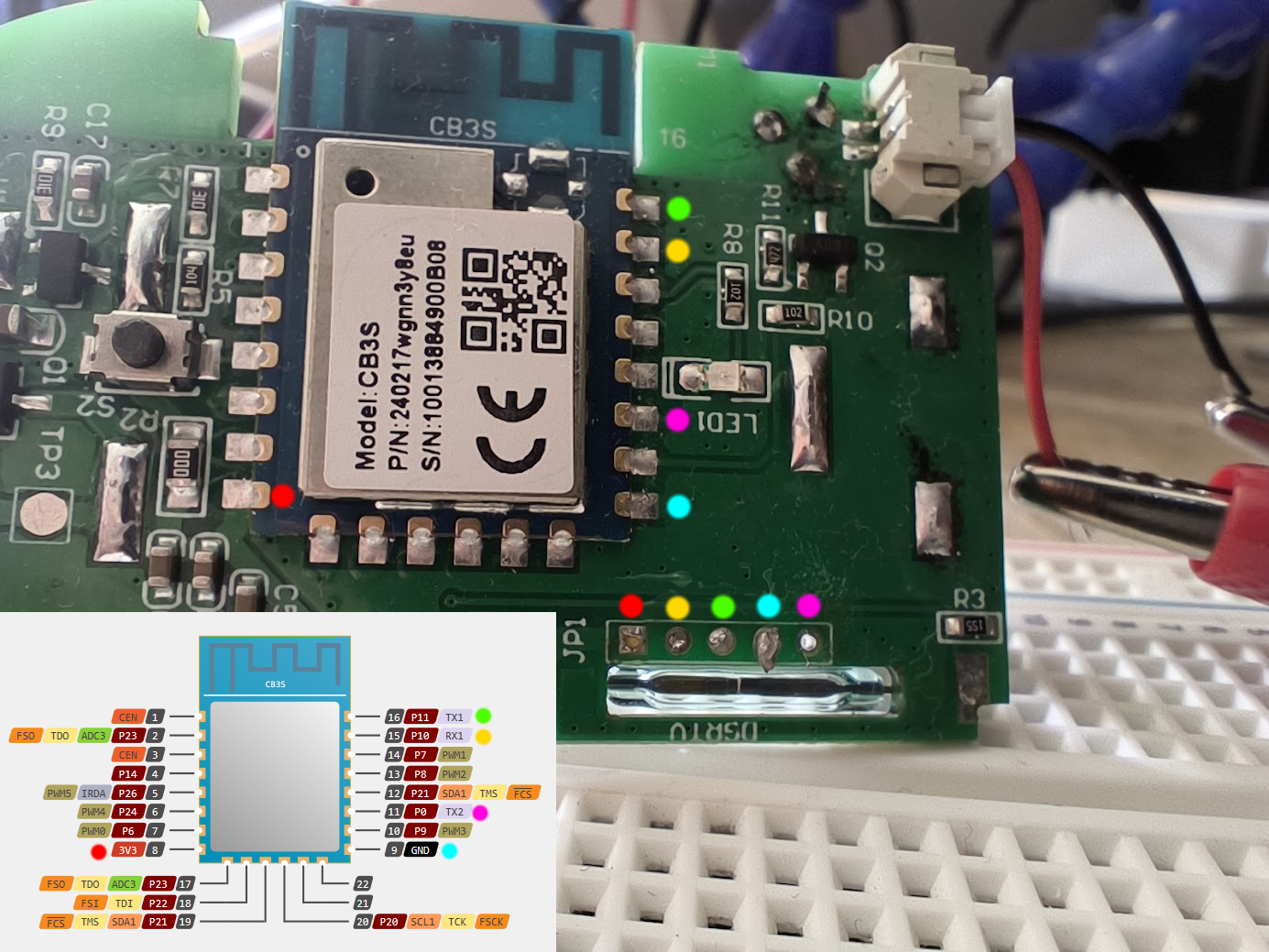

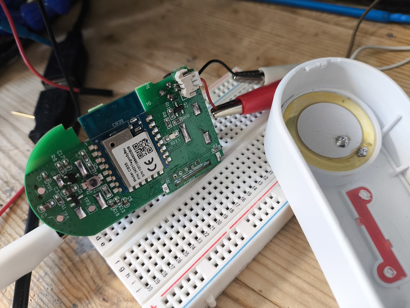

    Upon opening we see a BK7231N CB3S, the button, an LED, the magnet bar sensor thing and the connector to the piezo buzzer fit to the front half of the chassis. In this pic I've already unsoldered the buzzer because it gets annoying in testing. An LED (with 220Ohm resistor) replaces it for now.
    Close-up of PCB board in Tuya sensor with detached buzzer. Close-up of a contact sensor on a breadboard with connected wires and an LED.
    Firstly, I need to dump the factory firmware and work out the pin assignments. Using a multimeter these are identified:
    Close-up of a circuit board with a CB3S module and marked pins.
    and using TX2 the factory fw boot log is

    After some more multimeter and trial-and-error GPIO finder action:
    P6 - magnet sensor
    P7 - Wifi LED
    P9 - Buzzer
    P21 - BAT_Relay
    P23 - BAT_ADC
    P26 - Button

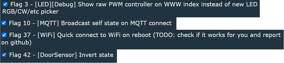

    -DoorSnsrWSleep_nPup because the led (will be buzzer) stays lit regardless with DoorSnsrWSleep
    -PWM set on the buzzer pin because that will be used in the autoexec to sound alarm
    -Btn_ScriptOnly so there is no on/off button in the GUI
    -Flags 3 (it's the PWM we're interested in, not the light sliders), 10, 37, 42 (without sensor would show door open (state 1) if magnet was next to sensor)

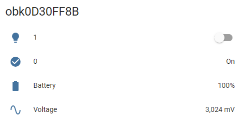

    forgot to mention that right now the btn does wake the device but changing the magnet sensor state does not. and this is what HA looks like
    User interface displaying device icons and battery status.
    sensor 0:on is with the magnet close (door/window closed)
