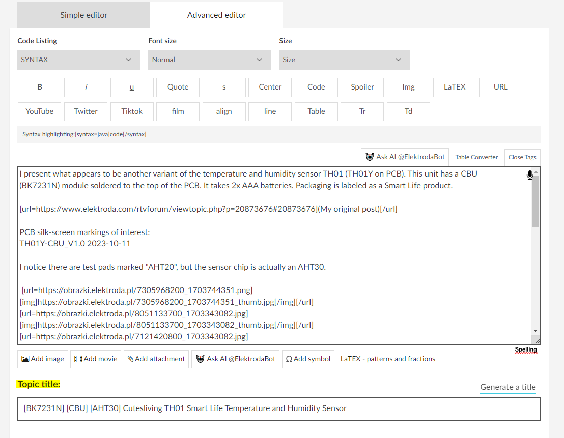

    How to change the title of the thread to "Tiny floor sitting Tuya Water Sensor WiFi DY-SQ400B with CR123A 3V Battery: Experiences, Usage?"
    There is a pen symbol next to the title, but it seems to be not functional - I can change the title and click "correct", but it just goes back to the original title.

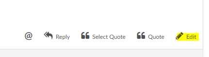

  • #32 21071769
    Posts: 5243
    Help: 451
    Rate: 921
    use edit at the bottom of post

    I'm not talking of a post, but of the thread's title itself.

    that edit option gives me topic title editing ability

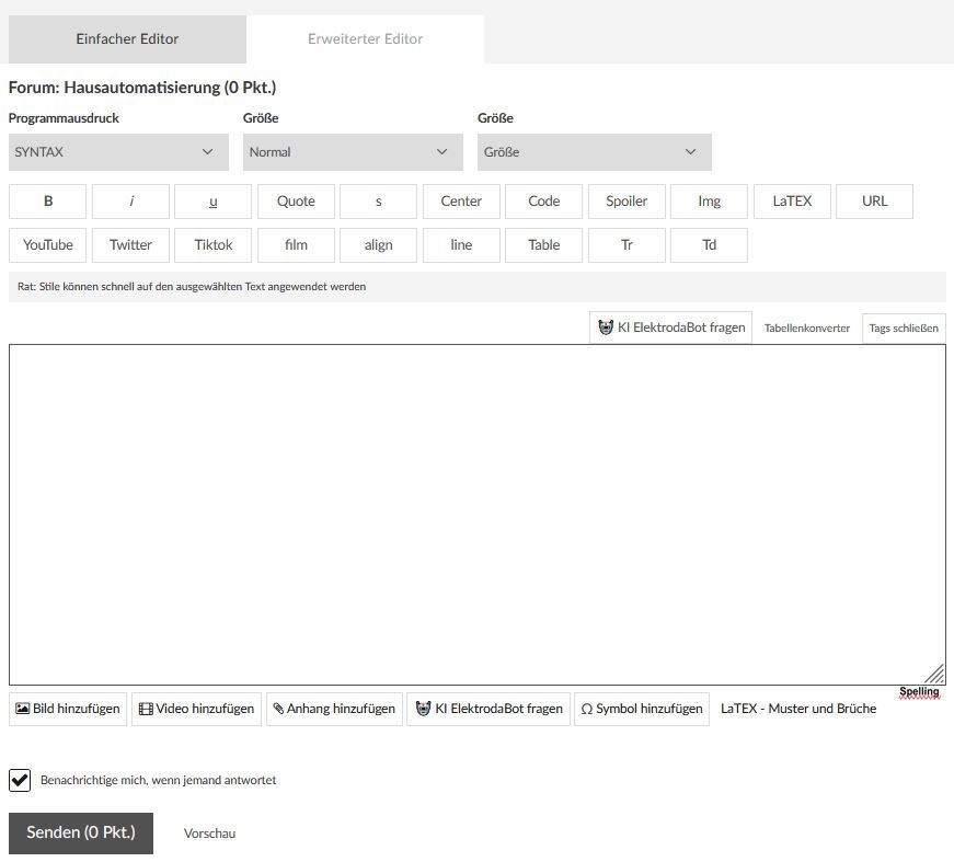

  • #35 21071834
    io2345
    Posts: 273
    Rate: 7
    Not for me. Some seem to have more rights than others
    Screenshot of a text editor in a home automation forum.
