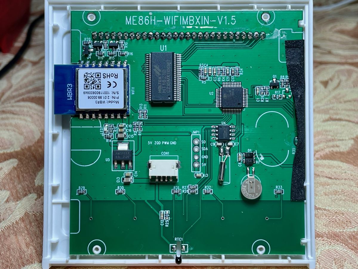

    I came across a ME86H thermostat, confusingly similar to the BHT-002 but with a chip as in the subject line.
    Electronic circuit board of the ME86H-WIFIMBXIN-V1.5 thermostat with visible components. .
    I've read a couple of posts related to this invention and wanted to ask if there are plans to look into flashing it?
    I was also thinking of replacing it with a CB3S that I have in stock, I'm just concerned about the single pin handling.
    On the WBR3, pin A17 (GPIOA_17, hardware PWM, IC Pin 38) is connected to transistor Y1, and on the CB3S this pin is CSN and is described like this:
    "Production test control pin. If it is used as a common I/O pin, it must be connected to the VCC externally. Do not connect it to the ground before the module is powered on."9c454bb32 .
    So I'm not sure about the compatibility of these two pins.
    The rest of it looks OK.
    I plan to eavesdrop on the module's communication with the MCU at my leisure, I suspect it will be similar to this topic:
    Link .

    I replaced the WBR3 module with a CB3S that I had in stock.
    I had previously overheard the communication and testify to the following...:

    Pin A_2 WBR3 ( P26 CB3S) must be pulled low, LED - is connected to it.

    Pin A_2 of WBR3 (P26 CB3S) must be pulled low, the LED -.
    is connected to it.
    After careful examination of another ME86H I found that pin P26 (CB3S, WB3S) should be defined as WifiLED_n

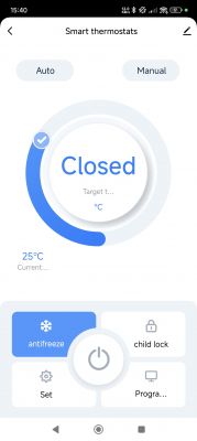

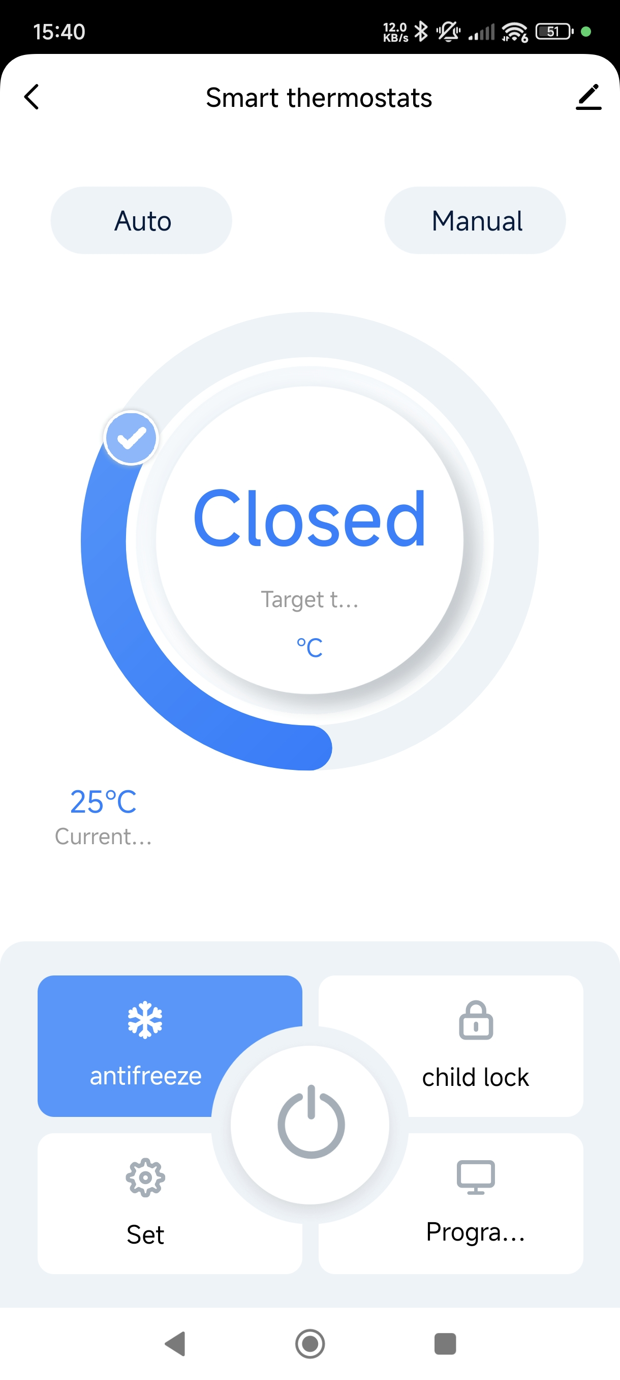

    Tuya app pics:
    Tuya Smart thermostat app on smartphone. Smart thermostat app screen with 'Auto' and 'Manual' options, target and current temperature, and additional function buttons.
    Added after 15 [minutes]:

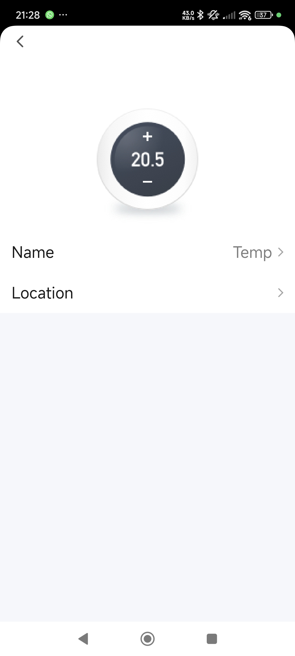

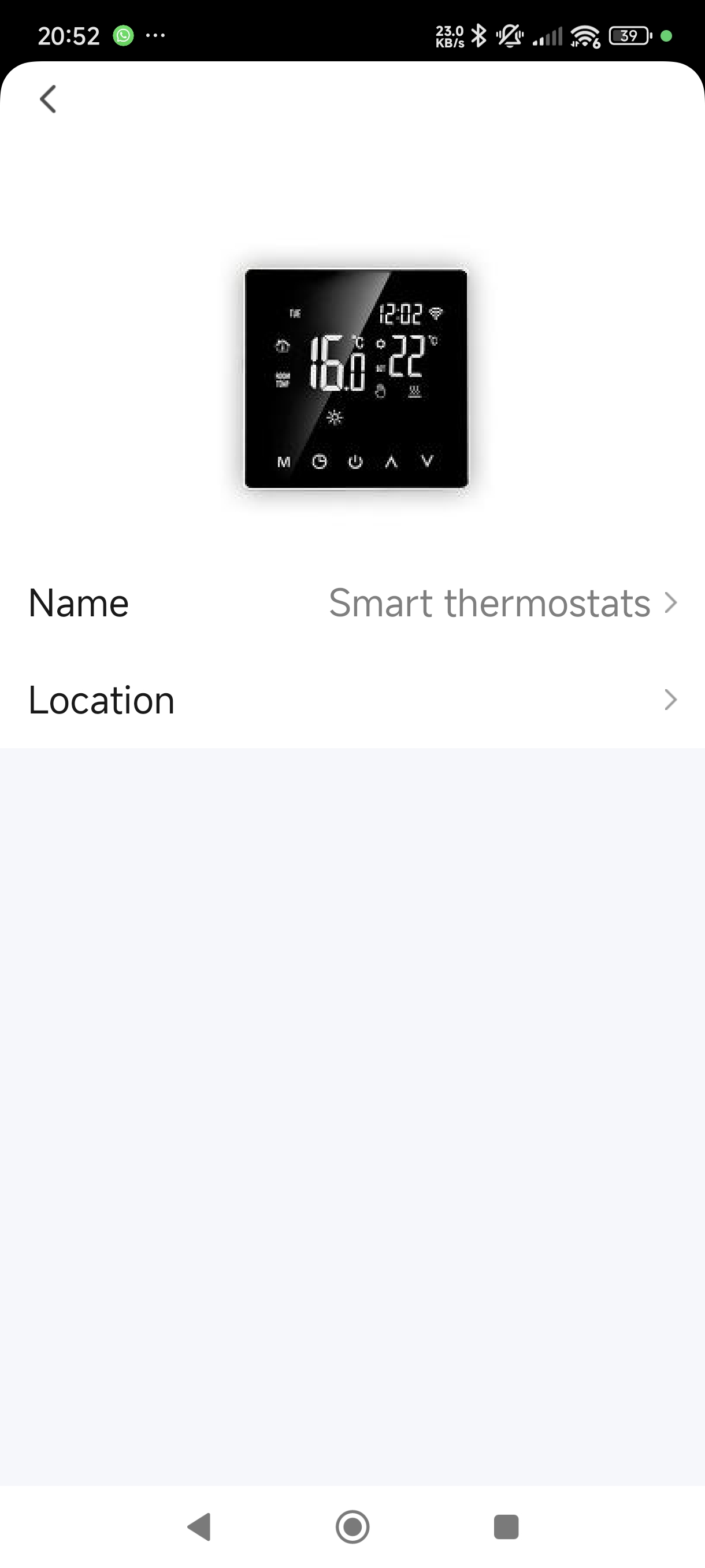

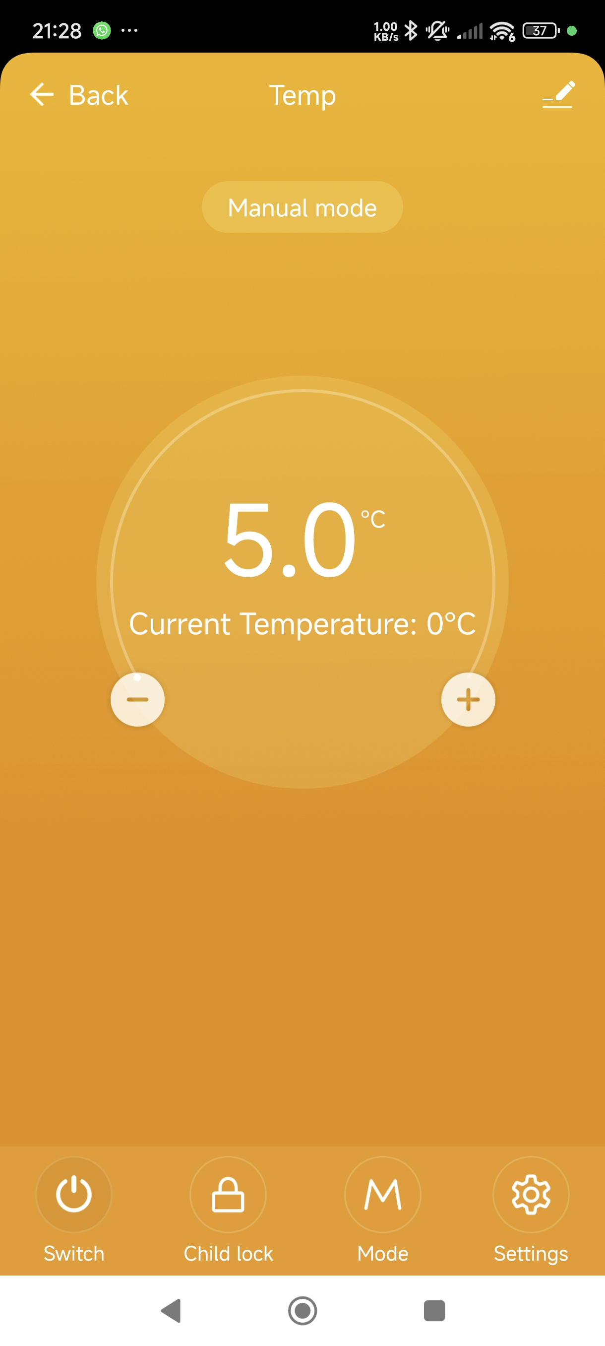

    Tuya_Avatto_WT200_Thermostat_(Temp-schemaID-00000035fb_gw173aldekvpzalg)_TuyaMCU_WBR3_2.5.2.bin
    Paired storage area content:
    Paired UART boot log (TuyaMCU simulator used):
    dpIDs:
    Tuya app pics:
    Tuya app interface showing thermostat settings with the current temperature set to 20.5 degrees. Tuya app interface with thermostat set to 5°C in manual mode.
