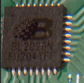

    please fix title of post to BL2028N :) :)
    Microchip labeled BL2028N on a circuit board.

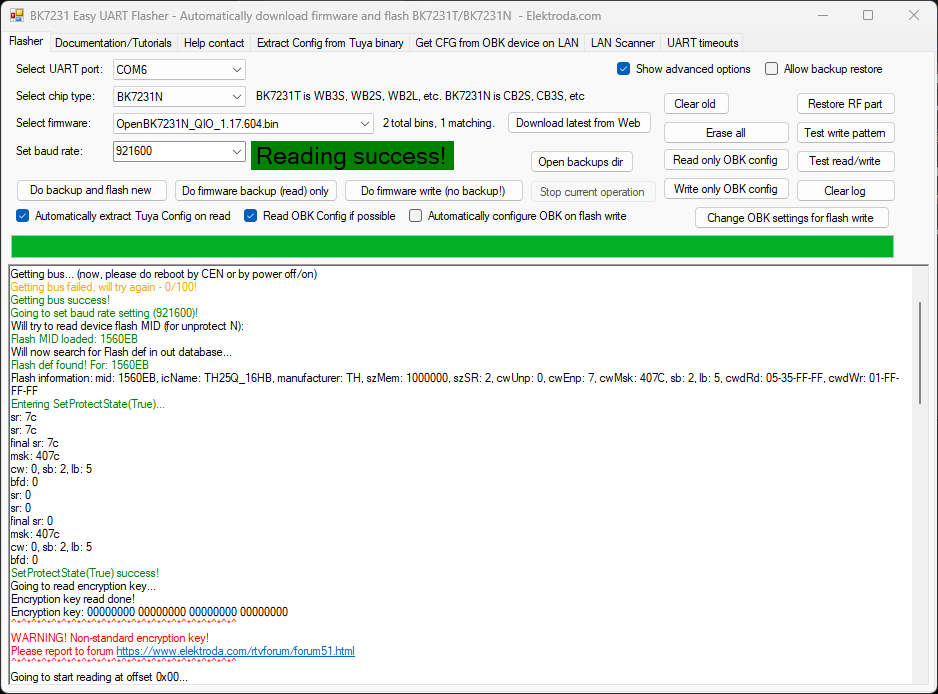

    It is important to note that in the past this flasher was overwriting bootloader for BK7231N and now I changed behaviour so it always skips bootloader portion, even when flashing QIO. You can change this behaviour via a checkbox.
    It seems that overwriting a bootloader is a mistake, I guess the one we have is also encrypted, that's why it's better leave a factory one.

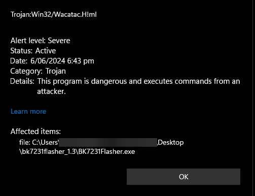

  • Defender false positive closed flasher and lost log
    #38 21109194
    terryb8s
    Level 4  
    Posts: 41
    Rate: 8
    Seems to have worked, this was without the check box ticked, boot log attached, I was about to copy the flasher log but Defender closed it with the following message.
    Screenshot of a Windows Defender alert about the detection of Trojan Win32/Wacatac.H!ml. Screenshot of a system log excerpt.
    I assume it's a false positive but the loss of the log reveals a feature that would be helpful, which is a log file.

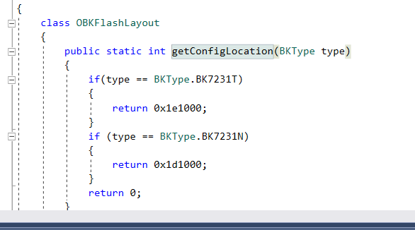

    Maybe its just me but I tried to restore the obk config for my device and I think it wrote it to 0x0, is this possible with the new version of easy flasher?
  • Questioning Easy Flasher’s generic RF partition source
    #43 21111462
    Posts: 5236
    Help: 450
    Rate: 920
    I don't know what RF calibration entails when they make these things but I was under the assumption that the content of the RF partition might be tailored to the device it was intended.
    I'd be curious to know how a generic RF partition (from the restore function in Easy Flasher) compares to your factory original.
    Actually, I have a question. Where is the data the restore function in Easy Flasher uses from? @p.kaczmarek2
  • #44 21111468
    Posts: 14796
    Rate: 12954
    Nice spotting, thank you!

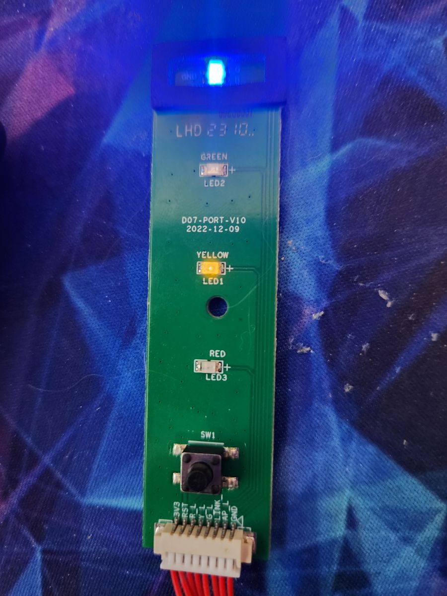

    I would say so, that would be handy if you could, the I have just found P6 is the button on the small control board, again weird as pushing it seems to control Channel 5 even though the channel for the button is 2 at the moment. Give me a sec will post some photos of that.

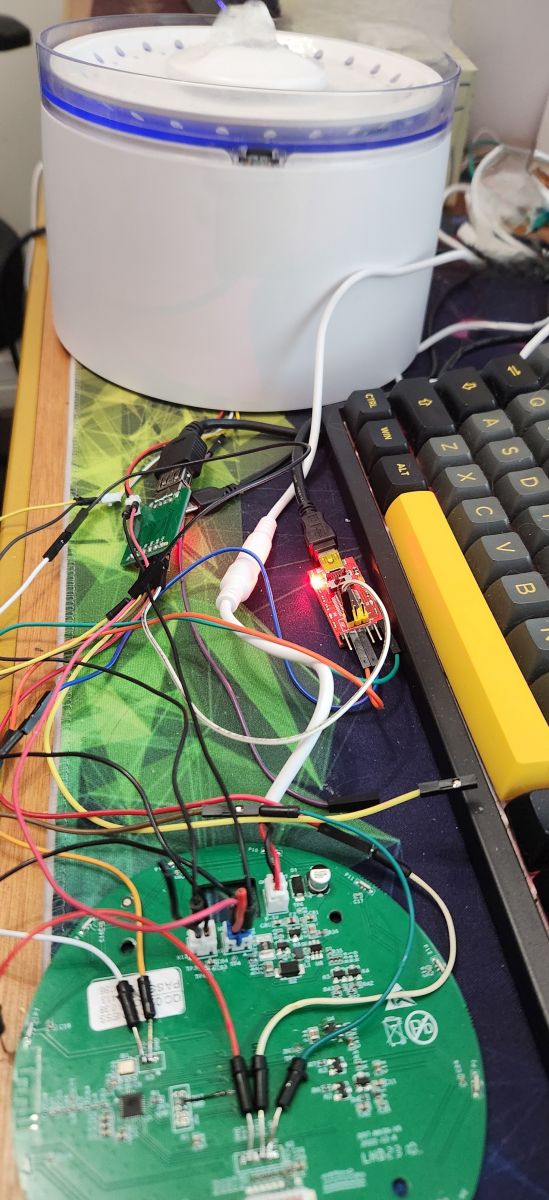

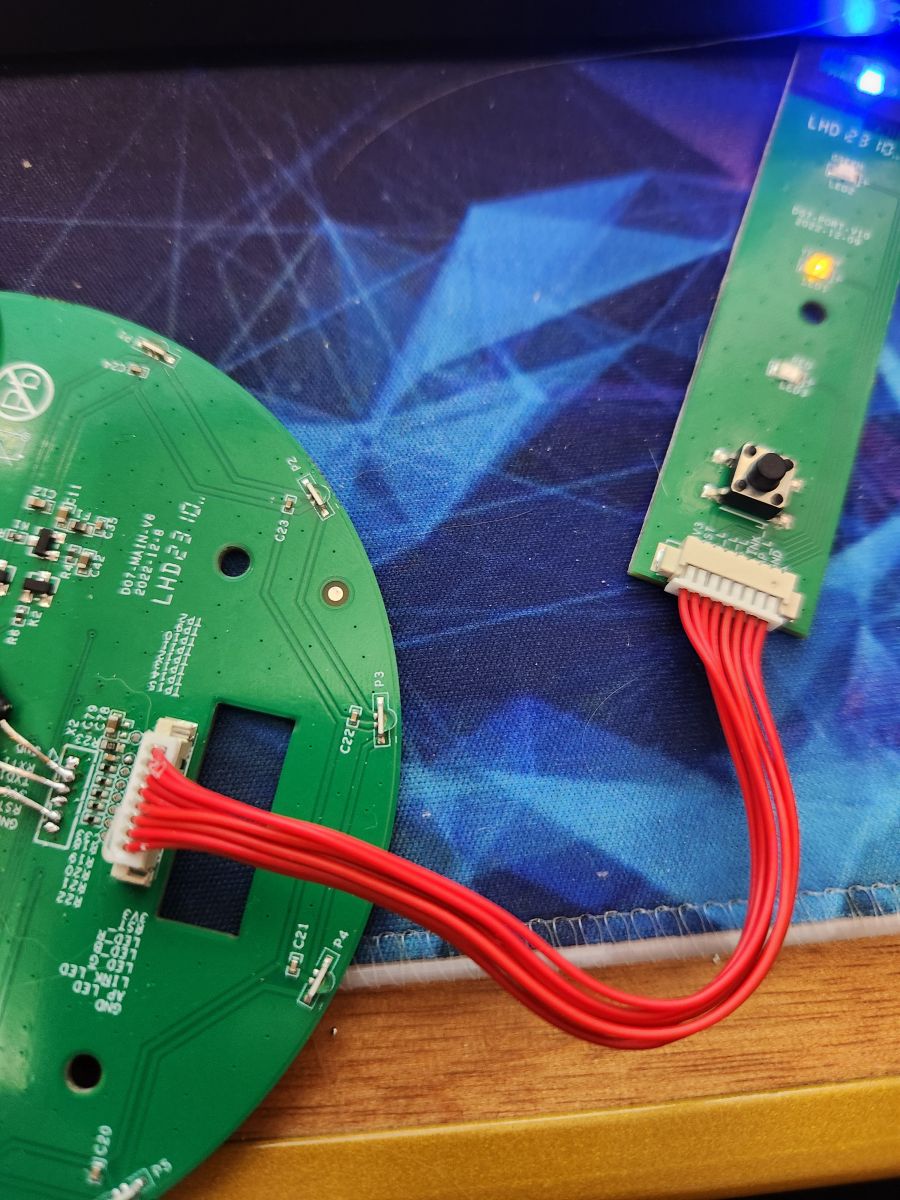

    Calmed down the config, the button still triggers channel 5
    You will have to excuse my setup, can only wish I had some sort of electronics workshop hahaha
    Electronic setup with visible circuit board on a desk.Close-up of an electronic module with three LEDs and a button.Close-up of two green printed circuit boards connected by red wires.
    >>21112253 All good divadiow, once you pointed out the title I was the same, I have tried to change it 4-5 times now.
  • #53 21112302
    Posts: 14796
    Rate: 12954
    When you strip down to:
      "pins": {
        "6": "Btn;2",
        "28": "Rel;5"
    does button also trigger channel 5? I don't think so.
    So most likely LED driver is guilty.
    Still, the obvious workaround is to use Btn_ScriptOnly. and manually script the button interaction

    terryb8s
    Level 4  
    Posts: 41
    Rate: 8
    OK sounds good I will look at using that then haven't used Btn_ScriptOnly but have used autoexec on other devices so should be able to sort something out.
