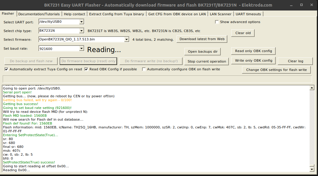

Use the latest BK7231GUIFlashTool/OpenBK tools: they can auto-configure the GPIOs, and even after OpenBeken is flashed you can still pull the Tuya GPIO config from flash because it is not overwritten; the web app has a "Download Tuya GPIO Config from 0x1EE000" action that generates a .bin you can drag back into the flasher [#20578223][#20578503][#20578615] If reading the firmware fails on firmware 1.3.10, that does not block flashing—flash-only works, and the maintainer asked for 2 MB dumps for analysis when possible [#20578297][#20578322][#20578356] On these cheap switches, enable PowerSave 1 in the startup command because the power supplies are weak [#20578223] For some variants, in-circuit flashing fails unless you remove the RX-to-GND solder bridge or an RX capacitor; one reply also notes that a USB-to-UART adapter is preferred over an EEPROM programmer [#20592328][#20592454]

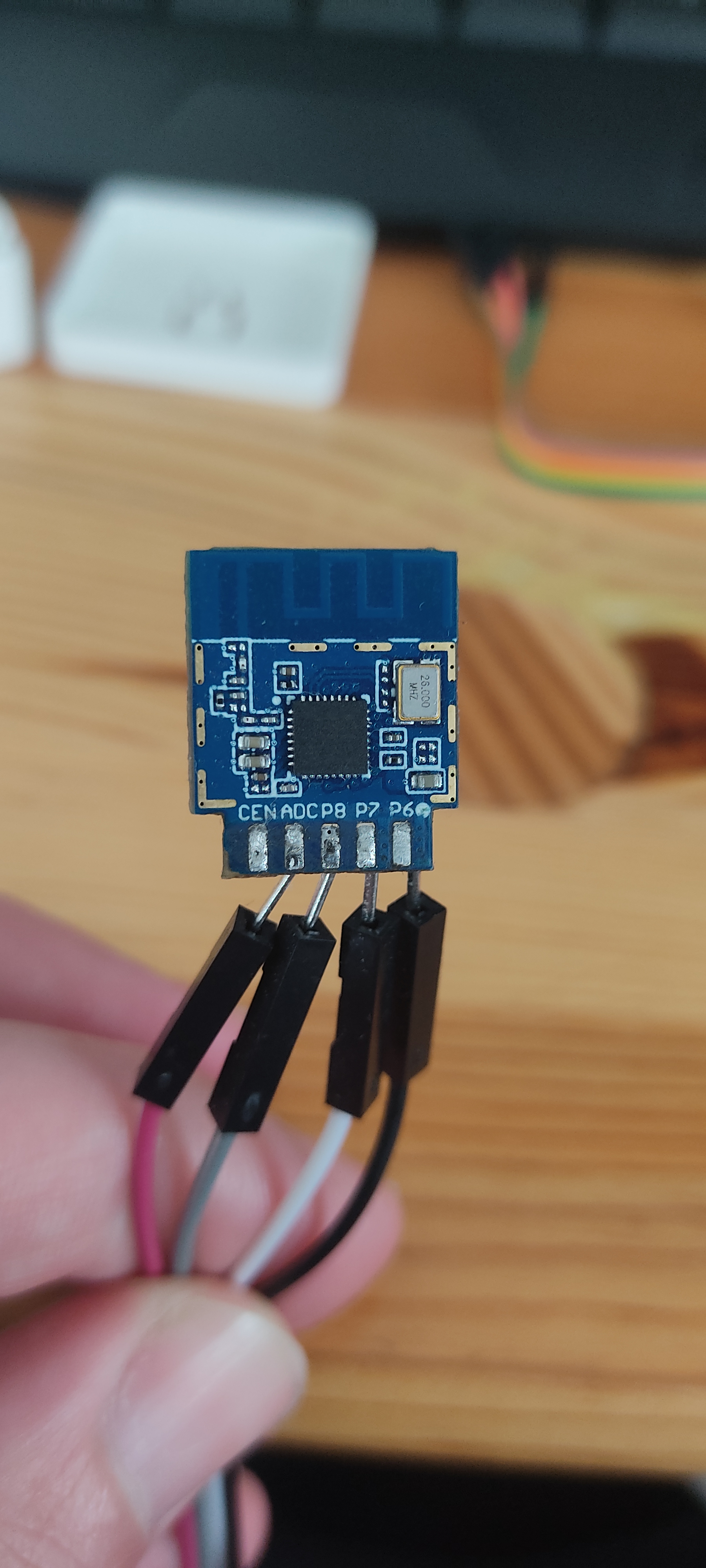

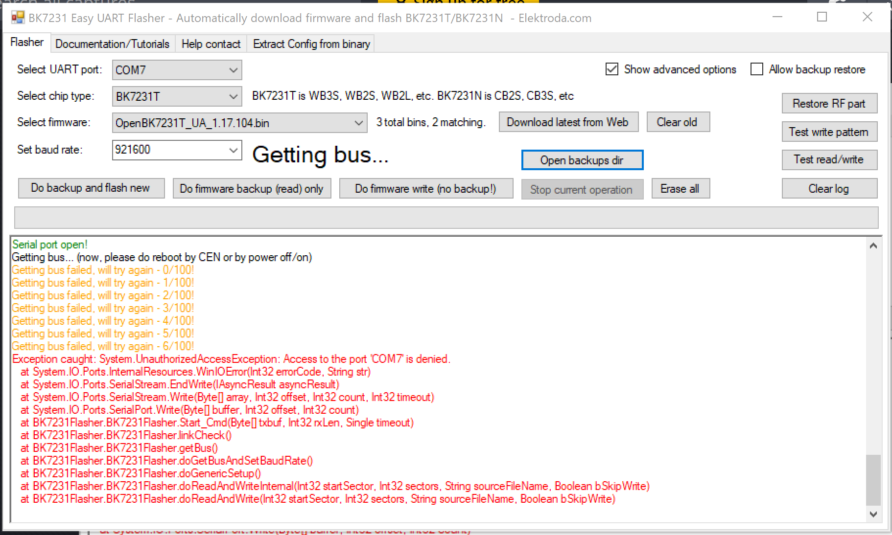

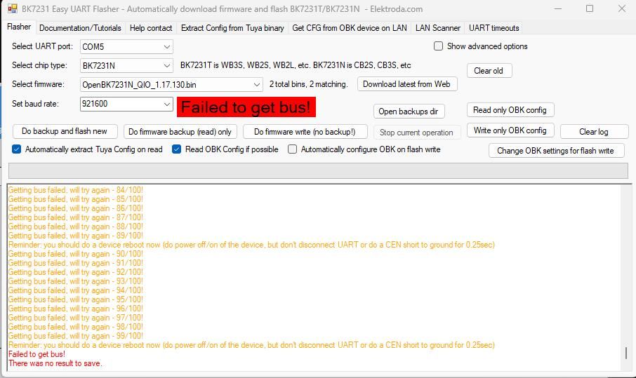

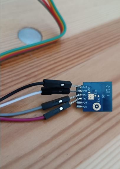

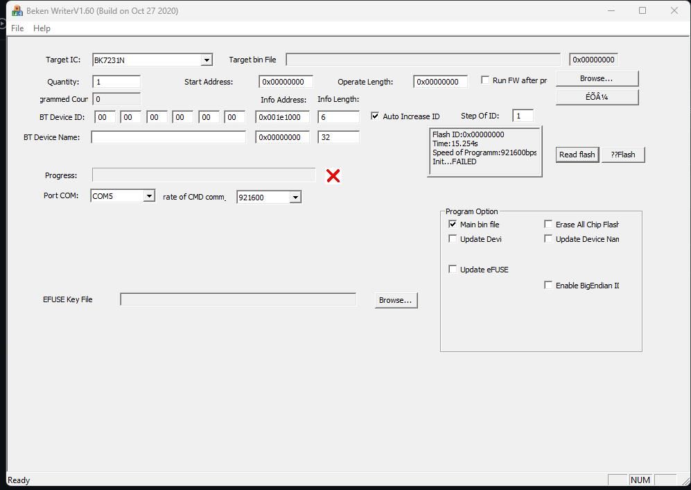

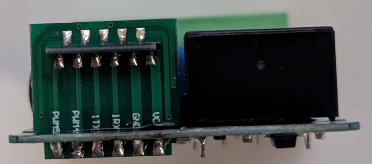

    Hi Guys, I still need your help. I desoldered two chips of my devices and solder the 4 pins.
    It will not work.
    [BK7231N/CB2S] Comparison of multiple smart switch modules, differences on PCB, patched firmware
    If I put CEN to ground nothing happens. Also if I disconnected ground or VCC completely for a few seconds, nothing will happen.
    I don't get it what I'm doing wrong...
    Now Port 5 is stable and it's my CP210x Adapter.
    Also Writer 1.60 fails

    You have white wire on ground and black on VDD? I hope you didn't swap them..
    bkWriter 1.60 won't work for BK7231N.
    How do you power the module? Maybe you haven't swapped RX to TX and TX to RX? Maybe wires are too long?
    Maybe try this method of resetting:
    1. start flashing process
    2. disconnect VDD
    3. temporary connectect VDD wire of BK7231 (NOT THE ONE of power supply! That would be short-circuit) to GND
    4. connect VDD of BK7231 to power supply VDD (3.3V)

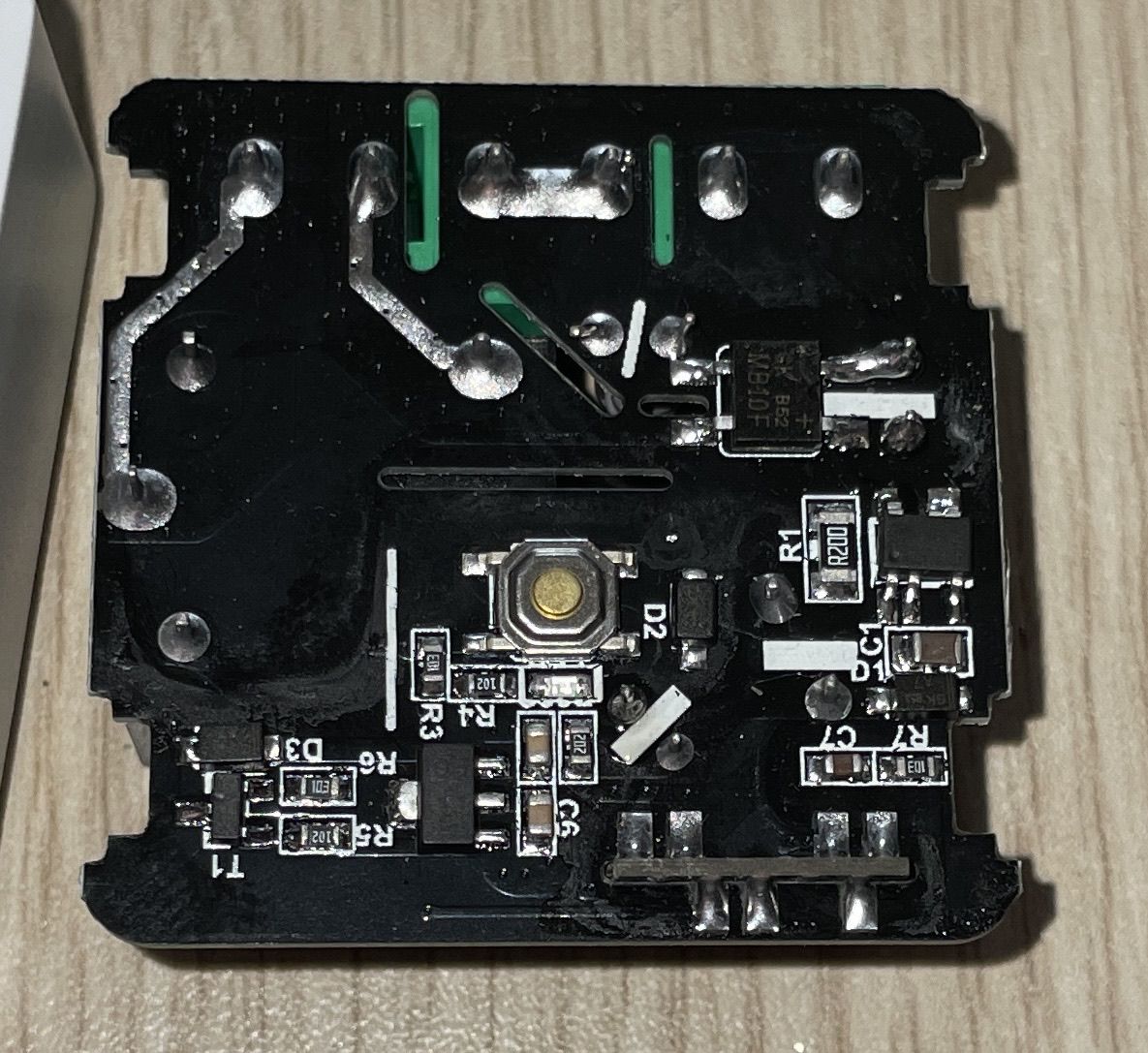

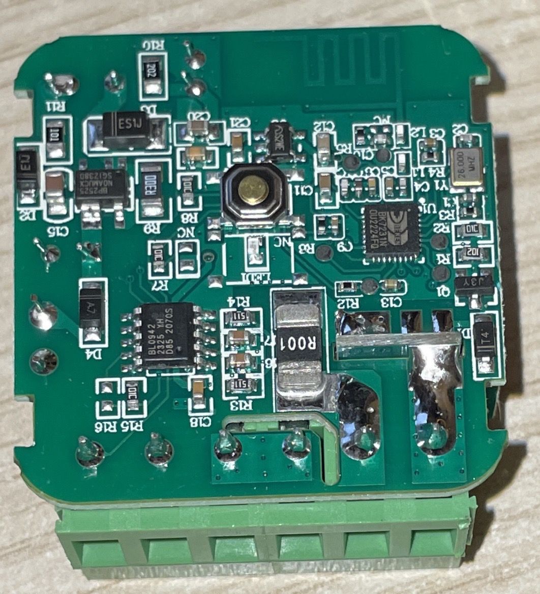

  • OU2224FQ variant with energy monitor chip identified
    #65 20833381
    RobertoD91

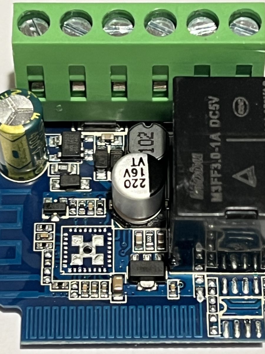

    erlipan2001 wrote:
    Second one:
    Also patched firmware
    - Pair/Toggle All Pin on P23
    - WiFi LED on P26
    - TglChannelToggle (channel 1) on P6
    - Relay (channel 1) on P7
    Device seems to be using CB2S module, which is using BK7231N.
    Hi, I found this version. Is it similar to version 2, or is it different?
    The chip is OU2224FQ instead of NU2134FQ.
    There is an energy monitor chip.
    I'm a novice. Does someone think I can use the same pin for flashing?
    Close-up of a circuit board with an OU2224FQ chip. Image of an electronic circuit board with Fanhar FH17-1A2TLE DC5V components on a PCB. Device update screen showing the firmware is up to date. Phone screen showing the addition of a device WBP-1G.

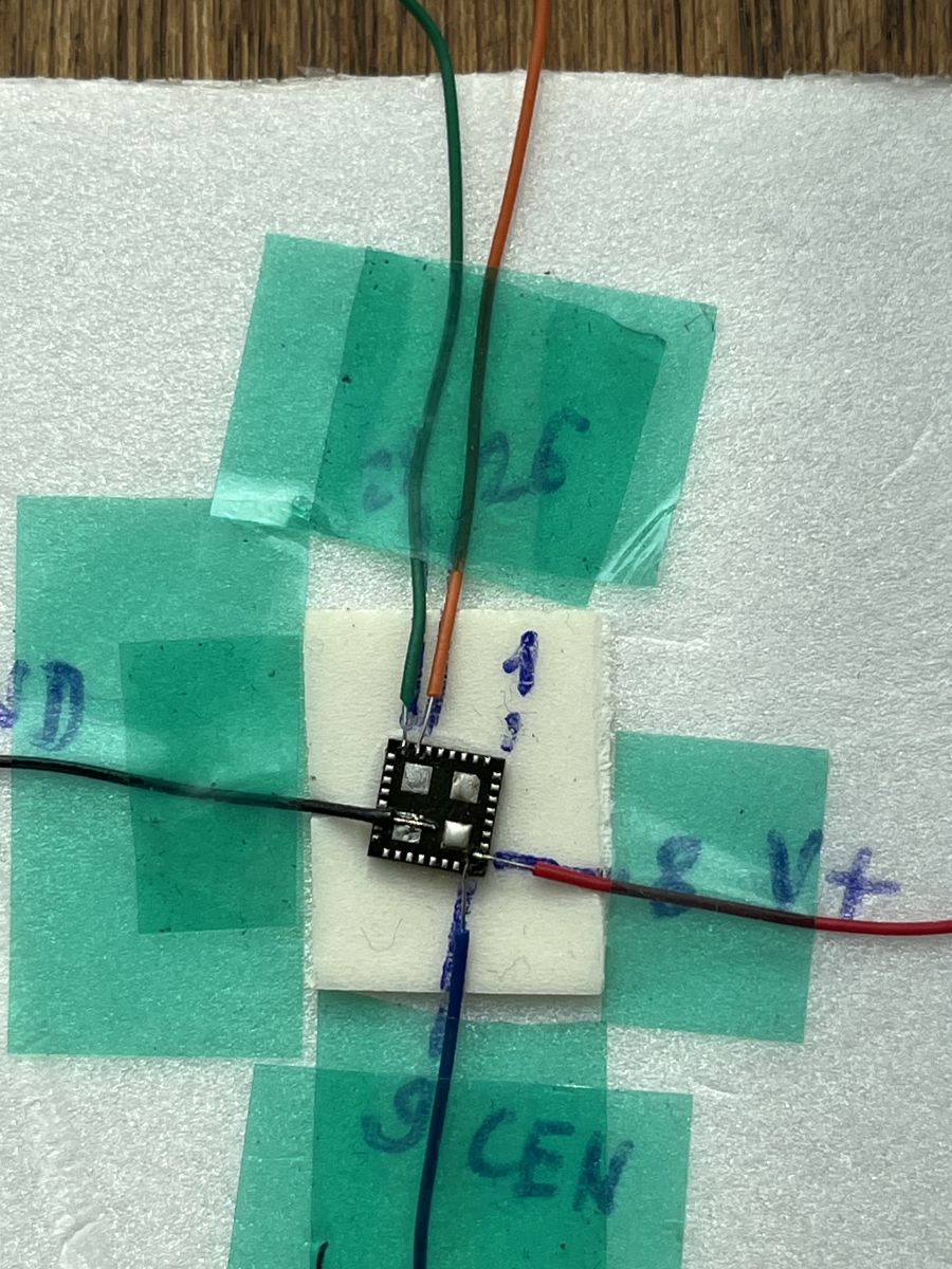

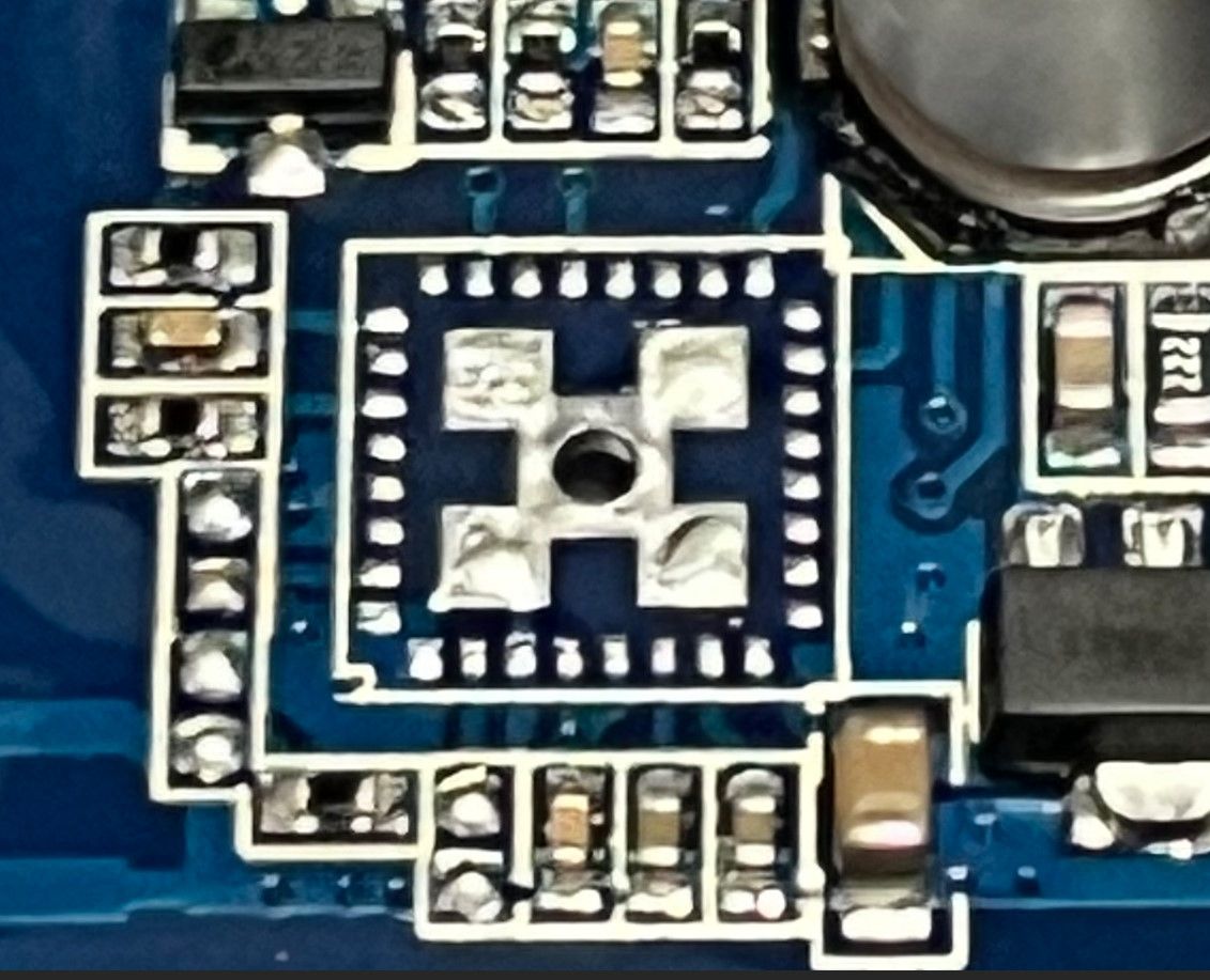

    HI All! I have a lot of switches based on this chip, but with different PCB layouts. I have bought the next bundle of smart switches from AliExpress, and they are without RX TX pads at all, based on T34 chip.
    Close-up of a PCB fragment with electronic components and a T34 chip. Multilayer printed circuit board with T34 chip and electronic components.
    I blew off the chip. It seems that there is only one way to flash it. Pin 26 is not attached at all. According to the picture I have connected CEN ( pin 9) but it is not necessary. It is much easier to break the 3.3V (pin 8).
    Close-up of a chip with several connected wires placed on a white base.
    See also the topic here
    https://www.elektroda.pl/rtvforum/topic4033216.html#20942683
    Used ports:
    P26 pin 15
    P23 pin 17
    P6 pin 21
    P8 pin 23

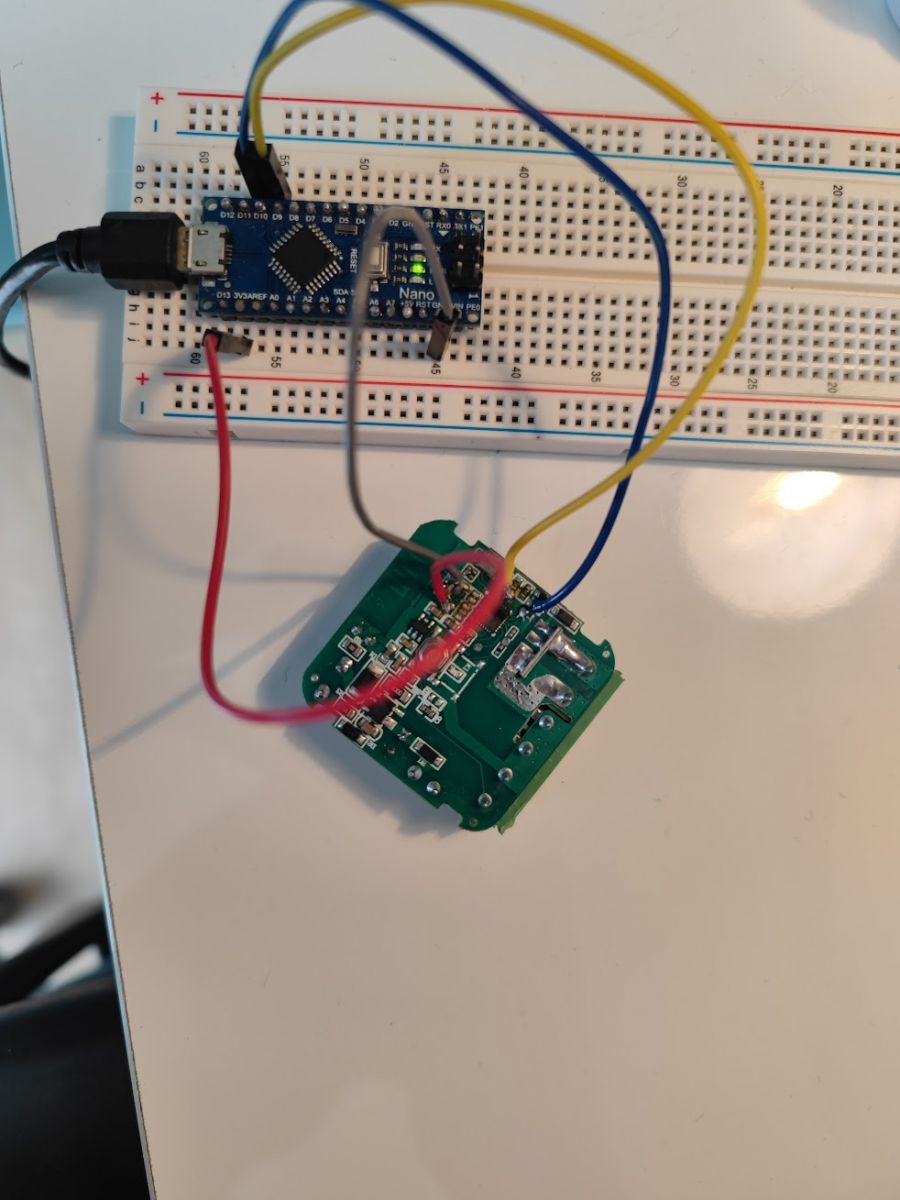

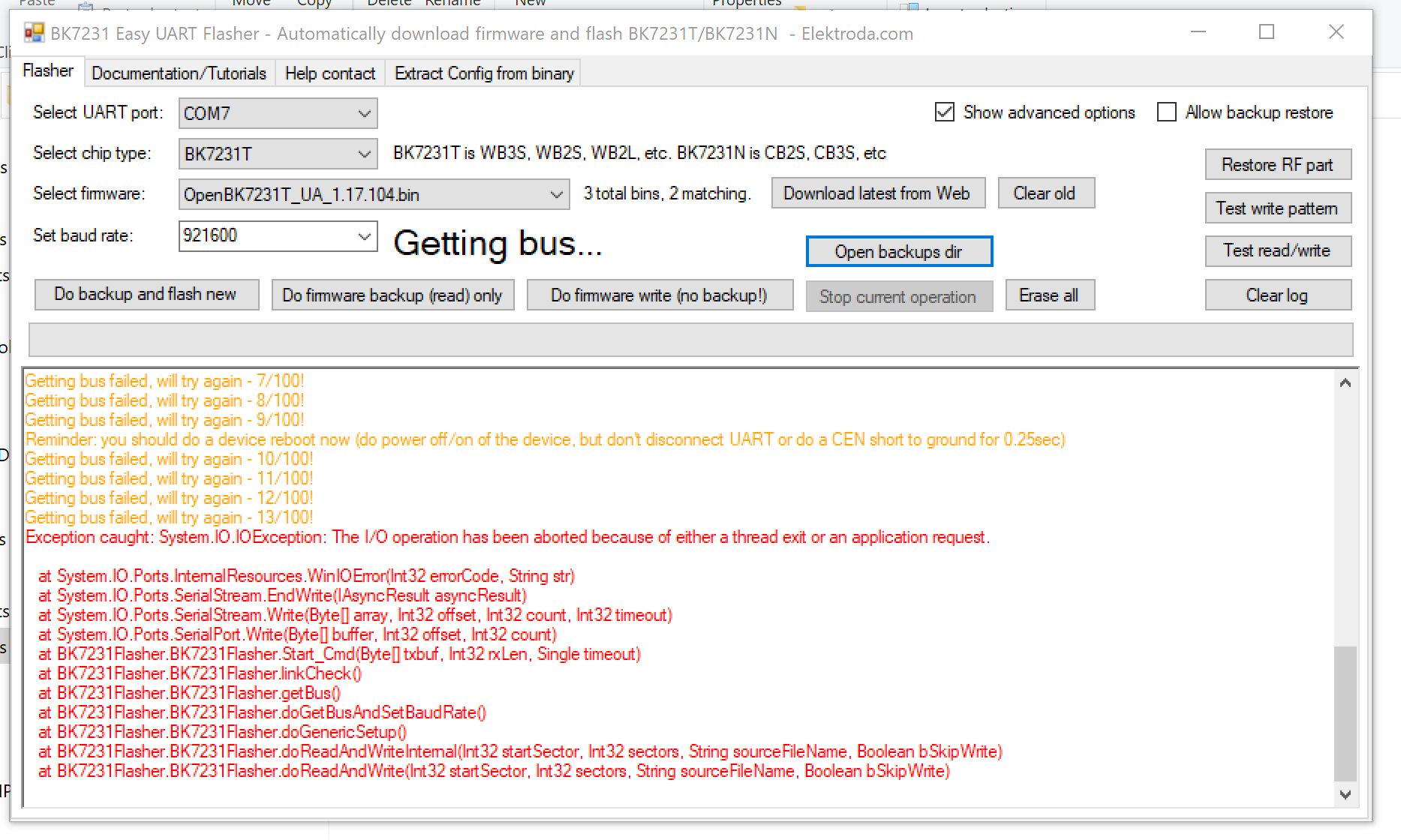

    I have two of the switches OP listed, but can't manage to flash them, they also have firmware 1.3.10 v102. I wired them up like you showed in your first post.
    I get several errors during the flashing process after repeatedly clicking the "write only" button, I added them at the bottom of this post. Things I tried:
    - Swapped arduino nano for uno
    - Used SoftwareSerial (see added code)
    - Wiped arduinos and used Rx Tx pins with gnd and reset pins shorted (cant set baud rate with that setup)
    - Tried standalone psu @ 3.3v instead of arduino 3.3v pin
    - Tried hid_download_py and to flash through CMD, to no avail. It fails to set baud rate.
    - Tried different USB ports
    Does anyone have some advice? I'm about to order some USB to TTL uart bridge adapters to try instead of the arduinos..

    I will just add for clarity that @donut343 issue has been solved in :
    Reading/writing errors on tuya mini switches - issues with arduinos?
  • #75 21109485
    donut343
    Posts: 18
    >>21109310 Sorry, I should have mentioned! Indeed, turns out my Arduinos all resulted in poor communication with the chips. After using a USB TTL-UART converter I managed to work it out. Thanks @ OP for the information of soldering + pin layout though!

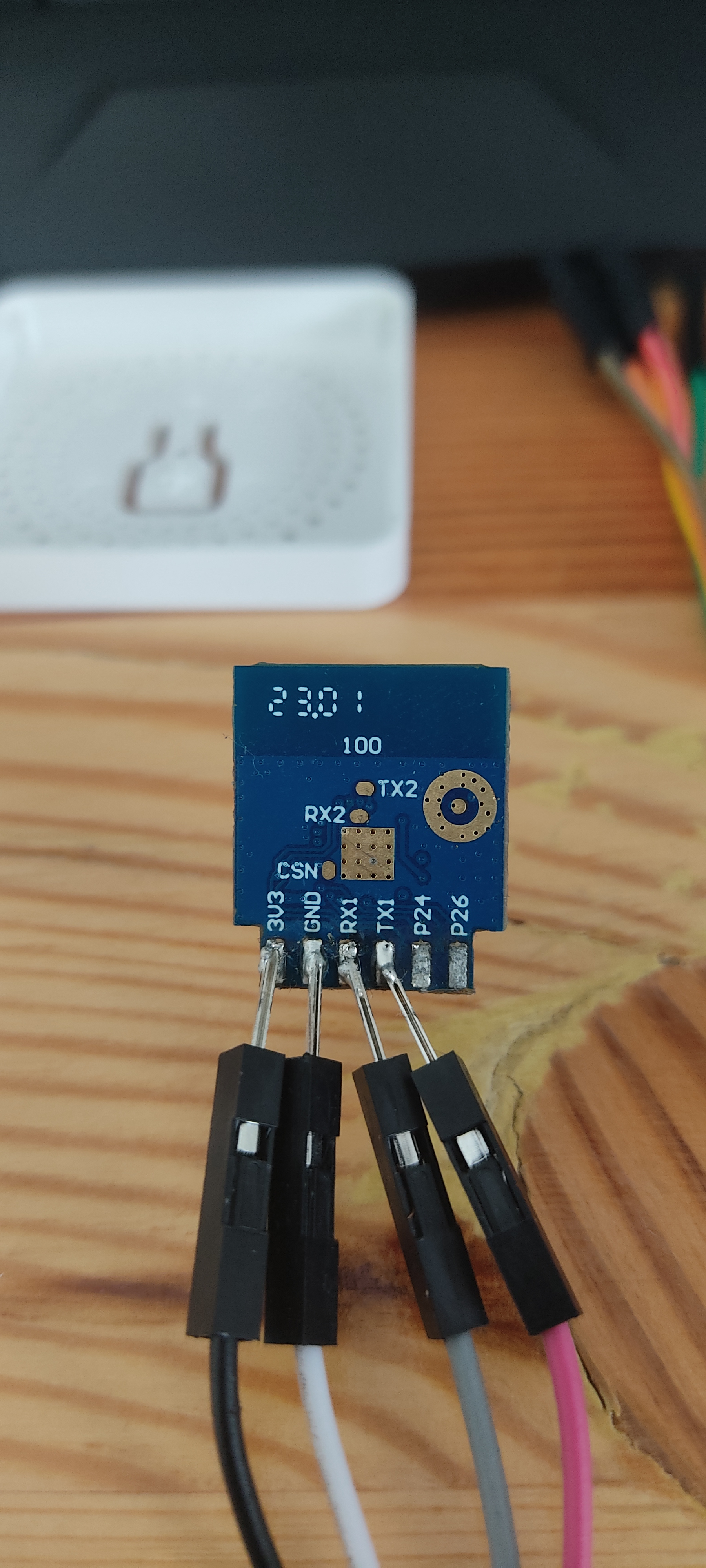

  • #76 21574120
    ttp1106
    Posts: 9
    >>20600974
    I found out that I have 5 Ohms between RTX and GRD on this board.
    Electronic module with connected wires on a wooden table.
    A blue electronic module with connected wires, held in hand, on a wooden table background.
    I think that is causing the issue while I cannot flash it. Do you know how I can heal that?

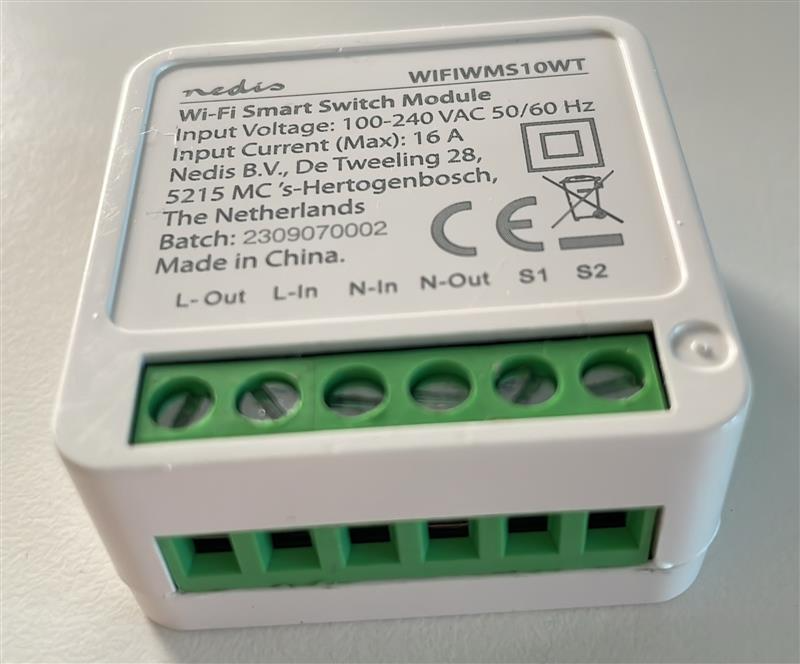

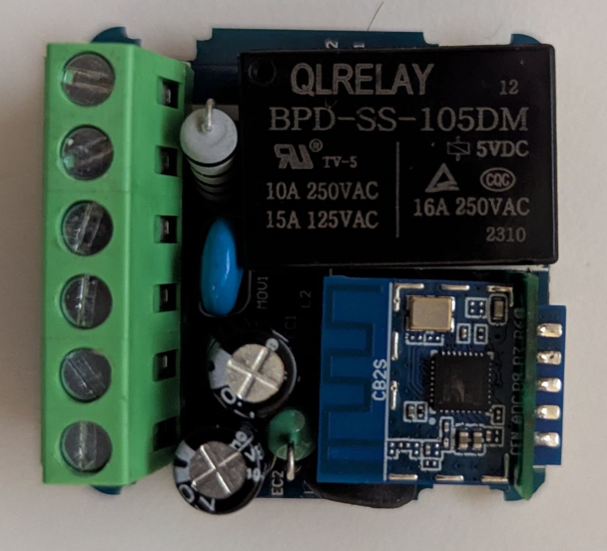

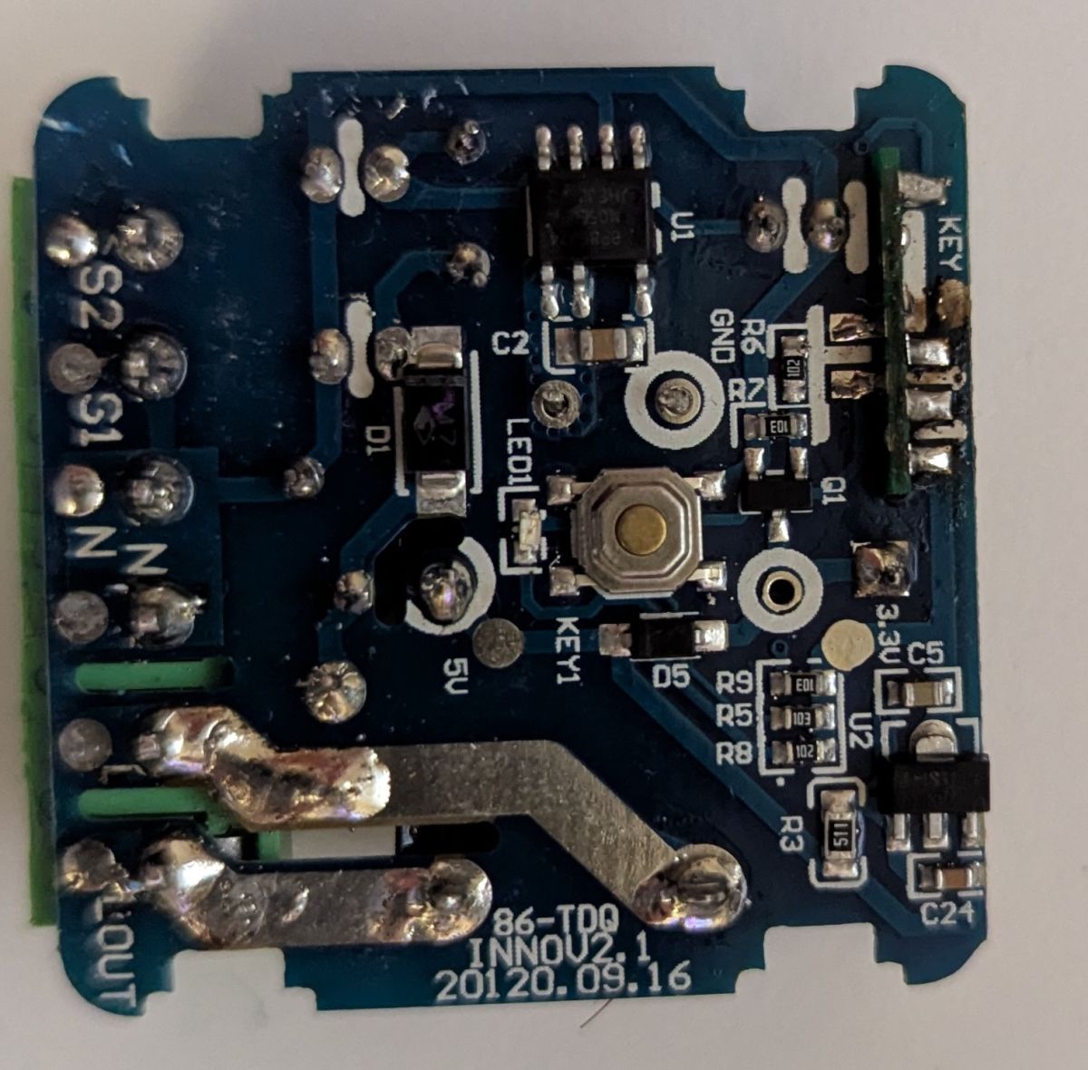

    cstadach

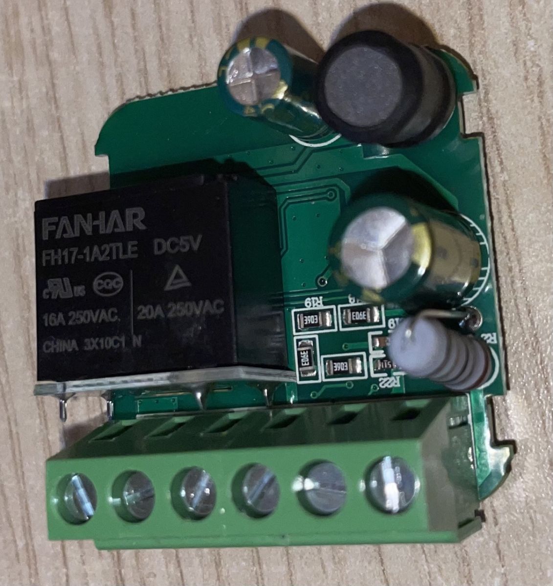

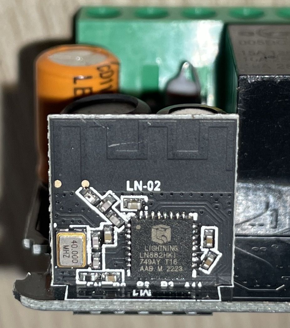

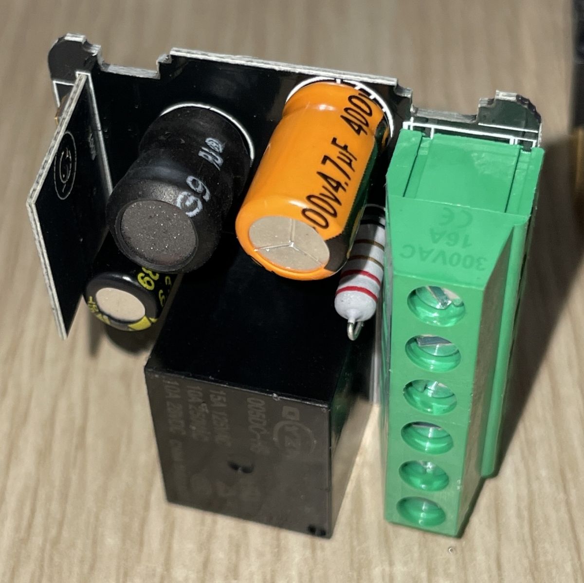

    Thanks to you, I was able to solder-flash my first OpenBeken device (so far I only dared OTA).
    It's a Nedis WIFIWMS10WT bought in Finland. It looked a lot like number 3 from the first post, but had a little different writing on it.

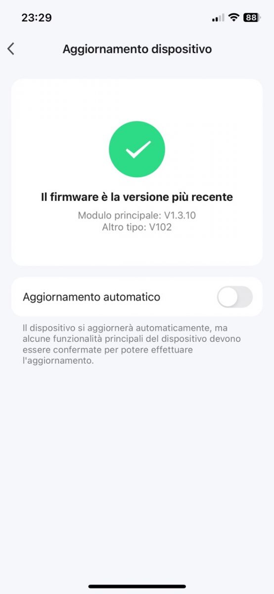

    It ran FW 1.3.10, so only soldering worked
    Nedis WIFIWMS10WT switch module with label showing technical specifications
    Close-up of Nedis device PCB with button, labeled pins, and soldered components visibleClose-up of a PCB with UART header pins and a black relay module on the rightQLRELAY relay module on PCB with capacitors and a Wi-Fi control module
    I was able to dump the firmware before the flash. I attached it to this post.
    readResult...-49-14.bin (2 MB)You must be logged in to download this attachment.
    Takeaways from this:
    Check if your solder job actually connected.
    3.3 V on a USB-TTL stick is not enough; I used the 3.3 V and GND pins of an ESP NodeMCU to make it work. (This one took me a while to figure out, because the device was turning on and the blue LED was blinking, so I thought everything was alright. I just need to time my reboots better...)
  • #78 21762988
    Posts: 14771
    Rate: 12914
    Good job. Sure, you can share your original firmware copy, just make sure it was not paired - otherwise it can contain your WiFi data.
    Don't forget about PowerSave 1 in startup command, those things come with weak power supplies.
